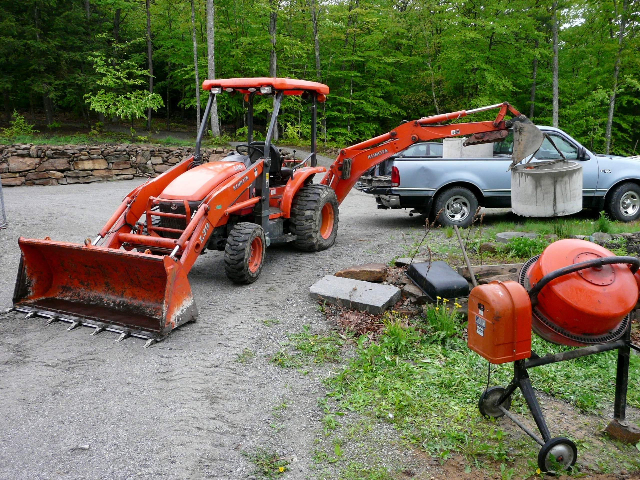

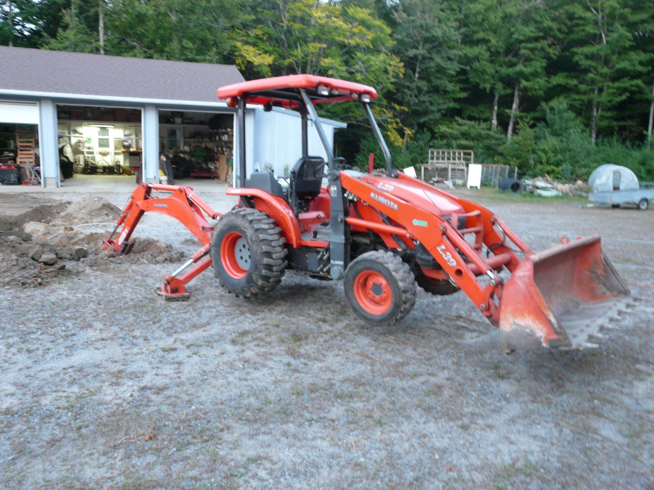

1. Front 3rd Function and as many rear remotes as you think you need.
2. Round bucket is not heavy enough. Weld some more metal to it. add extra side plates to BH bucket and Loader Add a 1/2 X 1" strip to top of round bucket and a scraper at the rear of the bottom.
I have two bolt on edges.

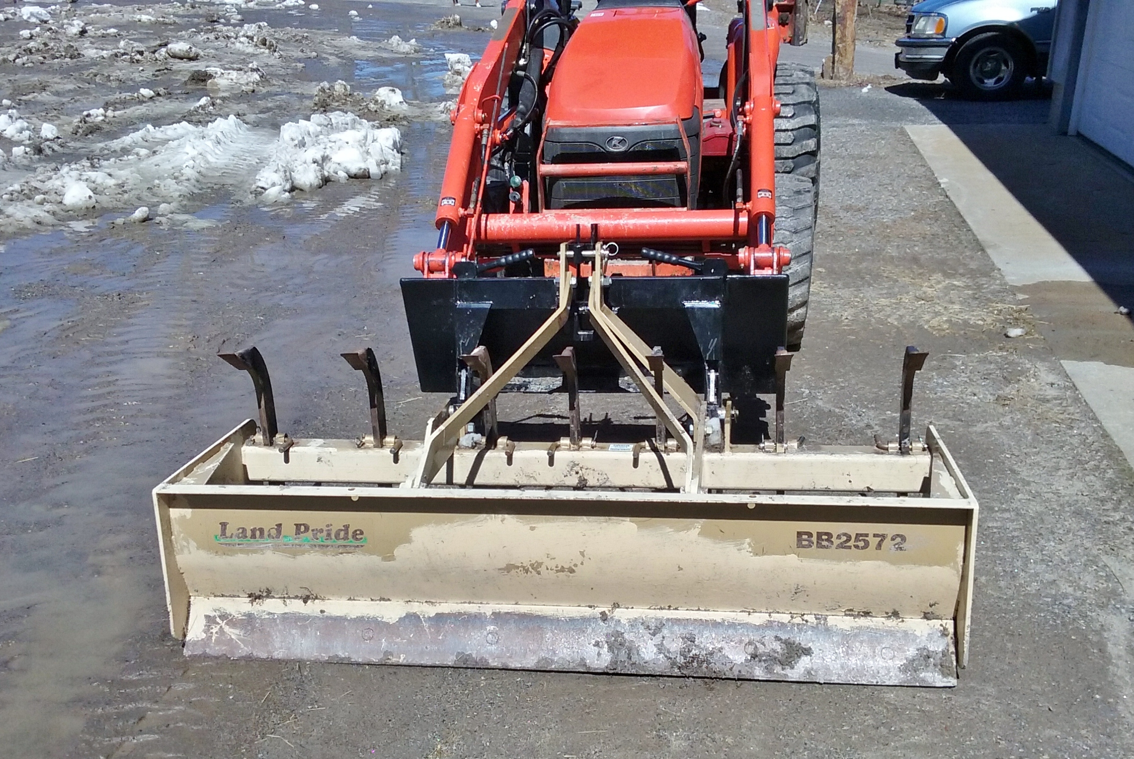

3. Land pride is ok. I'd get a extra heavy duty heavy Box Blade.
4. Hydraulic Thumb
5. Soft ground you can use bigger buckets. I live in NH so I need small bucket
6. Hou much PTO & 3 Point do you expect? I never had the hoe off.
7. Nice to have, certainly not a necessity.
8. Lights, Lots of lights.

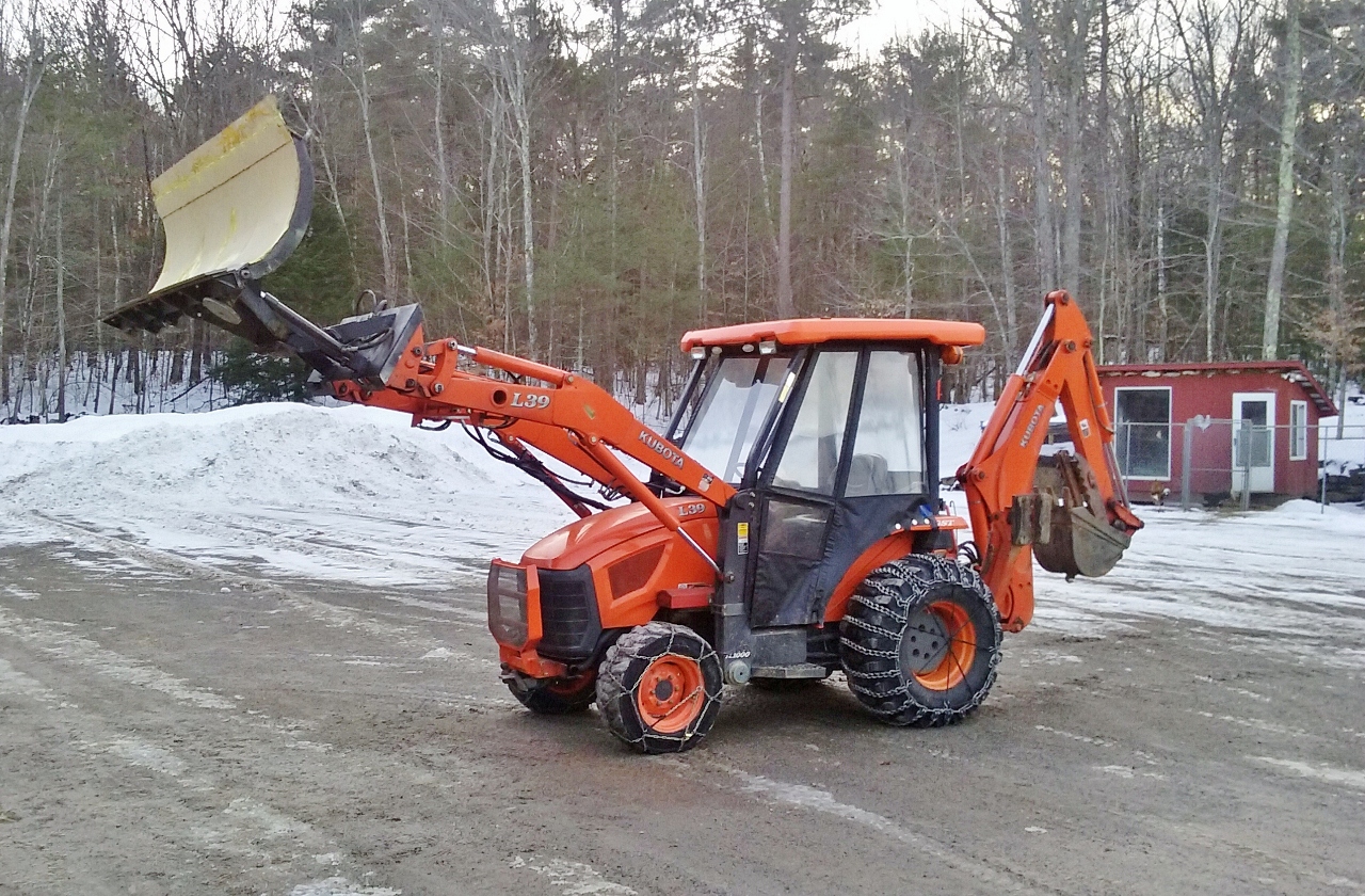

I have a soft Cab, no heat, but still is ok in winter. off it comes in the spring.

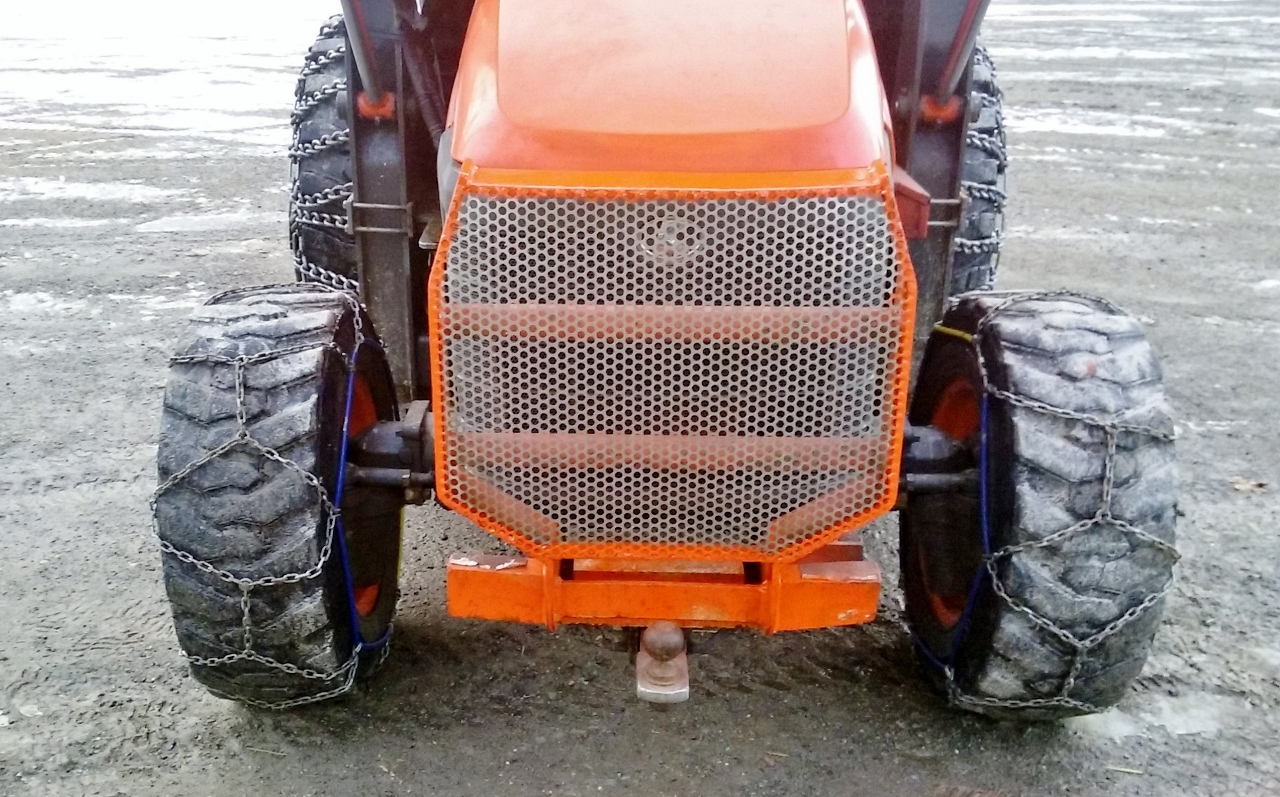

Tire Chains Studs and 1.5" wheel spacer.
Tow Loops and grab hooks
Load the Rear Tires! Do it.

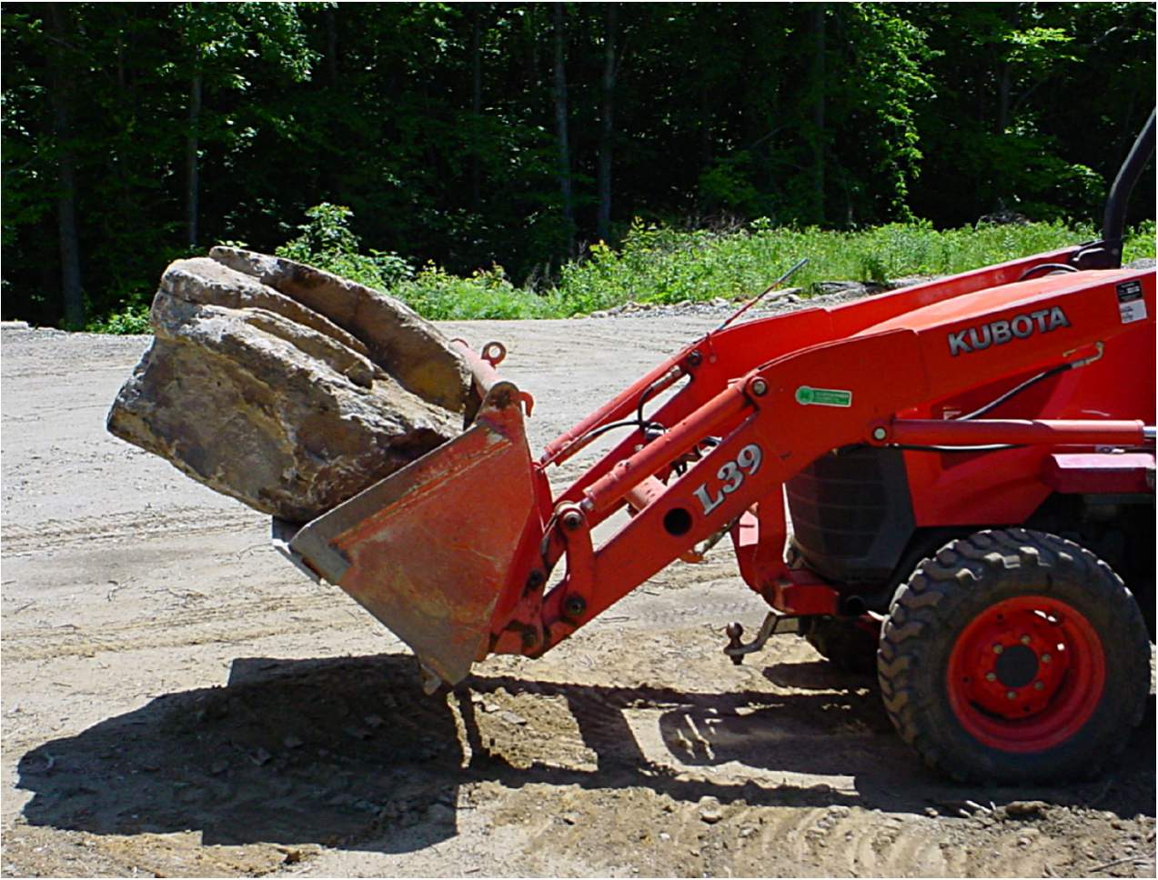

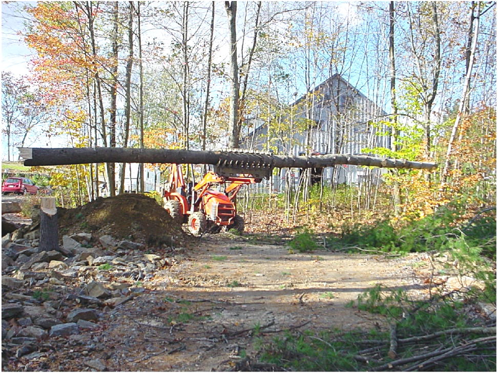

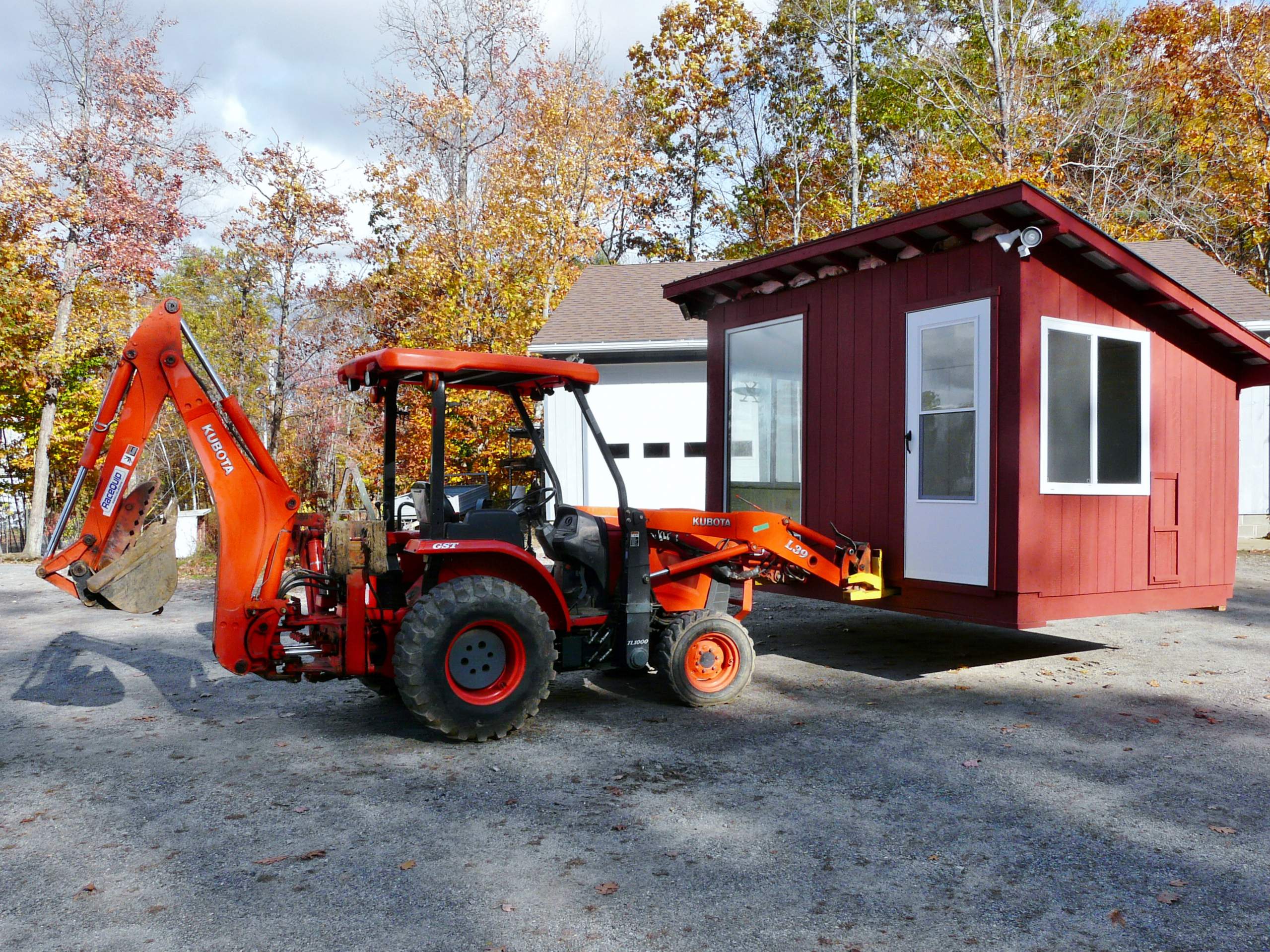

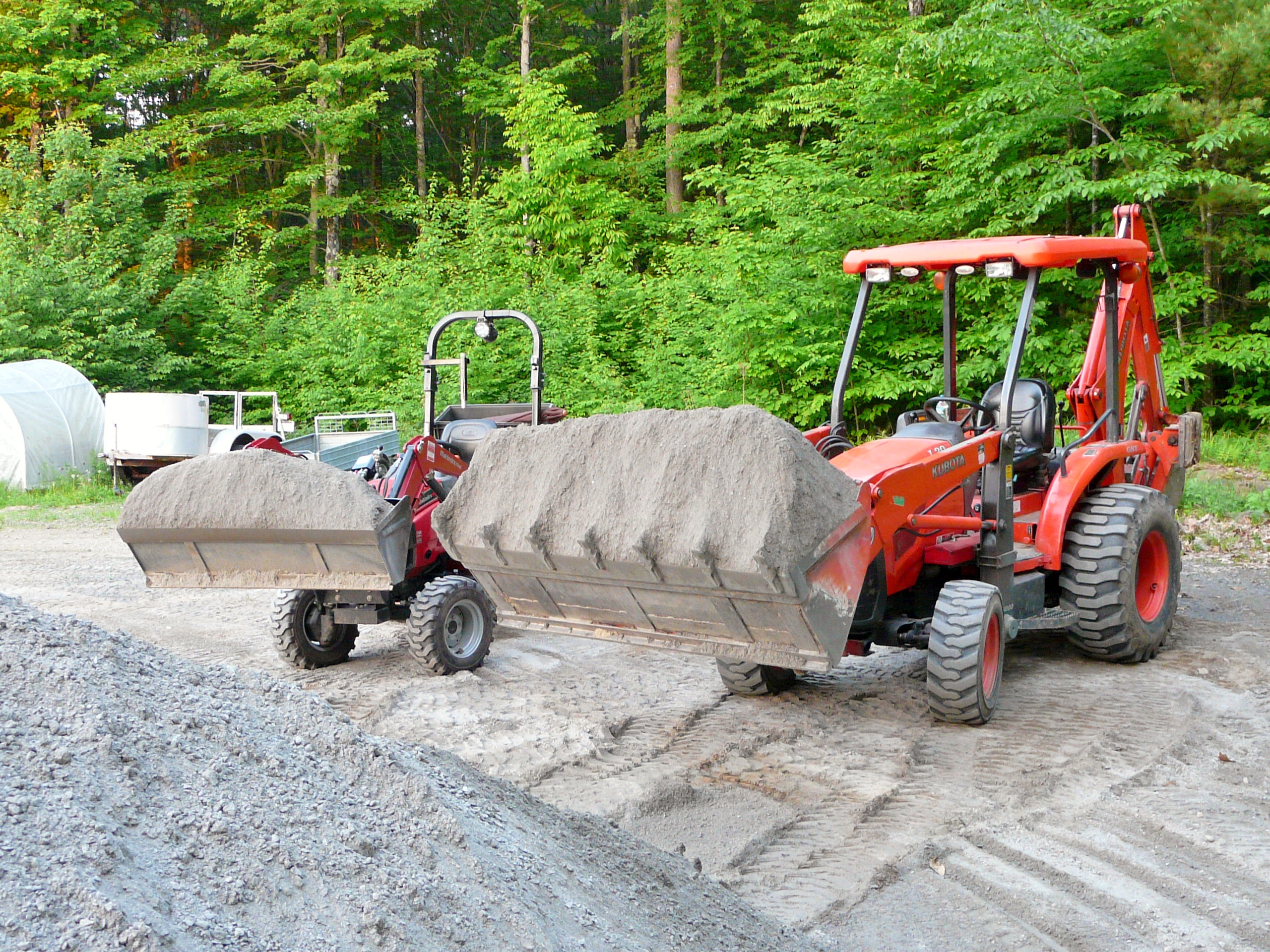

Attached Photos are some of the stuff you and do and tools you can add.

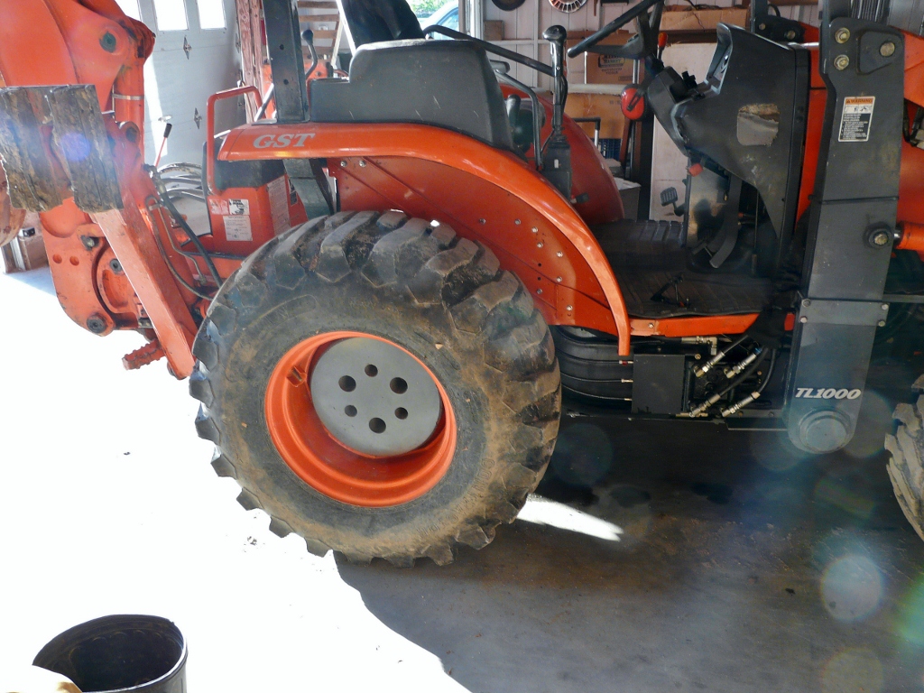

Which hydraulic PHD is that and what are those tractor wheel mats in the garage?
Danhuser. Don't remember the model, but it's the 2" hex drive & GPM range for my (your) machine. Easy to figure out if you browse through the models.
I got some chunks of conveyer belt a while back. My intent was to have it chewed instead of the concrete when I had chains on. Haven't needed to put the chains on in the past 2 years though. I actually rolled them up & put them away a few months ago as they got in the way sweeping the dirt out & generally being a tripping hazzard.

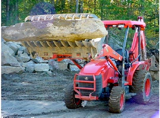

Thanks for the photos and answers. Which grapple is that in the max rock pic?

Borgford grapple.
I'd go Wicked, their HD one or if you want to get a ok grapple at a great price, Check out Fea Bay! Really my boss got a nice one.

8. Doors with my soft cab make entry difficult. Really difficult if your old and stiff and got on bulky coat. Other than that it is about an hour to install 1/2 to remove or less
