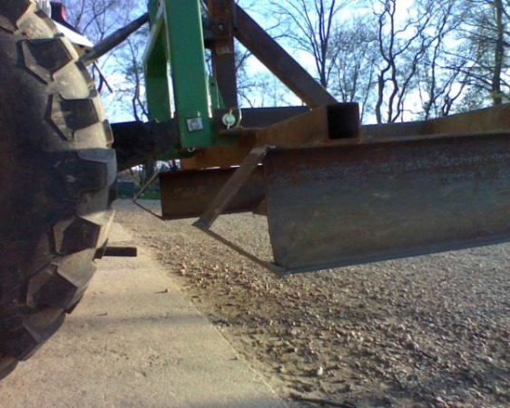

If one was to build a similar land plain with the intent of gravel driveway maintnance, should the cutting edge be even with the bottom of the runner or lower/higher?

I would set it about 3/4" below for driveway work as long as you have a hydraulic top link to adjust the pitch of the skids. Otherwise I would stay close to flush as it will still dig in quickly. Digging down deeper helps to pull the gravel back to the top surface.

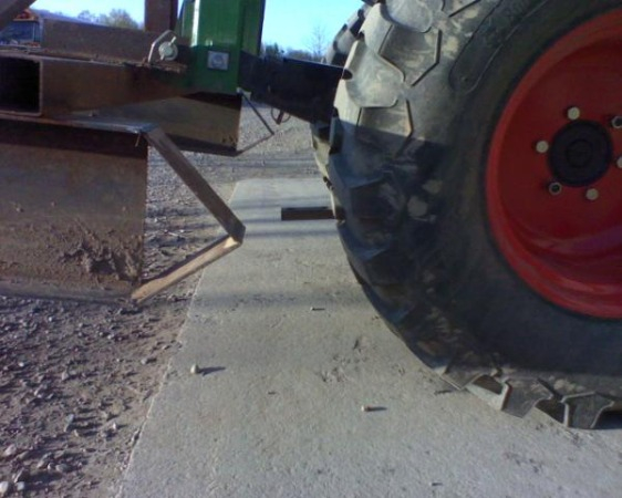

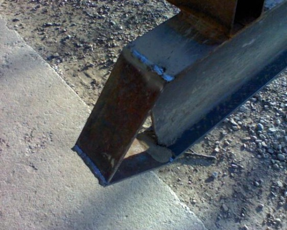

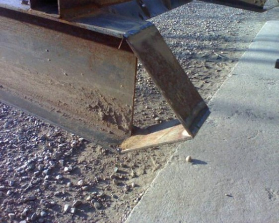

As far back as you put the first blade seems you have plenty of room to roll the ends as I did in the larger plane. On my larger plane the front blade is about 4 inches behind the start of the flat running surface. This allows me to pitch the plane forward and dig in when needed. I built this larger plane for the 110 and it has no problem with it.
I thought about rolling it. But here's what I went with, a 7inch and an 8inch piece in the triangle shape. So far it worked pretty good. Went across a fresh ripped field to make an access path to a new irrigation system. Earlier it wanted to dig, now it floats a whole lot better and not loosing traction in soft soil. I didn't do the back yet, maybe I'll try something else
Simple but effective glad it worked out for you.

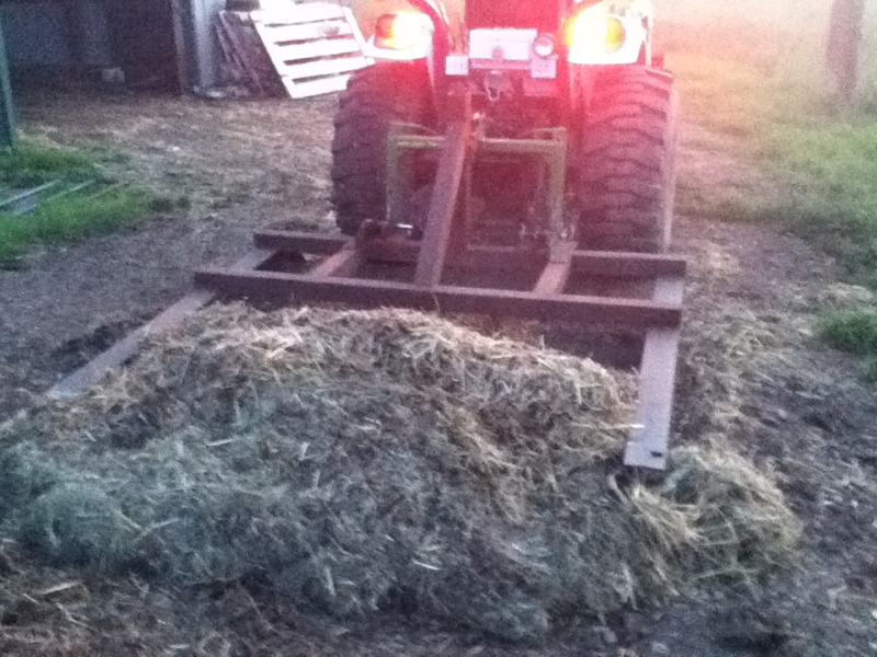

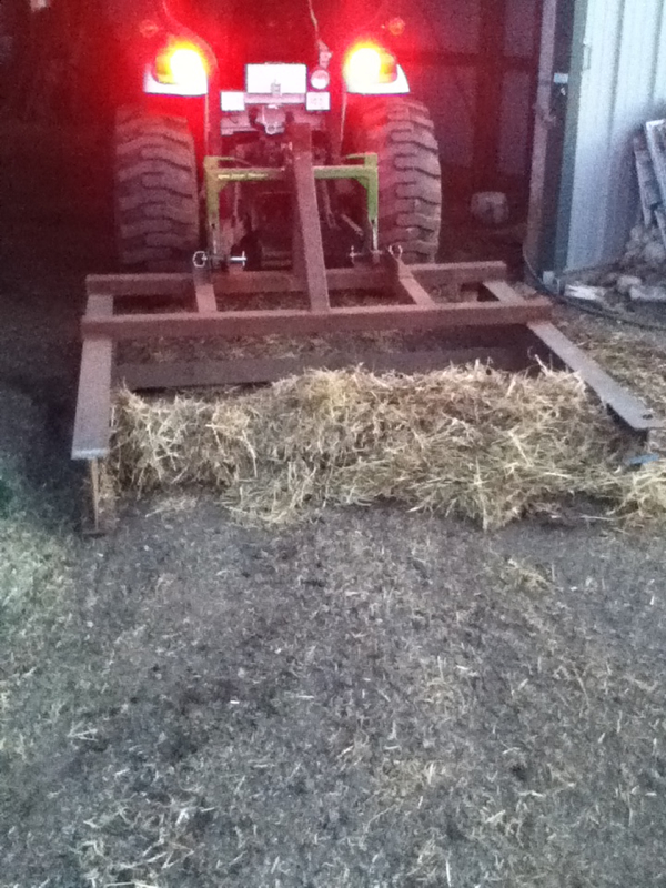

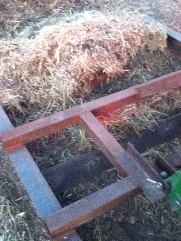

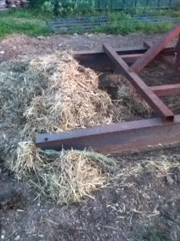

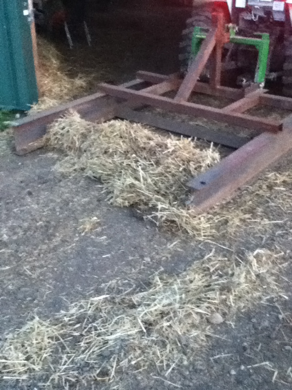

While cleaning the hay barn found a new use for a land plane! Scrape up the hay on the ground, (landscape rake is currently being fitted to work with the imatch) but go in reverse, acts like v-plow and catches majority of the hay.
