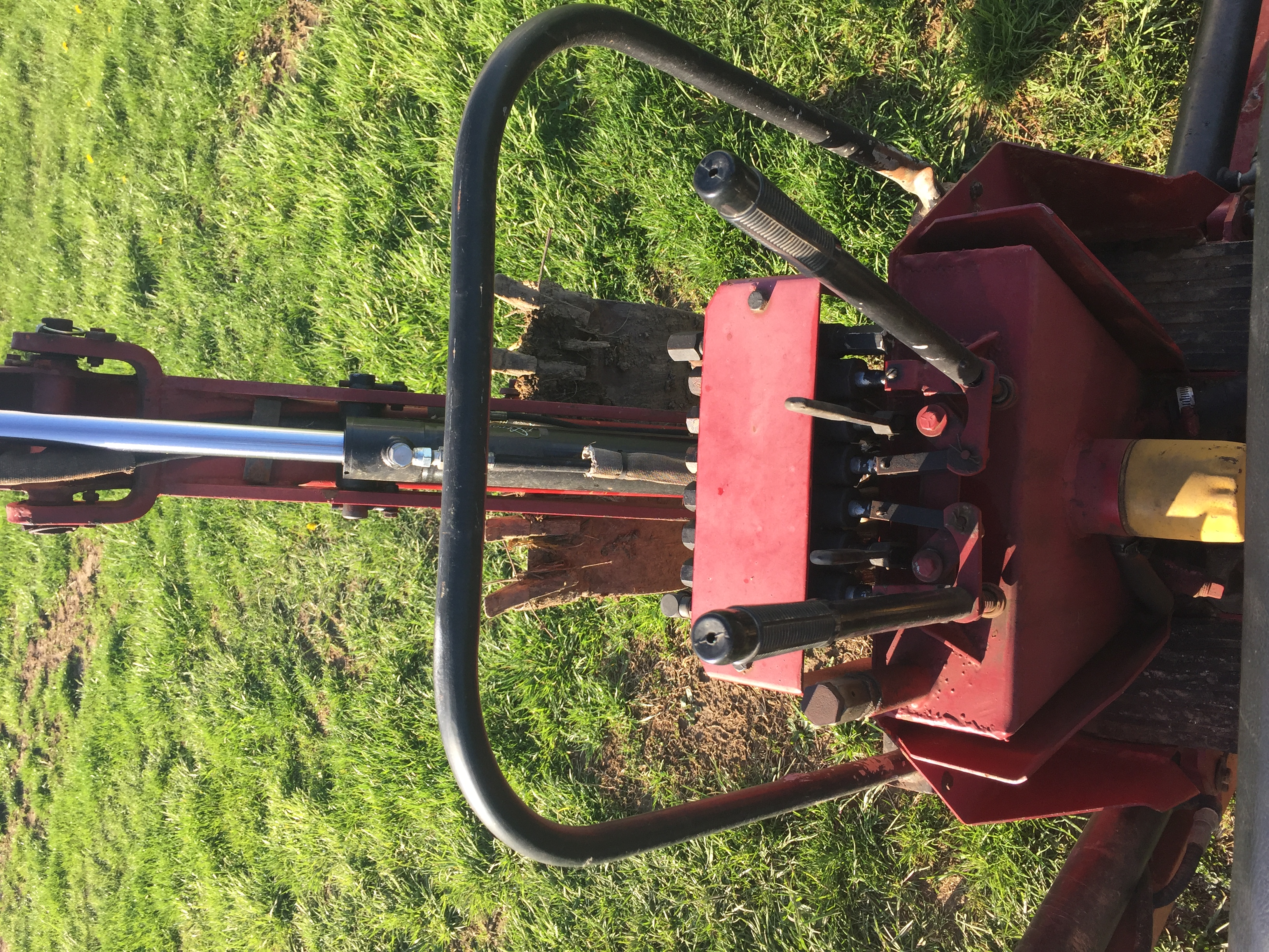

Just a bit of info on the loader and backhoe. The gentleman I bought the unit from told me both attachment pieces came off Kubota tractors (2 separate transactions to get the pieces). He told me the backhoe attachment was used in a cemetery. Of course I cannot verify this, just passing along. The backhoe is powered by a self contained PTO hydraulic pump, and the loader works off of the tractor hydraulics.

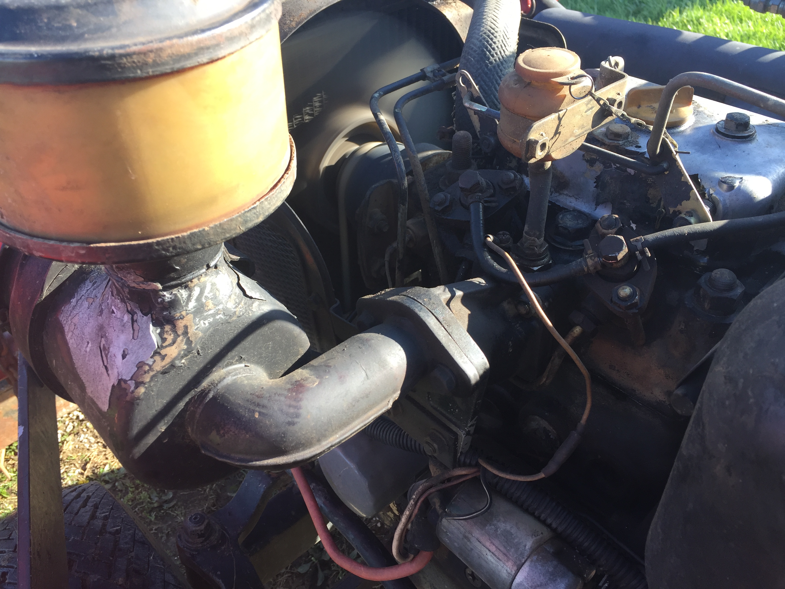

These had an optional ThermoStart, a plug similar to a spark plug screwed into the intake manifold. The inner end of the TS is similar to a car cigarette lighter. Twist the key left to power the TS and it heats the manifold. The TS is also fed a little dribble of diesel from a tiny reservoir. Look and see if you have these components.
If the prior owner didn't need TS in your climate then don't worry about it.

Thanks for the info on the ThermoStart. I'm not familiar with this, but I do think I saw a tiny plastic reservoir on the top of the engine. I will have to check into it.

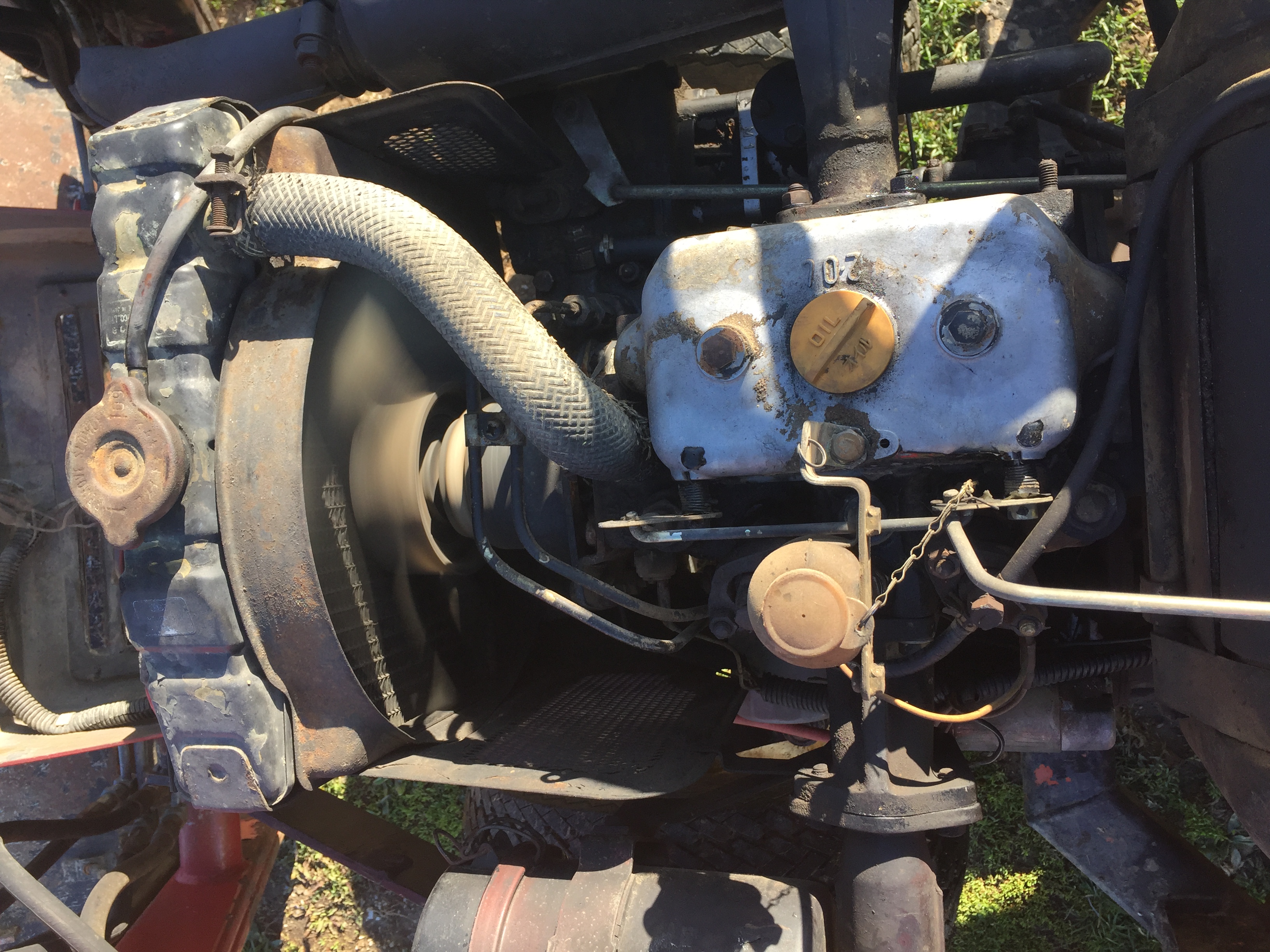

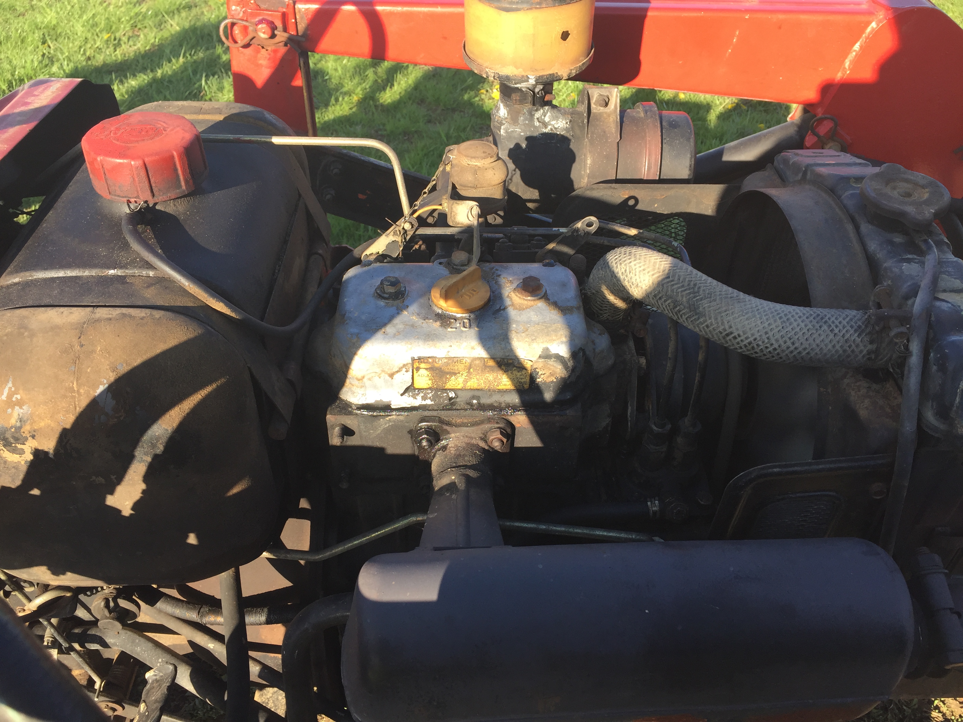

Took some more pics this evening as I was tinkering with the Yanmar. It does appear to have ThermoStart. I have not verified whether or not it works.
