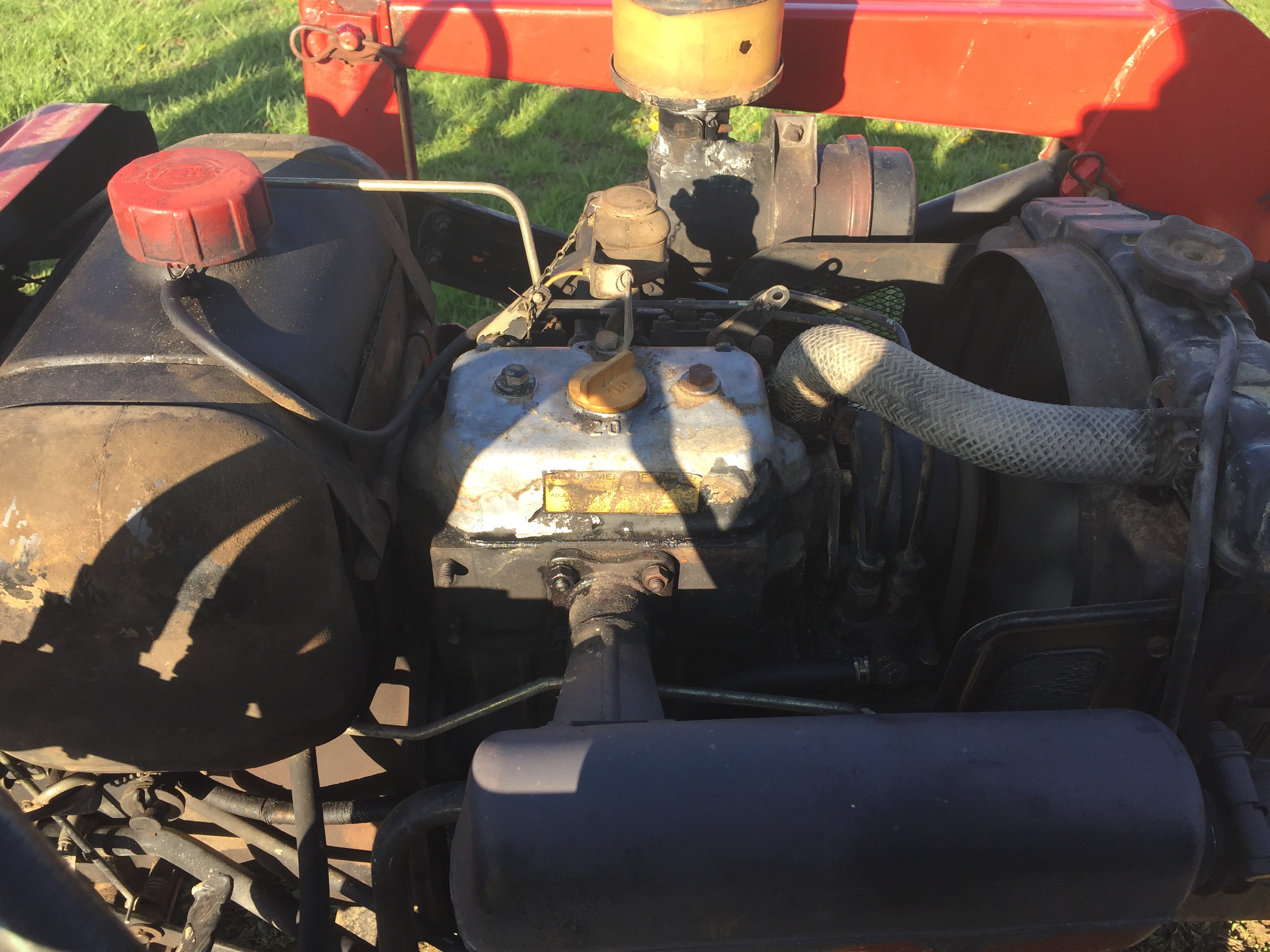

Normde2001--- Has always worked fine for me. Have you checked your springs that connect to the decompression assembly above the valve cover? Maybe they are broken or need lubed. They are responsible for returning the decompression lever to its natural position.
Yep, mine has a spring assembly that returns the decompression lever back to normal.

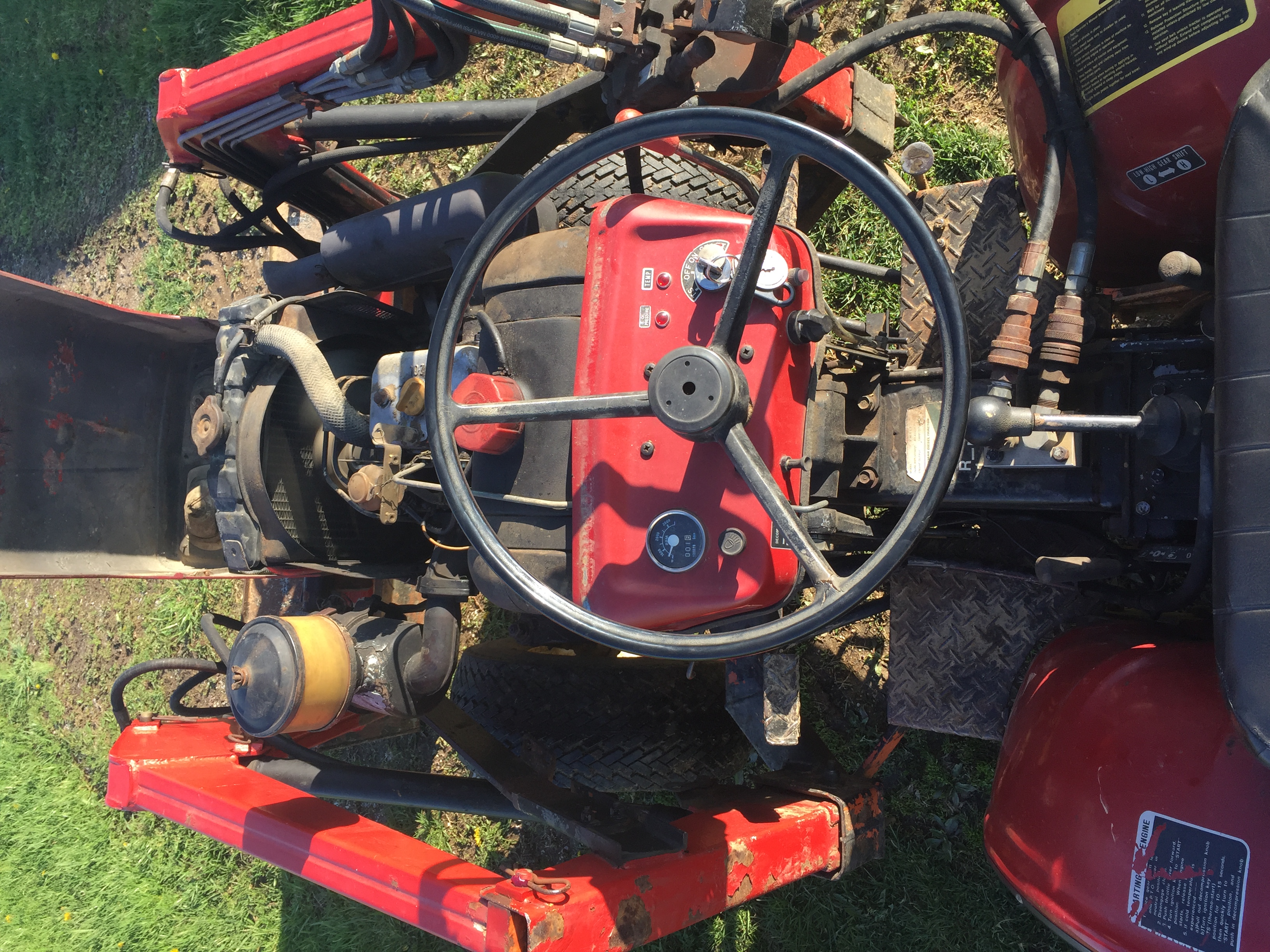

Gotta love that backhoe! Thank you for the great photos. Best of use with your new tractor!
Happy to share. I only found a handful of posts about a YM165 when I was doing research before I made the purchase, so I'm more than happy to share information.
The backhoe is pretty neat. I'll be honest, at first I didn't want the backhoe, but the seller told me everything had to come as a package deal. But now that I have it home and have tinkered with it, I will probably just keep it. I do work around the property with other 3 point implements, so I do need to experiment with removing the backhoe.
Springs good but still too much drag. Have never needed or used except to bring up oil pressure on cold start. Starts instantly without it.

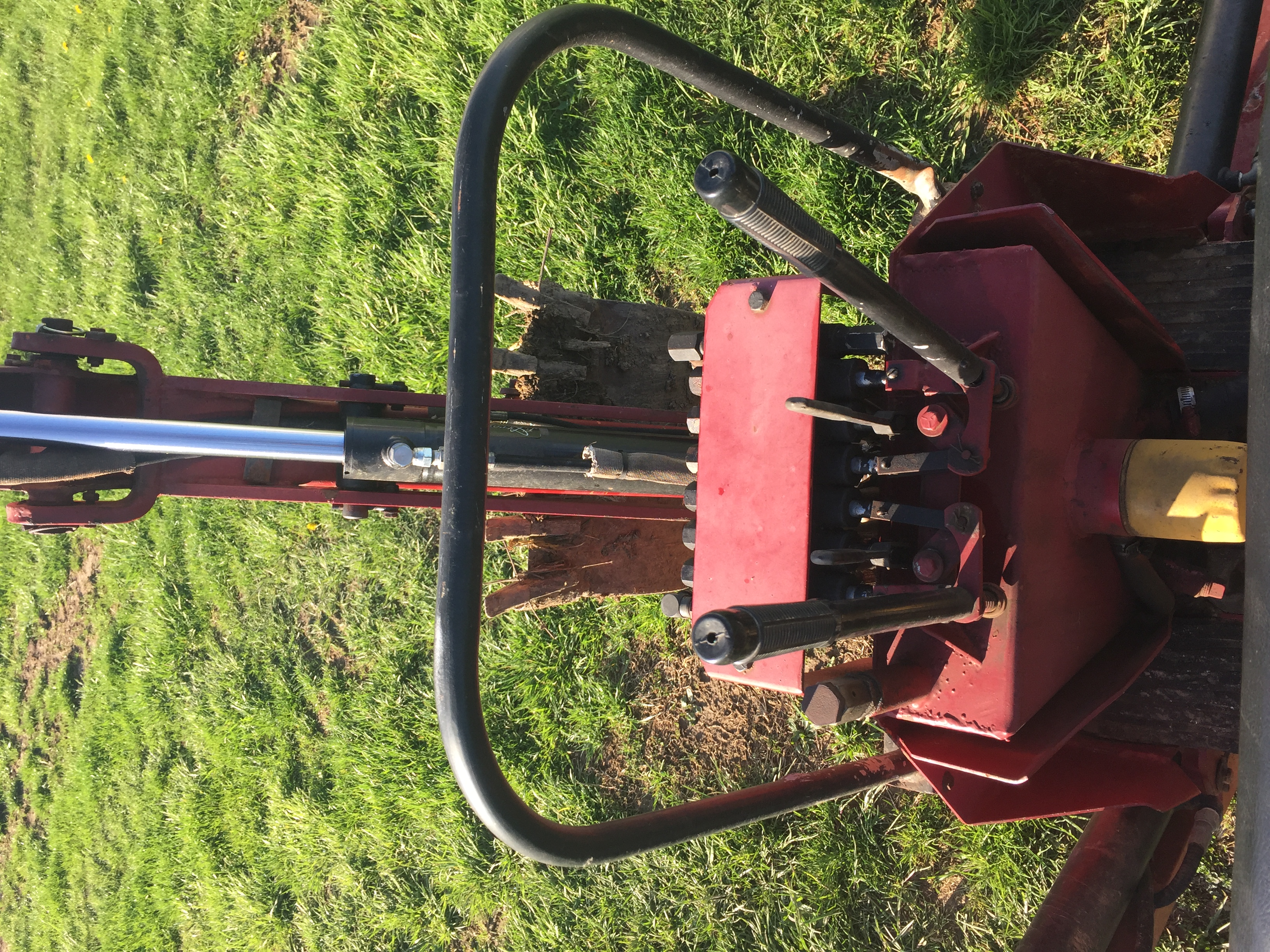

A tip on removing the backhoe: I have a chunk of 10 x 12 wood a couple of ft long I slip under the backhoe with the 3-point raised, then set its chassis down on that. The point is you need to balance it so it won't tip forward or back when it is left alone because that makes it more difficult to re-mount later. Then for installing it - back up close, connect hydraulics, use the hoe's hydraulics to operate both feet and the boom for final precision alignment. Much easier than using a long prybar. But stay out of dangerous crush zones! Turn the engine off before reaching in to install pins etc.
   / New Owner of a YM165
#25
Thanks for the tips. This unit is a little different though. It is not a 3 point mount. The 3 point arms have to be removed first, and the backhoe attaches to the tractor frame. As far as I know (I will have to definitely take a better look at things before I remove the backhoe), the PTO hydraulic pump is actually attached to the backhoe itself. This is how the previous owner described removing the backhoe;
Get yourself in a decently flat spot. Lower the backhoe outriggers to remove pressure off of the frame. Best I can tell the backhoe is attached to the frame with 2 bolts and a steel tube through something like a c-channel. Sort of hard to explain in words. I'll have to take pictures later as I tinker around. Once you remove pressure off the frame, undo the 2 bolts. He then said to kind of push the tractor forward a bit and the backhoe should start to slide off. At this point you need to push the little pin on the PTO pump/shaft to remove the shaft from the pump. Then he side you just drive off.
Sounds simple, we will see how easy it is lol. I do plan to put a large block of wood under the backhoe when it is free from the tractor though to keep it from falling over or something like that.
   / New Owner of a YM165 #26
That's good news if it is a frame-mount instead of 3-point. That design is much stronger, so less likely to harm the tractor.

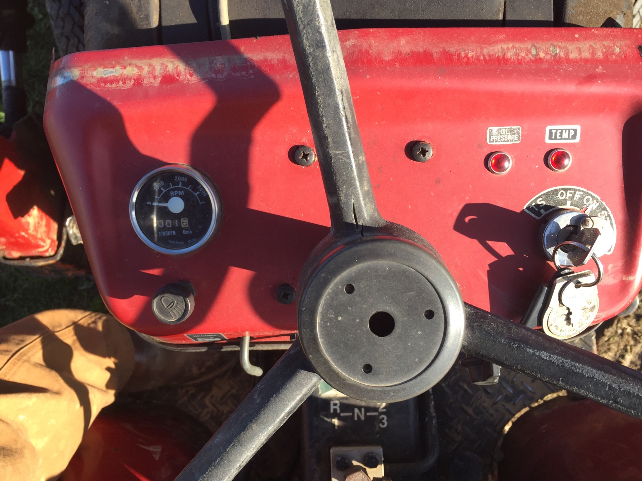

"Pull (twist?) the compression release lever, get the engine spinning with the starter, then let go of the lever and let the inertia of the flywheel assist the starter motor.
Grab the throttle and reduce it before the engine races. "
That has never worked for me. Have always had to push the decomp lever back in, and requires 3 hands.:thumbdown:
Mine works just at California describes and do it just like he wrote.
   / New Owner of a YM165 #29
I too have a recently acquired 165d. I am impressed the Thermostart actually works. Out of curiosity on one -10 F night I went out and started it with no problem on third try with the compression release. Took 20 minutes for the hydraulics to warm up enough to lift the 3pt but it started with no problem.
