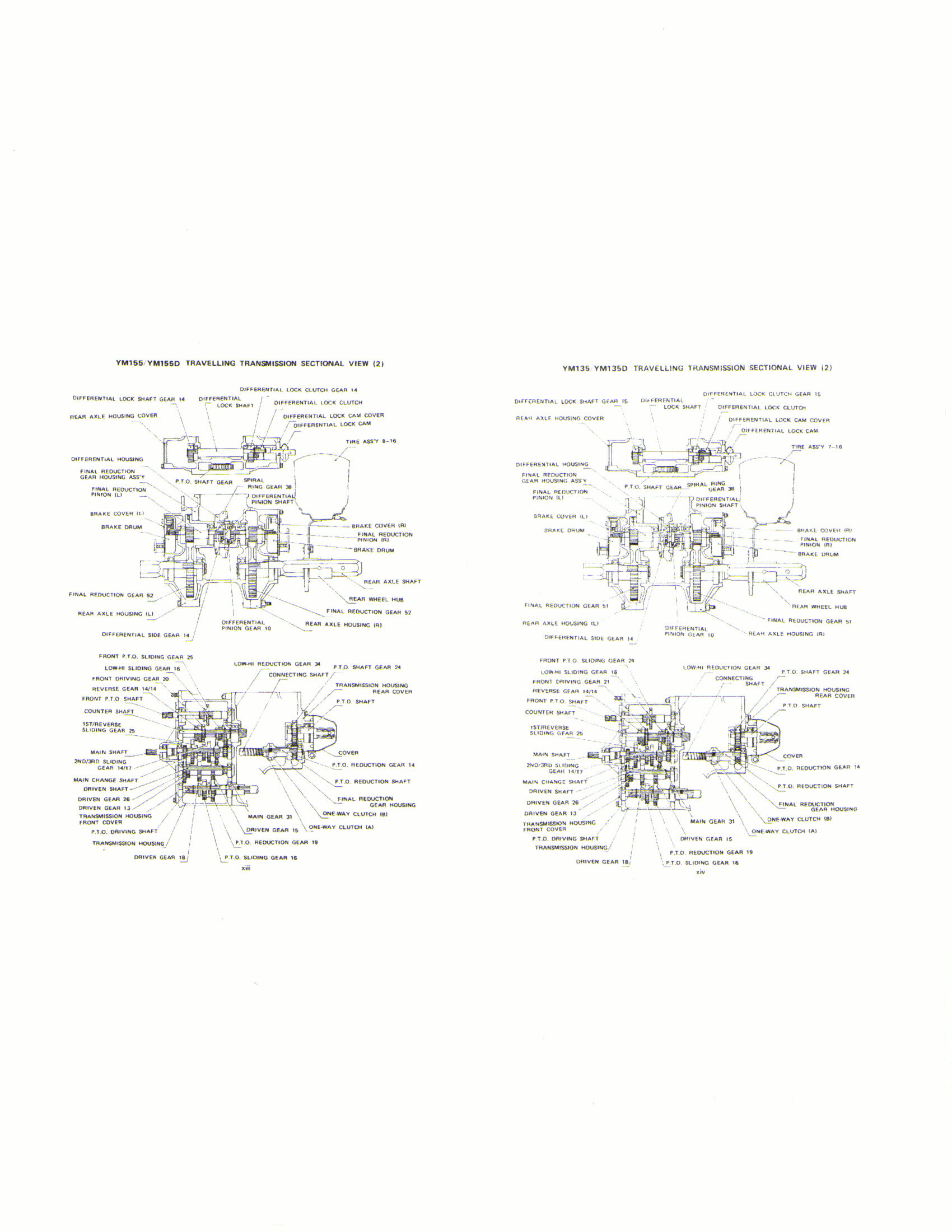

Thinking your 165's have internal over run clutches. Note the 135 and 155, also know the 169 has an internal. 2018-04-20-104138.jpg

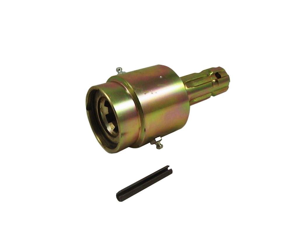

Yep, I'm going to order a quick-connect PTO over-running clutch for mine for when I have to bush hog or rototill.
Did you mean a slip clutch?
As Winston said, this model and all the US Yanmars already have an over-run clutch inside the transmission so far as I know. It is similar to the coasting mechanism on a bicycle, a one-way ratchet. Its purpose is to prevent the inertia of a mower etc from pushing you after you push in the clutch. A rototiller doesn't really need one, it doesn't have much inertia and will usually be slowed by the soil.
With the engine off engage the PTO and try turning the shaft in both directions. One way should ratchet.
This is what I was referring to, except quick-connect.
Interesting about having an internal over-run clutch. Does this ever need to be serviced or anything like that? I will have to do the test of shutting the engine off and trying to turn to the PTO shaft.
   / New Owner of a YM165 #36
It runs submerged in transmission fluid. No servicing unless it wears out.
