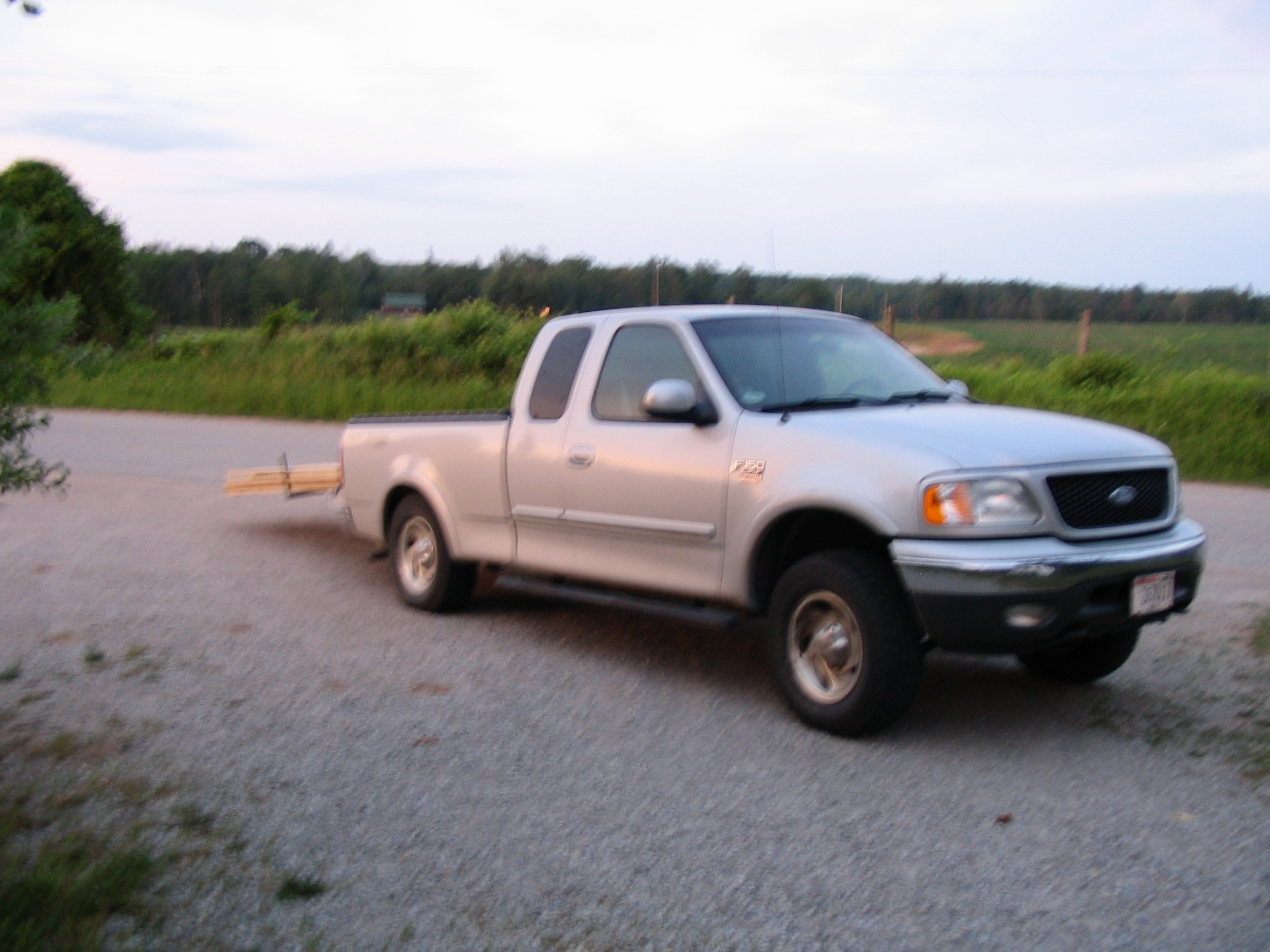

The attached picture shows my truck during a deck building project.
I am now considering a 2008 F150 4x4 super cab. It is over $11,000 off original MSRP.
It should also be more heavy duty than my 2001.
I tow my tractor on a tandem axle trailer once in awhile. What I really wanted was more payload as indicated in the attached photo.
The F150 is more agressively sale priced. F250's are less discounted, and very difficult to find at this date.
The Ford propaganda machine was also impressive at the dealership. Ford looks pretty good.

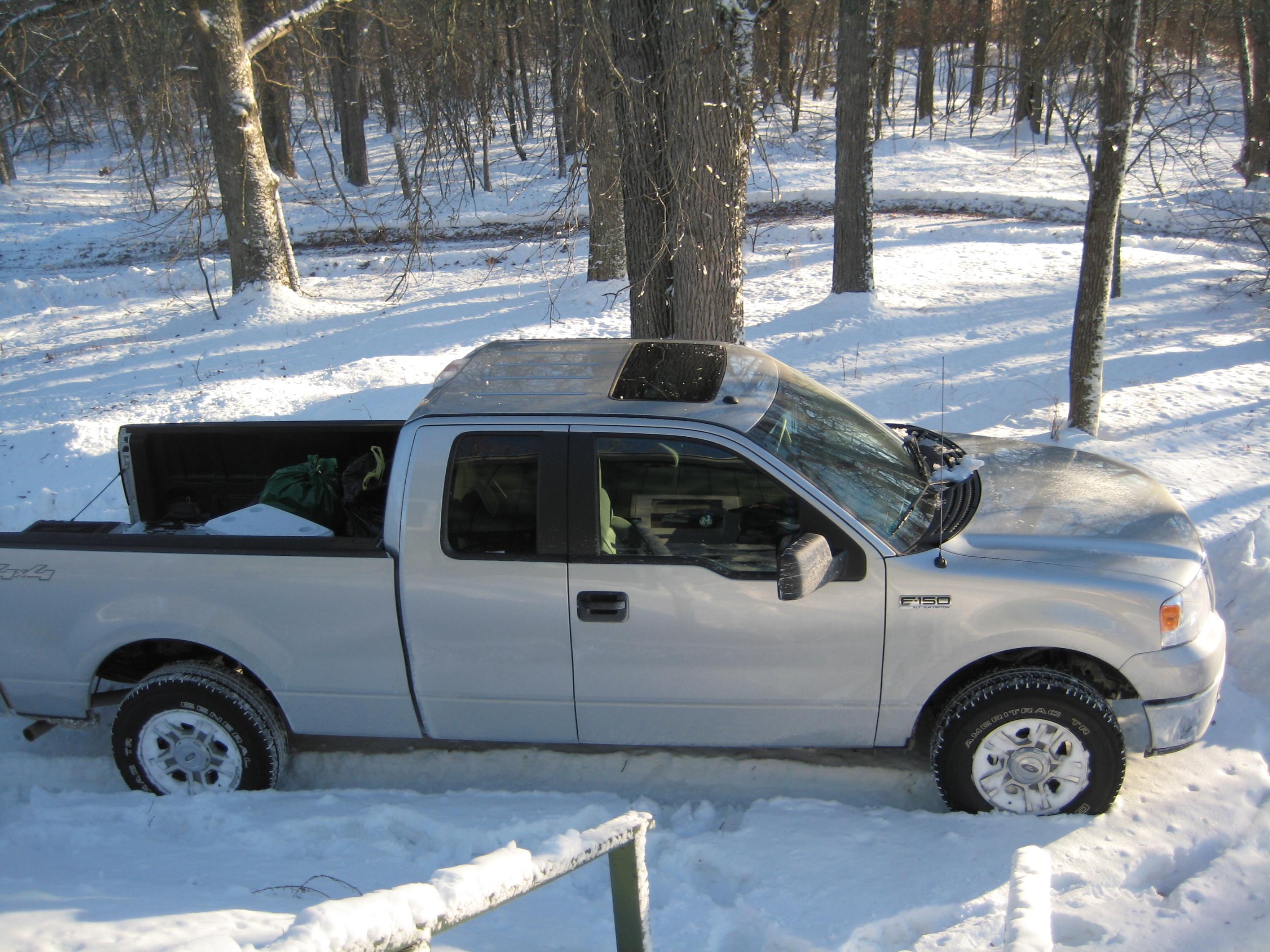

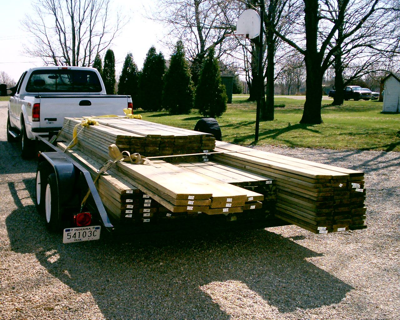

Boy, you sure need the trailer that day. Here is a pic of my deck project. I had 3 loads like this. The trailer is a 18' tandem 7,000# unit and its behind my 2004 F-250 4x4 Power Stroke.
Chris

   / New Pick em up Trucks #39
Chris
Forget something? :D
   / New Pick em up Trucks #40
Got it fixed.
Chris
