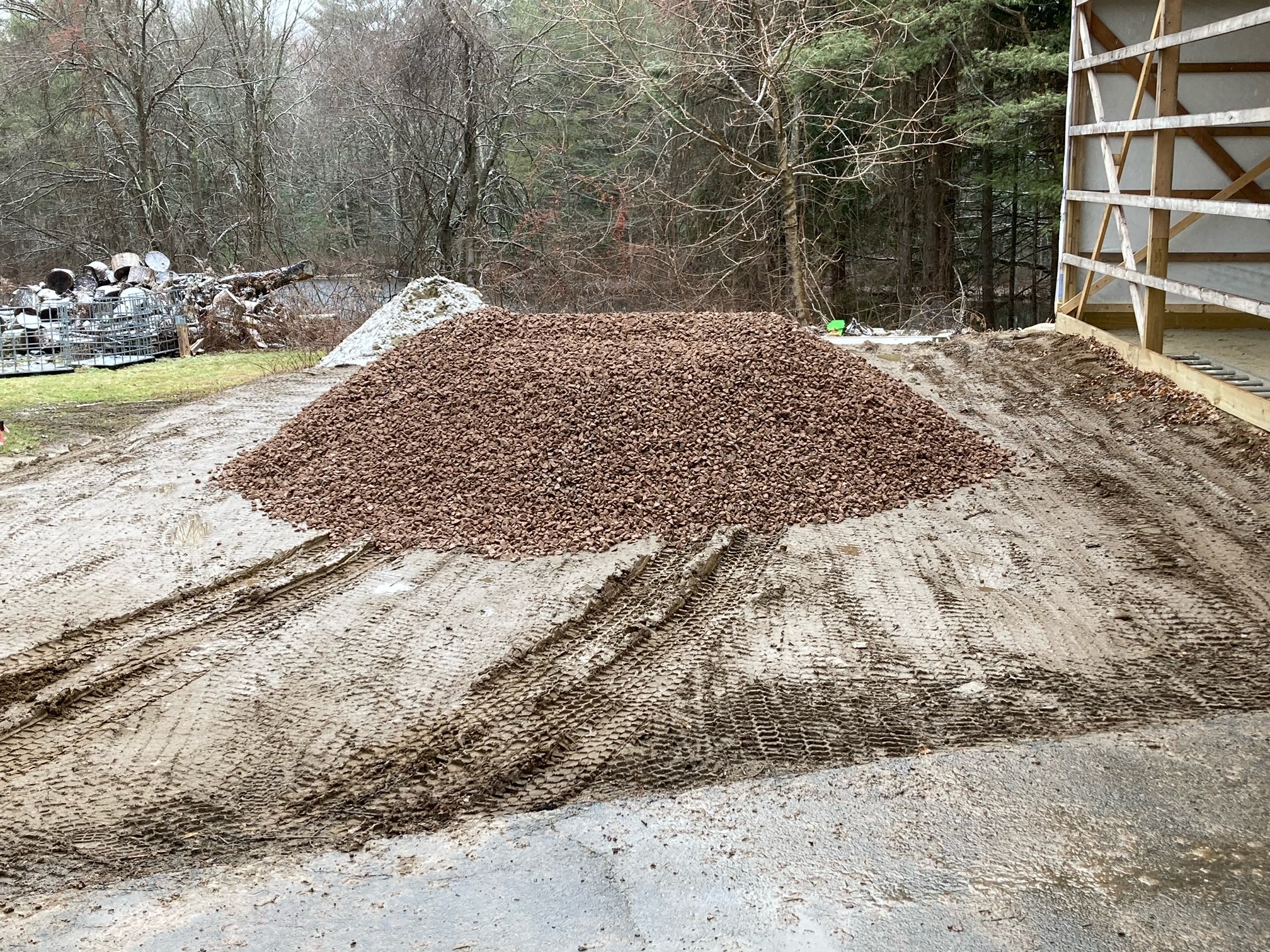

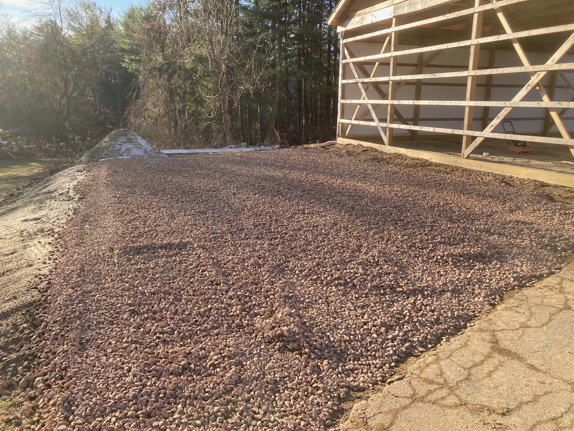

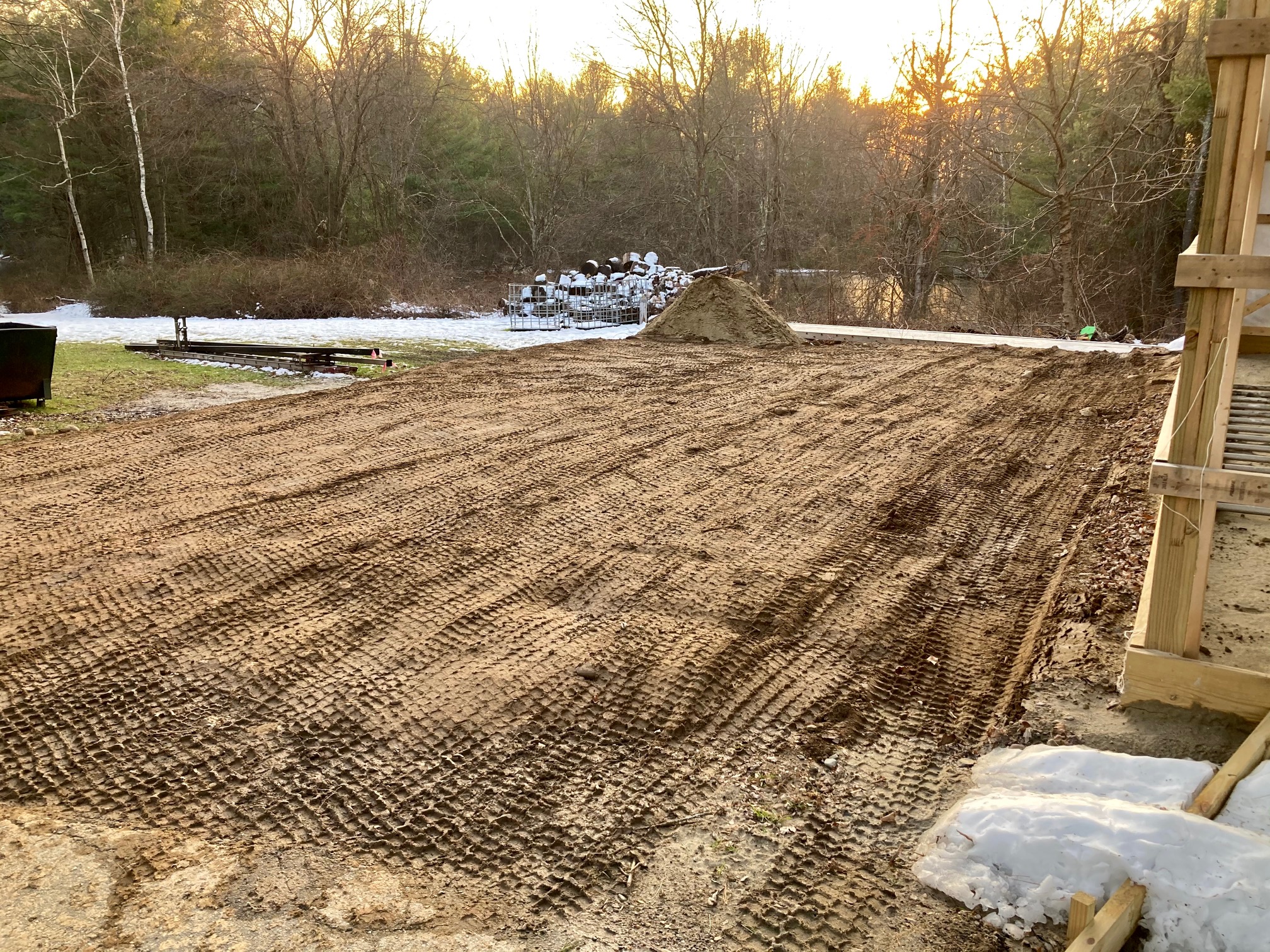

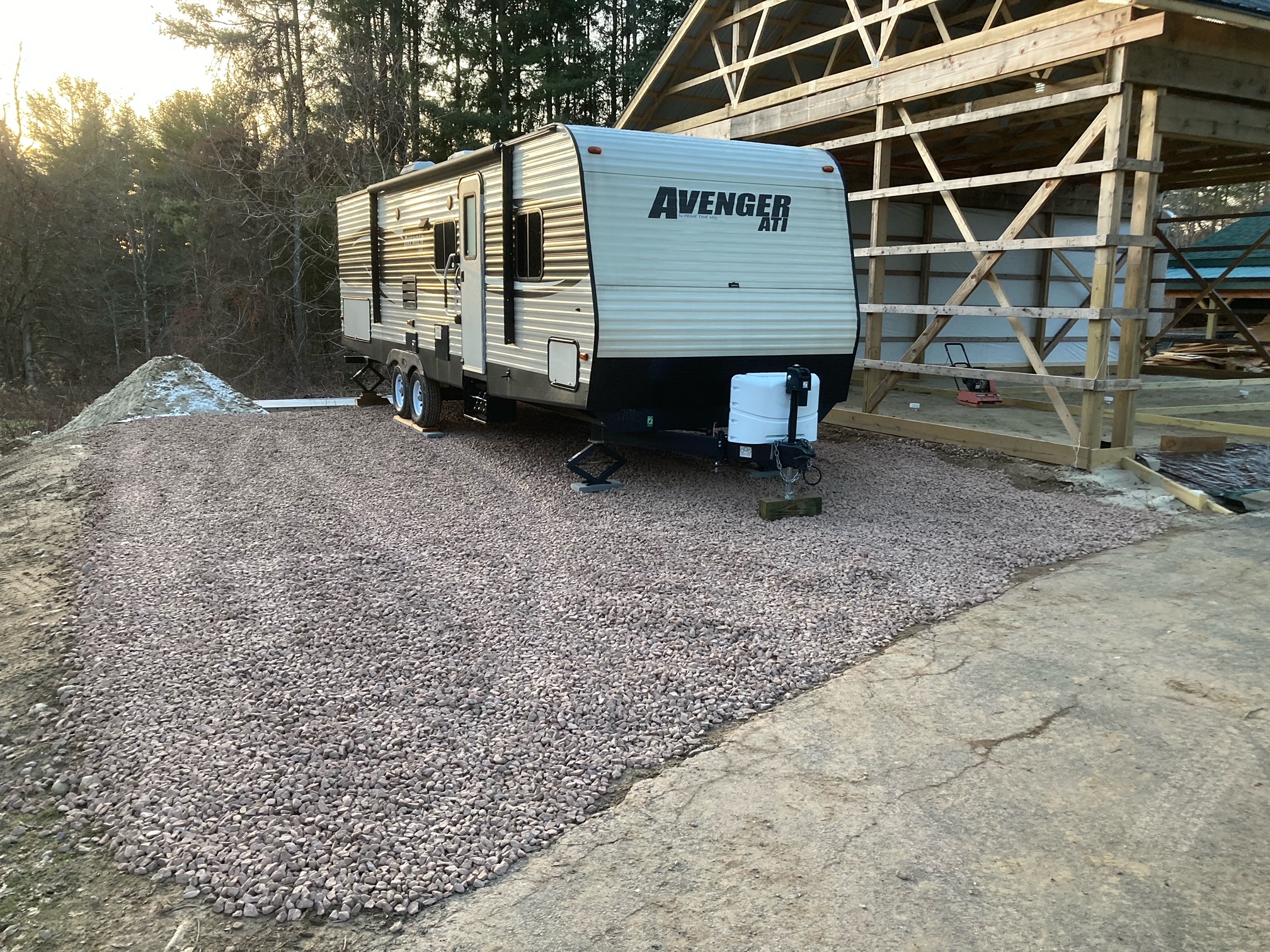

Well winter is here with a vengeance. Expecting 16-18" of snow tonight and tomorrow morning. We did not get a break in the weather to pour the concrete floor, so the pole barn progress is on hold until Spring. Very disappointed, but such is life.
We did level out that parking area on the south side of the barn this past week. Brought in 32 yards of fill to raise it up 18" or so and then 10 yards of 1 1/4" crushed gravel for the top coat, about 3" deep. We moved my father-in-law's RV to its new spot. Much better than being right in front of the house which is where it has been for 2 months. Once the barn is complete, we will add a 28x32 lean to shed over the parking area and have two 12x32 covered parking spots for a growing fleet of trailers plus a 4x32 covered space at the end for firewood which I store in IBC cages.
