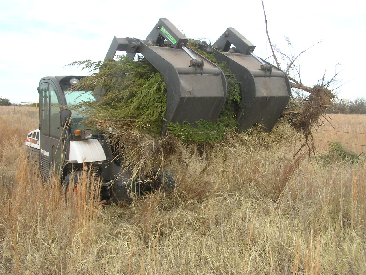

A FEL can do it all but not very well except moving material and even then a bobcat is faster and in some scenarios safer(expect some arugment on this). I have been a commercial landscaper for a long time and took care of my personal 5 ac for years(and transformed it myself). Yes i could have done it with a fel and a bunch of attachments, instead i did it and continue to work professionally with a few machines and a few attachments much more efficiently. BTW, i do buy used, always. these machines last thousands of hours and it is easy to find a used machine for sale by owner(stay away from dealers) that has low hours, since most people really don't like doing their own work. My fleet is a 4klb mini excavator with thumb(most used peice), small bobcat skidsteer with grapple on main bucket but also have a hydraulic brush mower for it , forks, a trencher and tracks. I also have a smallish zero turn hydraulic exmark finish mower, an older very large chipper and a stump grinder. Will a homeowner need all this, no but if you intend to make money of your place you can easily justify cost of used equipment and write off depreciation. I am a fixer and do all my maintenance and repairs and fabrication but most of these rarely break. I bought everything listed above for less that my friend bought a new kubota midsize fel with hoe and i can work circles around him.
as far as the danger thing that people will argue on skidsteer, yes they can tip, but so can any machine. At least in a skidsteer you are inside, plus use common sense and keep load low and follow the fall line of slopes and you may never even come close to tipping. in 25 years i have probably tipped skidsteer 3 times and an excavtor twice, never hurt. tip a fel and you are likely dead or injured bad.

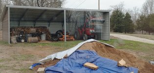

Congrats on purchasing yourselves a handy tool. It'll be well worth it when needed. We retired to central Mo 2 yrs ago. Ozarks are great. That said, buy what you can. Always said, buy the next size up. For me this holds true. April 2020 l purchased a MF1739. Great little tractor. Bought it out of Arkansas since no one local was close on price & they ship free in the USA. Also l have a MF dealer within 1hr. Our 53 acres is over 80% timbered. Id say mowing is close to 10 acres. I knew mowing weekly or so, l did not want those hrs on the tractor. So April 2020 l also purchased a 61" Scag zeroturn. Most of our property is sloped to some degree. I feel safer low to the ground. When you do purchase, my advice is to not consider any tractor that is not a 4x4. It's much safer on a slope with it engaged for braking. Not sure what dealers are close to you but consider service, parts, ect. I've been to our nearest once last fall. Though we didn't purchase there. They were good to work with as any NAME brand should be. Tractor came with a FEL. Currently 144hrs. Scag gets new blades installed next week. 115hrs. So our purchases came to $26k
Tractor 20k
Scag 5k
Box Blade $700
Like most have said, go look. Don't buy from the first place. Shopping around you learn alot. Enjoy your hobbies...

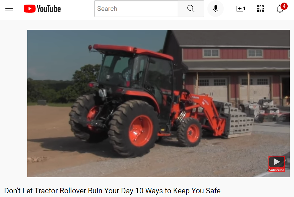

Another good thing about the Toolcat is not having the pivot on the front axle.
Don't have to worry about this:
It has independent suspension with rubber stops:
