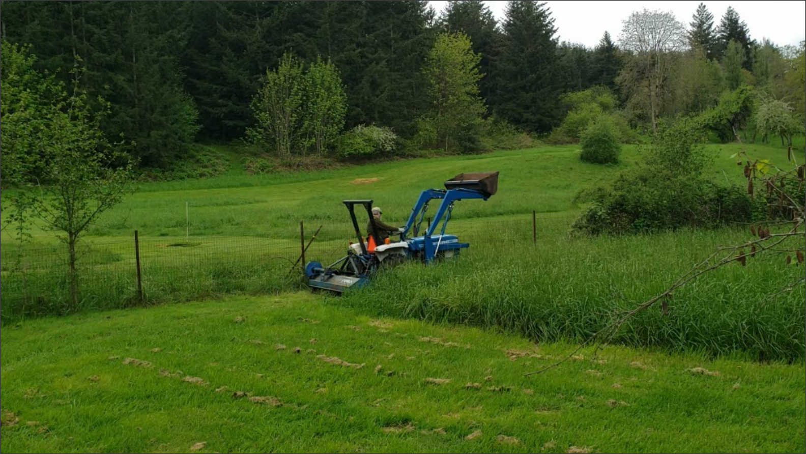

We have lived many years on similar size property, not too far away from your location and for us the most useful tractor attachments are:
PTO wood-chipper, flail mower & rototiller.
However the little cart I made for my old garden tractor & ATV is indispensable since we are using it to haul all kinds of material frequently.
It was meant to fit in tight spaces, easy to unload & handle a pretty heavy loads and works well for intended purpose.
PS. The ground has been too wet lately to go to the field for mowing, that's why the "grass" was way too tall when I finally mowed it two weeks ago!
