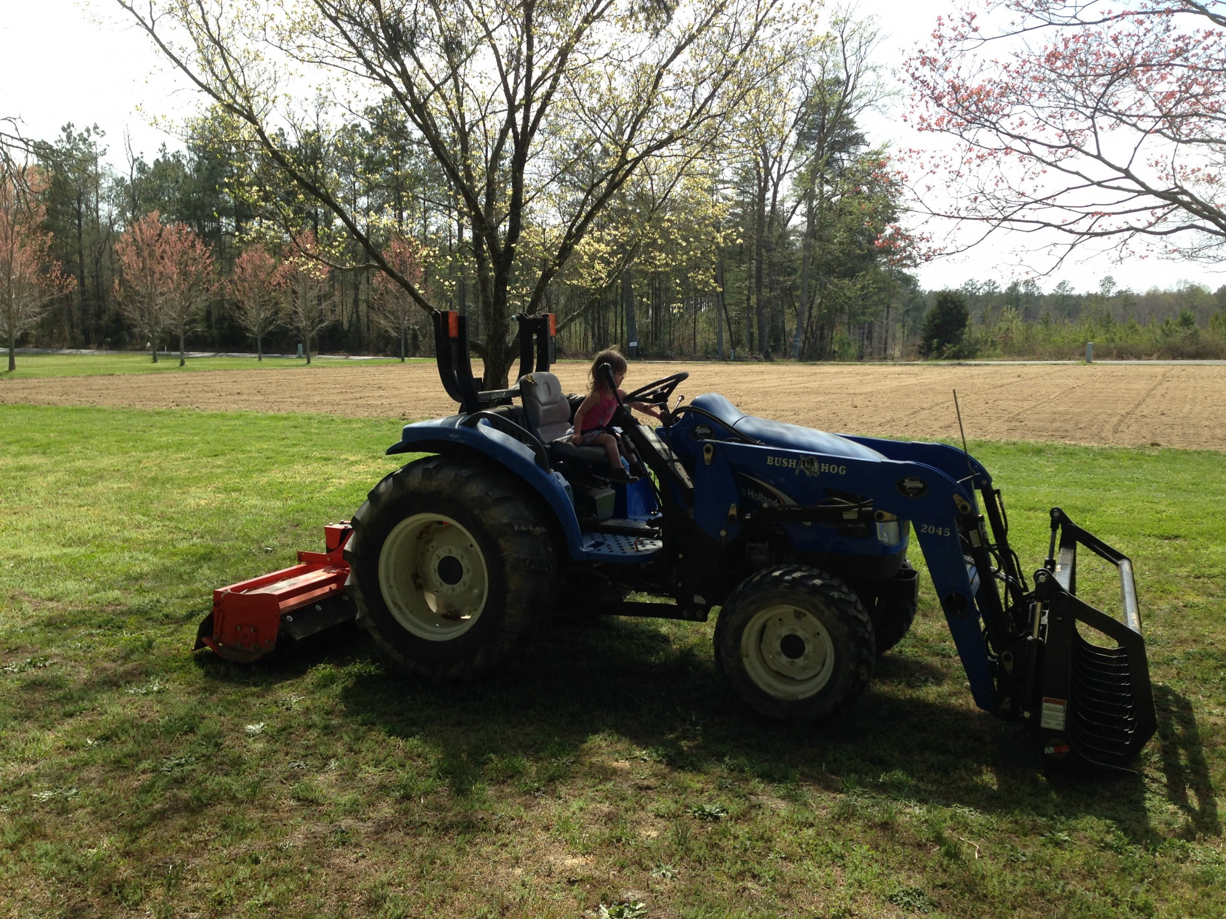

I wish I knew about this site when I bought my tractor, but I wasn't looking for a tractor. I have 1.6 ac on a hill with a dirt bike track. I was looking for something to mow it since I flood almost every year and by the time the water goes down the grass is 5ft tall. Well I listened to the JD dealer I was at and said I only needed their 1023 tractor. Well I like having a tractor but it's under powered and dangerous for my yard. Many a time I have had tires up in the air. I use the brush cutter as counter balance. I only travel with dirt in the bucket a foot or two off the ground. It also does not have the power to move existing dirt/clay/rocks. I hit the mound and it stops me dead. Not enough weight or power. My 23hp mini needs to be closer to 45-50 hp. Mowing the 5ft grass clogs and stops my PTO.
You have an idea what you need a tractor to do but once you have it you will be surprised how many other projects will pop up including neighbors yards. I'm up to 3 yards mowing. Don't forget the wife saying now that you have a tractor can you do this...... for me.

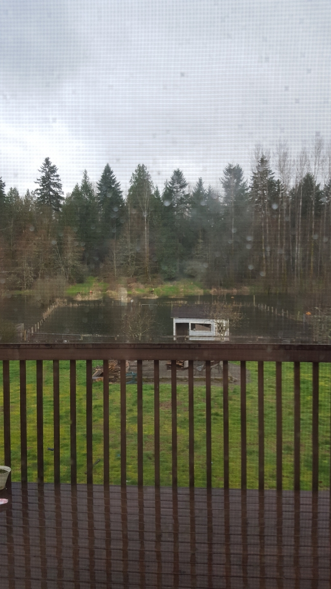

I've recently purchased a six acre horse property. Previously we were at boarding facilities but now with our own land I'm going to need equipment in order to take care of the numerous other property maintenance tasks. Definitely not something I want to try and handle with a push mower, wheelbarrow and a shovel, heh. The property is on a hillside with about a 200' elevation change from bottom to top, so there is some slope to work with though it's nothing too serious. Rough guess and an online calculator says 17 Degrees but I'm not sure it's actually quite that bad, that's likely worst case. I'm a first time tractor buyer and it looks like the only close tractor dealer is Kubota. I've done some preliminary research online as well as talking to the contractor who put in our perimeter fence about what kind of equipment to buy but I'd like to get opinions from you folks. Deciding between a BX, B, LX or L series tractor isn't an easy choice. I've tried to lay out everything in terms of capabilities:
NEEDS
1. Mowing all the non-pasture areas, maybe 2 Acres worth. Possibly also some pasture mowing if they sit too long unused.
2. Moving gravel. We have decent drainage since we're on a hill but it's Western Oregon and we get a lot of rain. Add in big horses and you get mud.
3. Maintaining the steep gravel driveway. Need to smooth out ruts and keep it drivable.
4. Some ability to deal with snow so we can get in and out of here in the winter. We don't get a ton of it, but it's enough I need at least some capability.

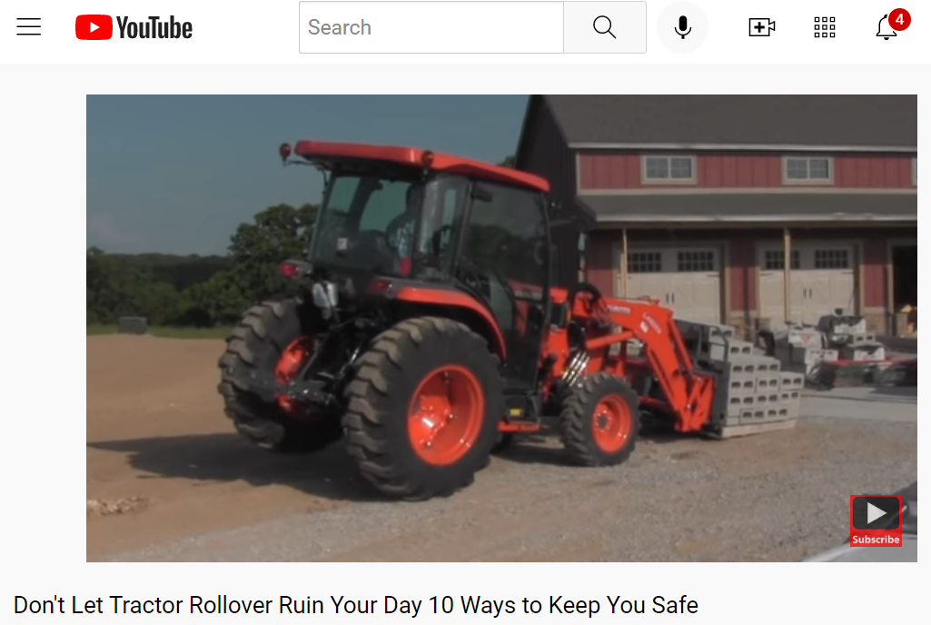

I have a cousin who has farmed all his life. He bought a used tractor that had been specially made for the highway department for right of way mowing that had unusually wide spacing and was lower to the ground that most other tractors. So he's out spraying his hillside pasture with this tractor, and then the axle broke on the spray rig. The shifting weight was enough to send his tractor rolling down the hill. He got air flighted to the nearest critical care center...had a rough recovery.
Tractors and hillsides need to be treated carefully. Even then, things can go badly wrong.

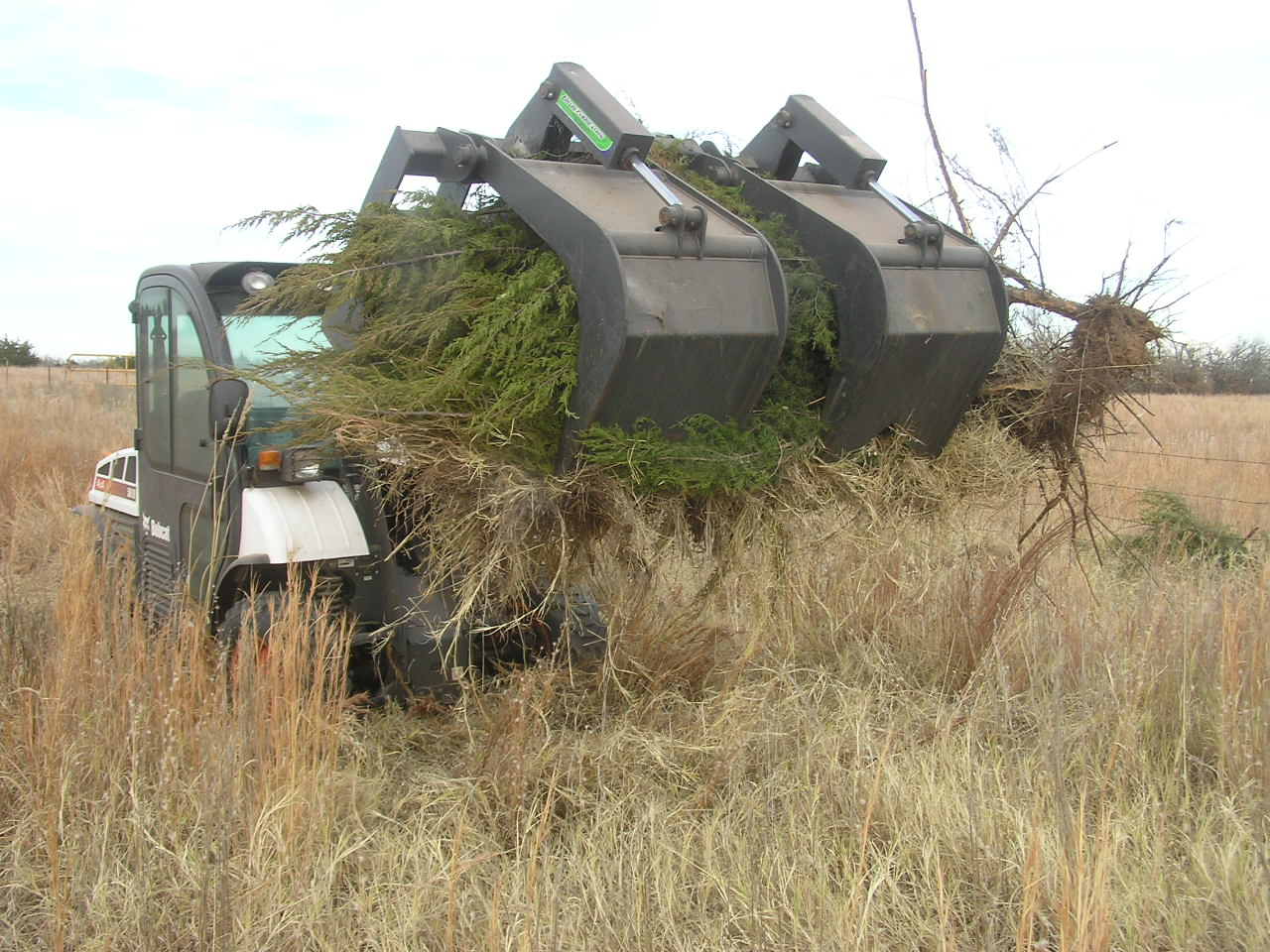

I love my finish mower and don’t care if it takes me longer to mow. I get to sit in the AC, on an air ride seat, out of the dust listening to the stereo. When it’s 100 degrees outside I’m feeling pretty good in my cab.
Another good thing about the Toolcat is having the 6' finish mower out front:
The view from the seat in the air conditioned cab:
