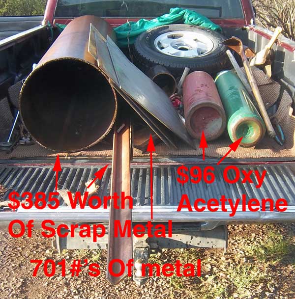

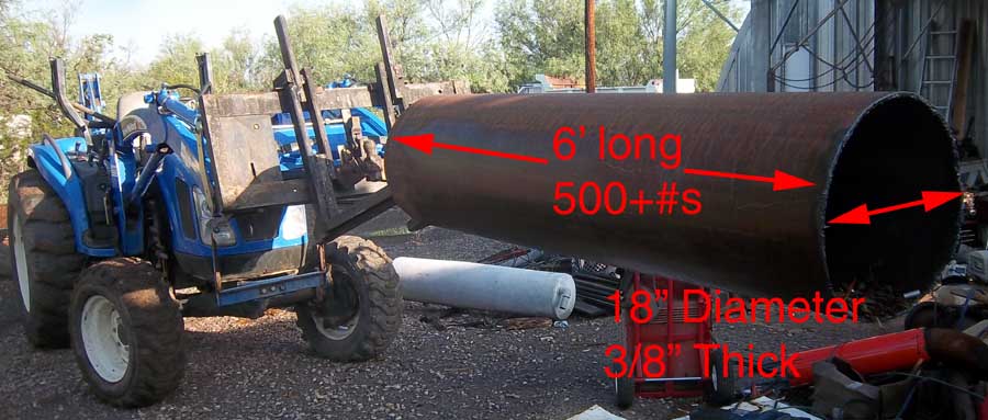

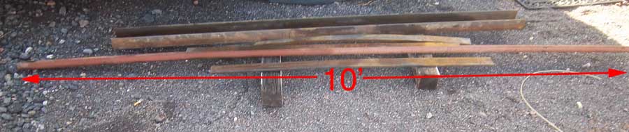

WOW!! The price of metal has gone out of sight.
701#s Came to $385, $10 of that was cutting the pipe to 6'.
Acetylene price is gone nuts as well. My medium size tank $ $86 including sales tax. Oxygen tank is $10 if filled on Tuesday or Thursday. Other days its almost $40.
It's a guess, but I think the 6', 3/8"x18" of pipe weights around 550#s. Guessing again, think when done and filled with water, roller will weight around 1,100 #s. Too much math for me. How about 1 of you folks good in math giving it a shot.

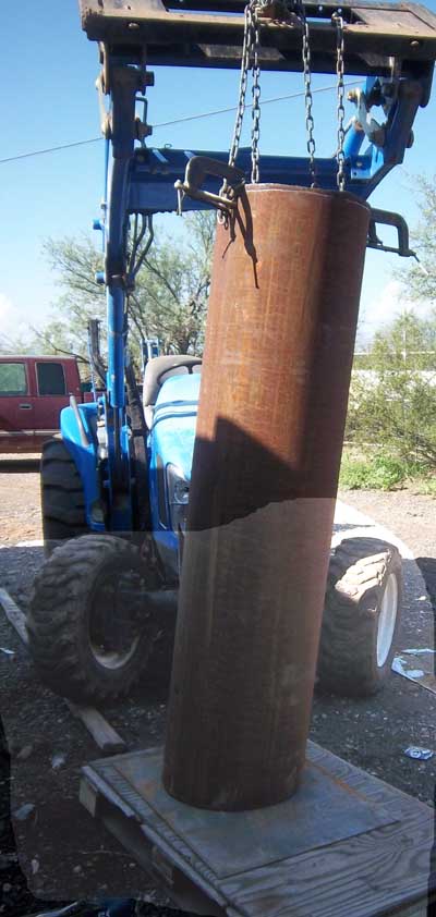

Now I need some Suggestions. The ends of the pipe are cut crooked and need to be trimmed straight. Tried wrapping a 2" wide strap around the pipe, but mark was still crooked. Am thinking maybe using a dry wall square may help. Too much cutting to screw it up and still be crooked.

I get ~950# weight of water only. For square cut, prop the pipe up dead vertical in a puddle or pan of water, mark the water line, measure to move the line close to the end?
Jim
   / NEW ROLLER & SHEEPS FOOT - ON THE WAY #56
Now I need some Suggestions. The ends of the pipe are cut crooked and need to be trimmed straight. Tried wrapping a 2" wide strap around the pipe, but mark was still crooked. Am thinking maybe using a dry wall square may help. Too much cutting to screw it up and still be crooked.[/QUOTE]
Use a peace of card stock at least 6" wide and long enough to go around the pipe 1 1/2 times. Rap it around the pipe and square up the straight edge.
E/S

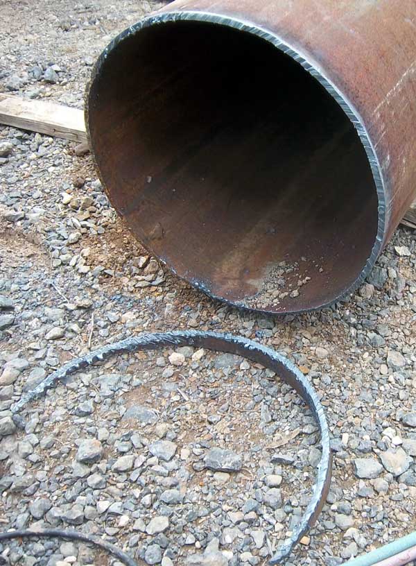

I squared it up the hard way. Stand on end, shim until square with steel plate. Make a marker and drag it around the pipe while its setting on the steel plate. Cut went from 0 to 2" and I am pretty happy with my cutting. Had not fired up the torch in over a year. Pretty clean and straight, very little slag and only a tiny little place needed another shot. Even managed a little angle on part of it. Will do a little grinding, set back on plate to see if more is needed

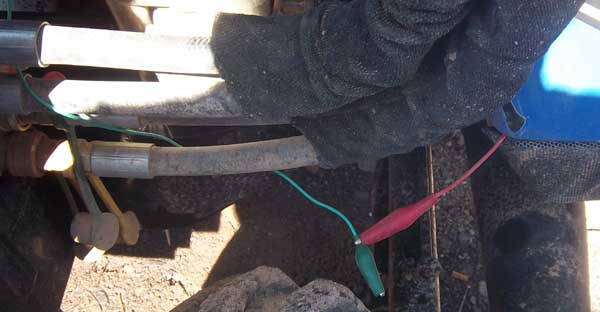

Would have got more done, but had a little tractor trouble. 2 Hours of trouble shooting and testing things. All said and done, I think part of the key switch has gone out. Run a jumper from battery to the injector and it goes. Will do a real fix next week :laughing::D

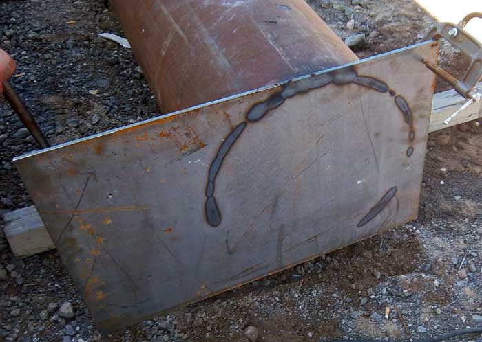

Little over an hour grinding down the end of the pipe and chamfering the edge. Set pipe back up on steel plate, check to see if it sits straight. Near perfect on straight. Put in some heavy tack welds and lay back down.
Laying it down was a mistake. Hard to roll with the square plate sticking out. Far too much out of position welding for me. Stand it back on end and finish weld. Lift it up in the air about a foot and fire up the cutting torch.
Today's cutting not a pretty as yesterday. Cutting through welds and slag as well as the metal makes it a little more of a challenge, Before grinding, I'll touch up the cut some with the torch. Once all the grinding is done, a final weld, that I hope comes out looking good.
End #2 can be marked by measuring from the first end. Guess that will be tomorrows goal. Mark, cut & weld end #2.

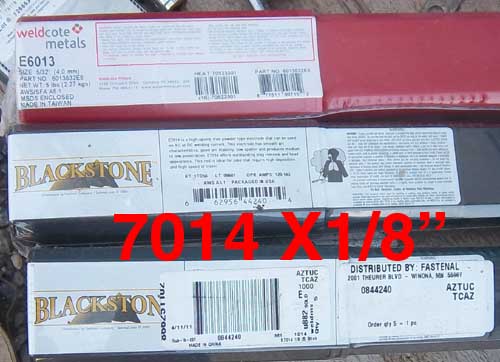

I really like the 5/32 "WeldCoat" #6013 rod. 145 Amps and just stuff it in the crack. Some of the welds even looked like I knew what I was doing. :laughing::thumbsup:

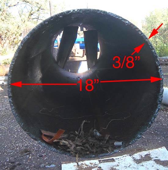

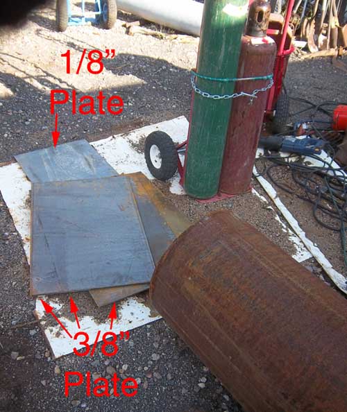

Sure would like one of you math experts would figure out the weight of the 18"diameter X 71" long X 3/8" pipe. I can't do formulas. Tried the one on the link below and nothing seems to come out right. End plates (X2) are 3/16" thick by 18" diameter. If you don't mind throw those weights in as well.
Calculating Pipes Weight
Down the center of the tank will be 2" pipe (outside diameter 2.37", wall thickness .37" x length 77". Link says it is 10.79 per foot, but that does not sound quite right to me. :confused: :mur:
Thanks to anyone that does the math and / or tells me how to do it myself.
My Guess to mation is about 675 pounds total, including the bridle.:mur:

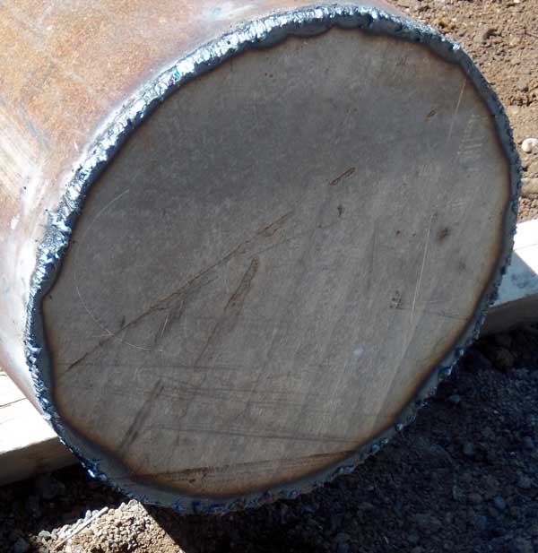

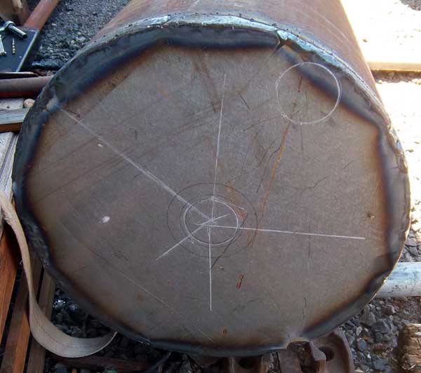

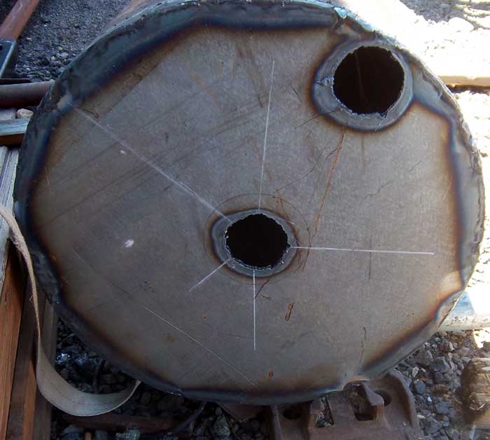

End #1 was ground down, ground out for a welding channel and then welded. Welding came out pretty good. Good enough that it will not be ground down, just left as is. It would have been better had I made the channel equal depth and width.
Got the solid end marked and cut out for the water fill and axle. The end did stay flat and not puckered as it looks in the picture. Needed to have the center hole in order to stand the pipe on end. Will get other end on and welded tomorrow if possible.
A 2" pipe will go all the way through the pipe and get welded solid on both ends. Axle will go all the way + another few inches, then bolted solid to the bridal.
