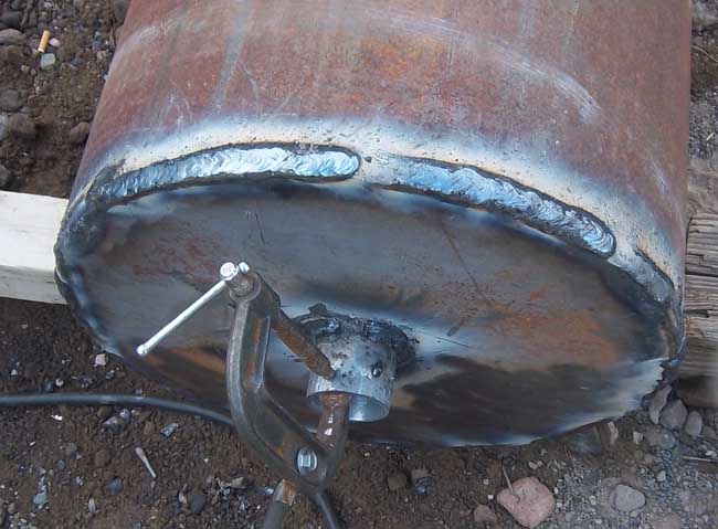

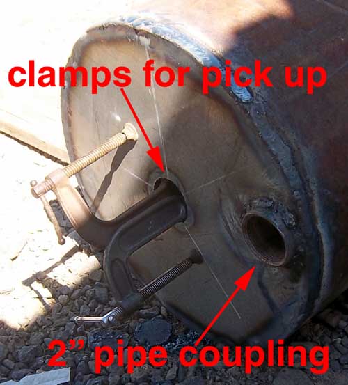

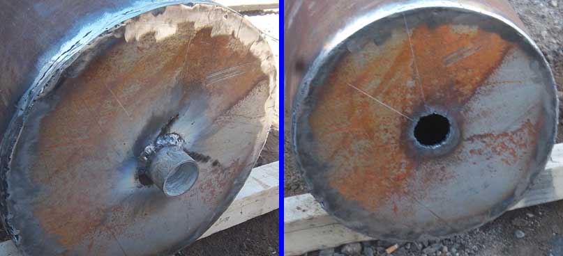

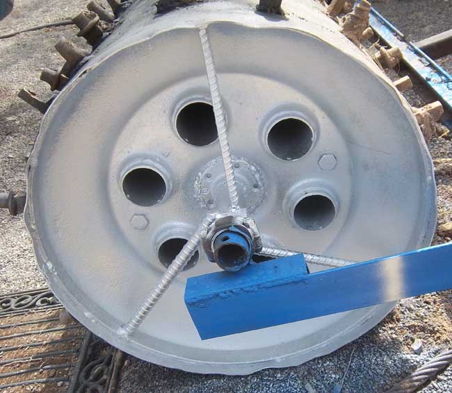

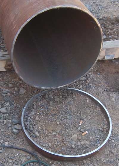

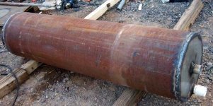

Used the torch to clean up the 2 holes for axle & water fill port. Ground all the zinc off the pipe coupling, had a nice snug fit. Just a little hammering and in it went. Welding went pretty well, a little build up where the welds overlapped.

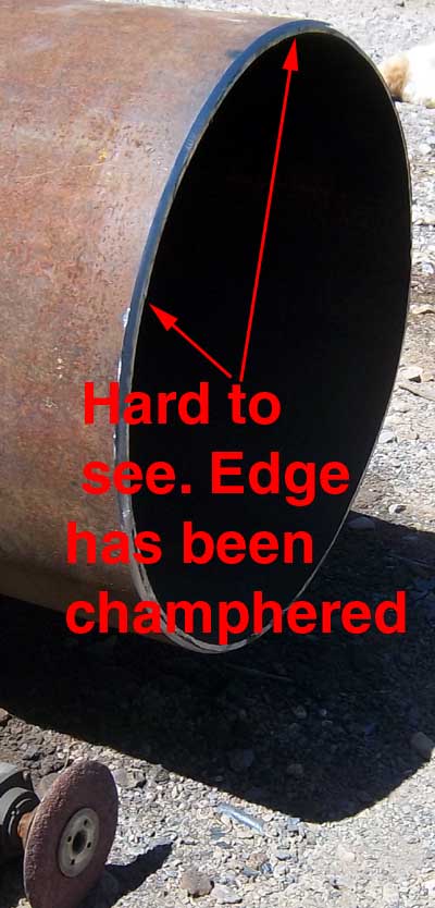

Once a fairly square and straight line was made, time to cut. Just as I was getting the torch out, a thought came to me. Why not try the angle grinder with a slitting disk. A lot slower than the torch, but a nice clean cut that does not need to be ground down. That worked out pretty well, slow, clean cut and almost no grinding. Wanting a good angle on the end spent quite a while grinding that. Sure did make me want a 7" grinder. :)
Cutting the end off the pipe took 2 slitting disks. HF cheepies. Grinding was 1, 24 grit sanding disk and it is still useable. The sanding disk is a lot faster than a grinding wheel and lasts almost as long.
A little more on Weight. My crummy math has come up with 434 pounds of pipe weight and 27 pounds for the end plates. AM I CLOSE??? :confused:

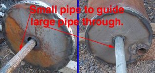

A few small steps today. Most everything just takes more time than 1 would think. ( A better welding person would spend a lot less time grinding. :thumbsup: )

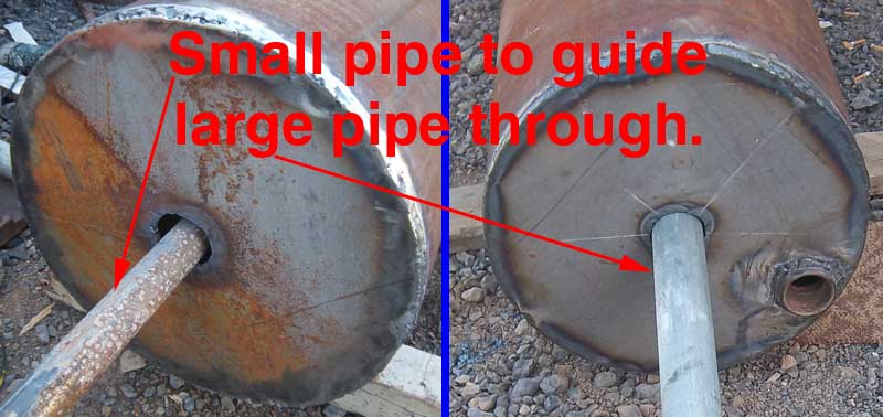

End #2 got its hole burned and fit to 2" center pipe that runs all the way through the roller. Used a small pipe to guide the tight fitting 2" center out the far end. 1 End of center pipe is welded.

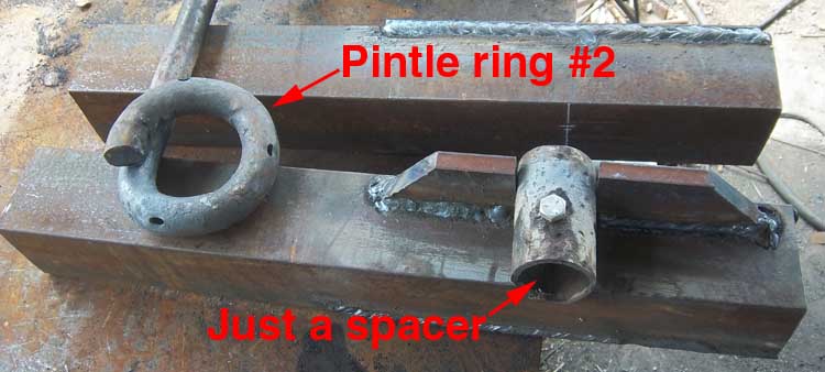

Some dummy didn't think. While the forge was fired up and rod hot. He only made 1 ring for the pintle hitch. That guy is in trouble if I can find out who didn't do it. :D

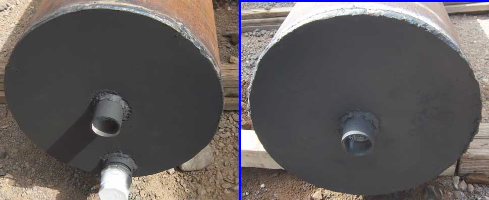

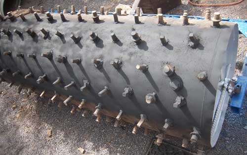

Yesterday. Welded in the center pipe, Second pass around one end. Filled it with water, Had a small leak around the center pipe. A first for me, welding something wet. First tried to weld it with the pipe plugged, bad idea, steam blew through the weld. Dump a little water out and remove plug. 2 More passes and got it done. Could not get a steel 2" pipe plug at "Lowe"s". Just to keep moving got a PVC plug. Will have to put a steel plug in later.
Today - Had a little breeze and it was almost cool, so I fired up the Forge to make the Pintle Ring (Lunnette) that should have been made the first time. Of course the breeze was blowing the heat & smoke right at the crank. Managed to burn my thumb a little past blistering. Keeps a person busy, cranking, banking the fire, keeping the iron in the fire, then doing the bending. Some day I will hook up blower to the forge.
Put 1 of the " Mag Wheels" on the sheep's foot. :laughing: Threw a little paint at things. Since the pipe (Guess its a "Tank now.) did not leak, painted the ends, a little more on the sheep's foot & a hint of blue on the bridle.

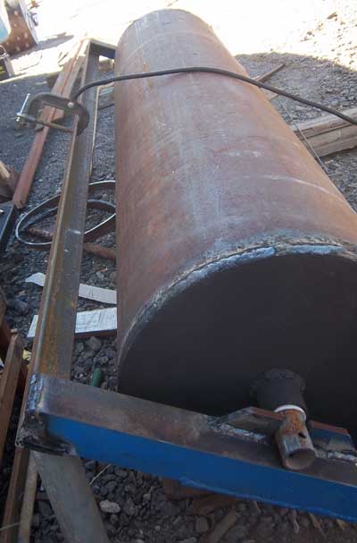

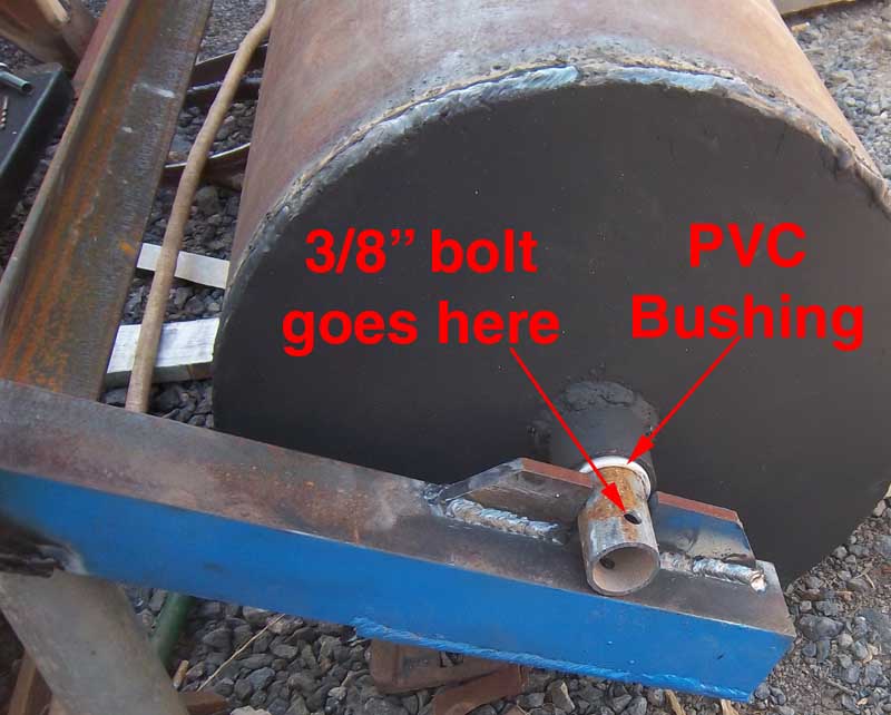

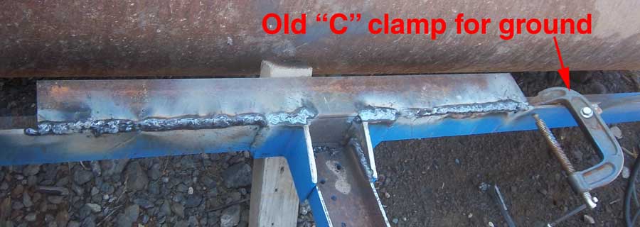

Got started on the bridle for the roller. Picture pretty well tells that story. Boxed in about 10" on the ends of the "L" angle iron. The 2 wedge shaped blocks hold the axle from moving under load, 3/8" bolt just holds the bridle in place.

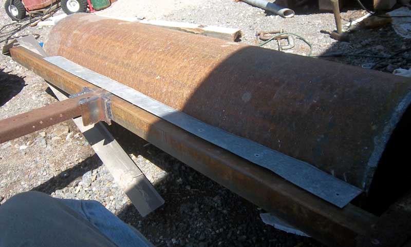

Hopefully tomorrow I can start dragging this thing around. Give it some abuse and see if anything breaks or it springs a leak.
There are 3 PCV bushing on the axle, 1 each end & 1 in center. With the 2 bridle ends over 6' apart the 2 end pieces were leveled up in order to drill aligned holes on each end of the axle.
Left to do - improve corner welds on bridle, make & attach tongue & ring. Cut PVC plug short enough to clear bridle.
If there are no real problems, I'll throw some more paint at it. Need to do the same with the sheep's foot. Find weak spots, fix and paint.

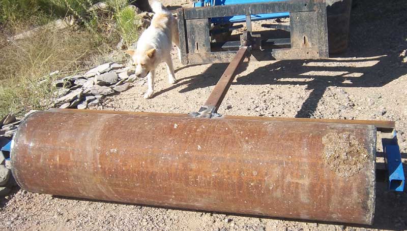

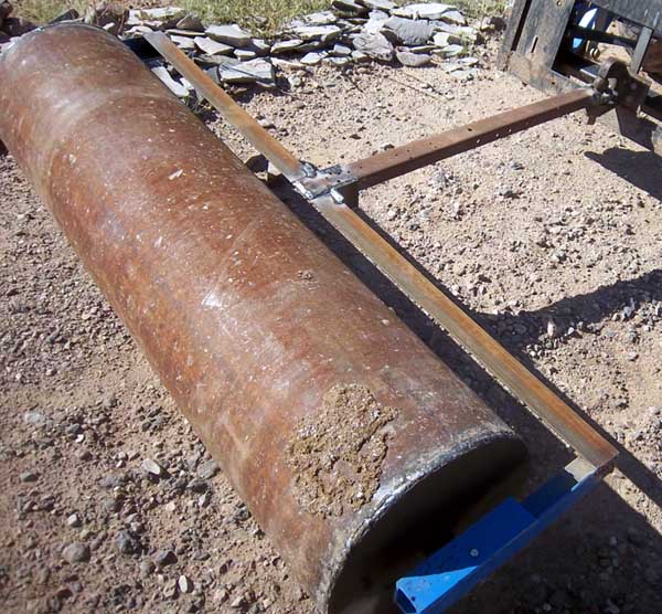

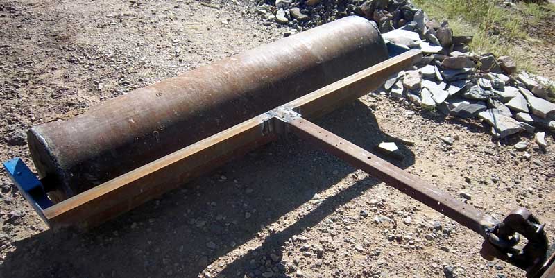

At last it Rolls. - :thumbsup::thumbsup:
Not saying it is finished, but the real work is done and it can be used. A few little things to do, plus Paint. :laughing:
Pushed & pulled it around the yard for 2 Beers :licking: and I was just sipping. Only a few hundred yards. Good things, nothing leaked or bent. and its rolls pretty easy.
May have a little flex in the front center cross bar. Will add something to it, just in case. Need to get a steel 2" pipe plug and replace the PCV plug. PCV will snap off on the first big rock. Rest of the work on it and the sheep's foot is mostly ginger bread type of stuff :thumbsup:

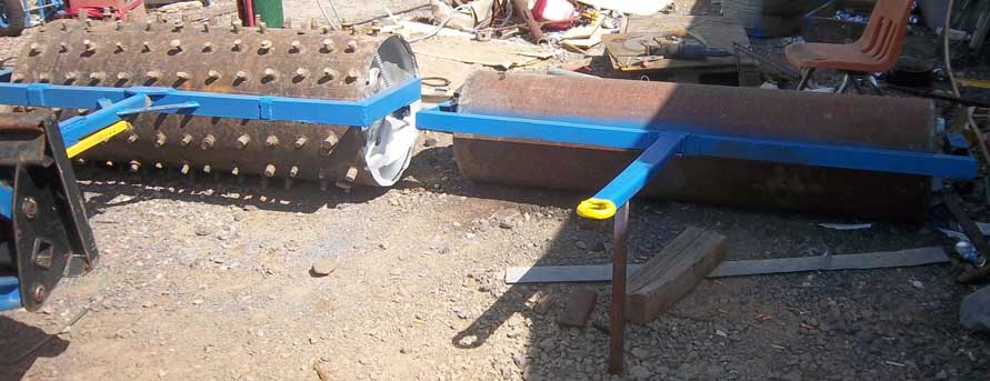

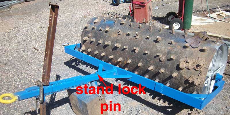

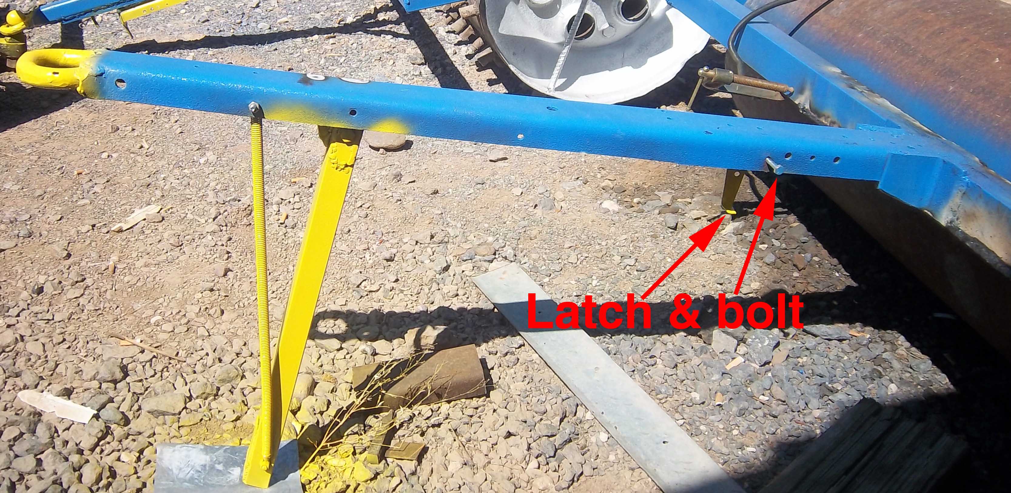

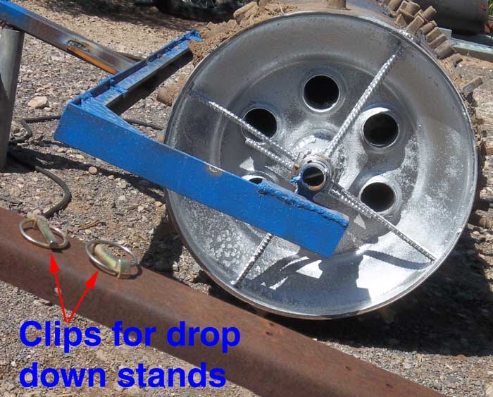

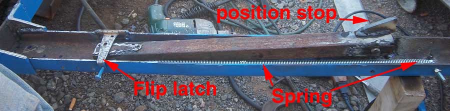

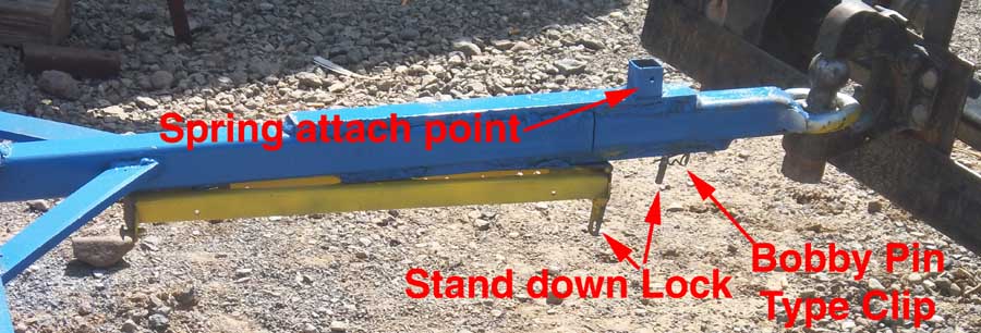

I want simple "Drop down stands" on the tongues. They don't need to hold much weight, just the tongue. They need to stand fairly high, so the rings are easy to see when hooking up. Only gave the roller ring about 1/4" of clearance, 1/2" would have been better for hooking up.

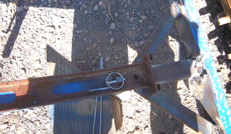

Plan on Over Center springs to hold them up and down. Then a clip of some type for positive lock. You can see the one on the sheep's foot, folded and down. Have to see what kind of springs and clips they have at the hardware store.
Am thinking maybe put a scraper on the roller. It can take what looks like a dry dog dropping and make it as large as a cow pie. Of course it sticks to the roller.:mad:

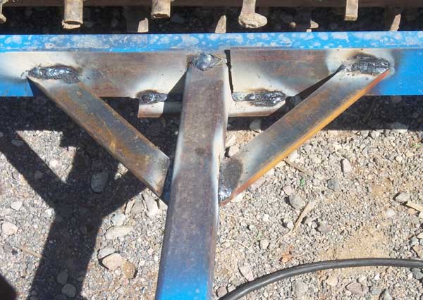

Touched up a few welds and added the braces to sheep's foot tongue. That's about it as far as real work goes. Both are usable as is, so the tongue stands and a little more ginger bread type work is about it.:thumbsup:

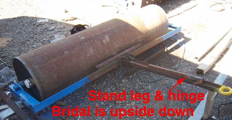

   / NEW ROLLER & SHEEPS FOOT - ON THE WAY
#68

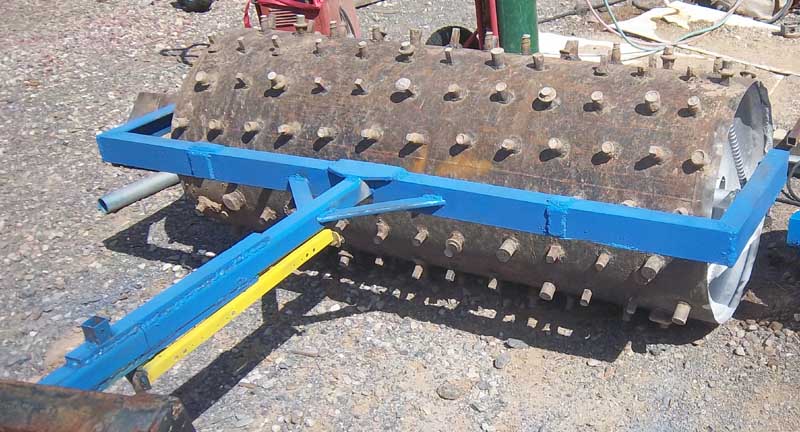

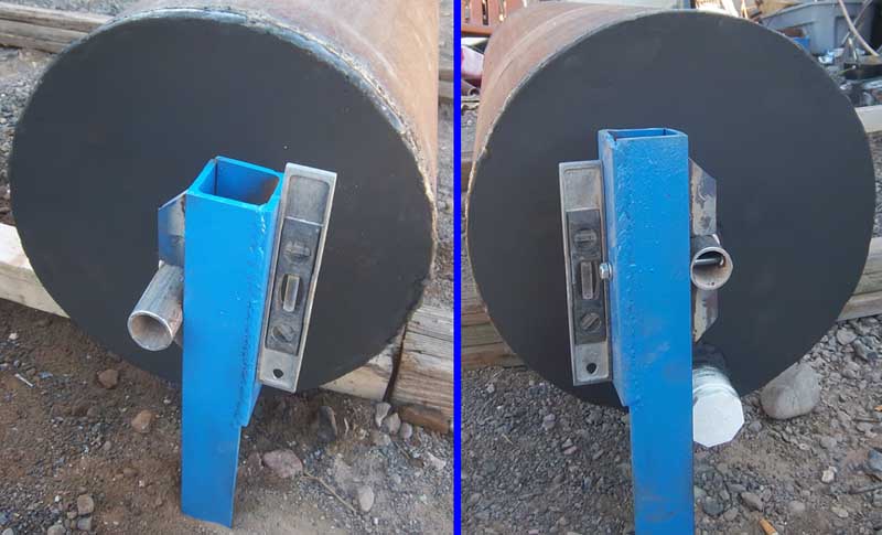

The end is in sight - At Last - :) Building these guys has turned into a career. At least both of them could be taken to a job site if need be. :D
If I had the springs for the tongue stands, most everything would be done. Need to stiffen the front cross bar on the roller & a small foot on roller stand. Keep looking at my junk pile and just can't see anything that looks right for the stiffener. Once the springs are installed, its mostly a little grinding and paint.
I'm working on a list of the does, don't does, could have or should have done. How to make the build better, faster & easier.

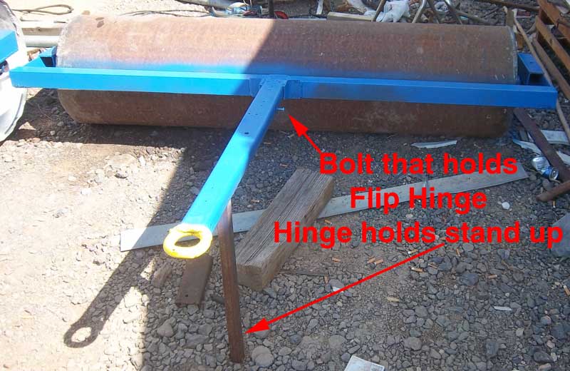

#70
Dang Jim. Those look store bought.:thumbsup:
hugs, Brandi
Brandi, Thanks for the flowers. Would look better were it not for my Red Neck ways. Keep throwing paint on it here and there. Sure makes the bad spots show up.
Moving right along. Got the folding stand pretty well done today. It does work, may move the front spring point for a little better tension when folded up,
Boxed the center of front cross piece, should be a little stiffer now.
Stand took too much time, lots of fiddling around to make it work. More sanding, grinding, painting & maybe some welding. Want these 2 guys parked where I can't see them for a few days. :):confused2:
