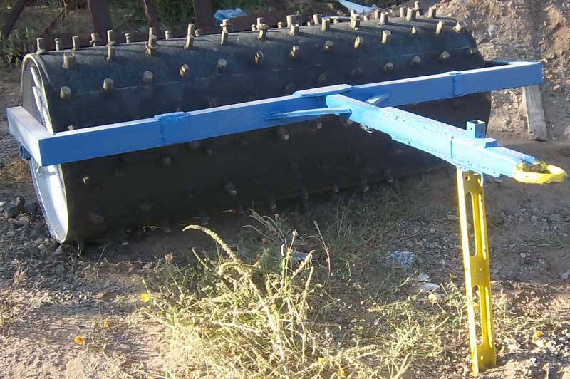

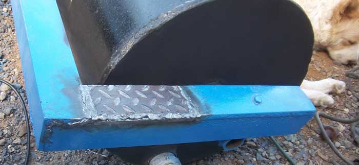

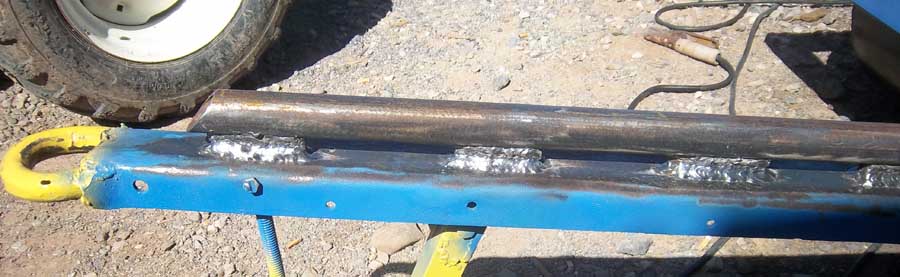

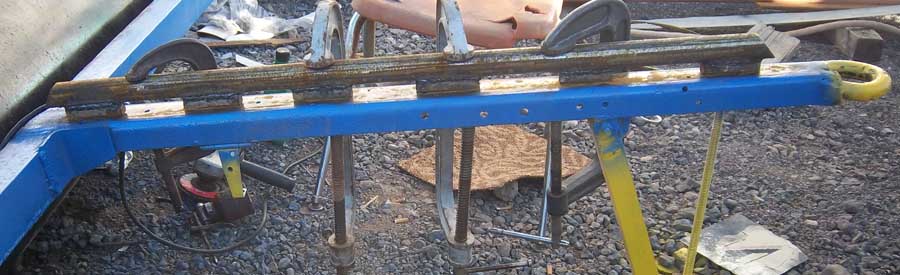

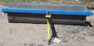

Well this build is pretty well wrapped up. Sure feels like it took forever. 8/16 to 10/6, includes time wasted on a bad tank.

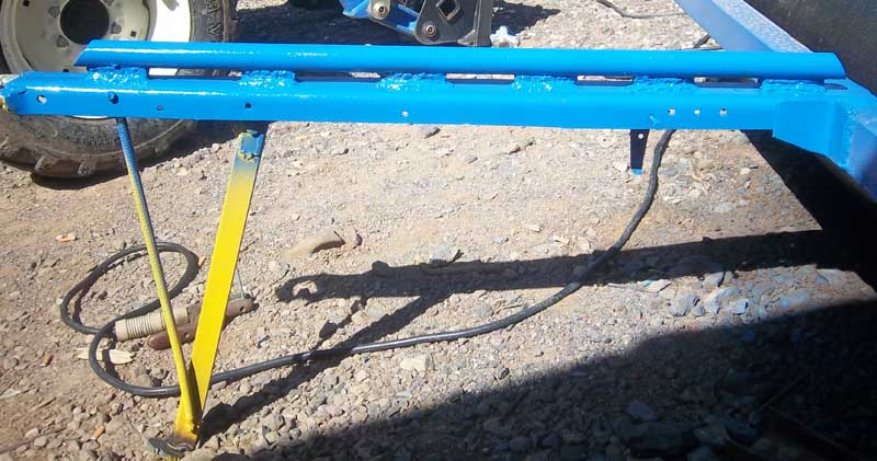

Both roller and sheep's foot have about 3 hours each of banging around. Tongue on roller was a little too limber when it came to 6" or so rocks, so a stiffener was added. Still have a tiny bit of give in the bridal, but not enough to do anything about. Maybe stay away from big rocks. :D

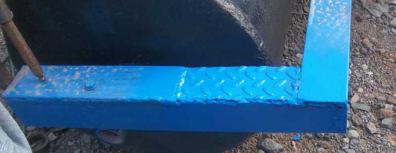

Filled in a gap with some diamond plate. Gap looked bad and the diamond plate was just about the right size. You can see in 1 of the pictures that the "Inspector" has given up on me. :laughing:
Fairly happy with most of the build. In a few days I will get into how to do it better and faster. Or with a well thought out plan and the right material how I would have done it.

Sheep's Foot -summery
A couple of minor little things planned. Add a 1.5" pipe plug & coupling to make water filling & draining easier. Mount springs for drop leg tongue support.
Building cost.
Having almost all material used in the build, out of pocket cost for material was nil.
About 15# of welding rod $45 Electric bill went up around $125
If metal had to be purchased at today's prices ( Used or Salvage ) .55 per pound. Around 500 pounds ( give or take a little ) $275. The feet are not accounted for in the 550#. A local guy sells 2"X20' drill rod for $40 each. 3 Would make about 290, 2" feet and at 6" spacing should do the job.
Buying all material used in the build, welding rod & electric comes out to $525
Likes & dislikes = Used 5" spacing for the feet. 6" would have been better.
If building another 1, Feet would be made from 2x2x1/4" "C" channel iron. Cut to 2" length's and spread slightly into a sort of "M" shape. The slight slope keeps kick out down when the feet come out of depressions. And a lot less welding.

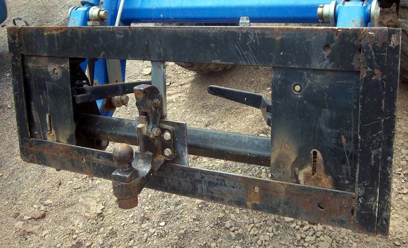

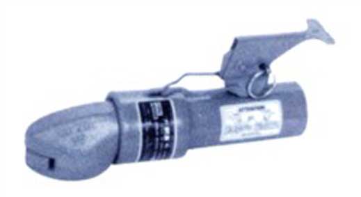

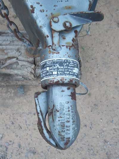

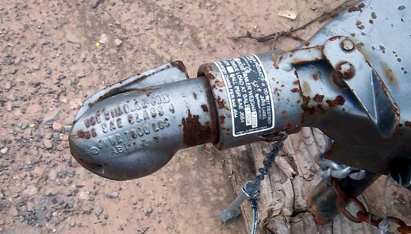

Pintle type hitch is the way to go. Next best would be a "Bull Dog" type. A normal trailer hitch is not going to hold up very long, as when pushing there is only a small bolt holding the hitch on.
When thrown together as a roller several years ago, stub axles were put on. They have held up well and I picked the tank full of water up with them. But if starting fresh a through axle as used on the roller would be my first choice. Spindles & bearings could have been used as I do have them laying around. Just my way of thinking, but that would be a waste. If the aluminum bushings don't hold up they will be replaced with brass. No signs of wear after about 3 hours of use.

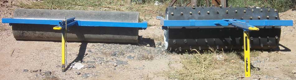

Out of sight = Out of mind.
Just in the thinking point at this time. No a plan as of yet. Would like to hear your thoughts.Good idea / bad idea??
Thinking about selling either one or both roller & compacter. Next idea is renting them out. Next is to offer custom made rollers & compactors.
If you were in my area would you buy 1 or have 1 built?? What do you think would be a fair selling price. Heavy material like these, plus welding rod, paint, supplies & electric comes to around $500. Now that these are done, I can see better & faster ways to build them. But any way you go about it there is a lot of work in either one of them. :confused2:
A few little things left to do. But for now I'm going to give them a rest, OK, gona give me a rest from them. :laughing::thumbsup:
In a week or so plan on finishing up the clearing & cleaning of my flying field. May have to put a faucet out there, stubbed up the water line when I put it in. So that will be fairly easy. 2 Days after a big rain, dirt is still too dry to work.
Now that they are done, sure would like to hear what you folks think.

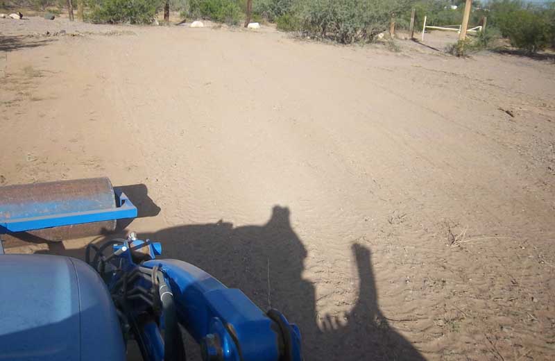

Weight of the watter is 1400# rough, does not count the wall thickness or the loss of the 2" pipe in the center. Add the metal weight; are you sure your tractor can pull that through soft dirt?
Hi SeaBee,
Thanks for the thoughts & concern.
Seems to have plenty of power. Been pushing & pulling both Sheep's foot & Roller quite a bit. In the picture is a pile where I had been cleaning out a drainage ditch. Pushed & pulled over the pile and several big rocks, Pile is about 2.5 feet high & rock over 6". Have not had to go over 1,200 RPM yet. Got a couple of steep, but short banks to try it out on. Want to see if it drives the tractor or not.
