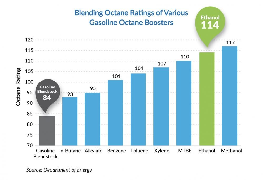

Ethanol is nothing more than an Octane Booster. Raw gas, RBOB blendstock, doesn't burn well in a modern internal combustion engine. Well, it might run but you wouldn't like it very much. Especially once the engine got hot-ish.
Raw gasoline doesn't have the octane. Burns great, combusts just fine. Everywhere. Often, before it gets to the combustion chamber. And when it combusts inside your manifold, bad things happen.
That's why they add alcohol, Ethanol, or something.
