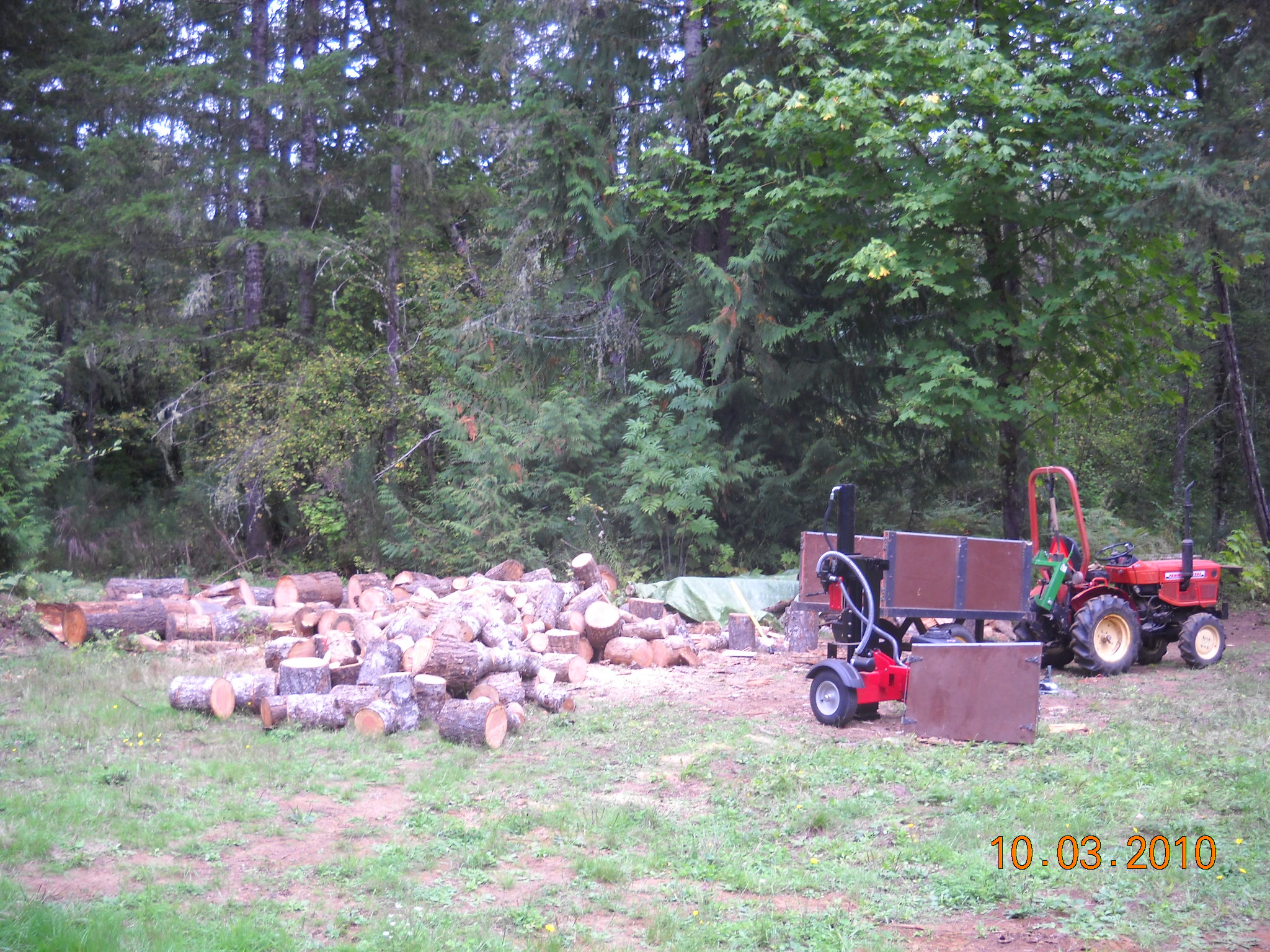

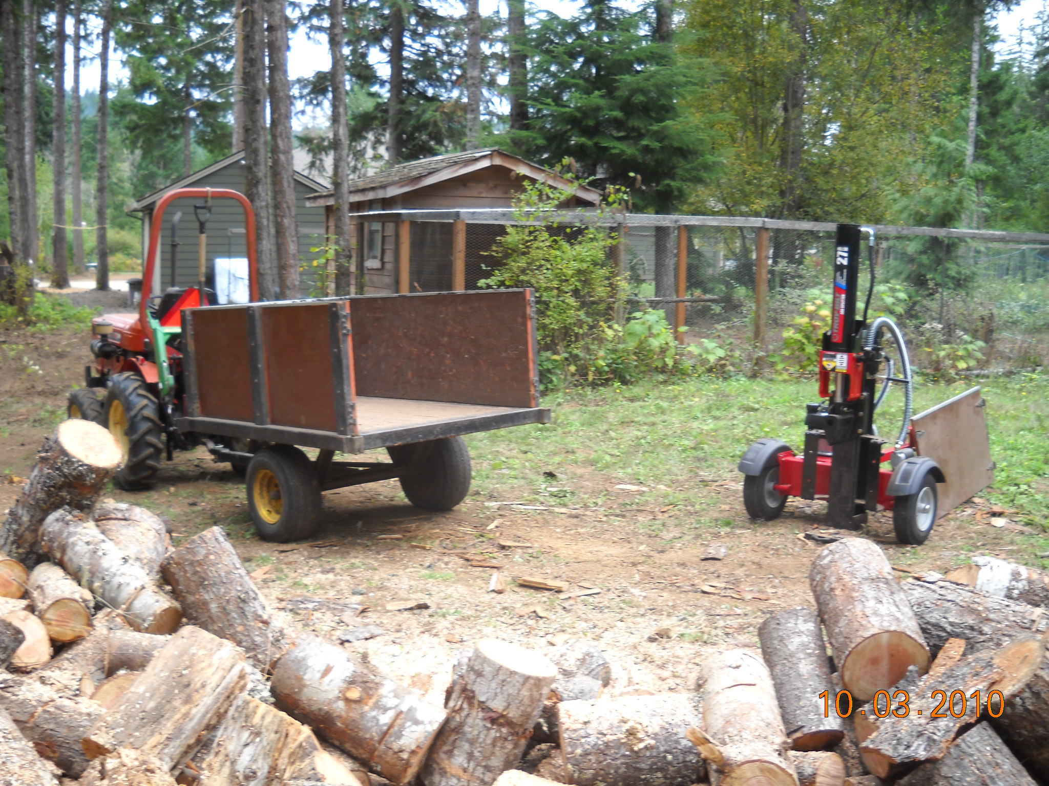

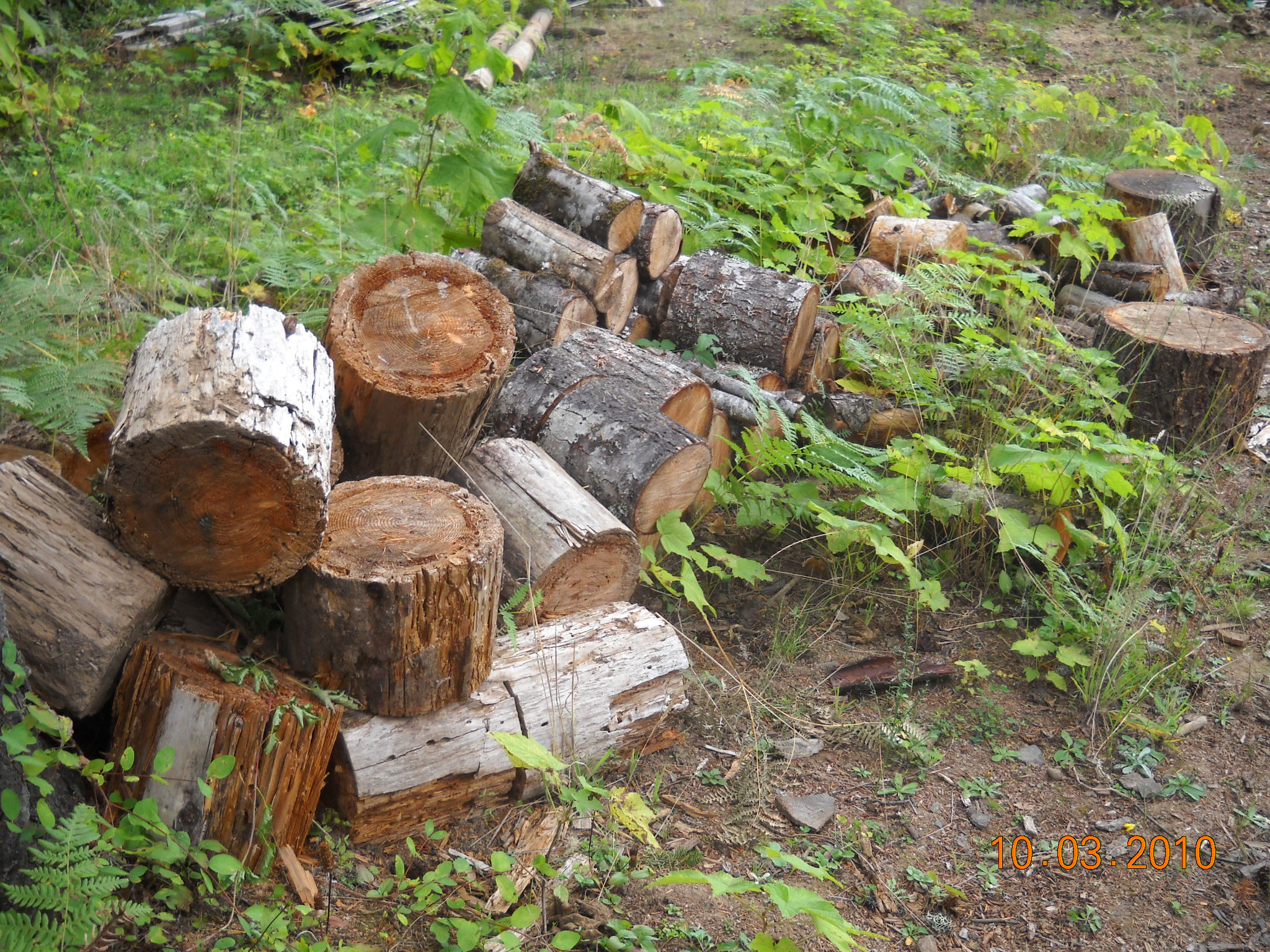

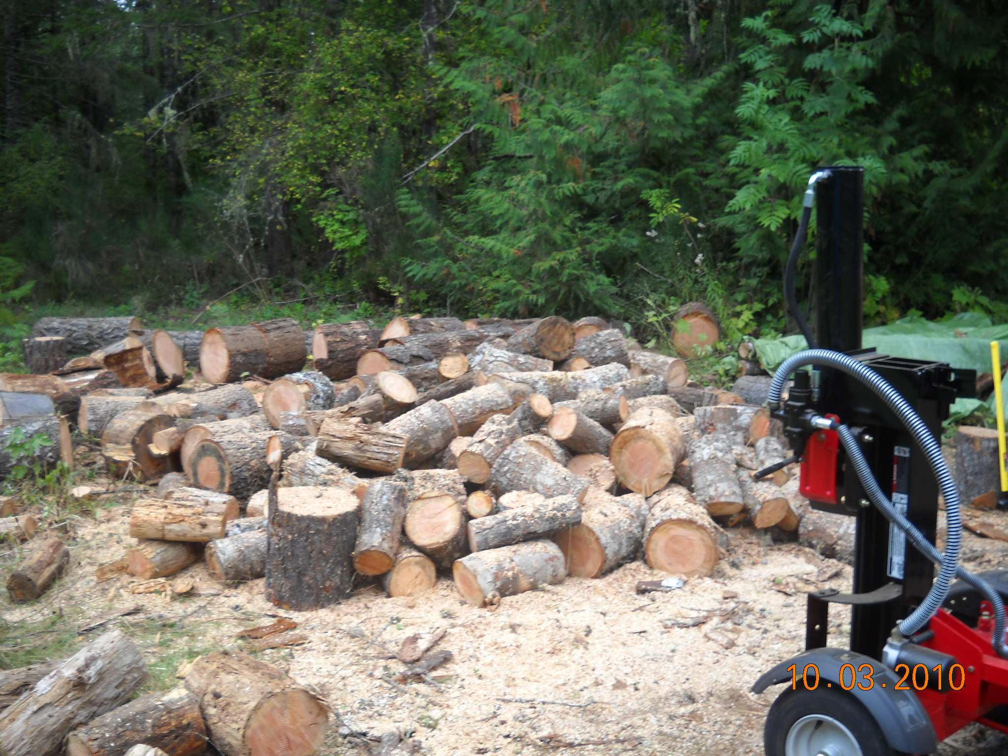

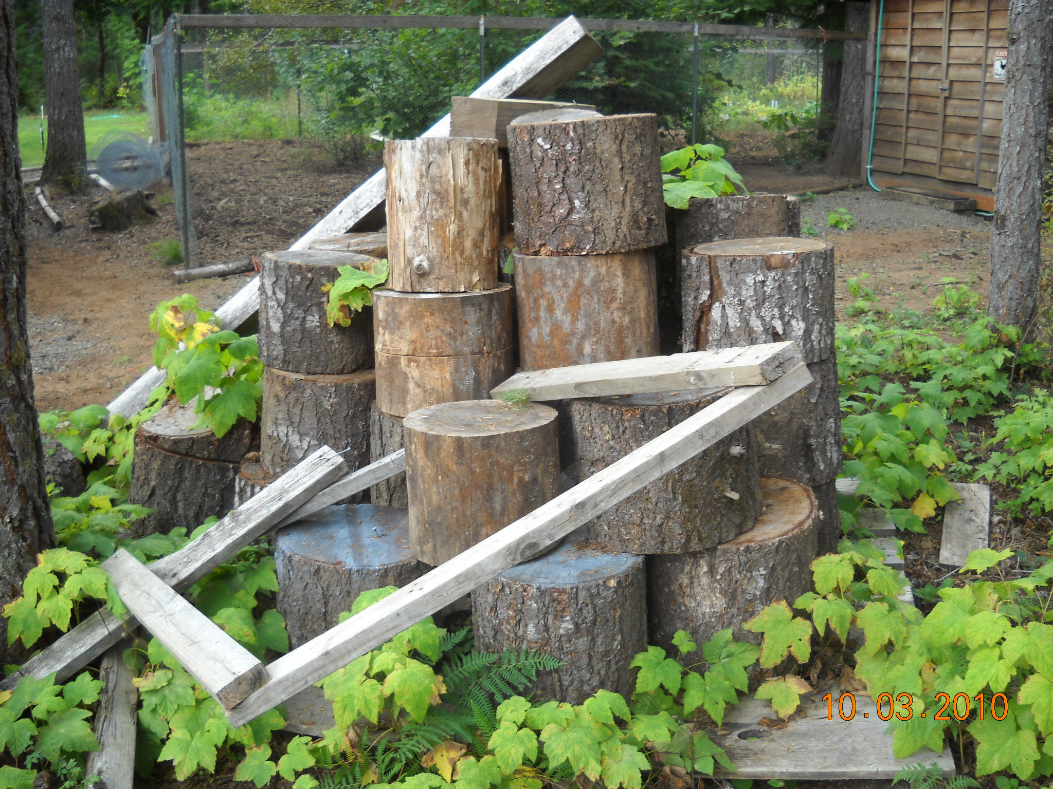

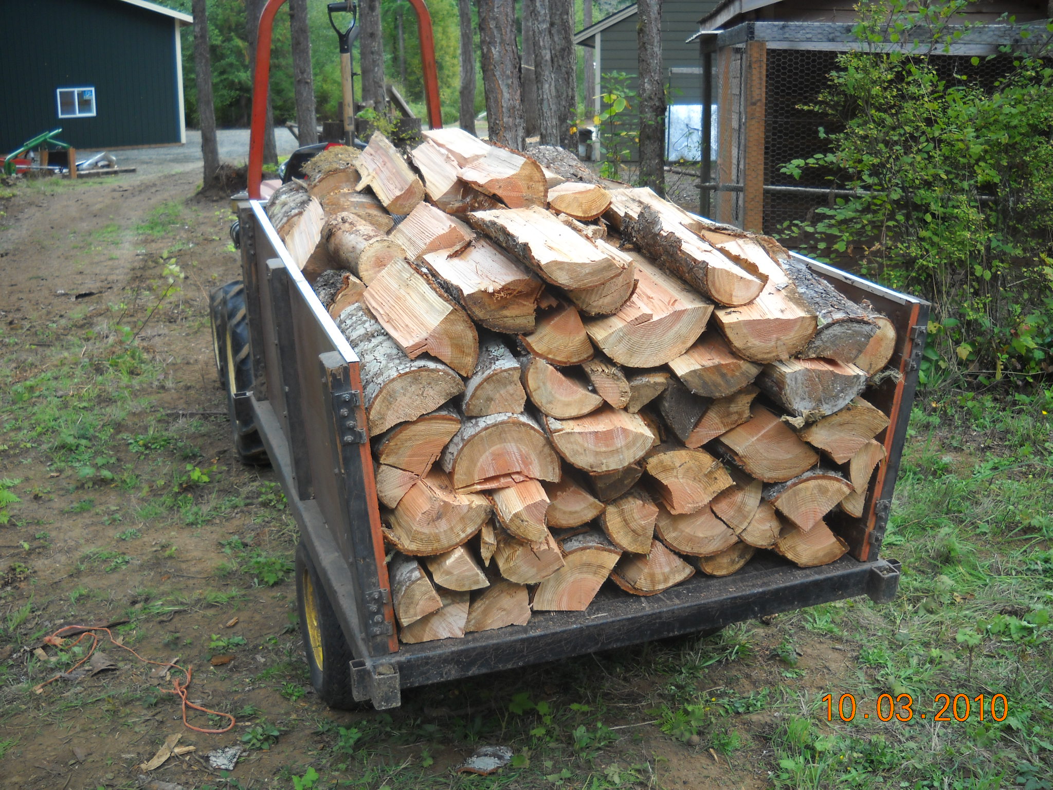

Well, i have already split 3 cord of wood with the splitter and i loved it. i ran it vertically the whole time since the rounds varried from 8 inches to about 2 feet in diameter. I split each round and stacked it into the trailer and hauled it next door (sold it to my aunt). I had a pretty big pile there so i had to borrow my neighbor's BX24 to push the small piles into one big mound. All in all, I still have a lot more to split, the wood in the picture is only part of it, i have a few small piles left and several trees still layin out in the woods to drag out and cut up. My dad has a fireplace store so I plan to stack wood on pallets and use industrial shrink wrap to hold the wood together so i can sell whole pallets as units. Also, i plan to bundle up the wood and wrap that in the shrink wrap so I can sell bundles there as well. I definatly got the wood, and since i have 2 3 day weekends and a 4 day weekend starting this week through the next 2 weeks, i will be working hard to get this wood all cleaned up so we can have more trees cut down.:D:cool: This splitter has a lot more work to do! :thumbsup: The pictures only show the wood after i had taken out 2 cord.
