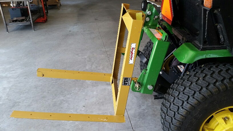

Sometimes it works the other way. I just bought a KK carry-all and made the time to "fix" it to fit my quick hitch. I was suprised to find that KK has changed their ways. Their carry-all's are now made to fit my quick hitch. All I had to do was add a bushing over the lift pins. The top-link was ready to go.
