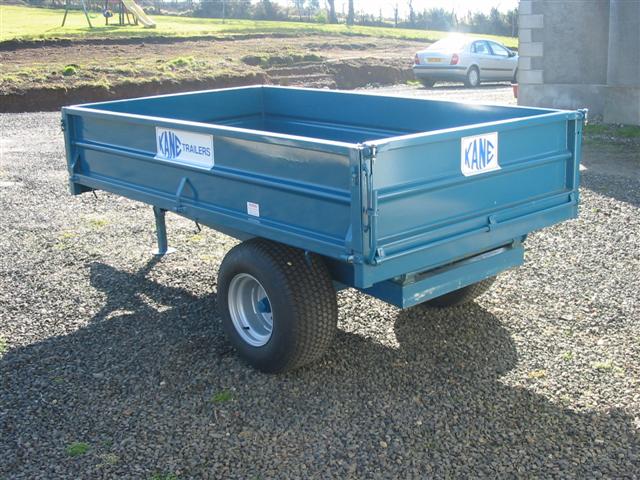

</font><font color="blue" class="small">( why is it that the axle for the trailer in your post is located so close to the centre of the bed )</font>
I've always understood that the main reason was to prevent too much tongue weight on the towing vehicle and to allow tighter turning in small spaces. You may notice that travel trailers as well as utility trailers, even 5th wheel travel trailers, have the axles pretty far forward since they're frequently pulled by smaller trucks and cars often driven by drivers without much experience in towing trailers so if the axles were farther back, they'd overload the towing vehicle, run over curbs on turns, not be able to back into tight parking spaces, etc. while trailers built to be pulled by big trucks will have the axles farther back because they want more weight on the truck. And of course a lot of the 18-wheeler type trailers have axles which can be pretty quickly and easily moved forward and backward by the driver for proper weight distribution.

Bird,
Guess you and Harvey are both right. Likewise, all utility trailers for cars and pickups here are also centre axle, exactly for the reasons you are mentioning.
It seems only to be agricultural trailers that have rear positioned axles, seemingly for the reasons I have mentioned.
