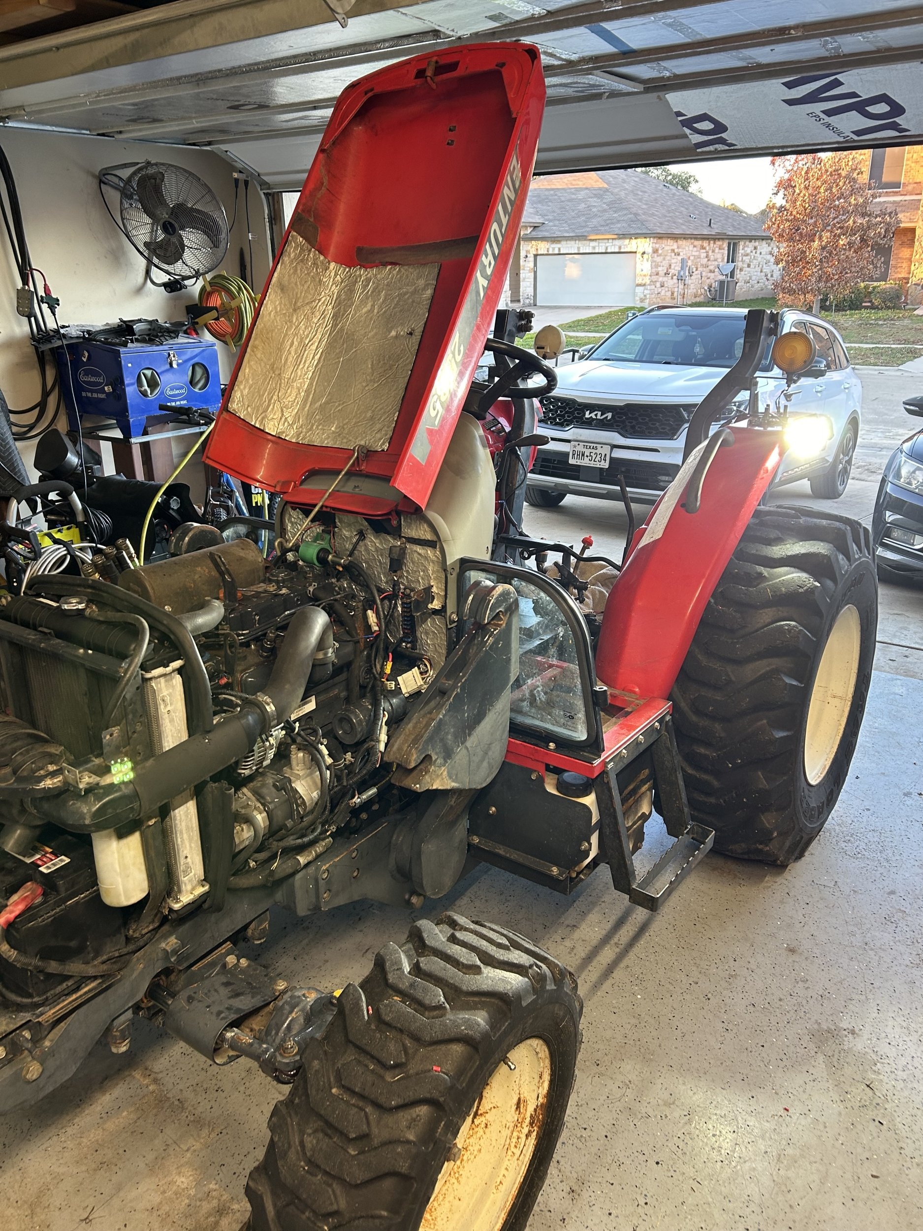

Thanks 52wej, I probably have less travel than that. I will readjust it completely and see if that helps. It's not really an issue, I just turn the tractor off engage then on again. removed safety start switch from PTO lever. just an annoyance.
Ya, the tractors running great now. really just the head gasket and all the hydraulics were the issue. Last thing left to do is drain the front axle and refill.

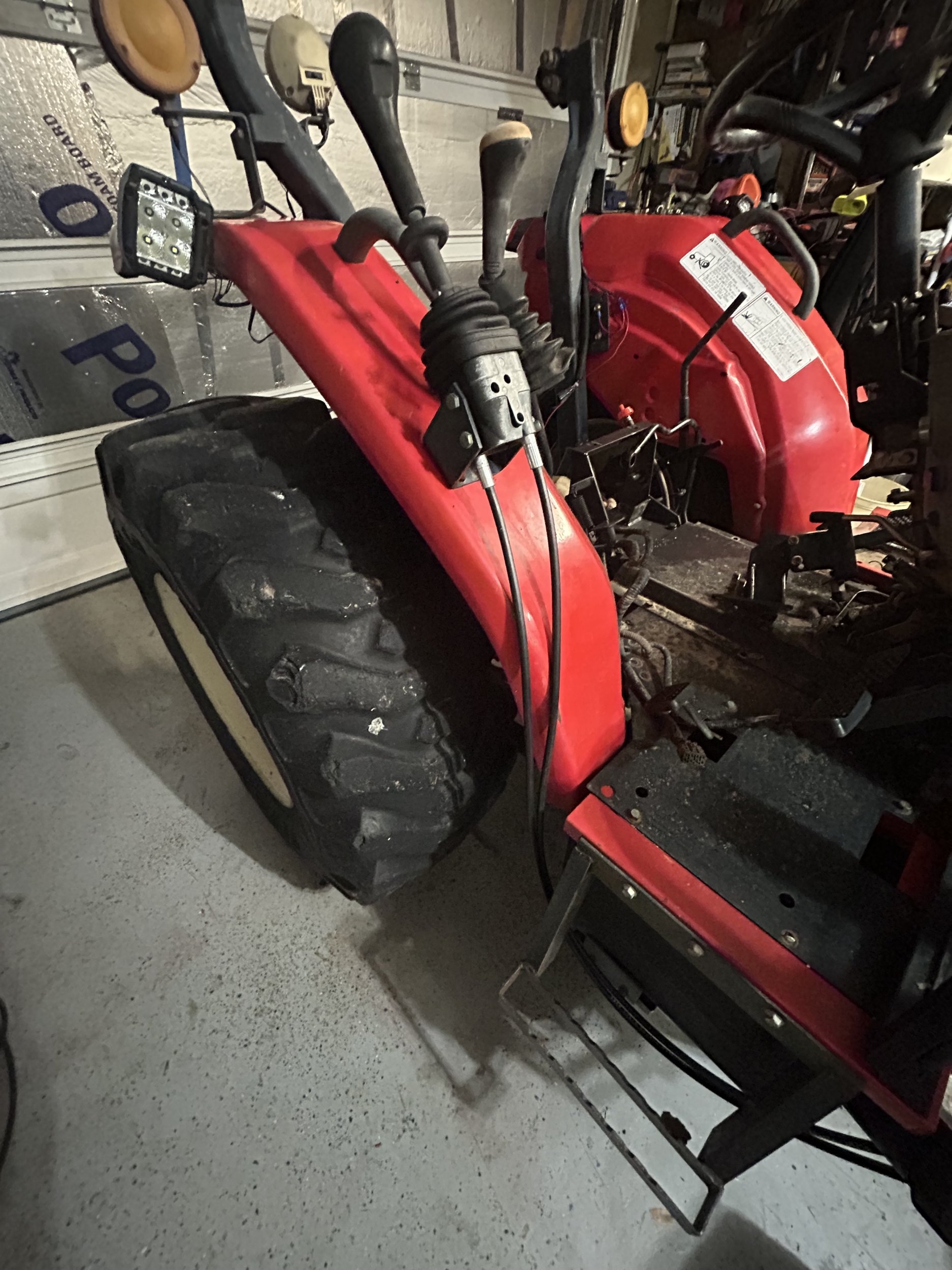

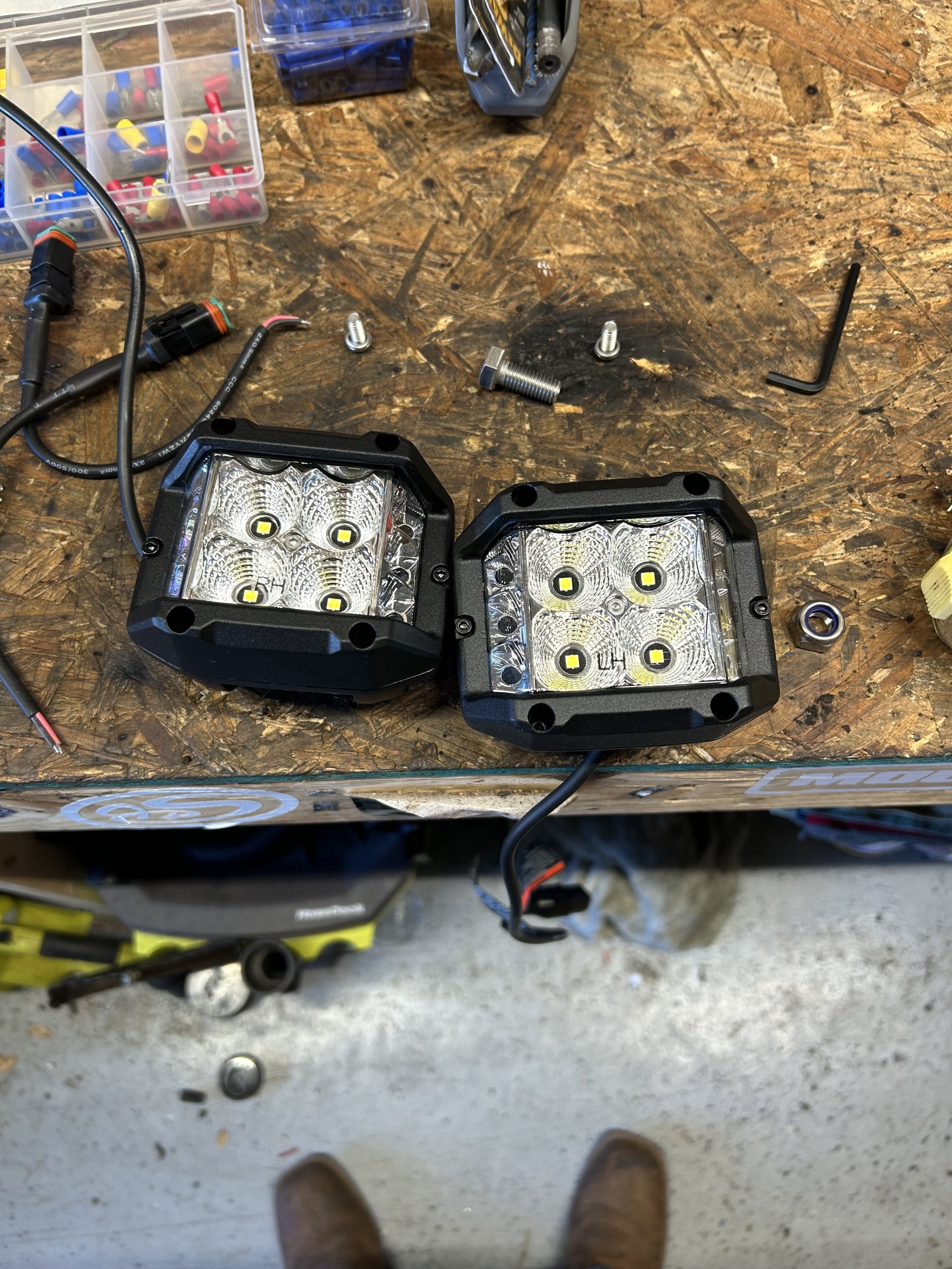

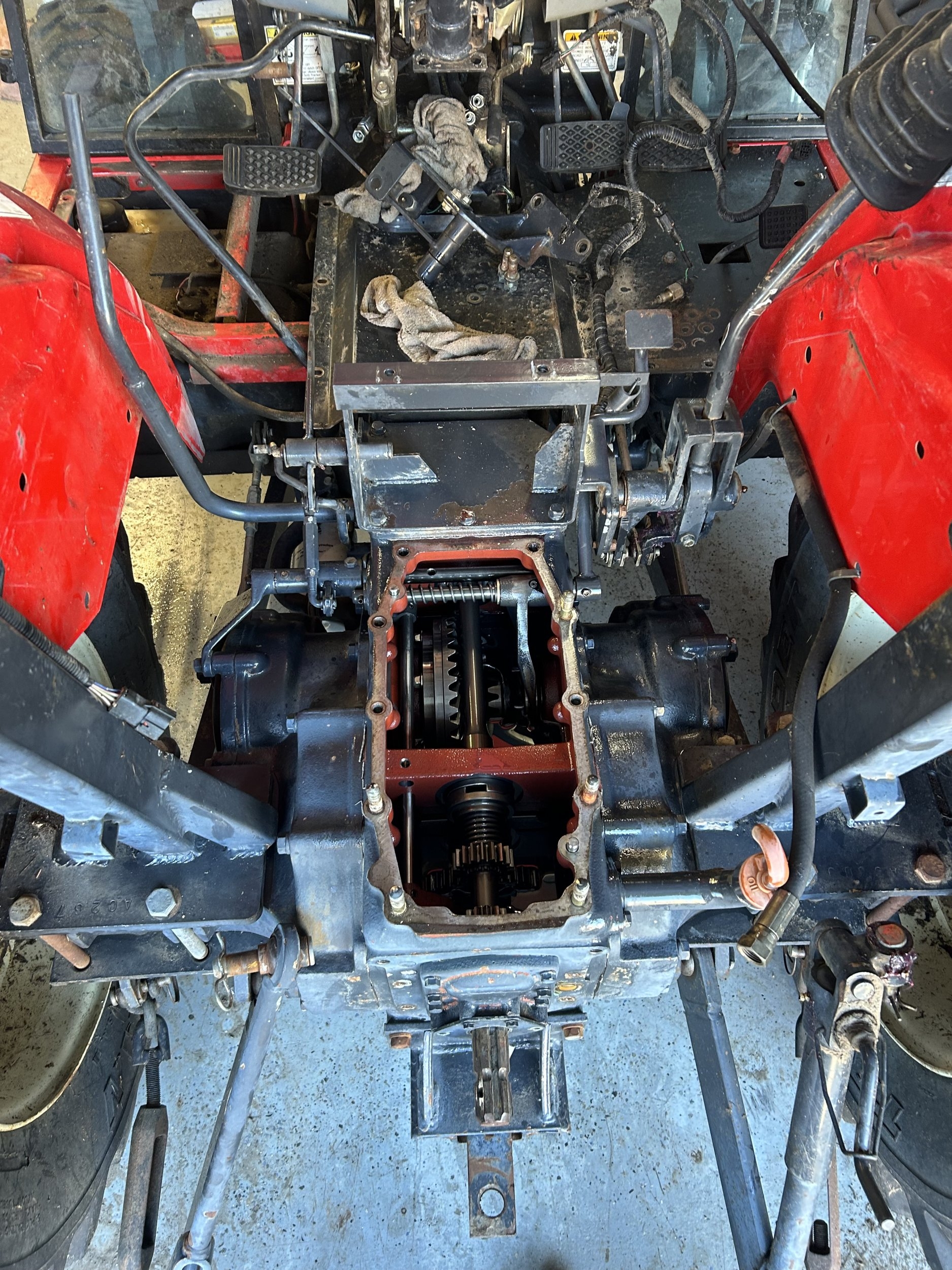

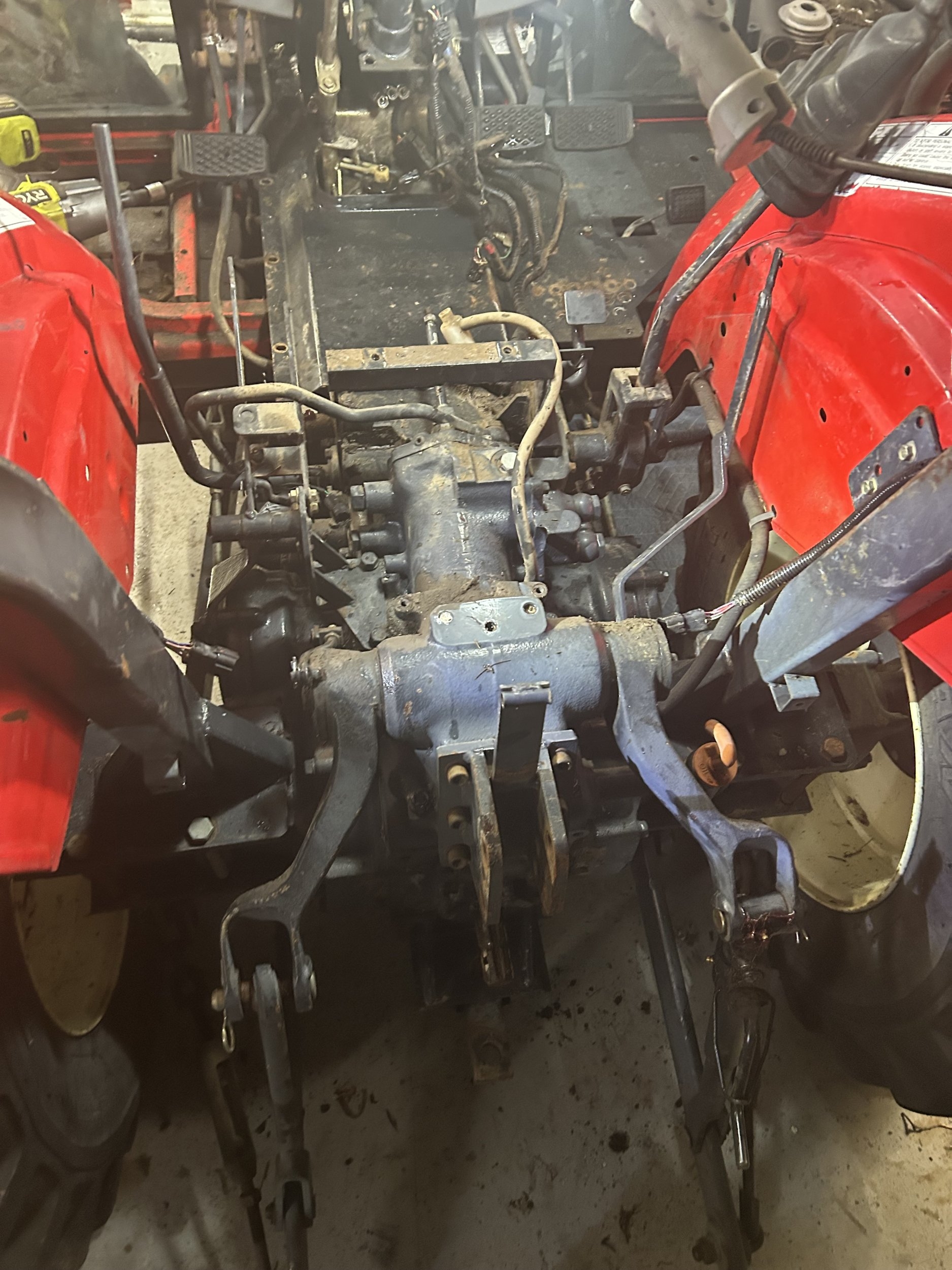

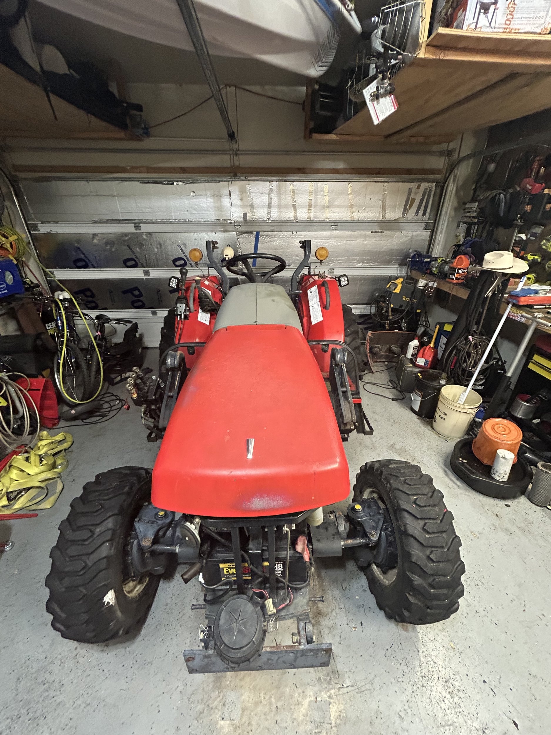

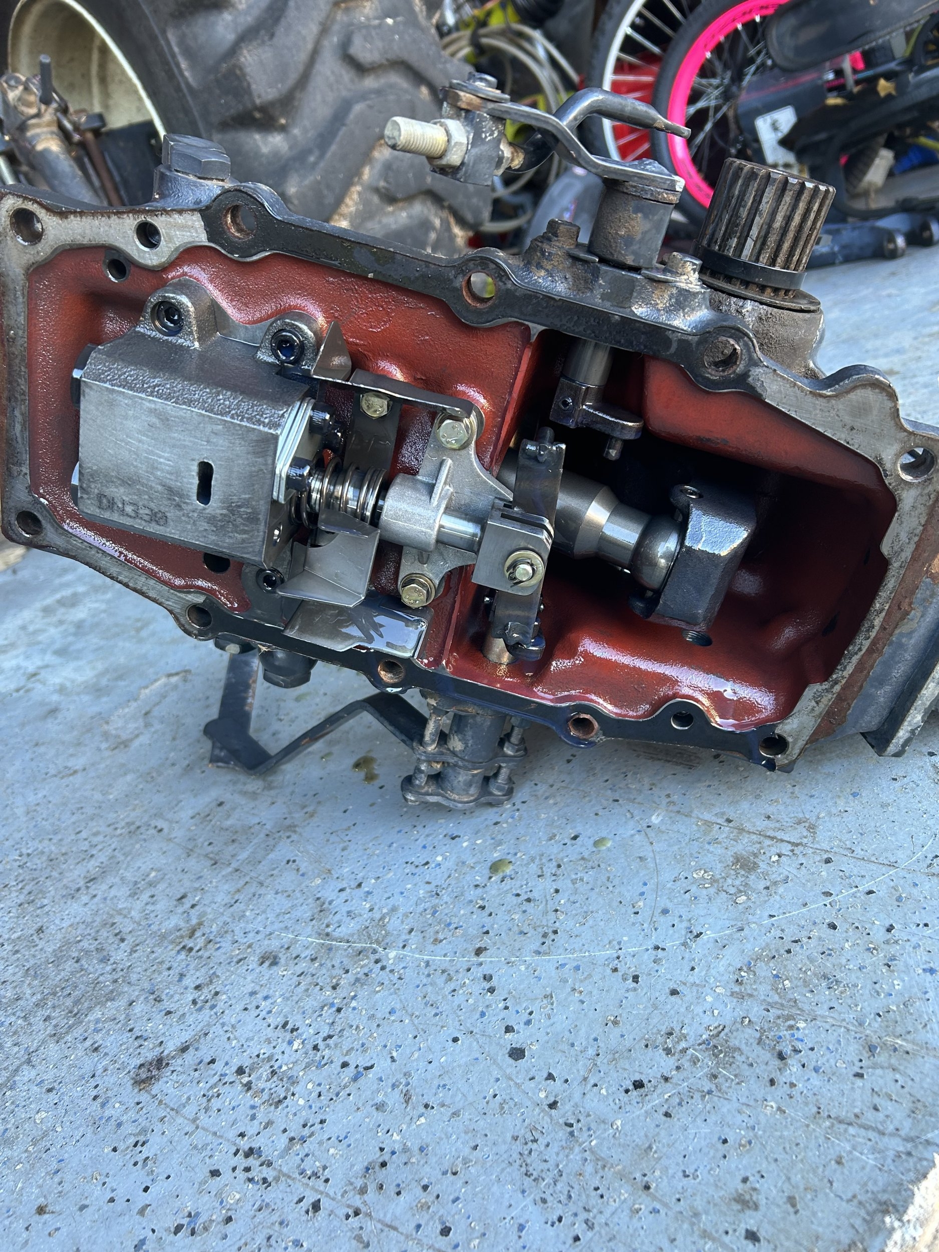

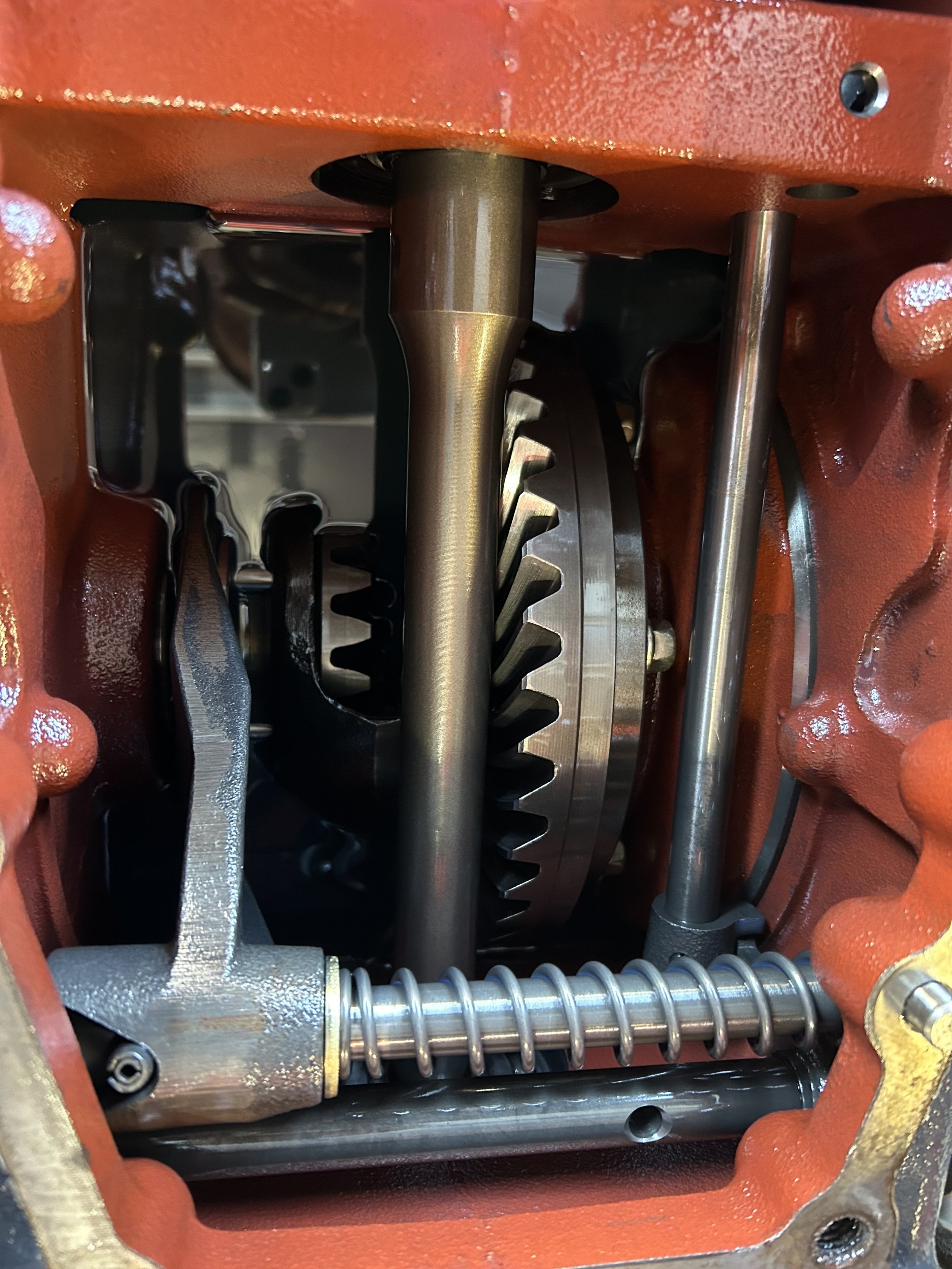

I finally decided to bring the tractor home and do a full work up on it. New lights all the way around, engine oil, fix the 3 point cylinder leaking by and new hoses all around. Also put on some 2k flood lights, new seat, replaced front axle gear oil. Pulled the steering orbital valve off to get rebuilt as well. Went top to bottom and grease every fitting i could find. Replaced all fuses. New FEL cables, air filter. Degreased and cleaned the radiator plus flush and fill. That really needed it. Drained and cleaned the steering system. Fresh battery.
Surprisingly the inside of the trans looks brand new still.
Once it’s all back together this will be a 100% tractor. Yay!!!

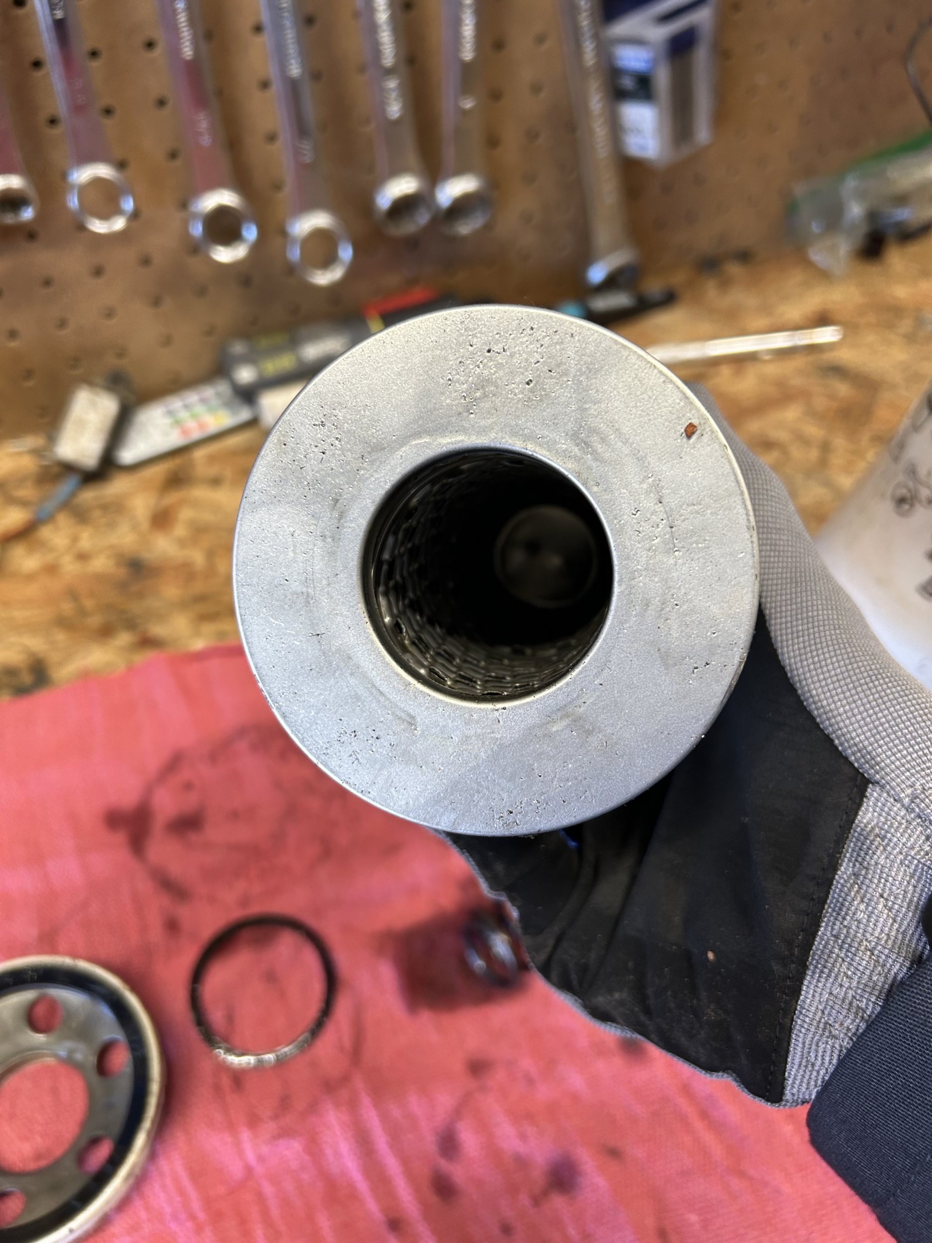

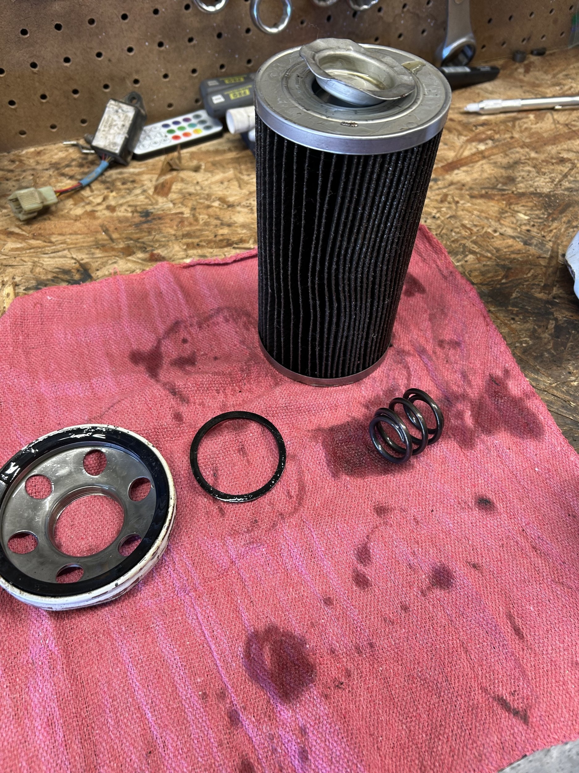

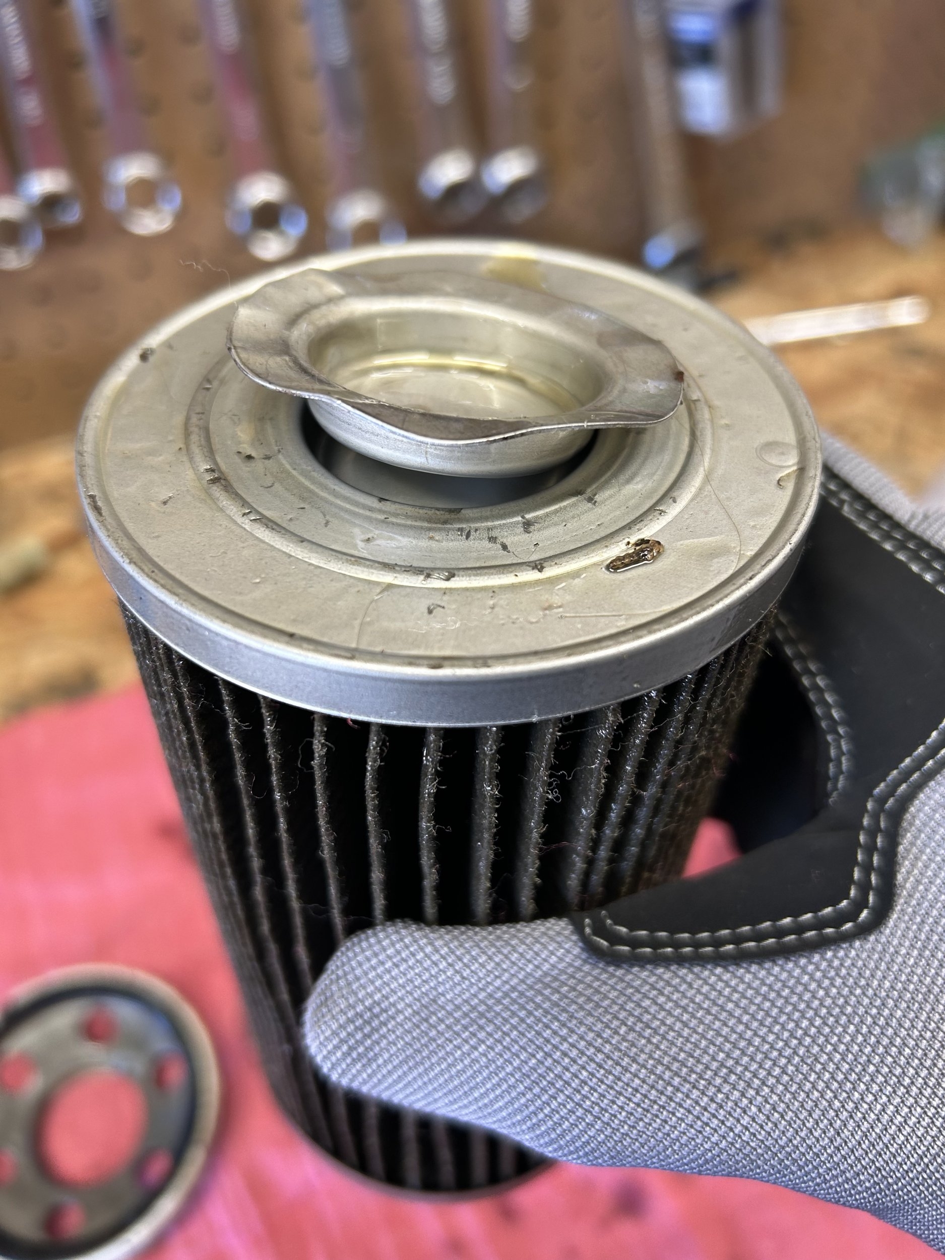

Cut open the wix filter for hydraulic. It had a spring at the bottom but no relief valve at the bottom like oem. I prayed it open with a screwdriver but not meant to come off. Maybe the whole filter slid down for the bypass. Either way this one made the hydraulic pump whine on really cold starts. Put the napa one on this go round. Will see how it reacts this winter. If you look at previous post i show the inside of oem.

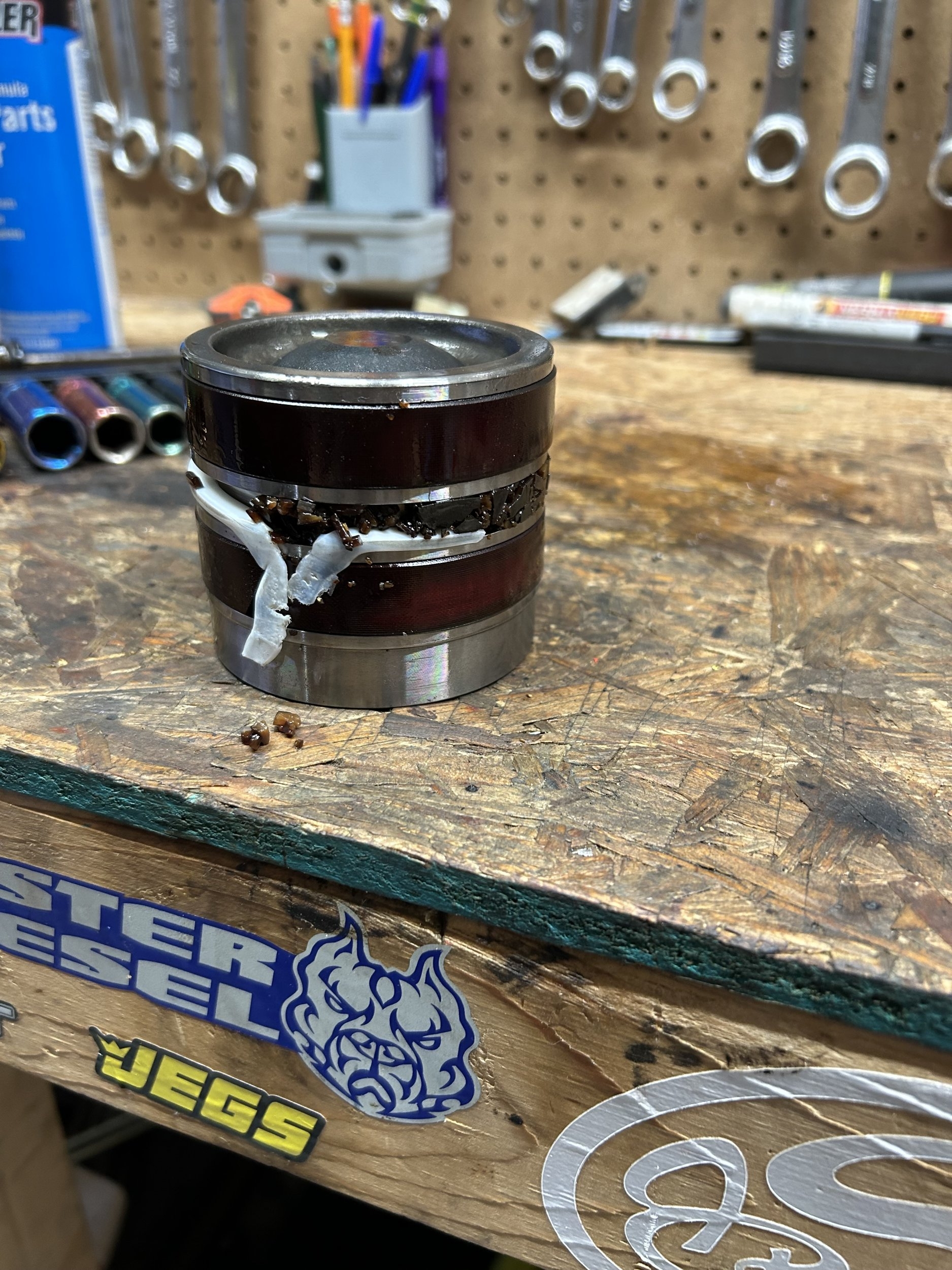

Forgot to add my 3 point piston. Think it was blowing by lol. No wonder my loader moved so slow. It was all blowing through the 3 point.
