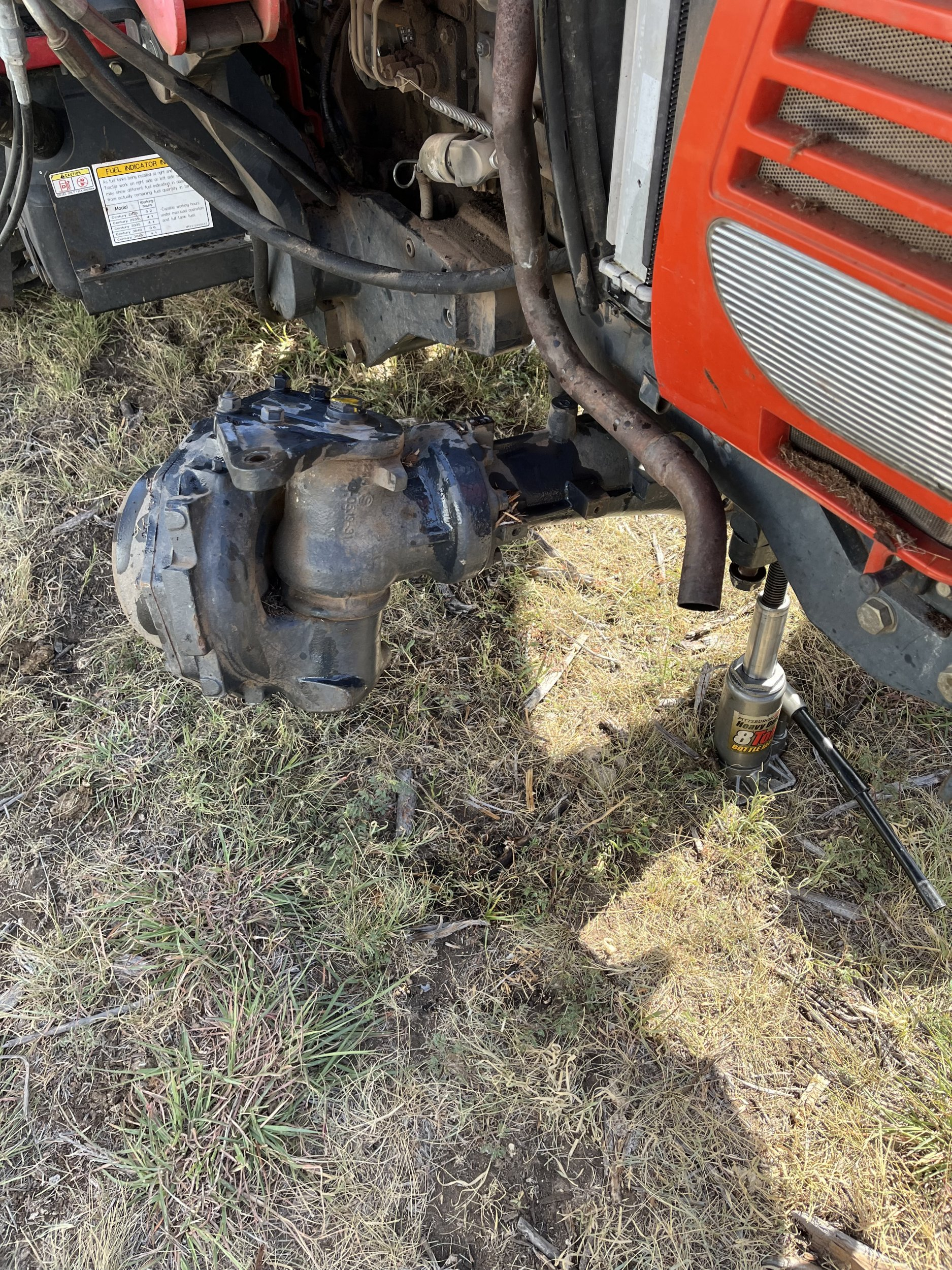

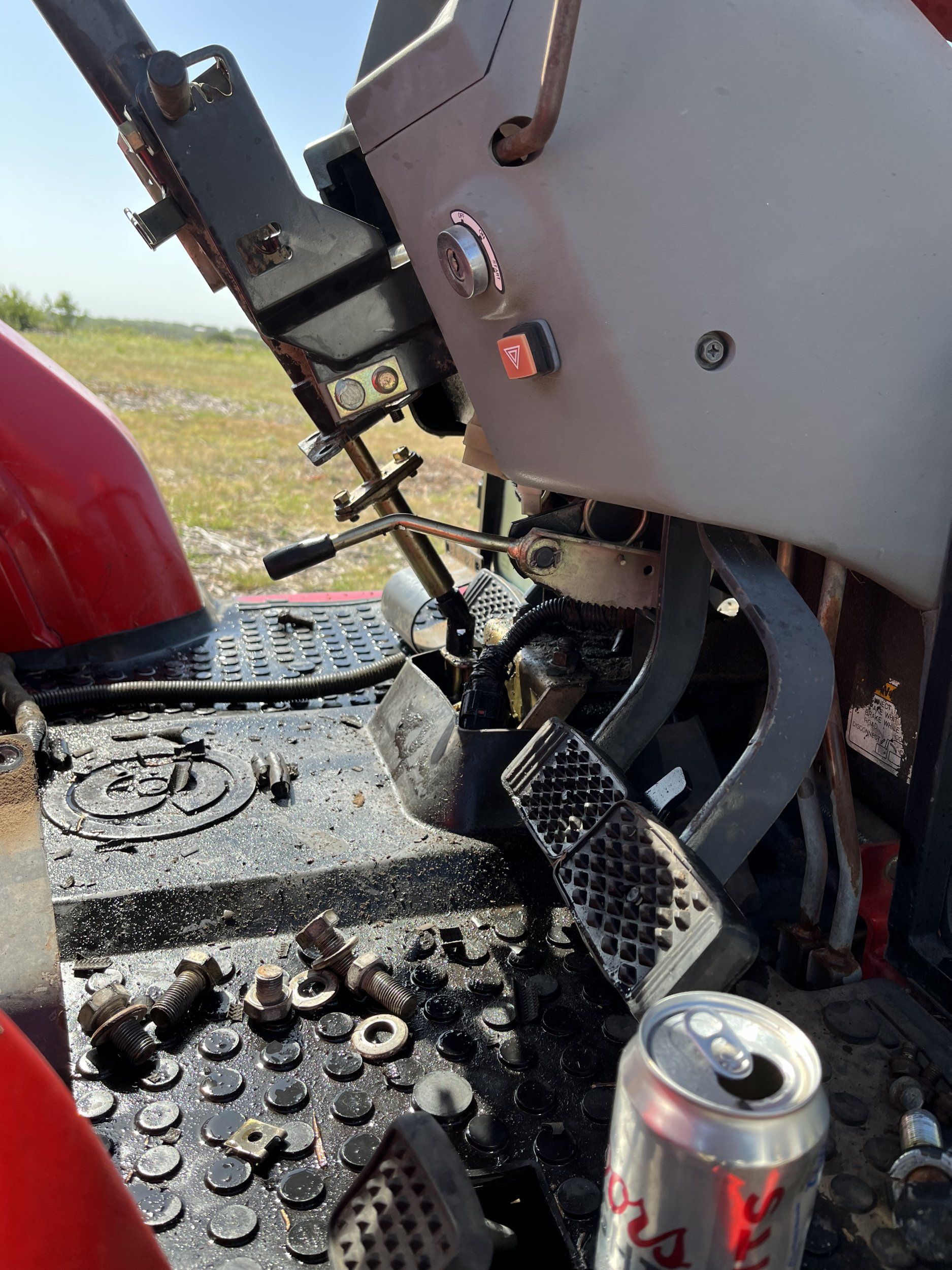

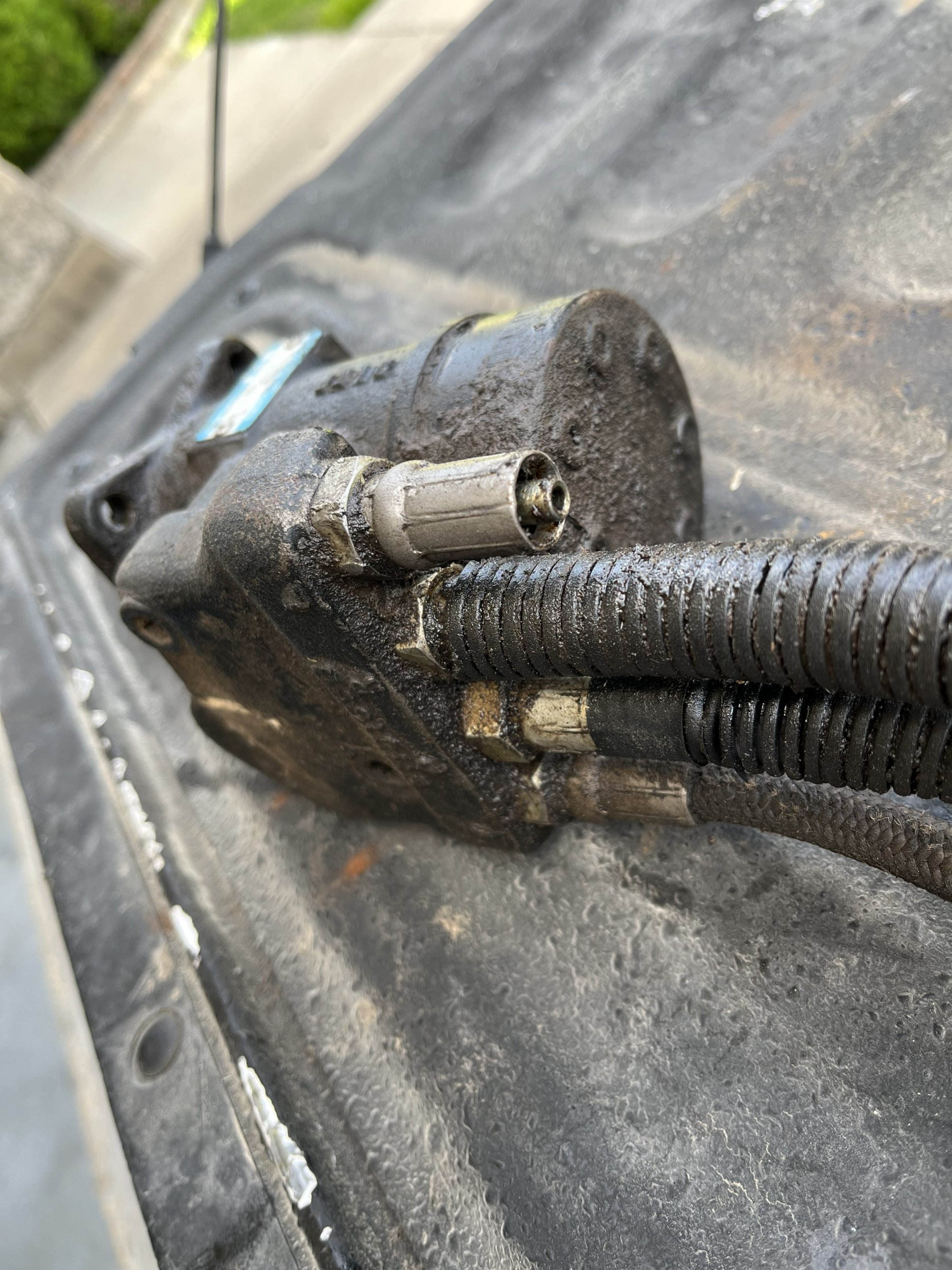

So i figured out my power steering!
Started working this morning moving dirt, heard a big pop and a shower of hydraulic fluid all over me lol. Blew a line right off at the steering wheel. After that notice a steady stream of fluid coming from the left side cylinder seal as well. Decided to pull all 4 lines and the rack to go get rebuilt. Had to drop the front axle to get the rack out. Too easy with a Ryobi 1/2 inch impact

Man, you are going to have one heck of a tractor when you're done! For cheap no less!

Glad to see you "found" the problem.
Sounds like you're going to be up and running soon. Congrats on getting the steering rack apart in the field in less than a day.
