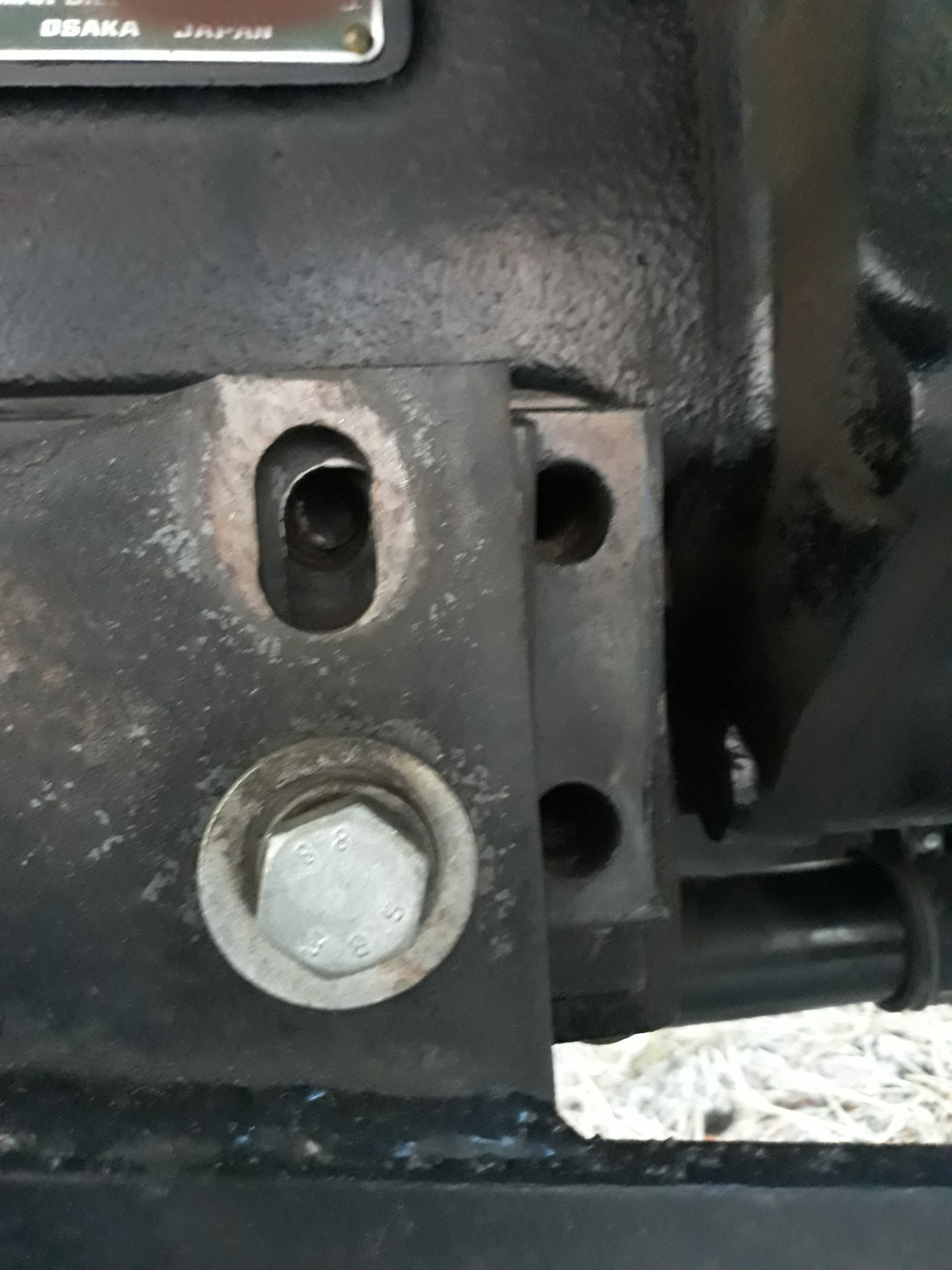

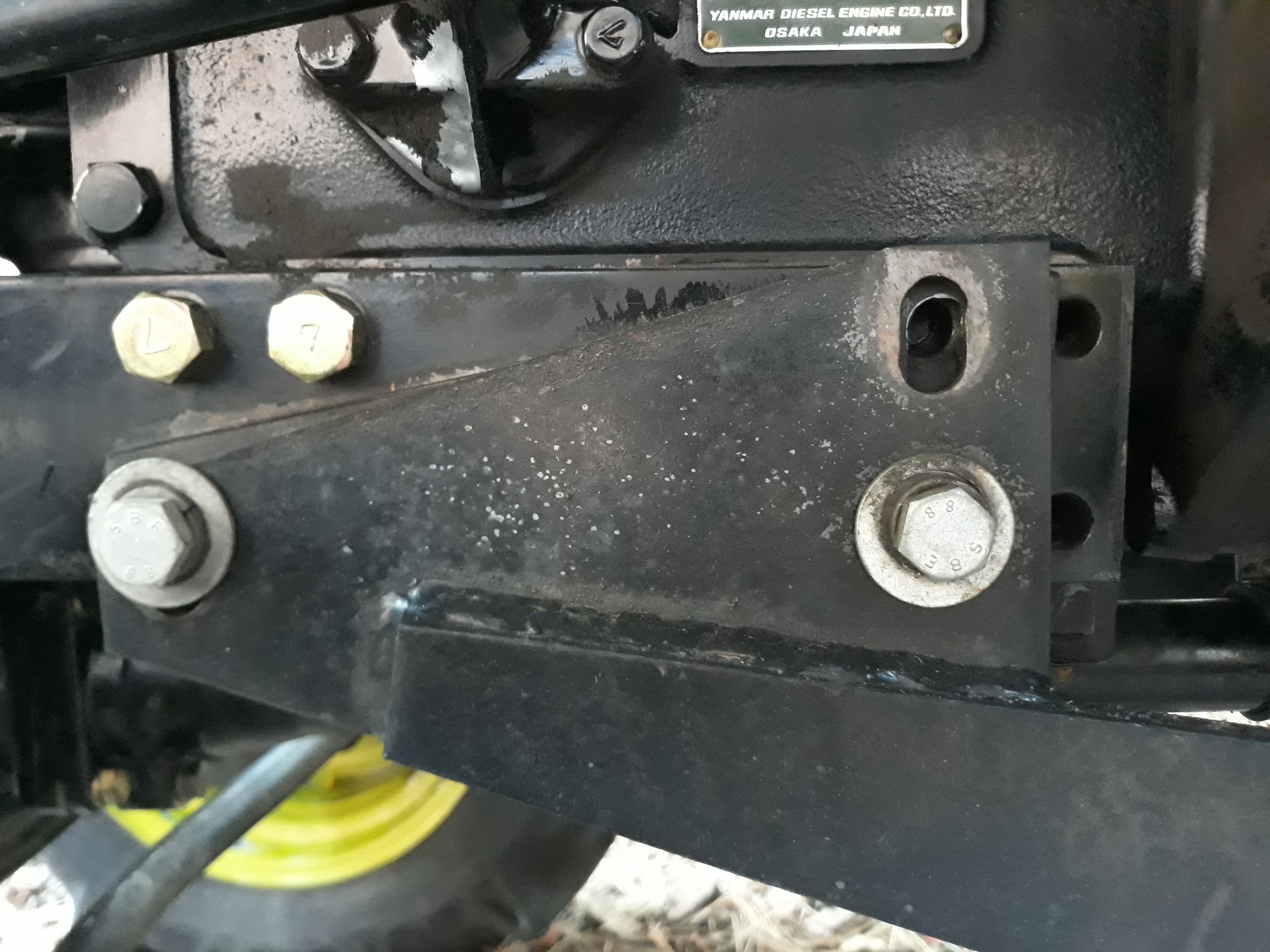

I was thinking about welding something to it, but it's approximately a 1/2 to 3/4 inch recessed into the frame + mounts. I wasn't sure I could get another bolt/nut into the hole and still be able to weld to it. Hopefully the pictures below will help show it.
View attachment 706112View attachment 706114
Really appreciate the responses and suggestion on the left hand drill bit, I'll check out my local HF to see if I can find an appropriately sized bit. Also hindsight, I wish I would have noticed all the newish bolts around the tractor. The light was a bit funny out when I checked out the tractor, I clearly missed them. Hopefully that doesn't lead to more surprises down the road.
Thanks!
My eyes aren't what they used to be, but, it is a good size bolt. If the lefties don't get it from either side, see if you can find a piece of pipe that will both; fit in the hole, and have room in the center for a small stick rod to fit through. If you can, push the pipe in to the broken bolt, then gouge it right down the middle with 6011 for 3 seconds, put a pipe wrench on and remove. One of the most innovative things I ever witnessed, and it held pulling out 2 inch bolts on an overhead crane. Sorry to be repetitive.
Best,
ed
Thanks Ed, the pipe idea is brillant. I didn't have time to get the HF set today, but plan to do that tomorrow and give the extractor set a try. If that for whatever reason doesn't work, I'll go the pipe route. I believe I do have some 6011 left over for the ole lincoln buzz box too.

Thanks @California. Question, do you recall how hard you had to turn when removing the broken stud? I'm putting a fair amount of force on the extractor and it's not budgin the bolt. Just don't want to snap the extractor off, been there and done that before.. In all my years, I've actually never been successful in using an extractor, getting worried I might make the situation worse.
On a side note, I ended up drilling straight through the remaining bolt, apparently it was not screwed all the way in. Since there is a hole, I sprayed a bunch of PB blaster in there and I'll let it sit over night and try again tomorrow. I guess if this doesn't work I'll try the pipe and weld trick.

Well done getting drilled through, and PB is the best. Dumb question, how well did you center the hole? If you can just keep going up in bit size without dorking up the treads it will get easier. Keep in mind the hole goes all the way through, if you wallow out the threads, you use a bolt and nut instead, not the end of the world:)
Extractors are some hard stuff, I have had to use a high speed drill and high priced bits when I break one.
If it was me I would just keep drilling until it comes out, or use a bolt and nut.
Thanks for the update, headed the right direction, break the extractor, two steps back:)
Best,
ed
Thanks, it was kind of an accident drilling through as I didn't know how much bolt was in there. I guess it's a good thing though because now I can spray PB behind the bolt and hopefully loosen it up.
Certainly not a dumb question on how centering :D. I think I got it pretty centered, but it is off just slightly. From the HF kit, I do have the next size up, but that will drill out most of the bolt. My concern there was I wouldn't have much left for the extractor to grab onto..
I pulled one of the other bolts on the FEL frame, it was stripped to all heck and back. I'm guessing the others will be the same. Looks like I need to get all new bolts and a tap to chase the threads on all of these.. The fun continues :).
