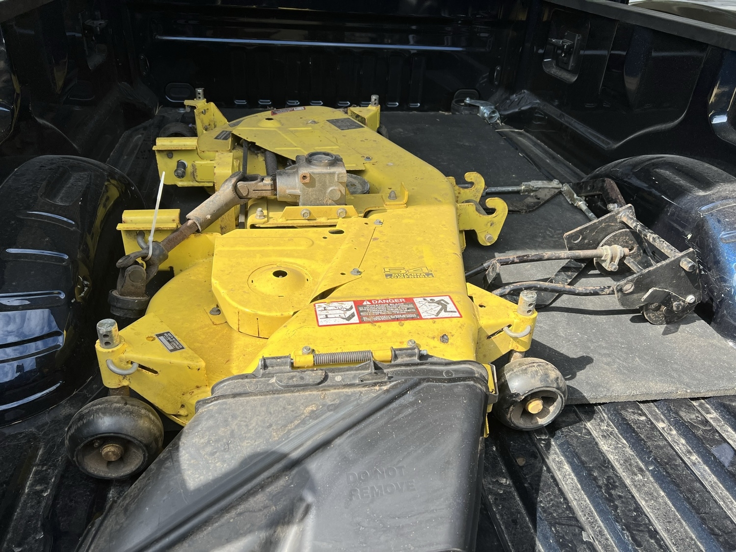

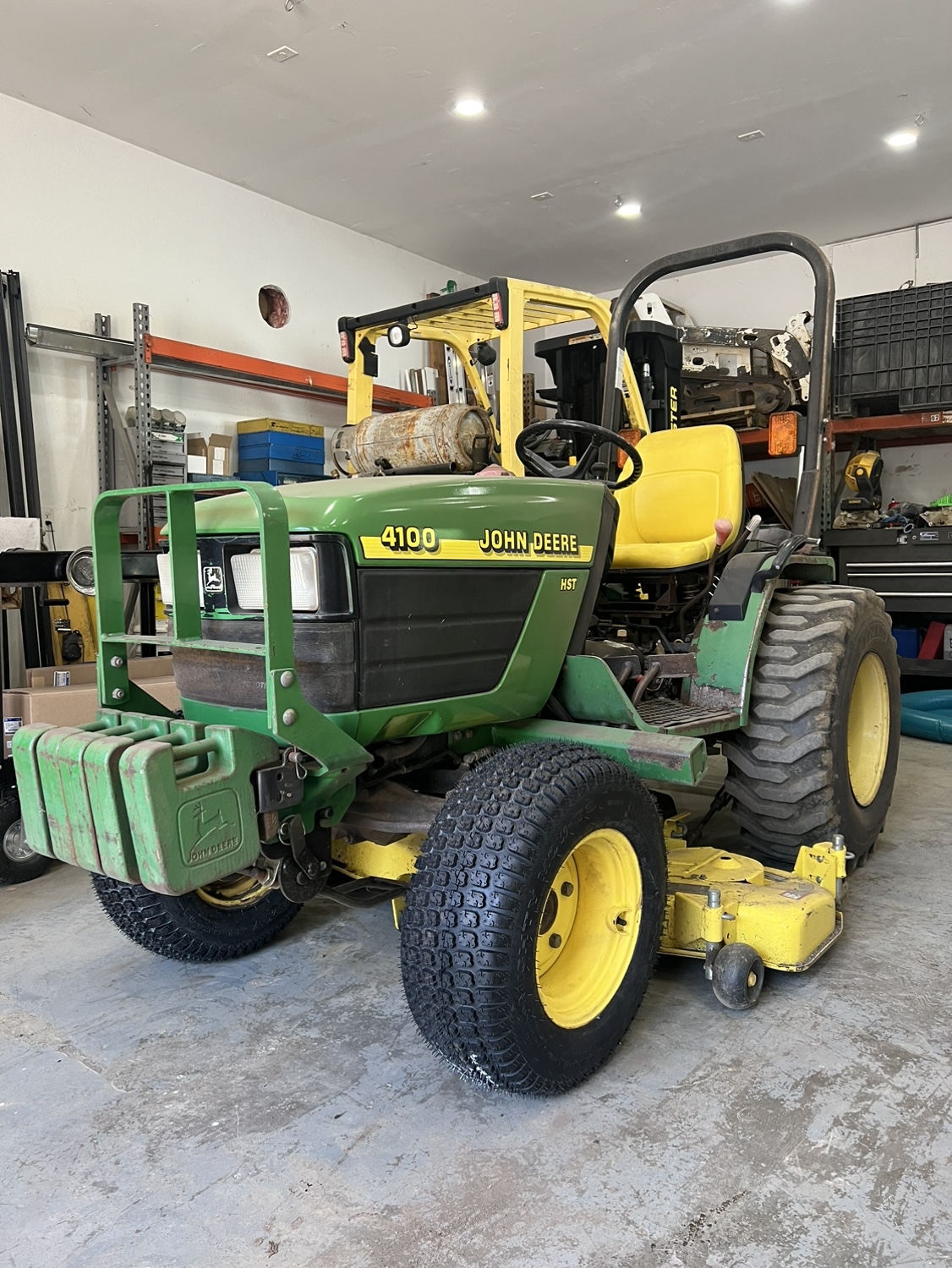

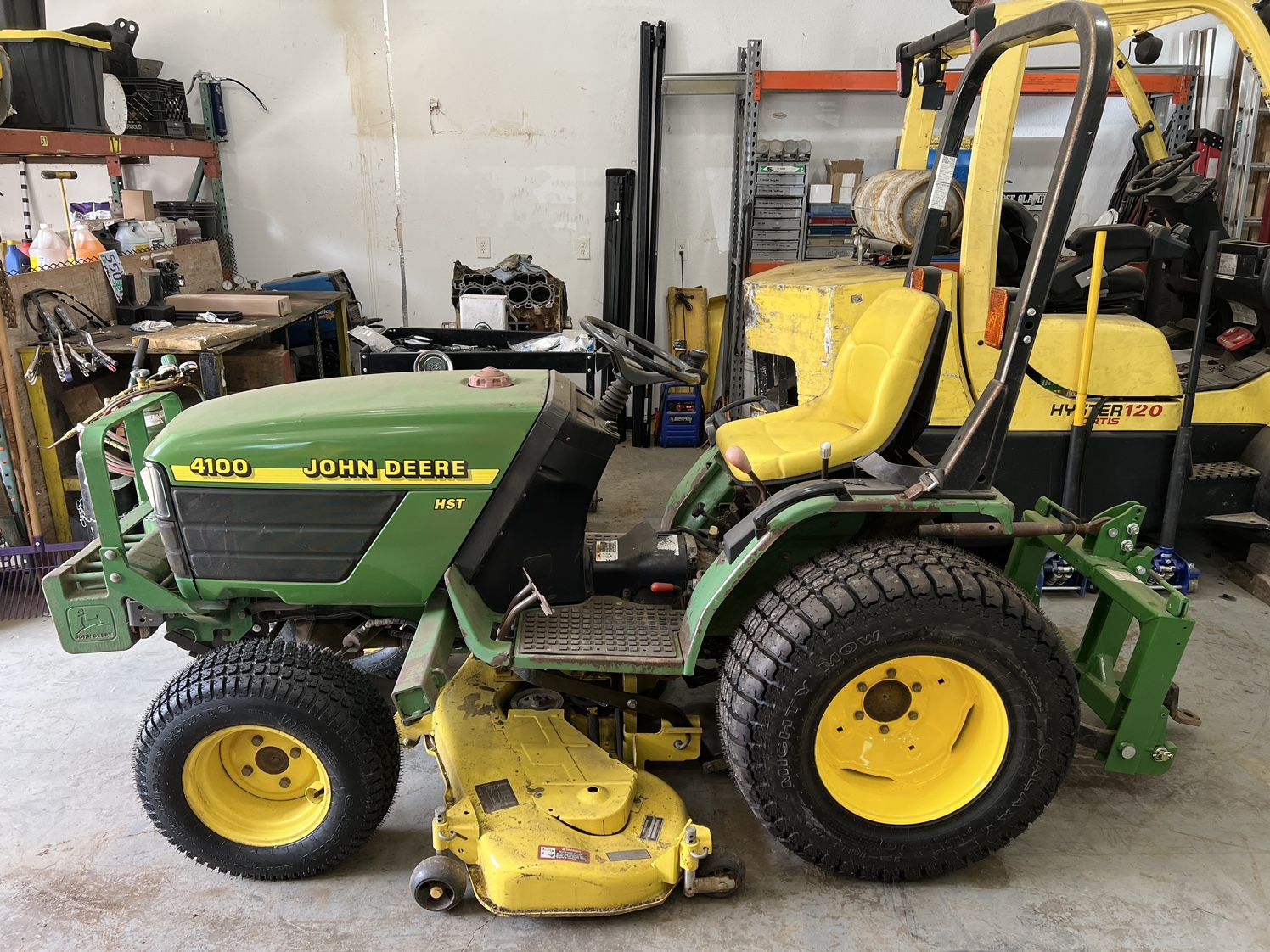

Been a while once I’ve posted an update but the 4100 has undergone some transformations.

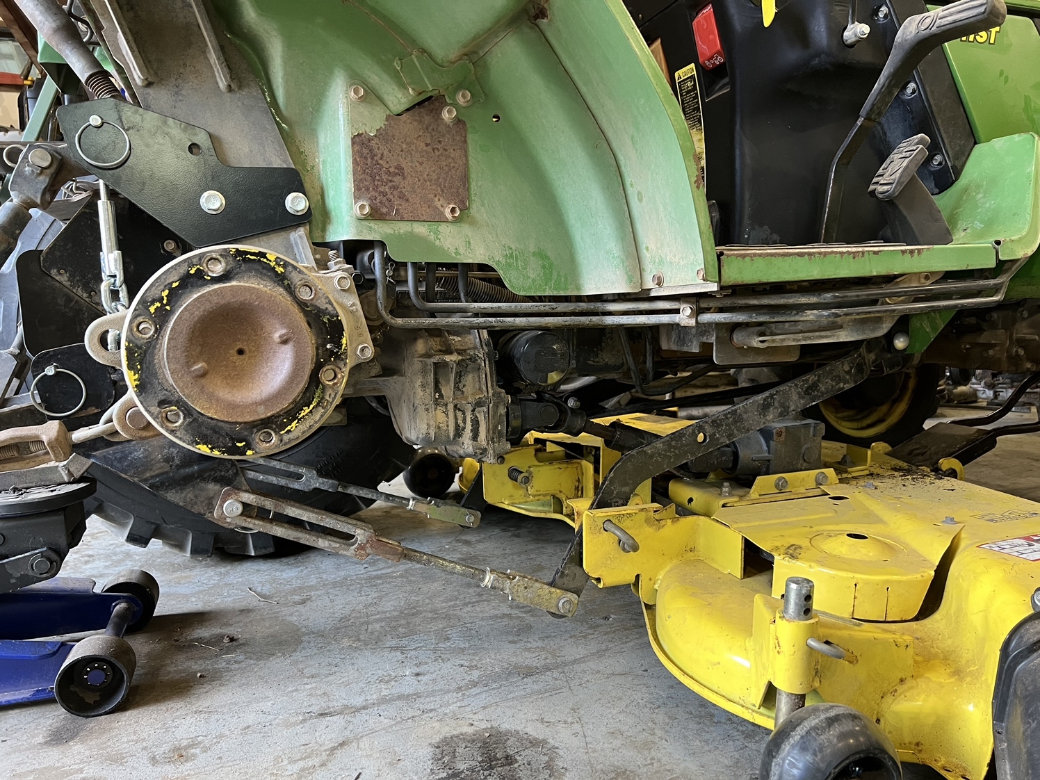

I located a new takeoff mid mower deck with 15 min of run time on it and decided to turn the 4100 into a big riding mower.

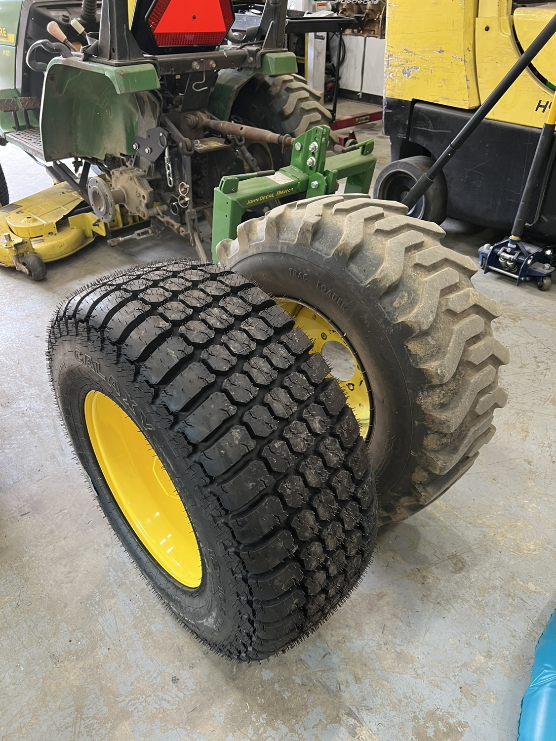

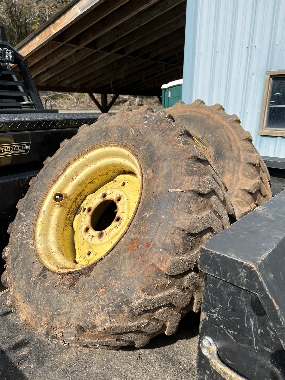

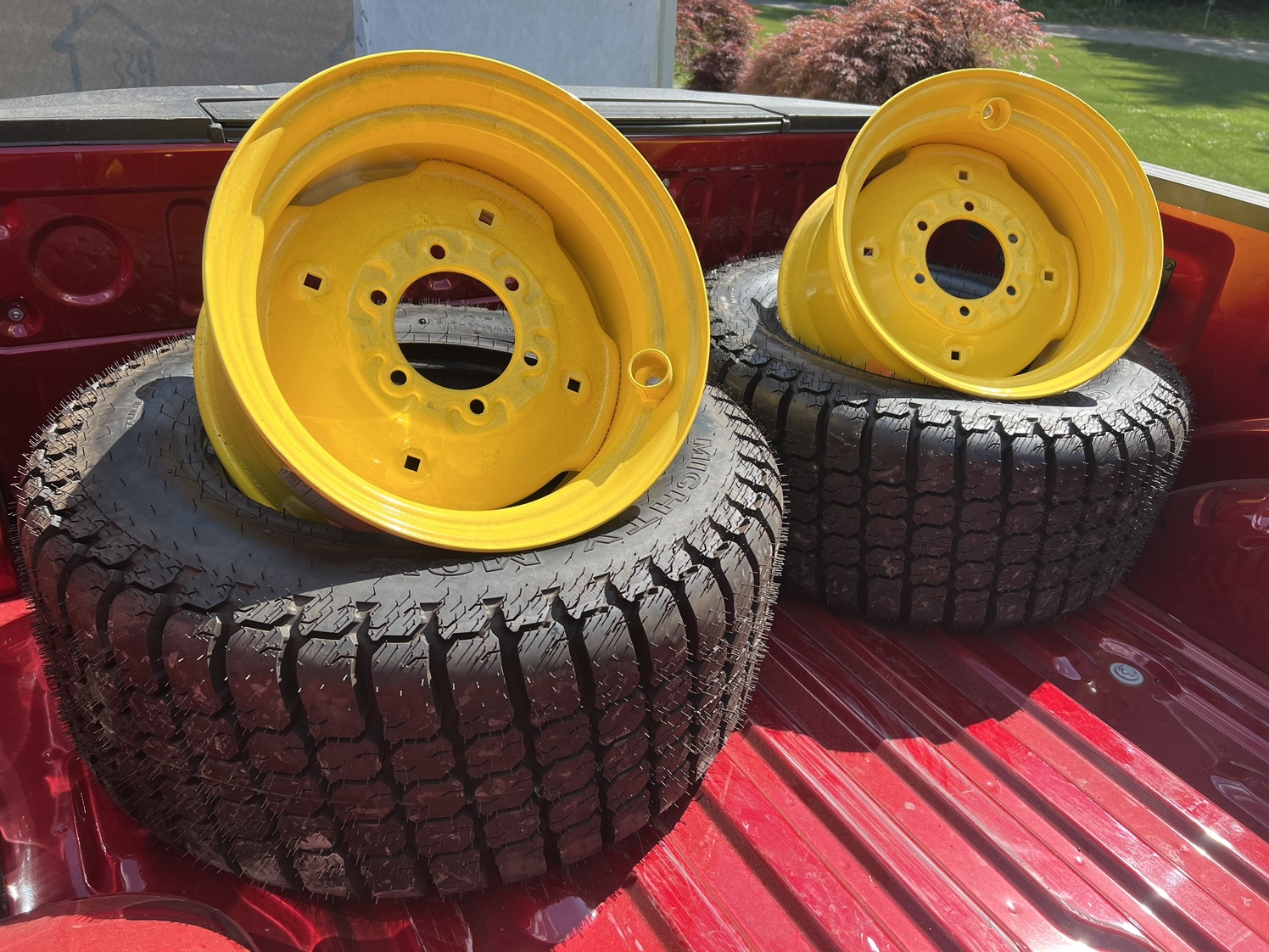

I absolutely love the cut with the deck on the 4100 but in the wetter months the R4’s were too hard on the yard. A friend of mine had given me a set of rear wheels from an 855 which share the same bolt pattern and size as the 4100 (both had 12x16.5 R4’s).
I brought the wheels in to Les Schwab and had them junk the tires and powder coat the wheels (relatively inexpensive). I also ordered a set of Galaxy R3’s for the front and back which should be a bit nicer to the yard in the wetter months.
Really love how this tractor is turning out. I’ve done a lot of ground work on the property lately so it’s main job has just been cutting the lawn meaning it’s only gotten a handful of hours since I brought it home. Hoping in the bear future to get a FEL for it, I’ve done some extensive research and discovered that the 200x/200cx mounts should work with the current 220R loader Deere sells today. Whenever I start that part of the transformation I’ll be sharing whatever else I learn in putting a current model loader on a 4100.
