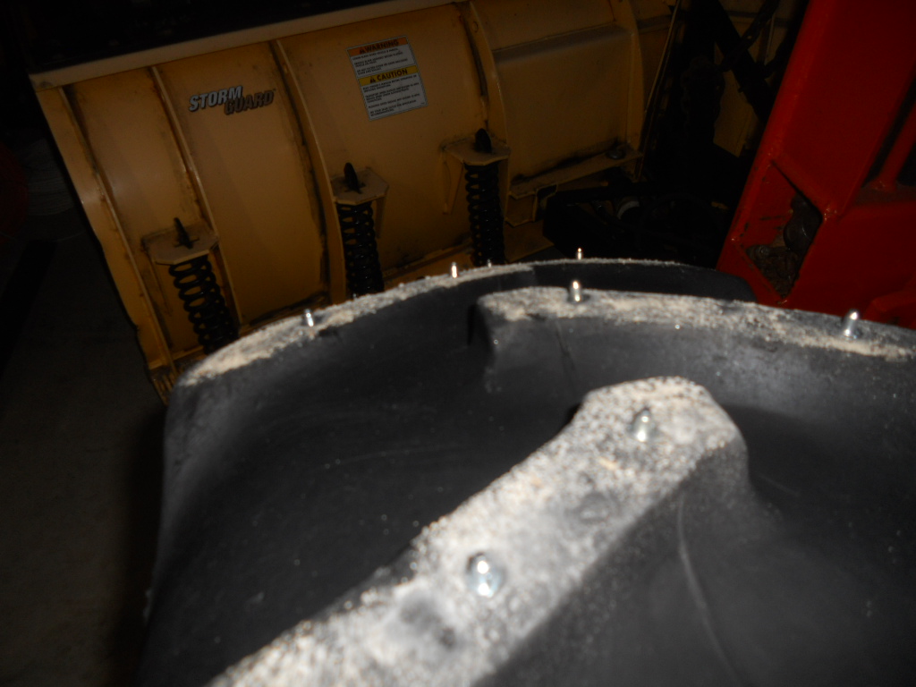

They look good! I've been eyeing them for the rears. Please report back and let us know how they did at the end of this season.
I'm on my 3rd year with screw in studs. Each year I am amazed (forgot how well they work) We just had conditions that created ice rink quality skating conditions that actually made walking on it without shoe cleats impossible but the tractor moved around almost normally on it. Initially I used 2 studs in each individual "bar" or lug thinking I could add more, that was not necessary.
They are not equal to my European studded ice chains in the woods in deep snow but I'd say they are very close to them on ice.
Leave them in year round, removal leaves a small hole making that spot unavailable to re install next season.
