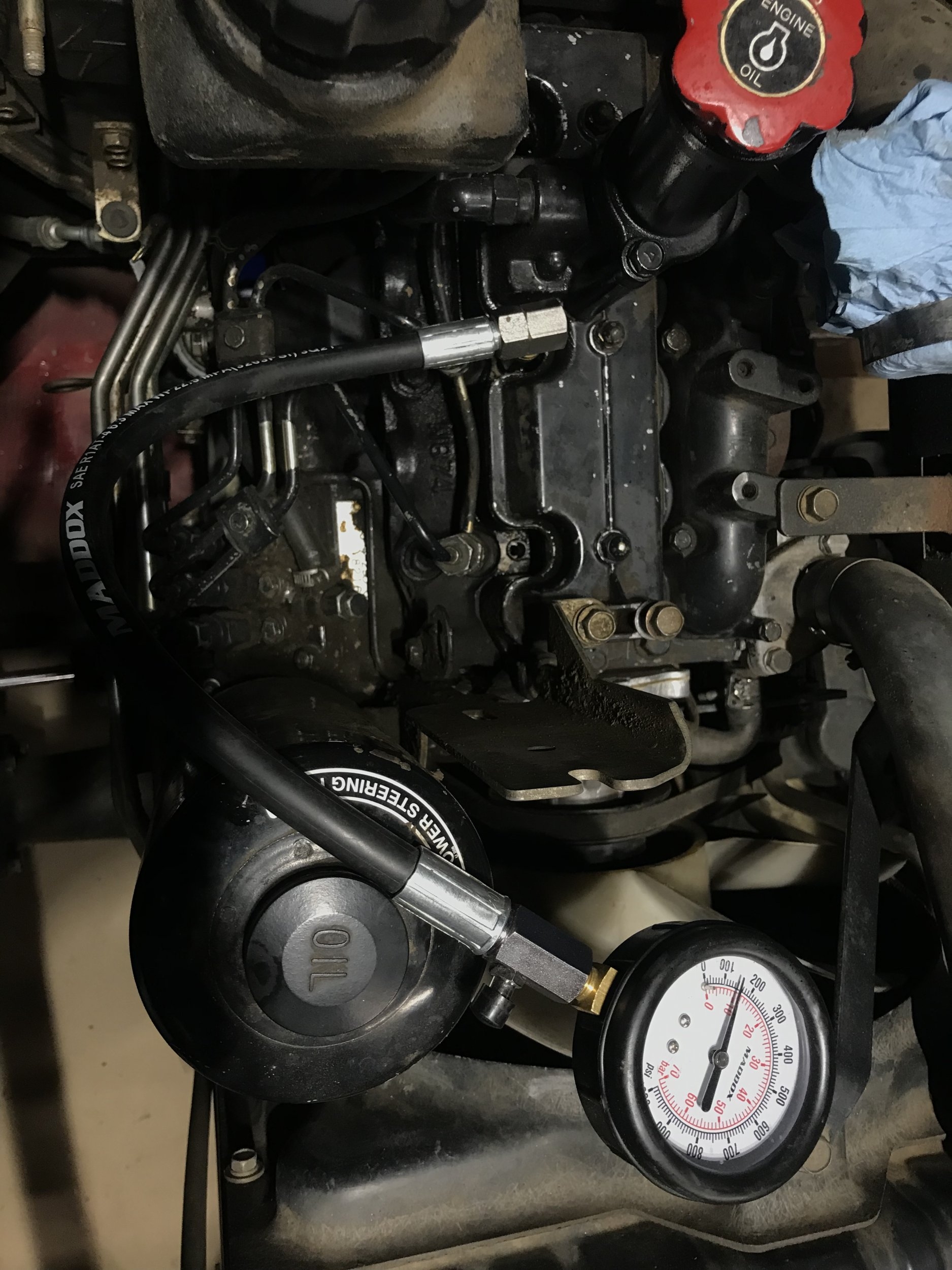

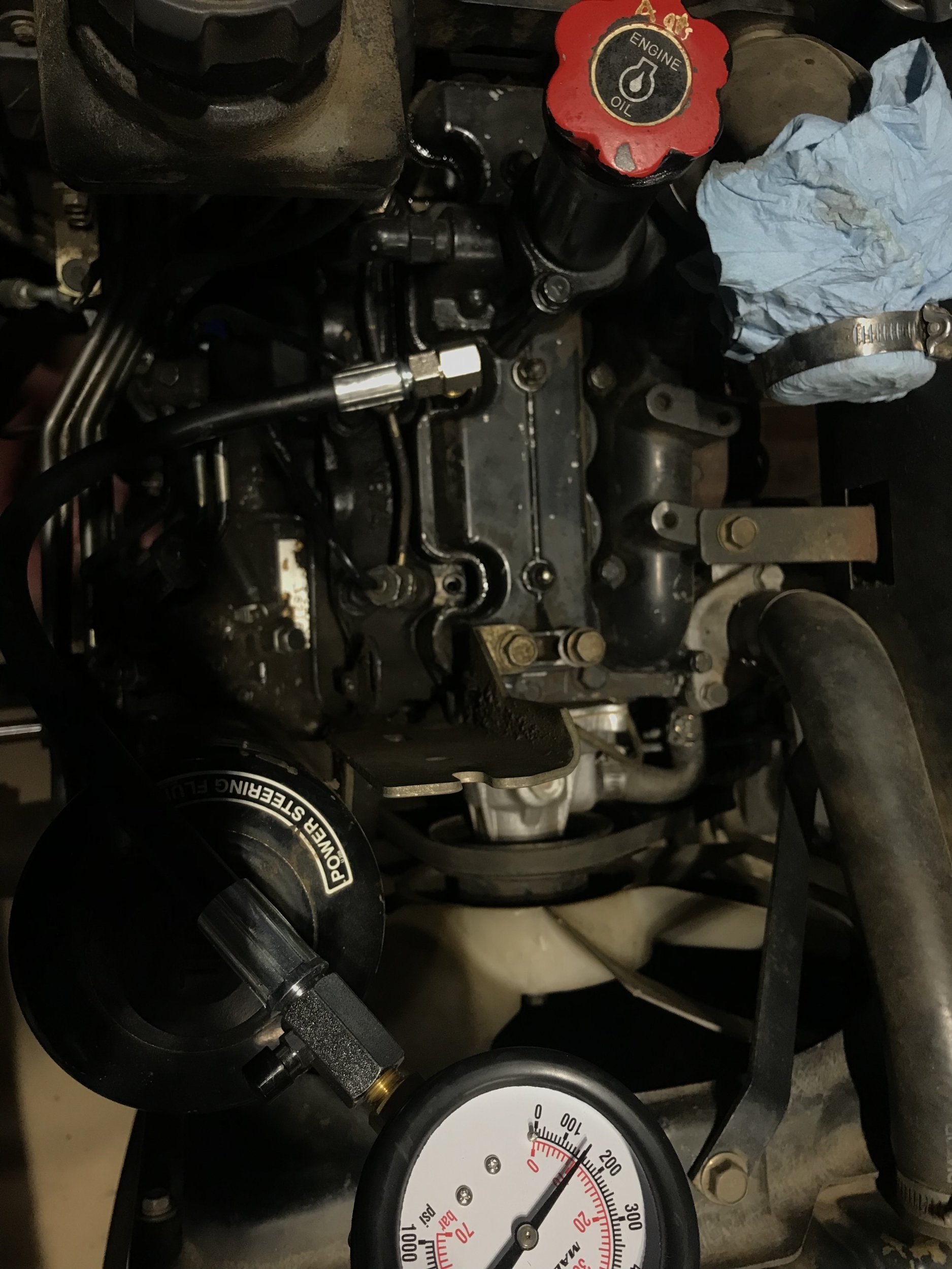

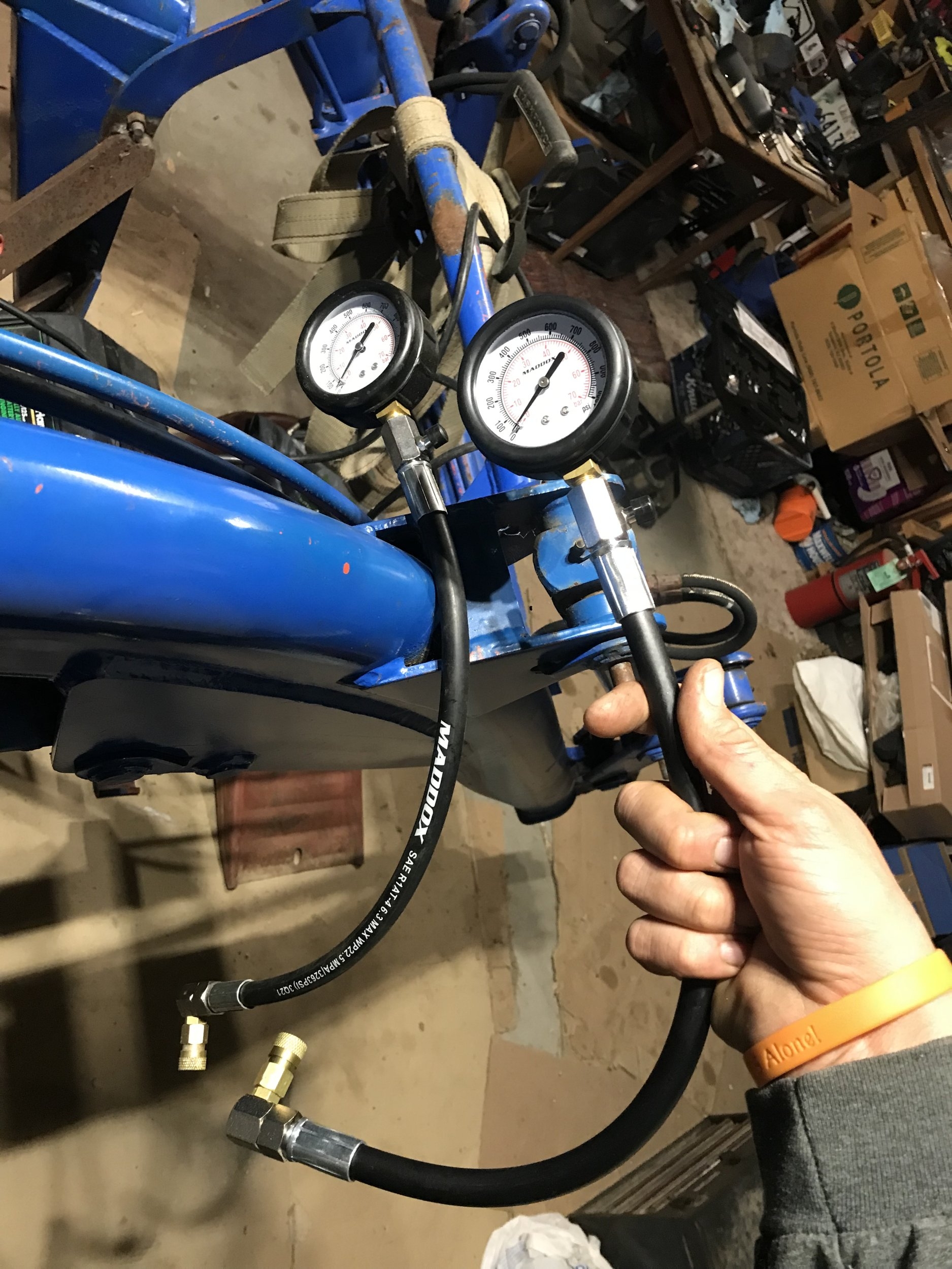

To the tractor my thought was to test my gauge to known good diesel (only one we have is a kubota bx1800) got it disassembled to learn my deluxe tester kit doesn’t have the correct adapter for it… lovely
So tried to rent one. Only gas ones available anywhere I checked oriley autozone etc etc
So I went ahead and purchased a second one with the intent of keeping if necessary and returning for other tools if not.
Tested compression side by side gauges measured within 5 lbs pressure of one another…

No surprise. Shops would go out of business if they had to double purchase every test instrument.

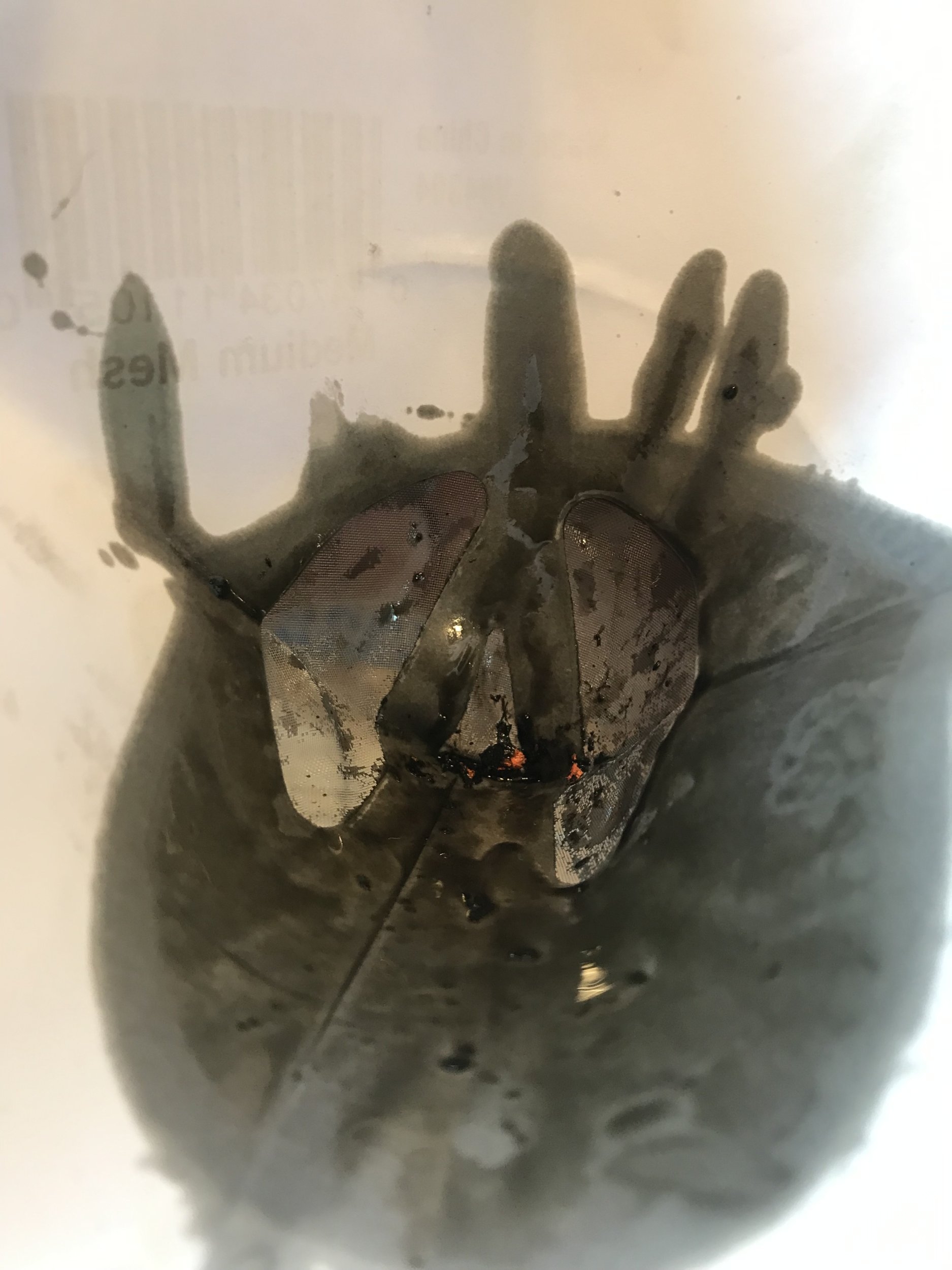

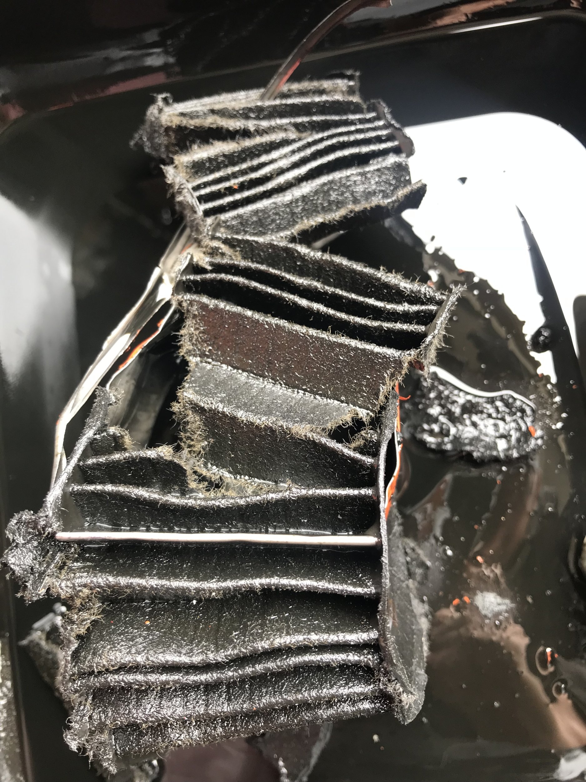

To screening & checking engine oil
bought paint screens and cut apart old filter with pipe cutter
Oil and filter were very dirty but nothing out of ordinary in catch pan oil filter or paint screen… found a few chunks of orange paint type material in screen was the most significant…
Agreed but it was mentioned multiple times so I thought worth a try

The low compression, blow by and the sound of the way it cranks would be enough for me. After all the years working on engines I can tell low compression by the sound of the way it cranks.
