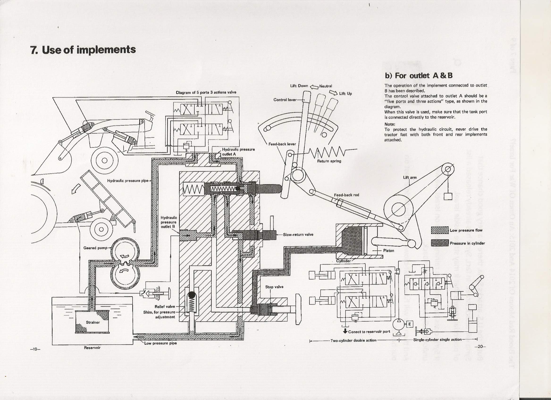

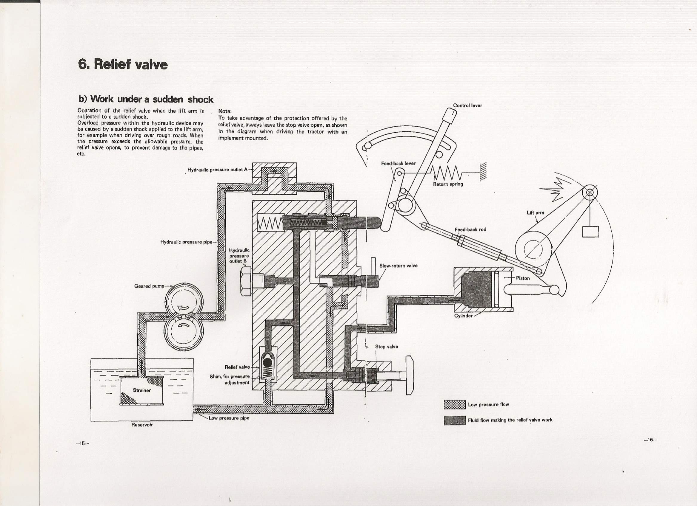

For what it's worth here are a couple of drawings out of the 240 hydraulic manual showing the block without loader and one with loader.

I agree with everyone's thinking. Since half the block is welded in there must surely be different top halves for additions. I just sort of had in my mind there might be a removable plug in there somewhere much like my old 2002d had.

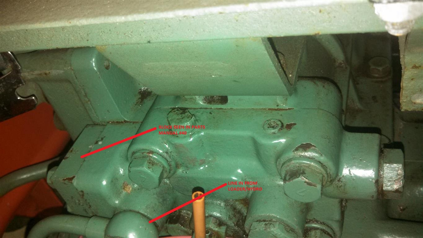

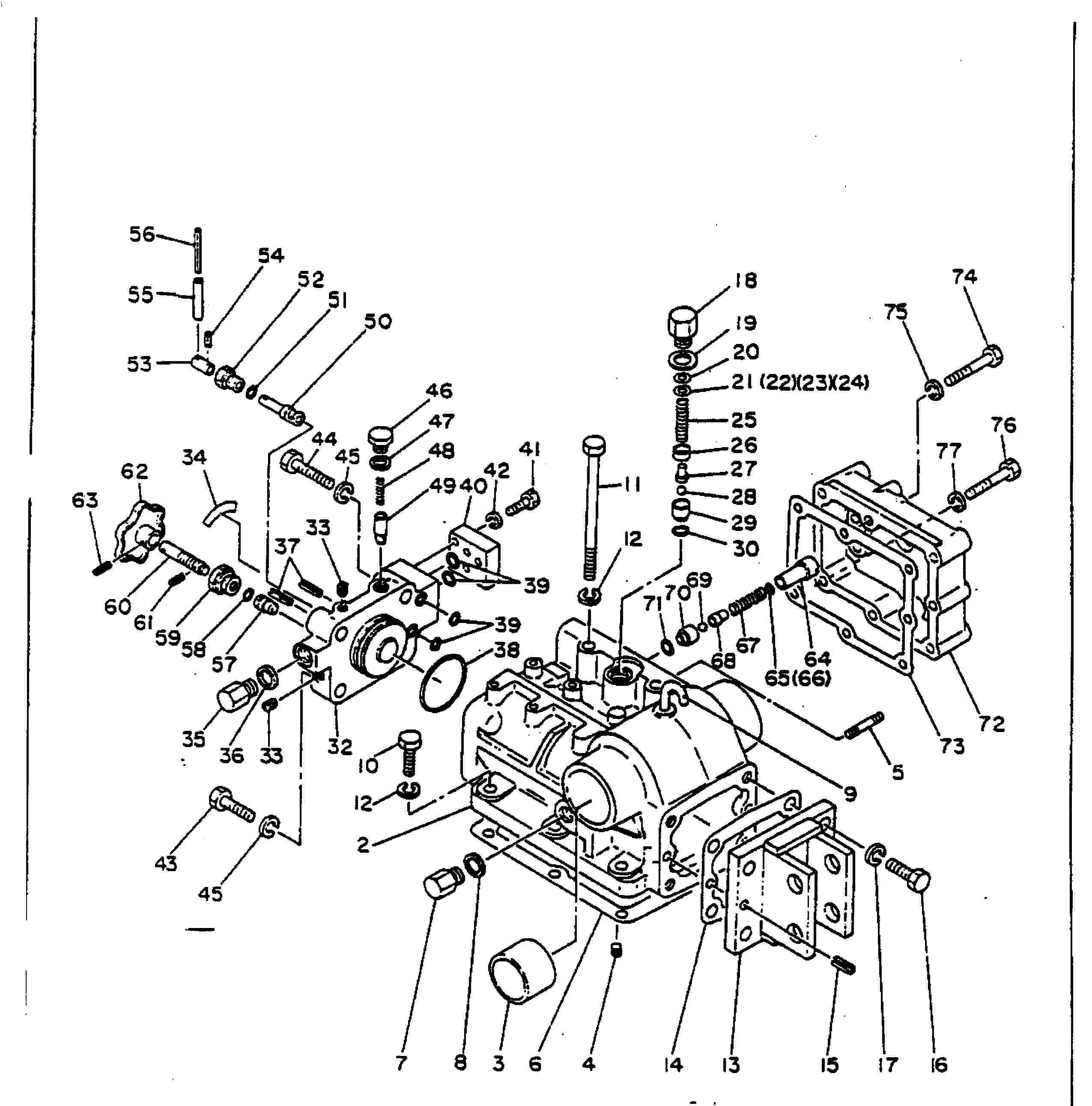

I agree - must take two blocks. Now...to hijack the post and complicate matters. Here are a couple pics from the parts manual for my 2210 and an actual picture. Similar block. Do you all think that this block is the same thing, just in a different spot? #40 in the parts picture. It bolts on very near to the place the hydro fluid hook to the 3 PT.
   / New (to me) YM240D #194
View attachment 442313View attachment 442314
No, I don't think your block works like the separate 240 block. I don't think yours can be used for additions. Just an opinion, not fact.

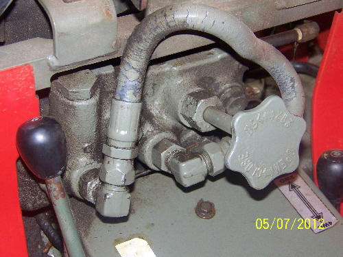

Todd8665, does your 2010bd have any plugs out by the stop valve handle like these on my 2002d. Notice the loop hose. I later took that off, installed a headless plug inside and plugged the openings. Those openings are for additional hydraulics such as a loader.
What is on the outside of your block? Plugs? Anything?
   / New (to me) YM240D #200
I don't believe i have anything like you have pictured here. There is a plug for a single action cylinder on the far drivers side of the 3 Pt works. You (Winston) commented on a post from a guy in Poland (i think it was) that wanted to add a remote from this - you drilled and tapped yours, if i recall correctly, to use with a cement mixer... Always wanted to ask you where you put/returned the fluid back from this setup. I assumed to the hole in the side of your transmission case?
