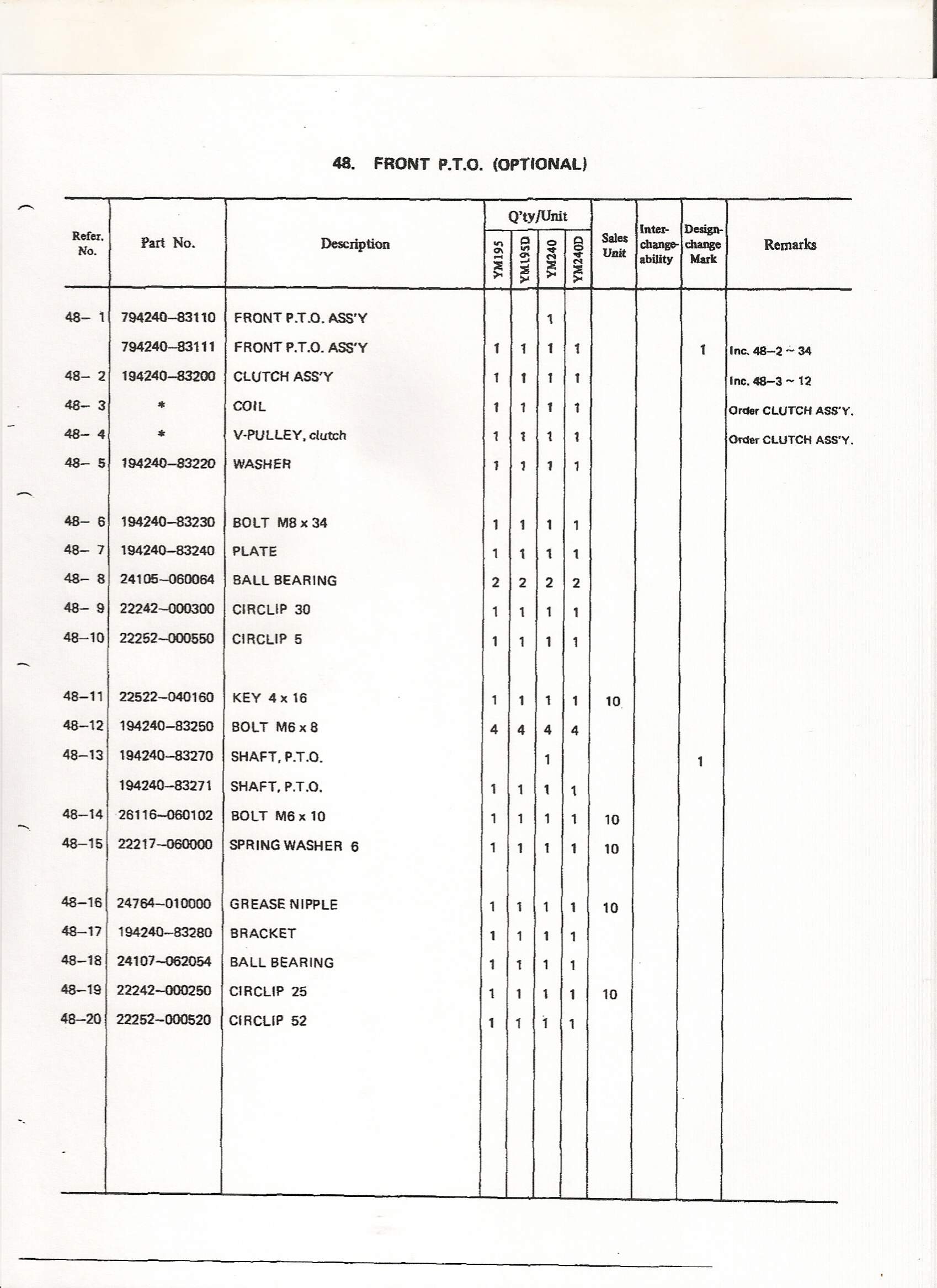

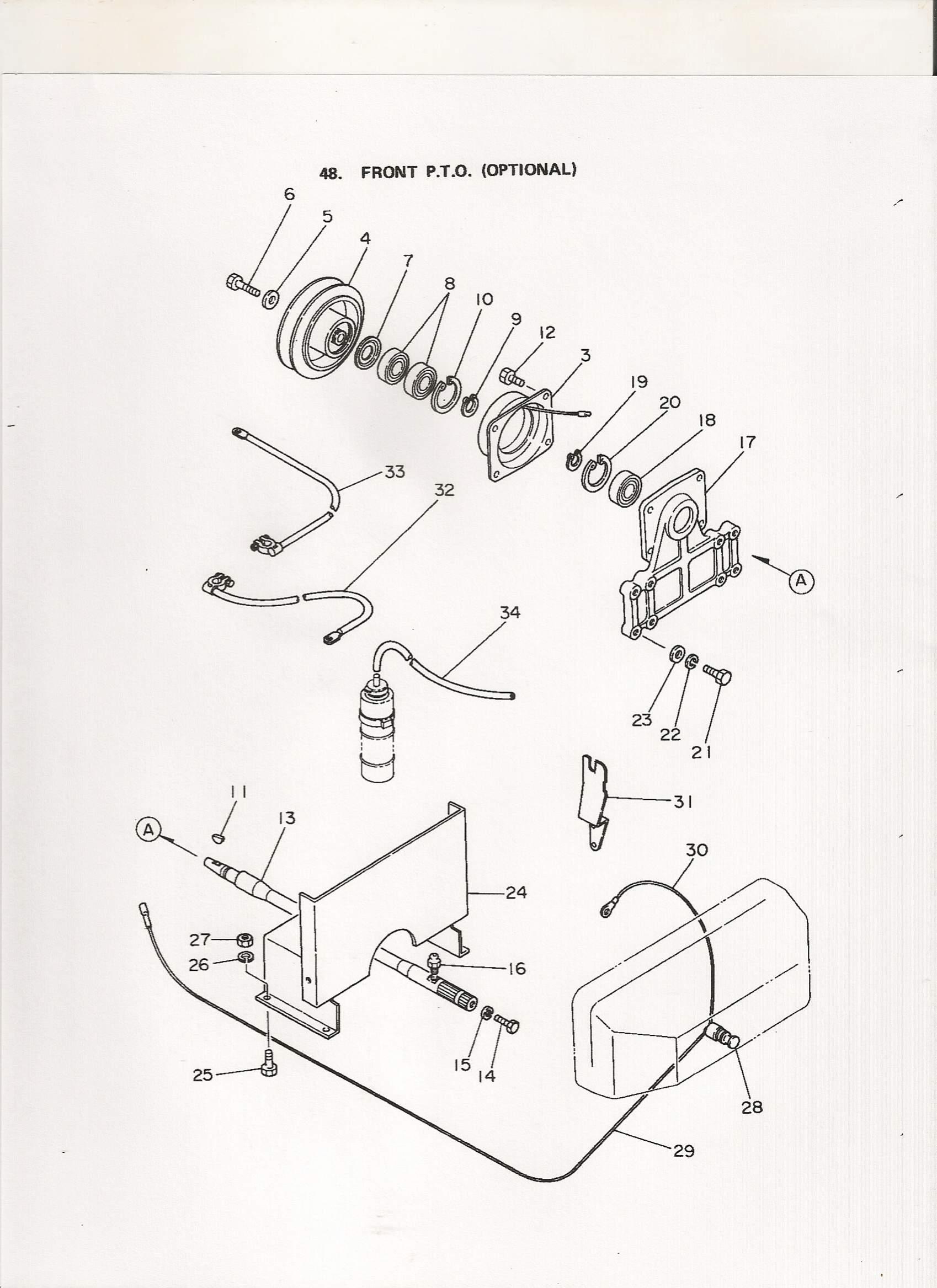

Thankfully my loader valve and 3PT lift-lever are both on the right side of the tractor so it's pretty unlikely that I'd operate both at the same causing damage to the valve. I really like your suggestion of using the front pump to run the loader. I looked over the front pto link you posted above. The only thing that looked similar was the cut-out in my hood. I suppose that gives room to open the hood even when there's a shaft sticking beyond the front bumper. My pump is actually mounted directly below the battery, completely within the footprint of the tractor so there's no interference with the hood. I need to figure out how to connect that to the shaft sticking forward from the engine and then make use of that for the loader.

Here is the front pto assembly out of the 240 parts manual. woolyacres, I sent you a pm.
