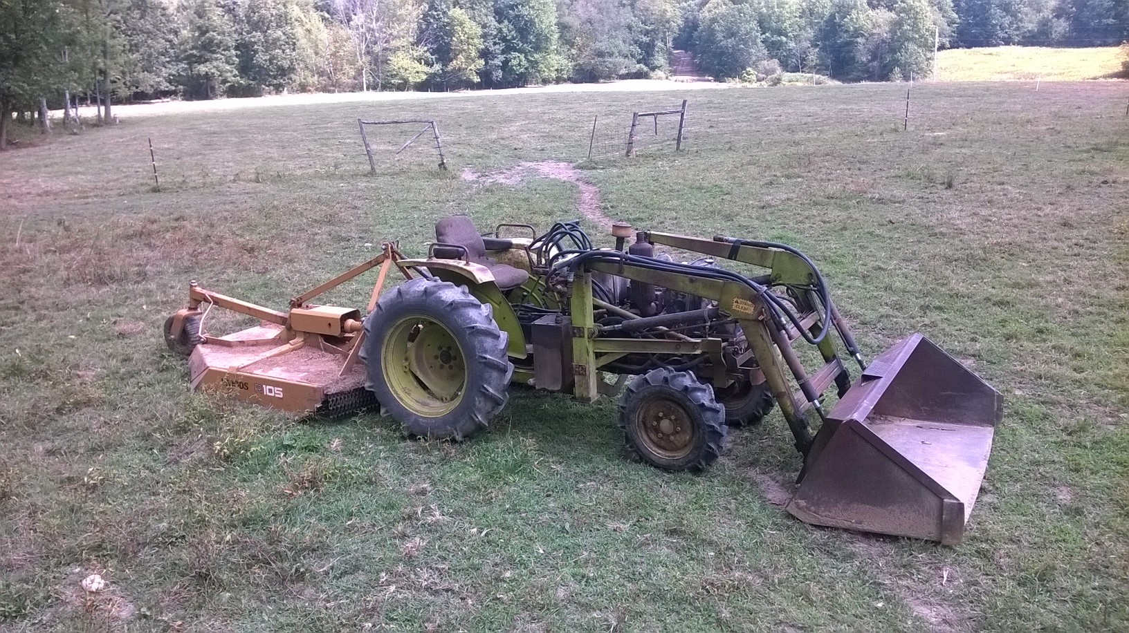

if that resivoir is full of fluid and the tractor could lift it on the 3pt then your main pump is fine . the weight of that tank and the fluid would be enough to see if its connected and not just barely working from a sheared key with just the wirling motion moveing the pump.
You can stand on your lift arms and pull the 3pt lever to see if its working . It wont lift you if its bad.

i would also just torch off the current bucket to a reasonable size. i doubt that you will find someone with a yanmar bucket just laying around. Maybe one for a similar sized tractor that you could adapt or if you went to a tractor junkyard but those are not common and they usually just sit in peoples yards wehn they die.

As per Todd8686 and clemsonfor's suggestion I went ahead and got something heavy on the back. See photo. Best I can figure that rotary cutter weighs more than 500lbs. The tractor did pick it up before running out of throw on the lift. The rear wheel of the brush hog would only ever get a few inches off the ground. I took that cutter for a spin as well and although it worked, my gut feeling is that was a bit much for the tractor. That's a pretty solid 5' cutter. I switched that cutter out for a box blade at lunch and left the 3PT hitch in the raised position. The loader was also left in the 'up' position. I'll check on it later today to see how far things have slipped. I'm sure the FEL will drop because I could actually see it falling just standing there. That's not hard to believe given the state of the lift arms.
I've got a lot to learn about hydraulics but my guess is that the hydro pump that currently runs the 3PT hitch and FEL is working. Will trouble with the loader cylinders cause the rear to drop as well?
