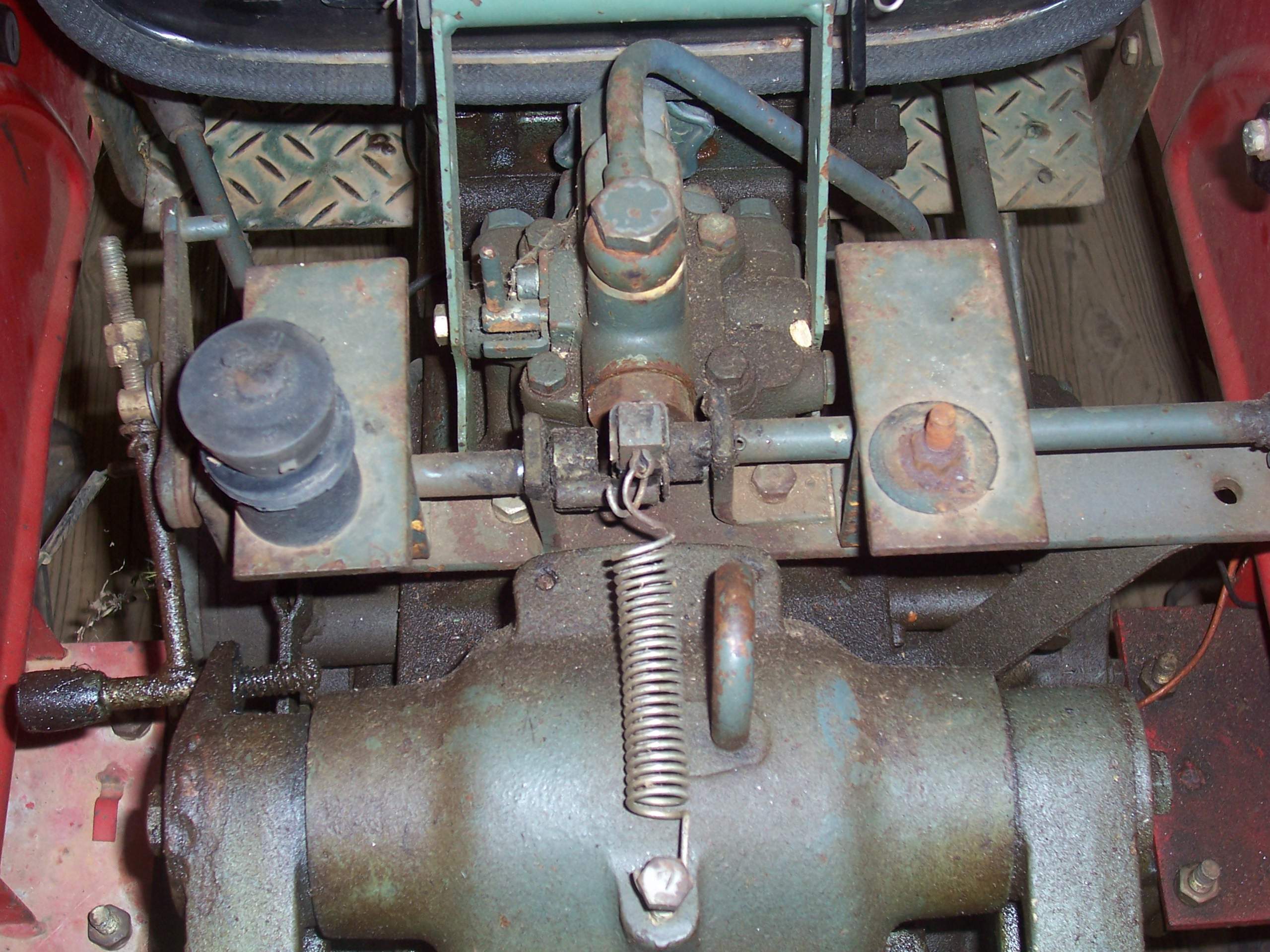

"On your YM2000 do you have a diff-lock? Is the lever under your right foot? When you push that lever does it move the PTO 540/1000 lever? Maybe I should be more concerned about getting my PTO engagement right?"
The pto shift lever swings on the diff. lock shaft and is frozen to it. May have to remove pto ***'y. to free up. Woops!! can't hyphenate "assembly".

The shaft runs across from the Differential Foot Lever to the PTO Shifter. If you look down to the right in the Pic., Where the Seat Bumper is removed your see the top of a Roll Pin and a red dot. That is were the Diff. Foot Lever is connected to the same shaft as the PTO shifter Assembly.:) It's probably bound up on the PTO Gear Selector side.

Yes I think that's the one I recall. But looking at it doesn't tell me as much as I had hoped to see. Listen to Norm and Carey on this one.
I'll check this when I get home on Saturday. Winston also provided a diagram that I hope has things labeled well enough to see what connects to where.
