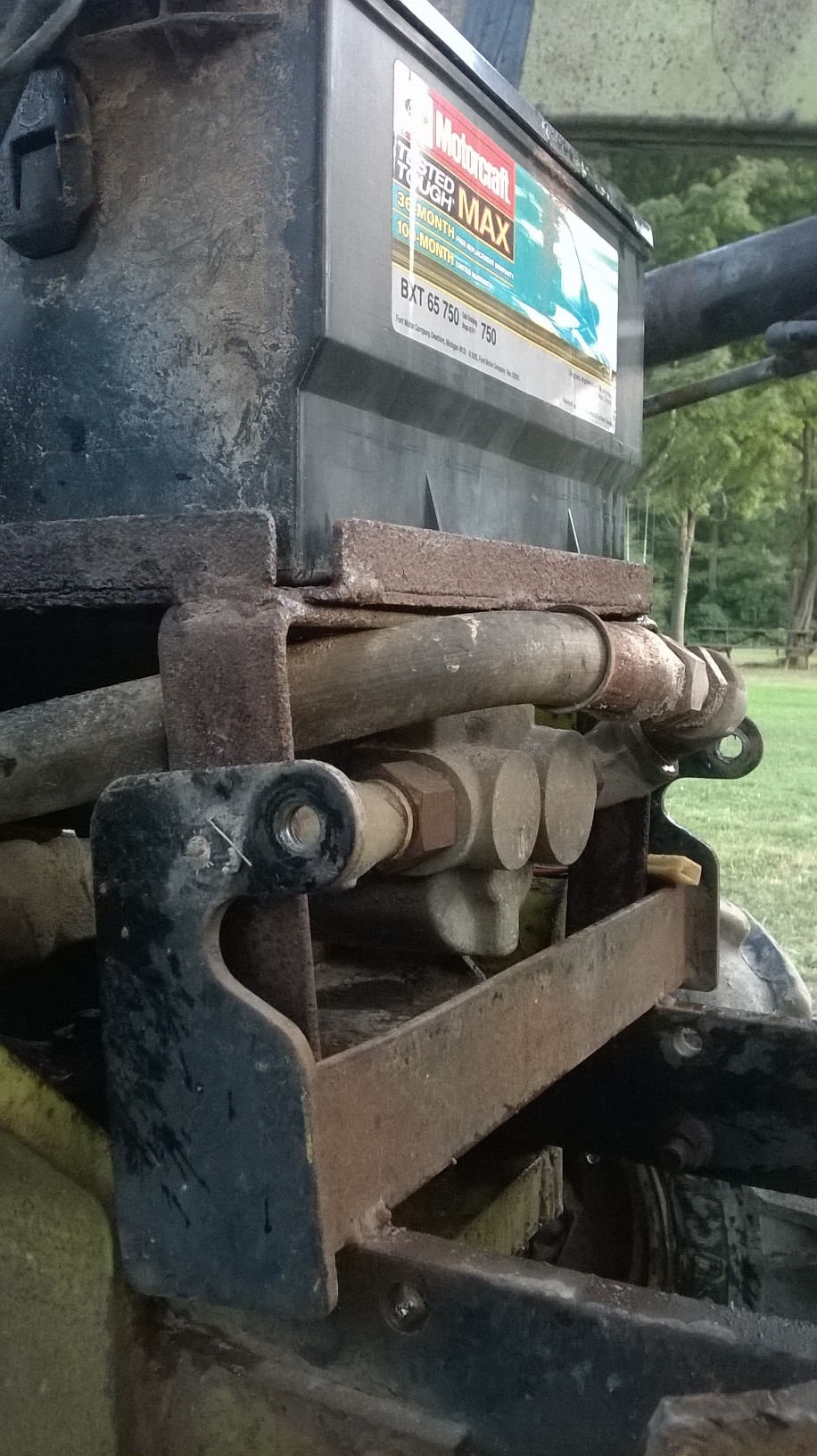

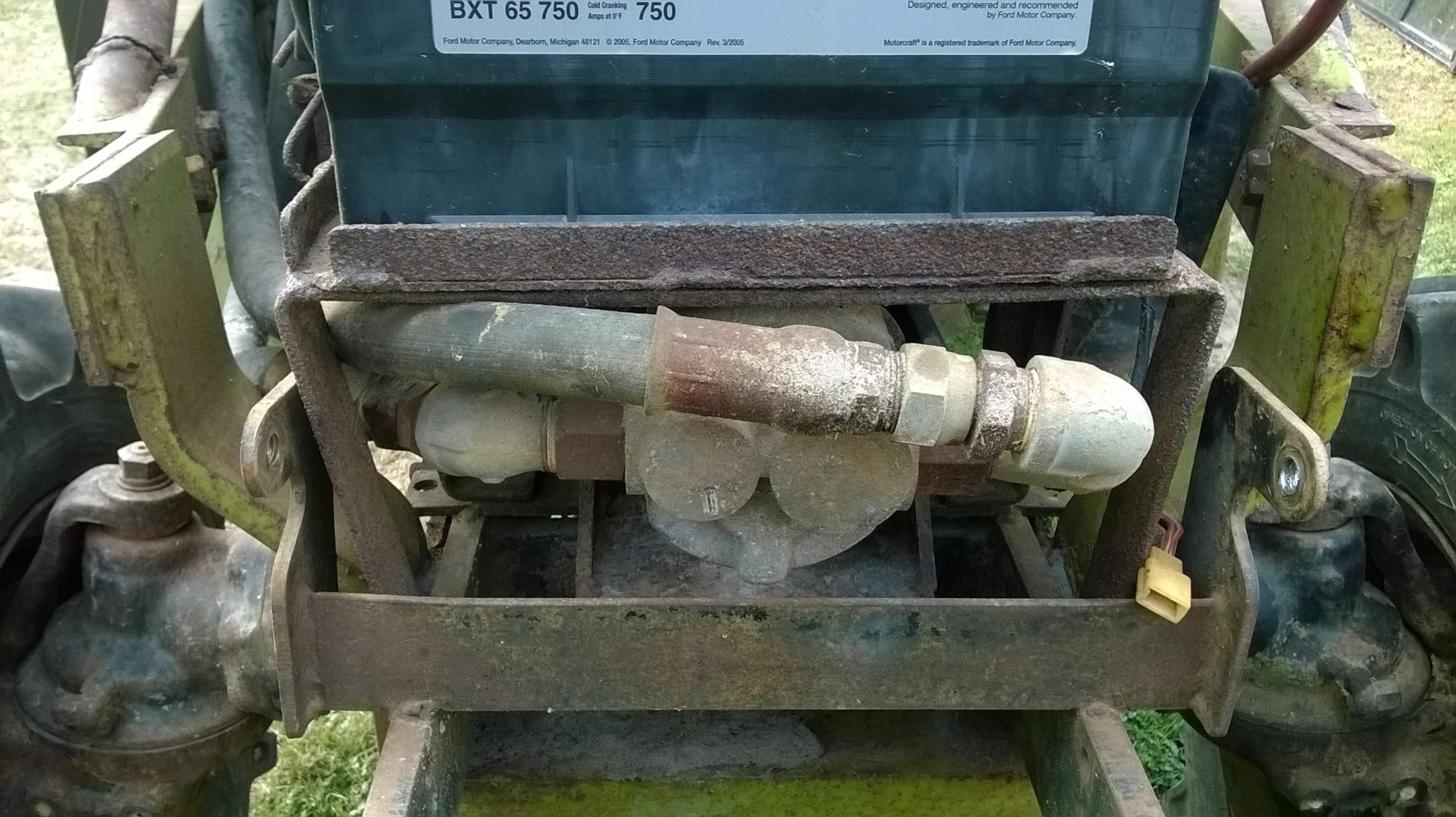

You're absolutely right about the front PTO no longer powering the pump. There's some kind of coupler missing between the shaft coming forward from the engine and the shaft on the pump.
However, I believe the loader was always connected to the tractor hydraulic pump. I think these two other pumps (the front one in the photos and the big rear-PTO were connected for some other reason- presumably the post pounder and maybe a hydraulic tilt for the pounder. Or maybe a big spinning broom, with a hydraulic adjust for that?
I haven't been able to identify what exactly fits between the pump and the front PTO shaft. I've been told it's something like a 'lovejoy' coupler or shear-able union. That sounds like what you'd want there-something that would shear if the pump bound up. I may have to remove the pump and take it somewhere to get that figured out.
As you and California have both suggested- get it working better as is, before redoing everything. I'm on board with that and I'll start with that leaky cylinder tomorrow. However, I haven't located a hydraulic shop very close to home so if I end up taking a cylinder 45 minutes away to get seals I'll probably take this pump with me to see what they can tell me about the coupler and possibly, the state of the pump itself.

The plumbing is an absolute mess. The quick connect lines you see where plumbed into a valve that worked with the rear PTO pump. The two lines coming off the front pump go to/from the reservoir mounted on the loader frame. Strangely there is no valve for it and the lines basically go in a circle. It could well be they used that front pump until it broke, then just put a bigger unit on the rear because it was cheapear/easier.
Just a little rambling for what it is worth. "IF" the electric clutch is what is missing off the front pto it would first be very expensive if available at all. Next, if you hooked it up direct I am just wondering what kind of drag that would put on the starter having to turn the pump while starting. Might not be a factor, just rambling, just something to ponder.
I looked at the cost of pumps similar to this one and they aren't terribly expensive (I believe under $150) but hadn't thought about a clutch there. The loader is PRETTY slow at the moment which is why I'm interested in getting the front pump to work, but if an electric clutch is needed that might put an end to it- both availability and cost. You're point about drag on the starter if it were constantly connected is something I hadn't considered. However if that hydraulic system wasn't being asked to do anything when starting the tractor would that do anything to reduce the drag? I guess not. The pump would always be providing flow and pressure regardless of any valve being actuated and THAT'S what would cause the drag.

Go to Dl601-9. Sort of looks like what was there. MF Hard to Find Parts
That does look pretty close, though it looks rigid. Do you think that would provide shear protection? I am interested in getting the front pump going but not at expense of damaging other components....
