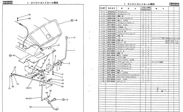

So I put everything back together but really wanted to make sure that the linkage was all tight and not going to cause any problems. Well I always thought that the throttle was hard to push and pull so I took it apart to change out the friction disk and check it out. Well of course the ball detent was missing and a washer was in the place of a friction disk which was causing the part where a ball detent is supposed to not be there and just causing friction against the metal. Well I called Hoye to see if I could get a new spring but they don't have any in stock does anyone have any idea of a replacement equivalent that I might be able to get locally?
hmm, I already forgot your location as it's not in your avatar profile pix with each post. I would recommend asking Hoye what size of spring and the load compression. Then head out to Tractor Supply central to the USA, or ASC in the South East, or Farm and Fleet in the eastern part of the Mid-West, or maybe your local ACE Hardware store.
The Parts Manual on pg-11 item-13 shows the spring as p/n 104200-66820
On the web, the Yanmar Spring is listed as a FSC 5360 industry standard. Just what does that mean then? Well, upon review of the number, it's very common in automotive to hold the rear shoe pads on a brake drum.

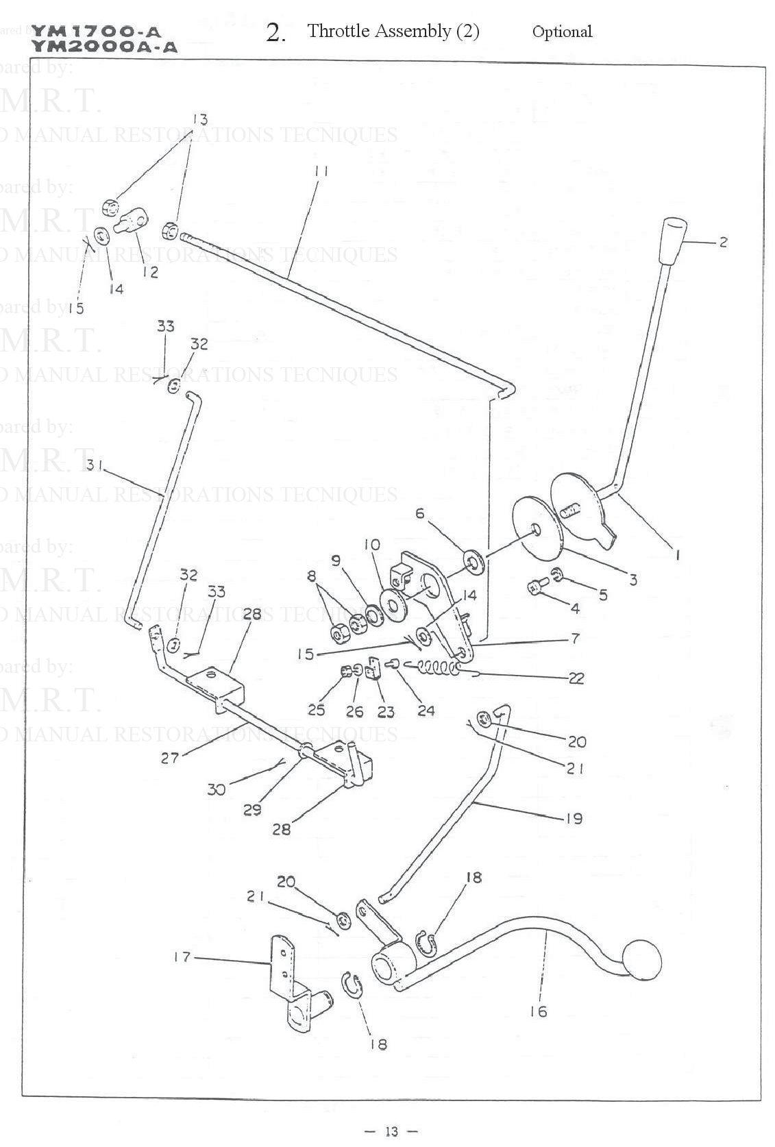

/ New to me YM2500 #73
This should be the same as yours. Fredrick's refurbishes the YM2500 they should have it used if not new. Not much to it. Cheap on Ebay even SPRING THROTTLE RETURN | eBay
No detent ball that I recall.

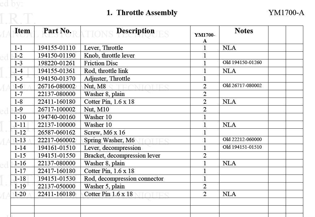

So the speed control assembly on mine looks different than what you have. Mine looks like this. If I can't find an appropriate spring then I guess I will bite the bullet and overpay for a single spring. If anyone happens to have their spring out and can take some pictures and measurements that would be awesome as well since they are apparently becoming rare and would be good to have another source when someone is looking to find it.

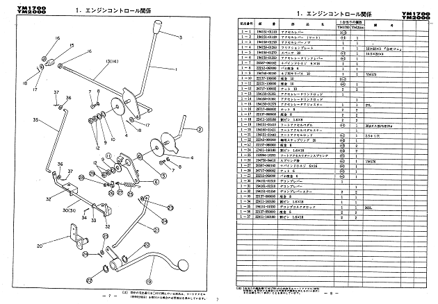

I do have the hole just below the #7 Nothing to attach a Spring or a Chk. Ball to the handle side. Maybe something with a JD. 240 or a Prod. of a later model. My YM2000 was so Org. They may have removed it. Which could be true since the paper thin PD. disintegrated and The mounting stud easily Broke. That could be very true getting all they could out of it. It looked as though it just rolled off a boat!! Which was a big plus knowing it was Org intact.
/ New to me YM2500 #78
Not sure if your machine is a Tree Frog or a Red Apple.
The Tree Frog setup YM2000
The Red Apple setup YM2000
