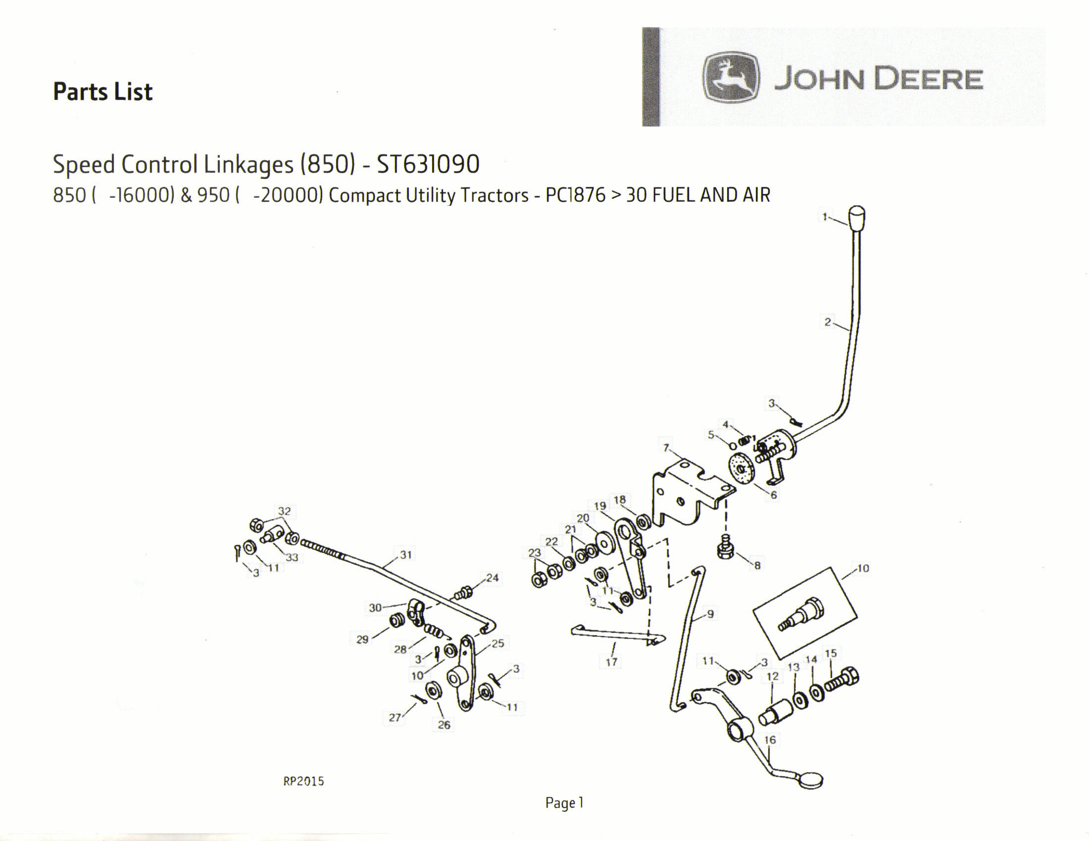

Per Winston's posted diagram, friction washers or a spring keeps the throttle lever from slipping back below idle. Mine slips from 1400rpms to just the idle detent. I know, I got to check mine out too. BUT, mine doesn't slipp past the detent to turn off. Thus, you have 2 issues to contend with.

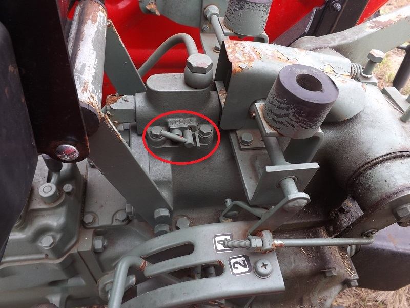

So I had a bit of time to go out and see if i could get the idle sorted. But can't find the reason. If i drive the tractor around it runs fine but there is not pedal response and or you will hear it surge then drop in rpms. I took a video of me pressing the accelerator and then you can hear it fumble. I then save it by pulling the lever. I then slowly move the lever forward to try and get to a lower idle but you can hear it lower and surge till it eventually dies when the rps are around 1200. My next step is to put a clear hose and make sure there are no bubbles in the lines etc but i find it hard to believe as it runs awesome when at 2200 rpms or pto speed.

Speaking from experience, a pin hole air leak can cause very weird behavior in a diesel; stumbles at lower speed, stumbles under load, excessive fuel usage, and overheating exhaust. All caused by poor injection behavior of the fuel being too compressible with the trace of air in it.

When the engine is running, I keep hearing that 'tinned' sound. Our machines have the same engine and at the very low idle it sounds like my engine, but increasing the RPMs it sounds so strange.
There is a governor rod inside the engine at the very bottom and to the governor at the back of the engine. Pulling off the bottom oil pan you can examine this. The trouble is, you will then need a replacement gasket for that pan cover.
If that rod is bent or not correct, it would explain why the engine drops to idle.
With the throttle linkages, are there and weak springs?
