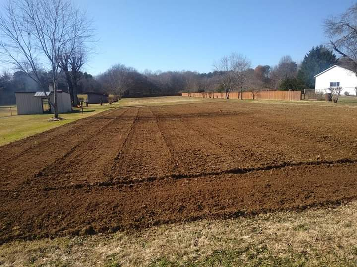

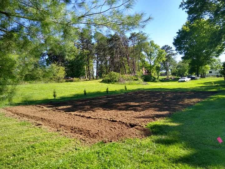

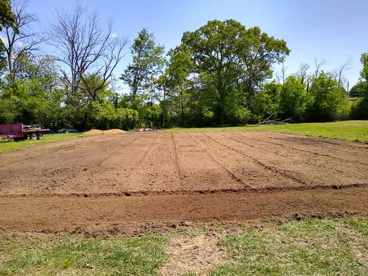

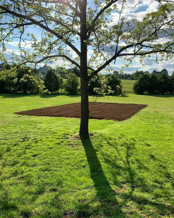

One of my regular customers.
Done with 1626 shuttle and TSC Tarter 5'
