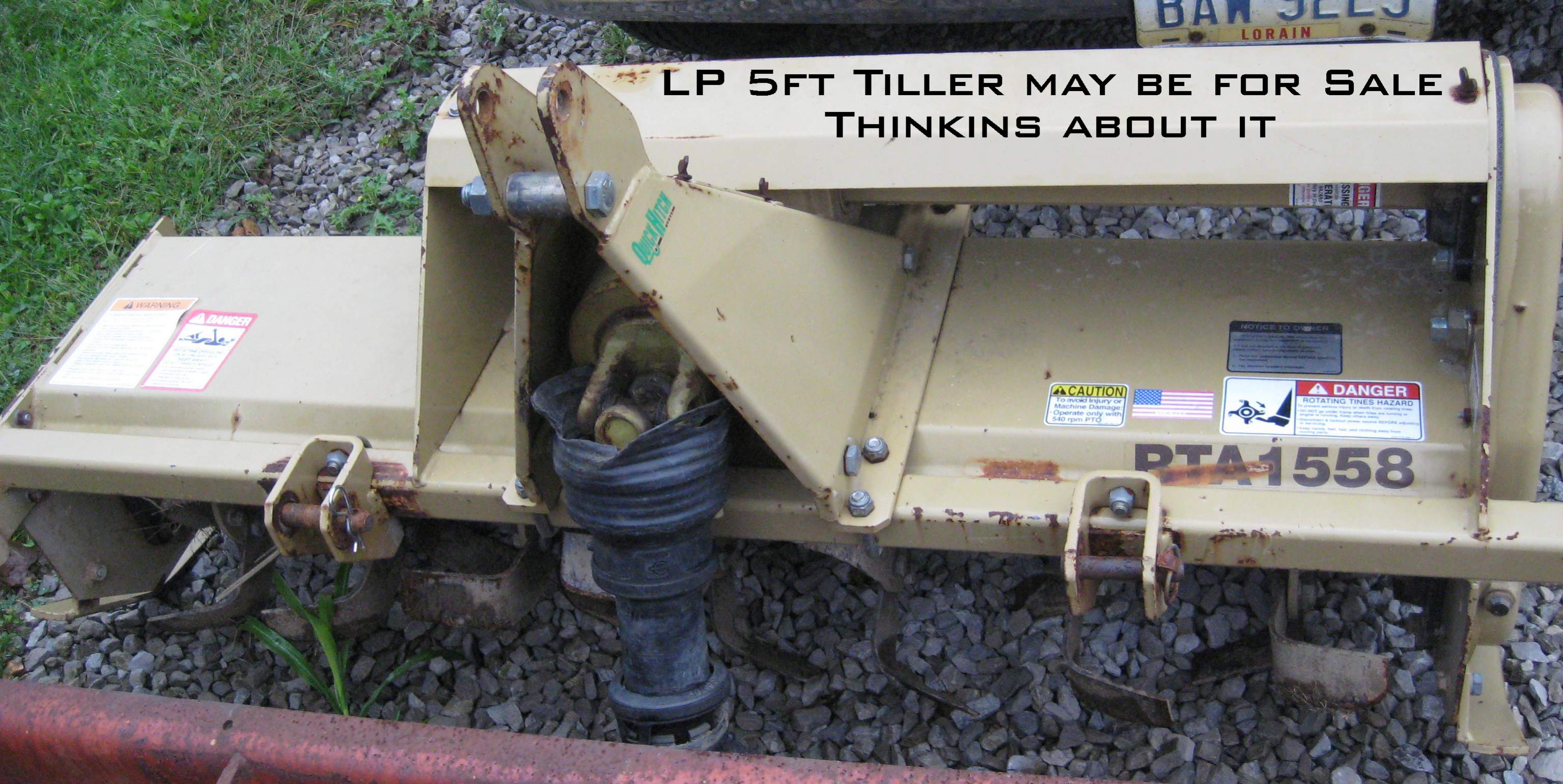

I have a neighbor with an older 5ft tiller, so we may just share. It's a Land Pride unit and looks to be only a few years old. Photo attached.

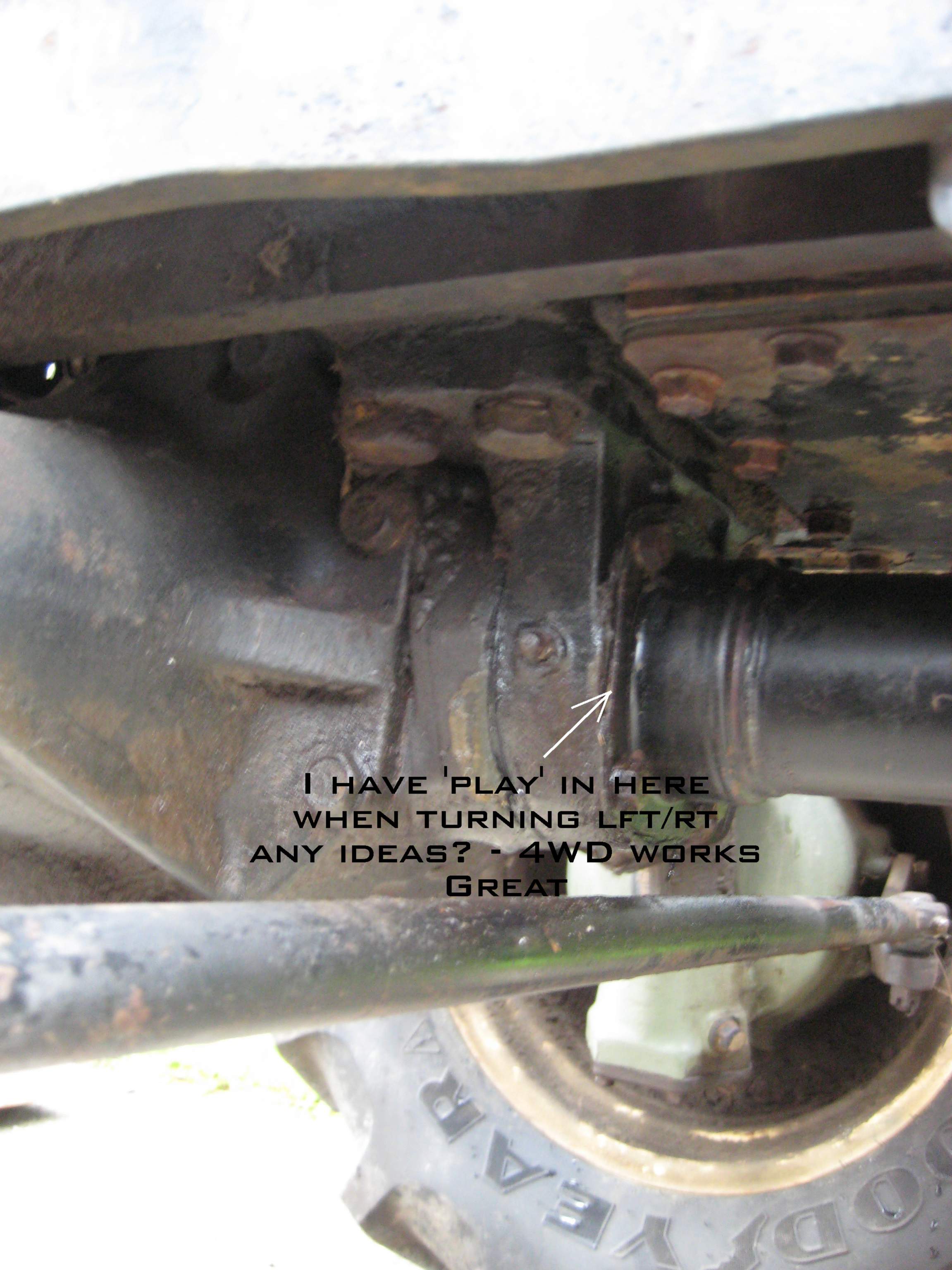

Ok YM Gurus......... I have a (what I think) is a minor issue.
When steering, I get a bit of play. Upon inspection, the yolk of the front pinion seems to be slipping back and forth about 1/8th inch. There are 4 bolts around the housing, so I think cranking them down will take care of that.... SECOND, will I lose all diff oil without a gasket in there....... (see photo)

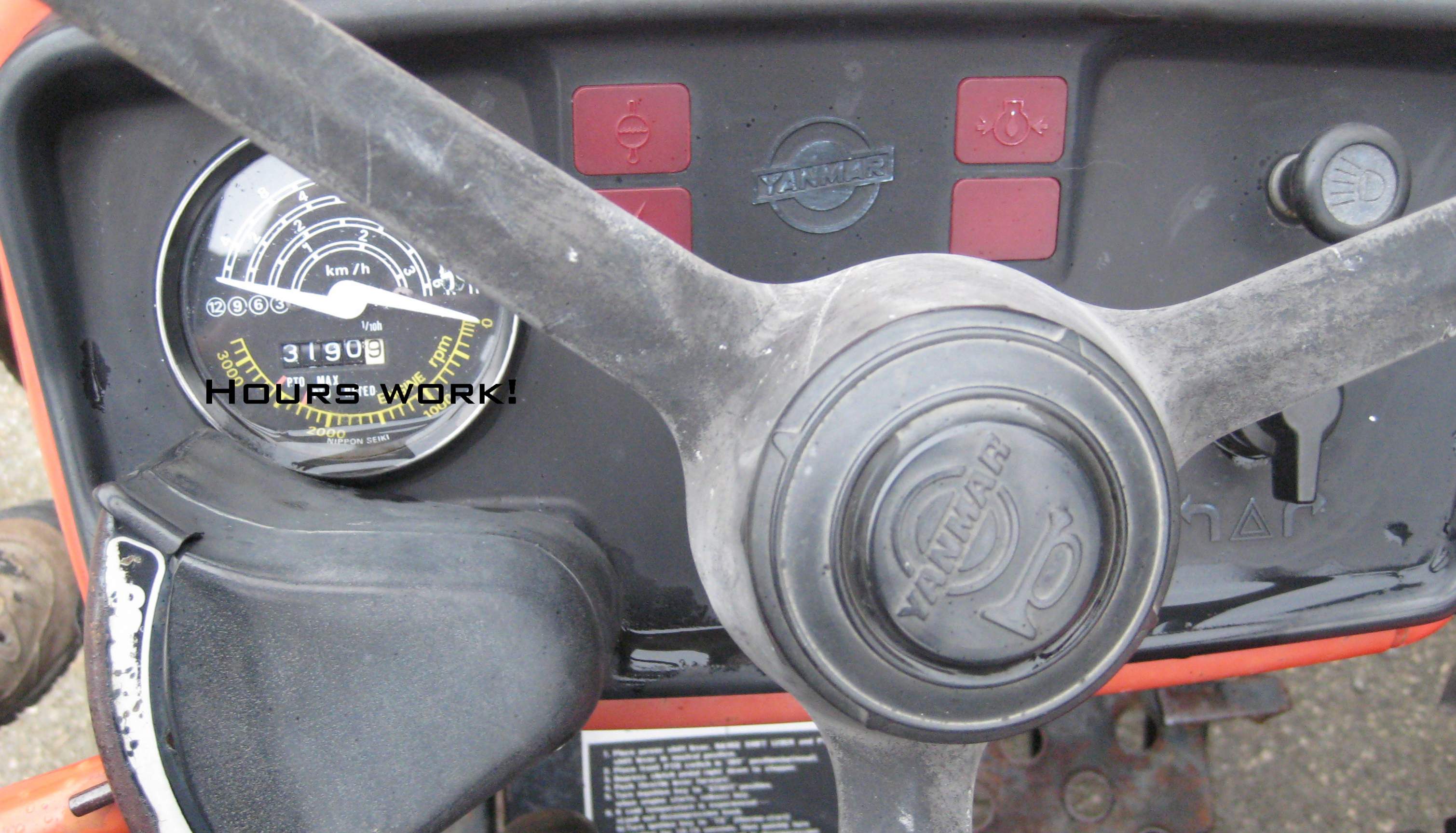

Ahhh... Hour meter works too! :)

There should not be any fluid in the drive shaft cover. If you are leaking 90 wt your front pinion seal is leaking. If it is hydraulic/transmission fluid your drop box seal is leaking. Here is a picture of the old style. You can click around and see the new style. http://www.hoyetractor.com/mm5/merchant.mvc?Screen=CTGY&Store_Code=HTE&Category_Code=3364WDINT-OLD

I believe there is a bearing in that location. Notice grease fitting ? May not have been greased in a while or bearing could be worn. Have you tried to grease it?

My 336D was loose in there as well. I removed the play by loosening the two (4?) big bolts which hold the front-most center bracket (the bolts are vertical going up into the hood assembly) in place and banging the bracket forward, then re-tightening. Just be sure the axle is all the way to the rear of the play, so when you slide the bracket, it goes all the way. There should be zero play in that pivot.

Noticed the grease fitting also. NO, I have not greased anything yet. (next order of business on a dry day). there is a bit of front/back play but may be some greasing would help, but it really looks like the main retainer bolts need snugged up.
