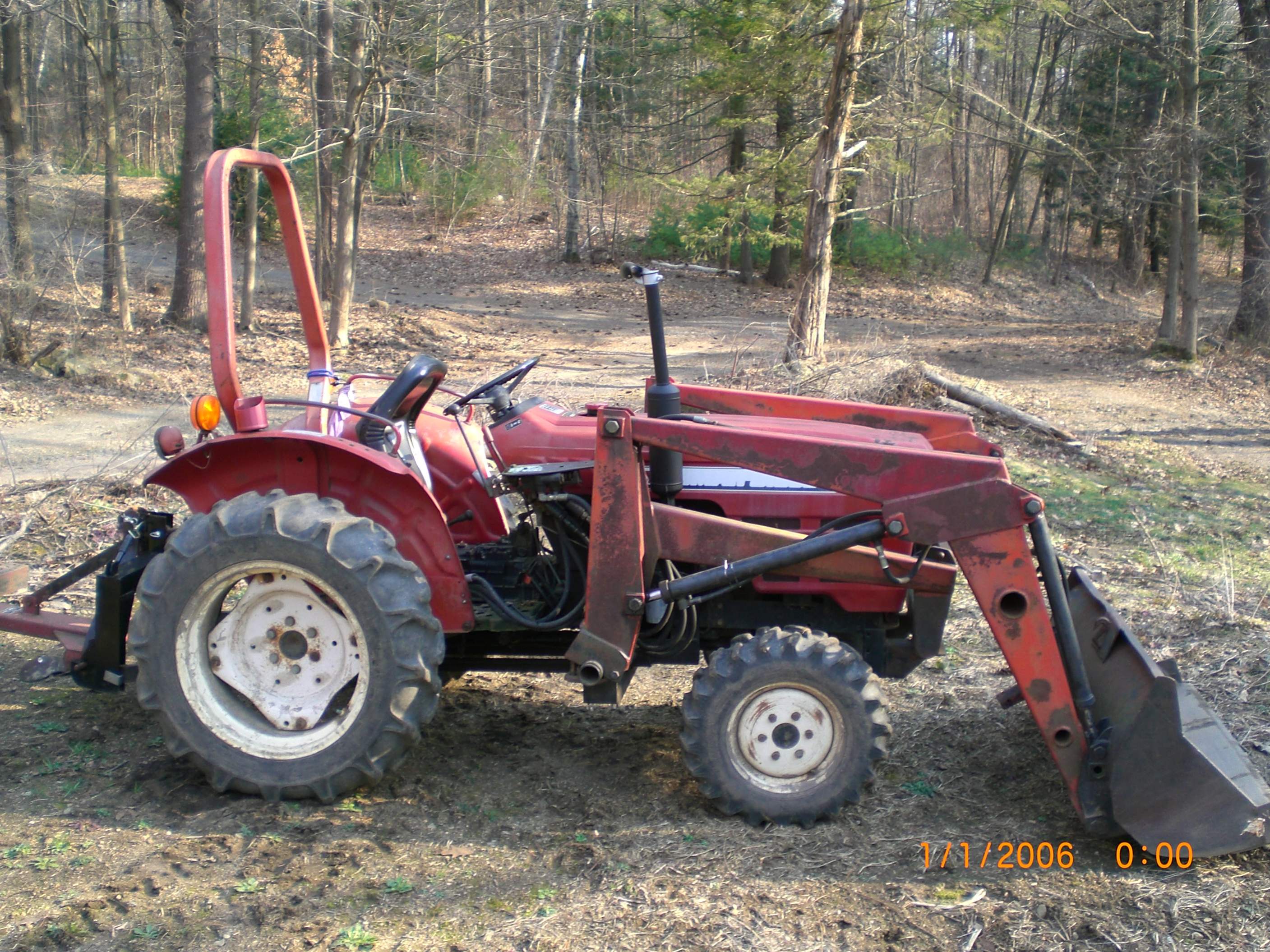

I have a 276D/loader. (27 engine HP) It's a real nice tractor. I paid $6K. It had 870 hours. I bet you'll like it.
