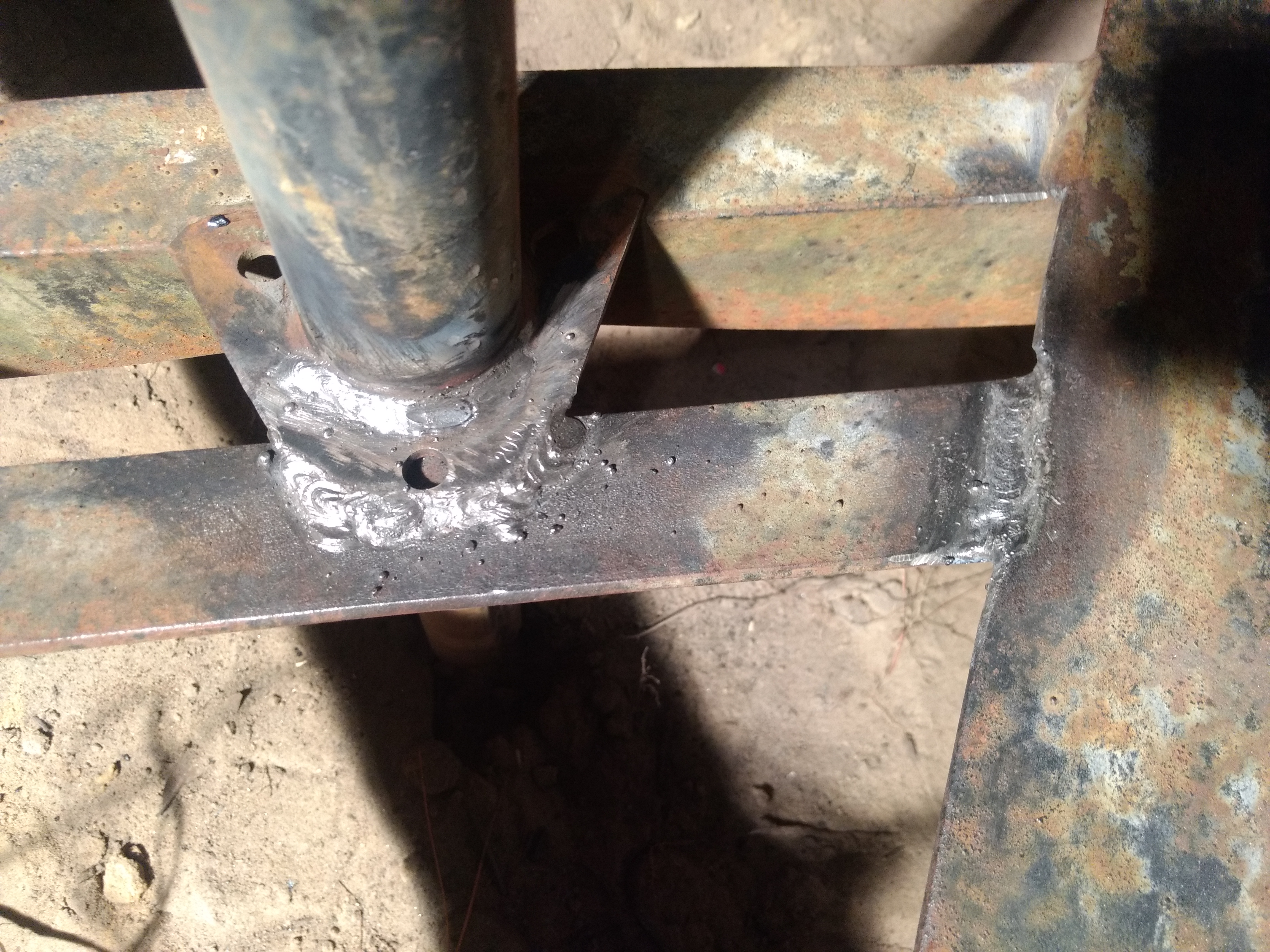

Did my first repair last night on my utility trailer. Three places were cracked or completely broken. Most everything was flat position, but with the welds curving or cornering on two of the repairs it felt completely foreign changing my weld in flight. They will hold I believe, but didn't feel comfortable or as nice as I want them to be. So yeah, as I knew already lots more practice needed before I tackle other stuff. Just sharing

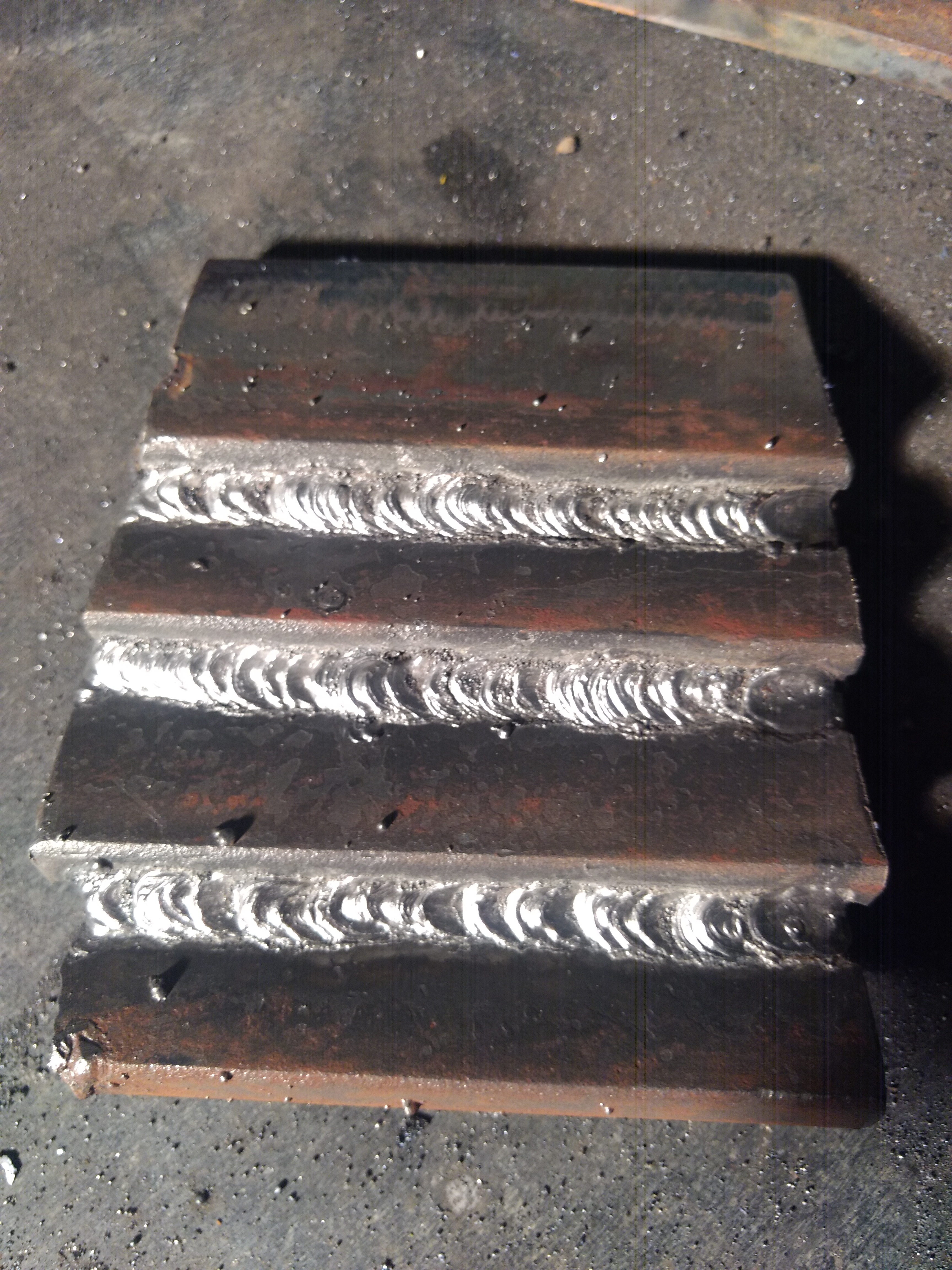

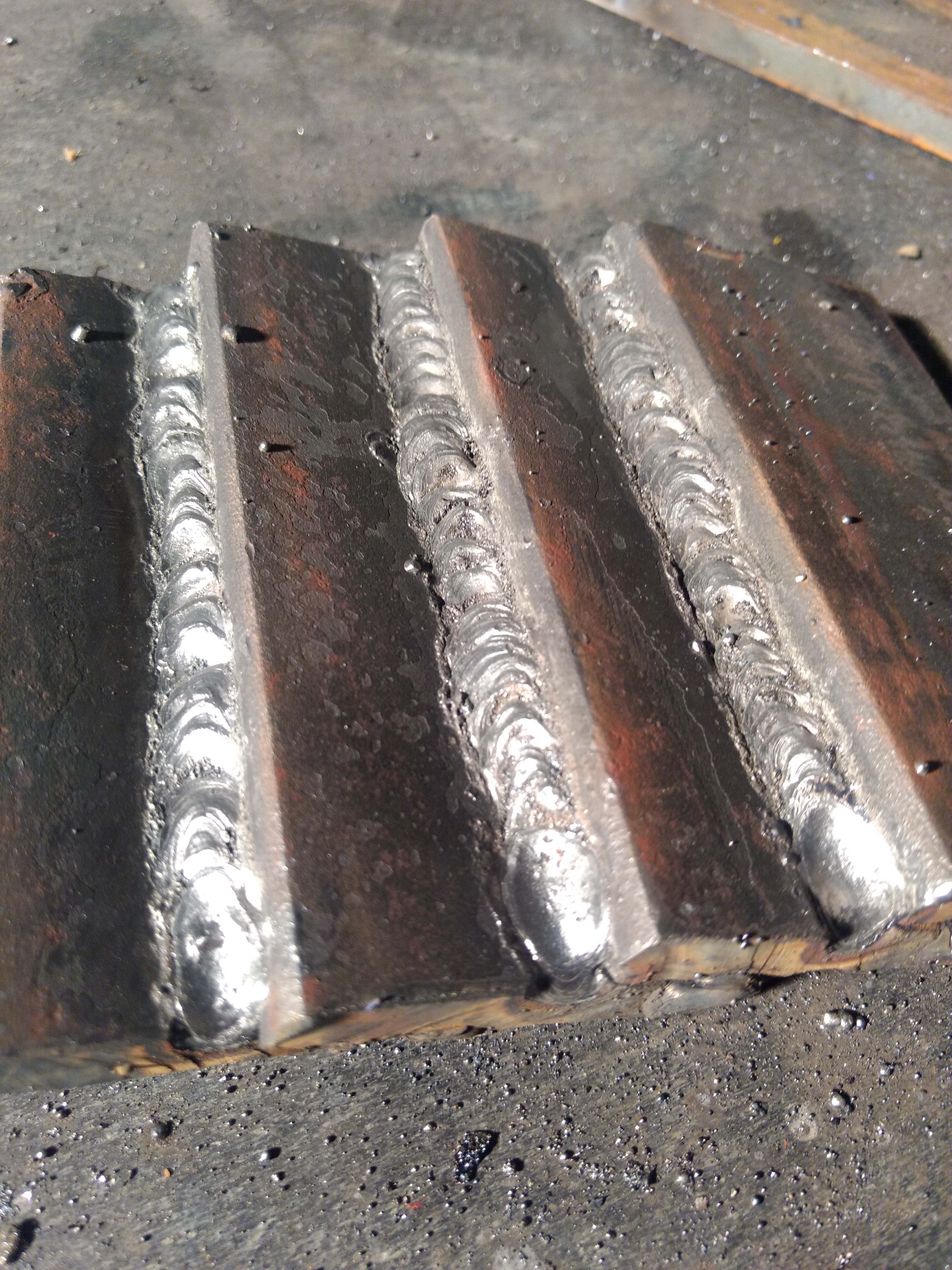

I had enough time to get 6 lap welds for practice tonight. This was the last 3, and better than the first. Not near as easy as flat on a piece of metal. School me!
   / New to welding #139

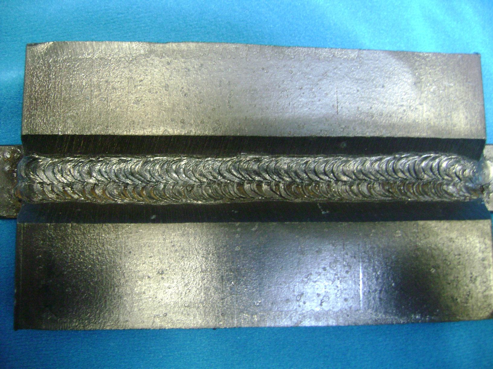

Not bad at all. It will take some time to get the perfect stack of dimes.
Little trick for you. When you get ready to stop, back up just a touch, and push the rod into the puddle some. This will help fill in the crater. An under filled crater is where a crack will start.
