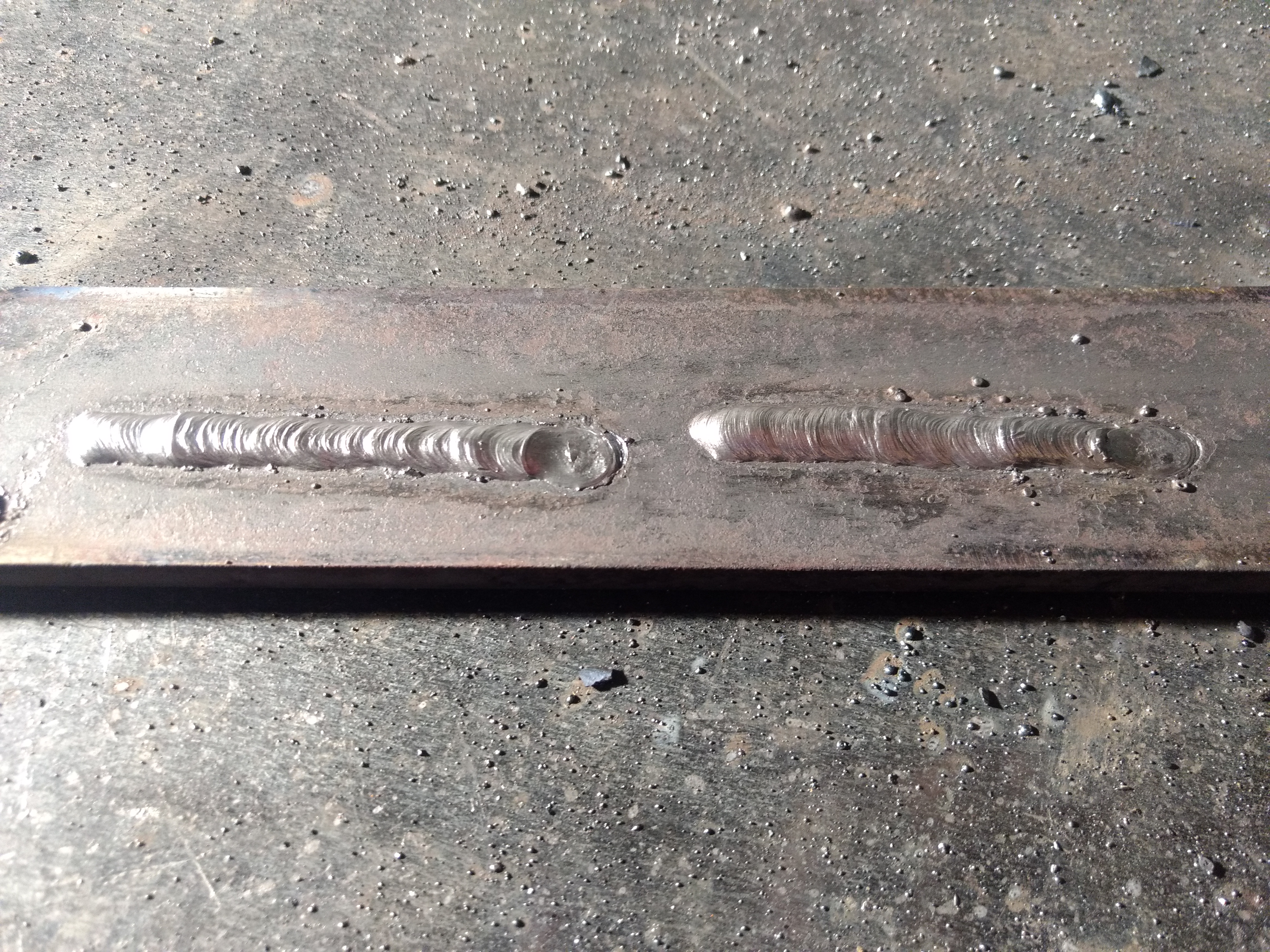

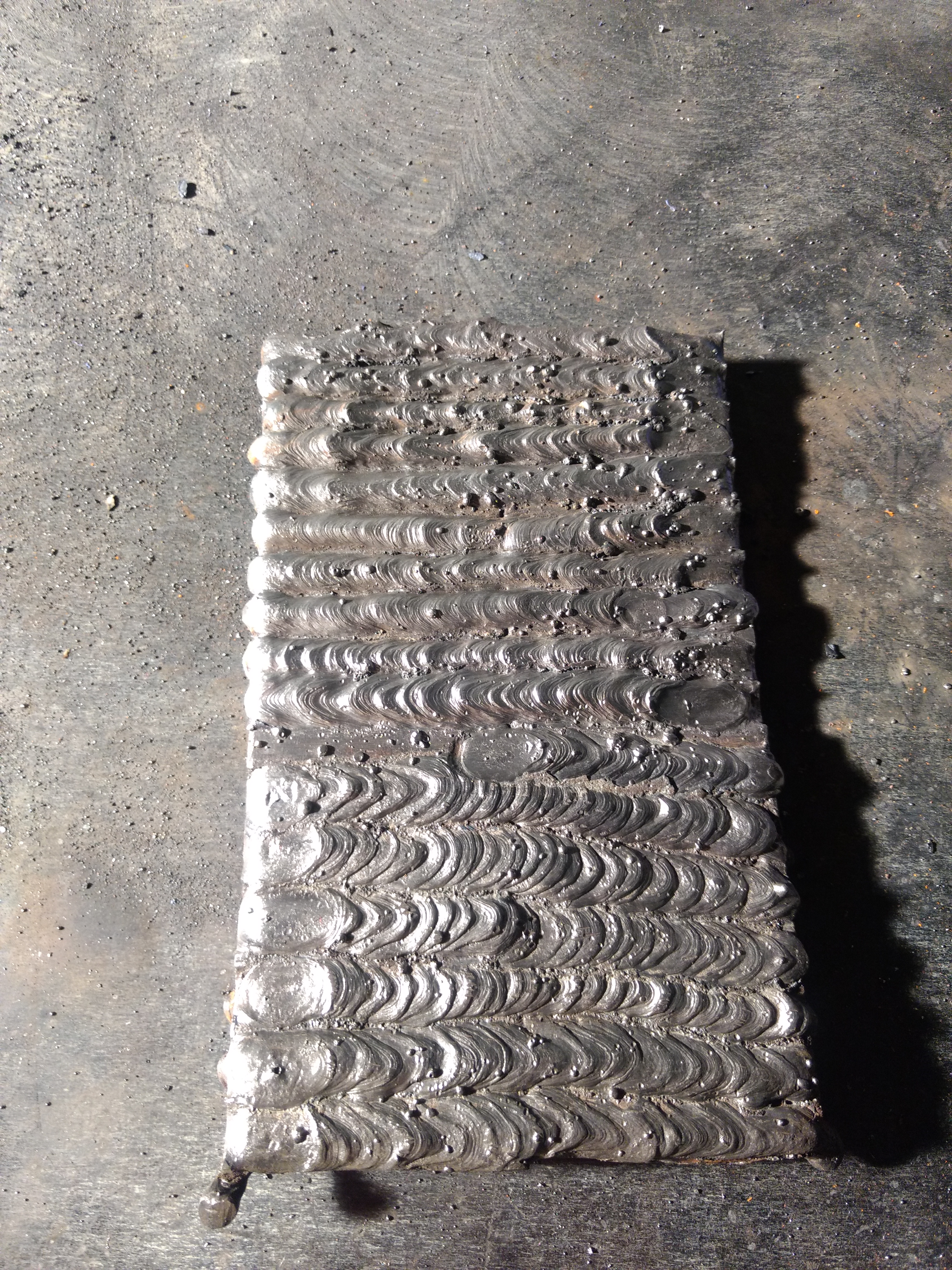

Shield Arc I may have had the plug wrong, but I got a chance to practice tonight and made sure the leads were correct. With the above advice by Gordon I tilted my rod my and faintly dragged it and started my arcs much easier tonight! Here are some 6011 & 7014 practice runs flat, 6011 with the stacked look. You pros I'm sure knew that. Also after more practice with 7014 I ran two last beads then quit for the night. I think they looked my best for the 7014.
But, what do you guys see here to help me out!

WOW! Those look really good!:thumbsup::thumbsup:
Now do it like when you're in welding school. Stack each weld half way on top of the other! Do this for a while, then move on to lap welds, and fillet welds.

That's really good to hear that they look ok! Should I just stick with one rod type for awhile? Or maybe do each like I have, alot of welds with each.?
Also, I ran the 1/8" 7014 from 80-120. The arc was steady but weak at 80 and weld seemed shallow, 100-110 seemed to be kinda a sweet spot, but much more spatter. 80 amps was the last two welds. Does it matter? Also this is 3/16" steel I believe.
Back in welding school, we started out with 6010. Ran 6010 in all positions. Then moved on to 7018. 6010 / 6011 will teach you puddle control. And help you learn how to read the puddle. 7018, and 7014 is childs play to run, compared to 6010 or 6011.

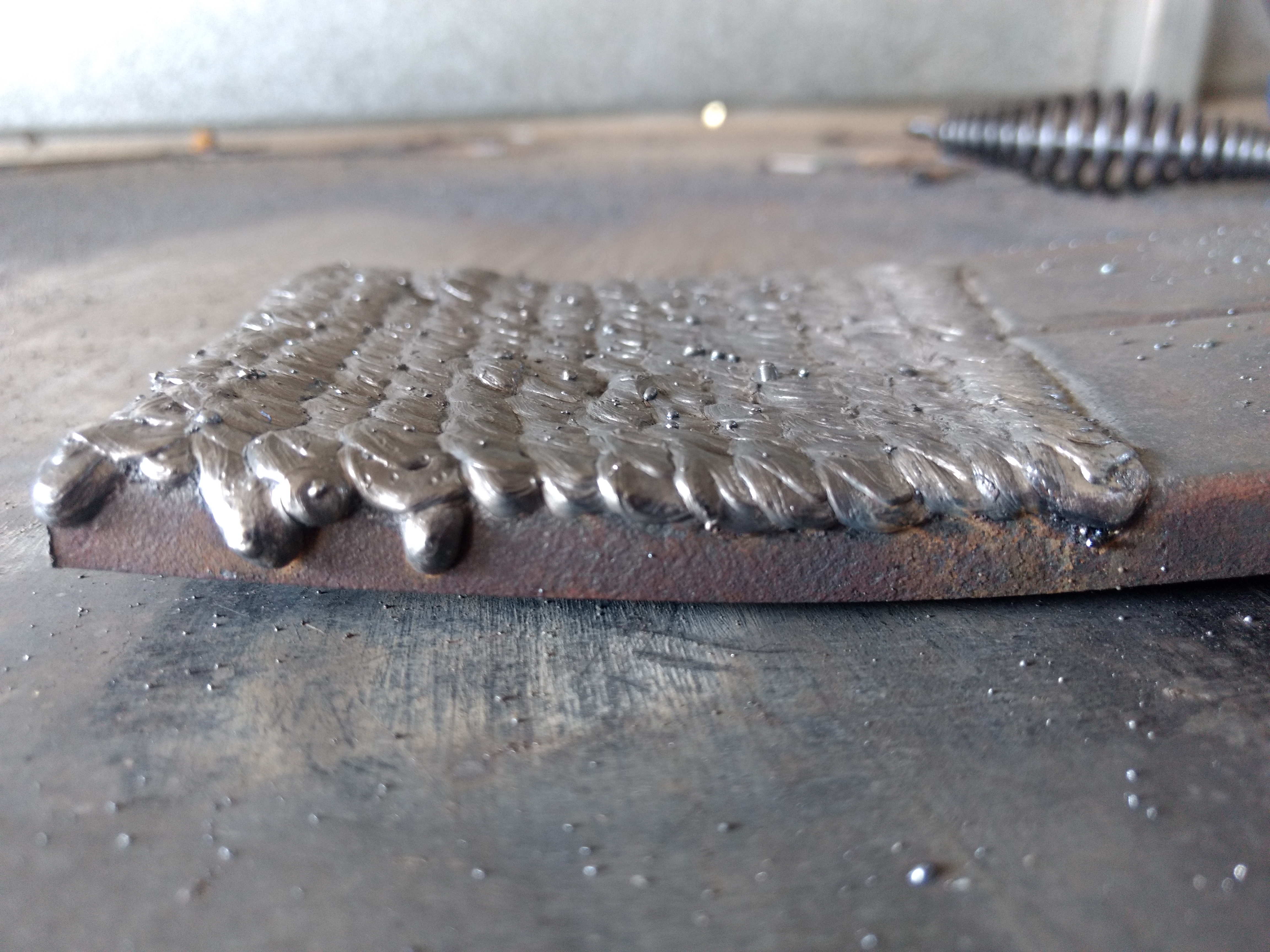

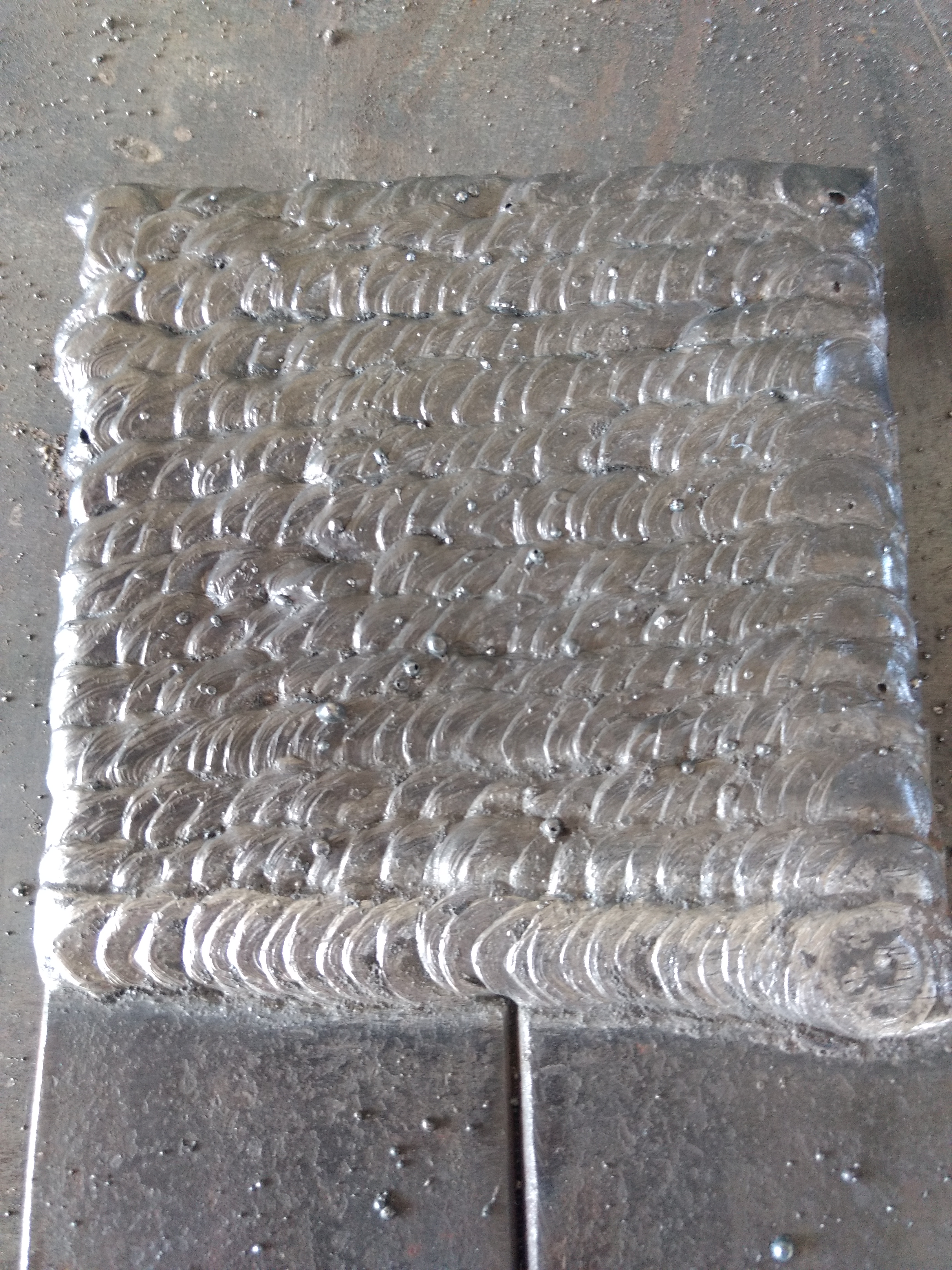

How do these look? 6011 75 amps running the full rod, so I had several stop/starts. Criticism welcome on anything

Those look great! :thumbsup:
Next I would buy some 1/4-inch thick flatbar, and practice welding lap joints, and fillet weld joints. After that, start working on vertical up hill welding. Then overhead welding.
