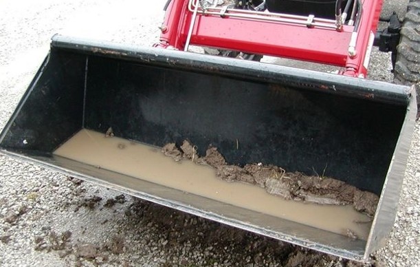

I installed a new tooth bar on my DX33 today and thought I'd share a few before and after pics. This is one heavy duty unit and it made a world of difference in how it digs!

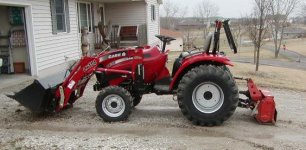

With the tiller.

Pete,
I couldn't tell you manufacturer as I got it off of EBay very reasonable....one of the few deals I have gotten off there. It has the replaceable teeth and it is heavy duty.
/ New Tooth Bar #7
another convert to the toothbar hey? /forums/images/graemlins/grin.gif
/ New Tooth Bar #8
How does it fasten to the bucket, welding or bolted on?
/ New Tooth Bar
#9
It is bolted. I used 1/2 bolts w/ some flat washers for spacer and some bushings to take up some excess room in the slot where the bolt went through.
/ New Tooth Bar
Frank,
I had been looking to get one and was about to order from Markham. I ws snooping about EBay one evening and came across this tooth bar....brand new w/ replaceable teeth. I thought there was no way this thing would go for the $150.00 it was posted for. I wound up getting it for $162.50 and there was only one other bidder....sometimes you get lucky!
/ New Tooth Bar #11
It looks just like my Markham (only bigger), so you may have gotten one from them after all. Seemed that when I was looking, all the different mfrs I looked at each had their own distinctive looking toothbars.
/ New Tooth Bar
#12
Well that would be GREAT if it is!!!! I like it and am looking forward to some digging!
/ New Tooth Bar #13
It looks like a WR Long. Markham doesn't slot the end plates on their toothbars, unless they just started.
We have had both at the shop.
KO
/ New Tooth Bar #14
It's a New Holland skid loader bar. I have the same thing on my NH TC33 60in. bucket. It's 10X more toothbar than we have tractor. It's engineered for the 80hp 8000# skidloader to rip the crap out of things. Has allowed me to dig better and great for ripping out rootballs and holding onto branches during transport to the burn pile. I tack welded 8-10 washers to take up the slack on the ends. Only drawback is it wont fit over replaceble cutting edge-BUT I was told there is another tooth bar that does fit over .
/ New Tooth Bar
#15
Hey Dirtball,
I'll give it one thing it is heavy duty. Mine fit over the factory edge of the bucket fine. I had to use 4 washers on the inside of both sides and then used some bushing to take up the space between the 1/2 inch bolt and the remaining space in the mounting flange. They must use some big !@# bolts to mount that thing on the skid steer. Anyway it was a bargain! Can't wait to tear up some dirt with it!!
