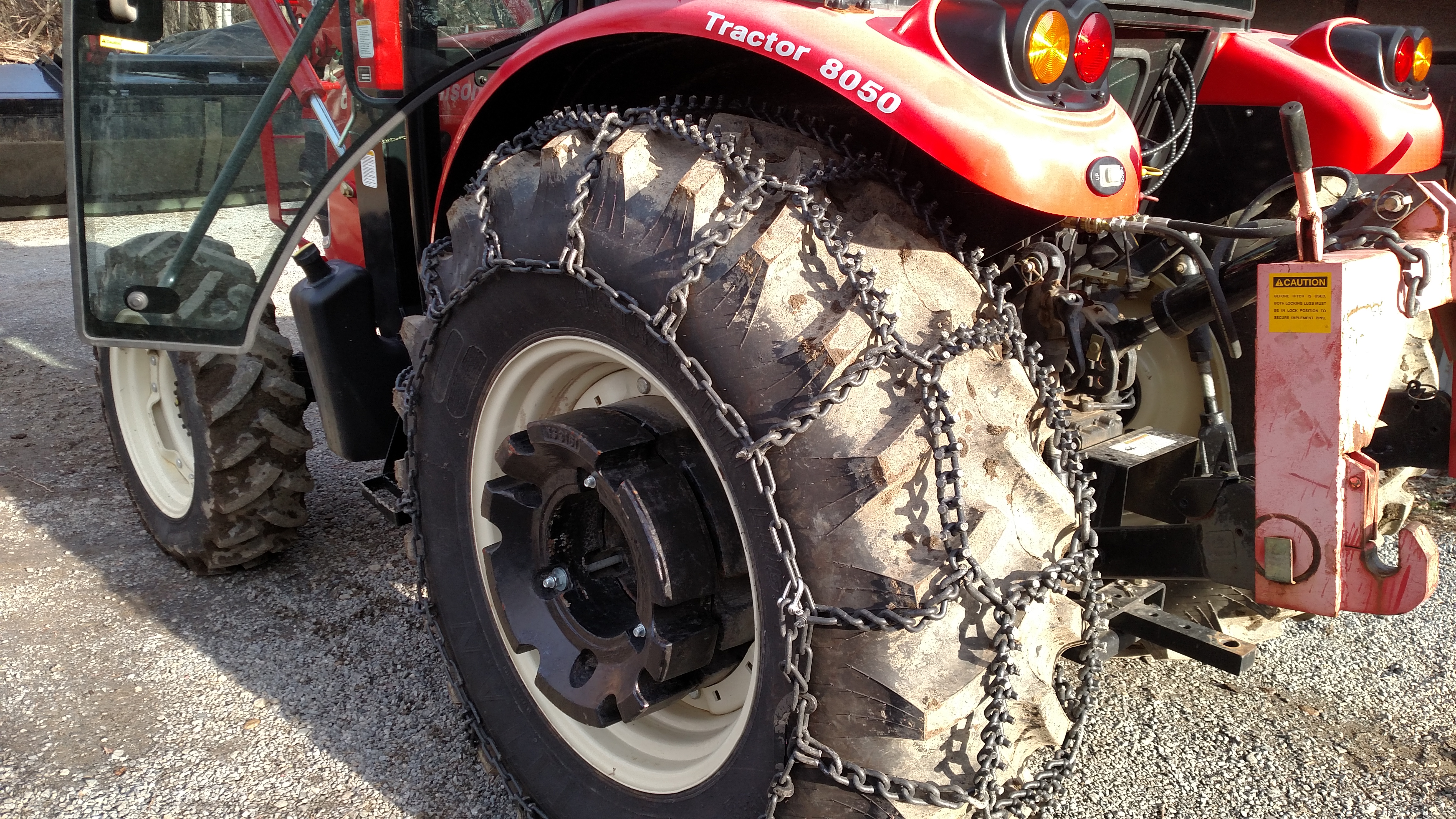

Kioti NX cab with R4 and Rimguard. Good traction and toughness for woods. Still need chains for ice and mud.
Yep, R4’s don’t really like mud.
