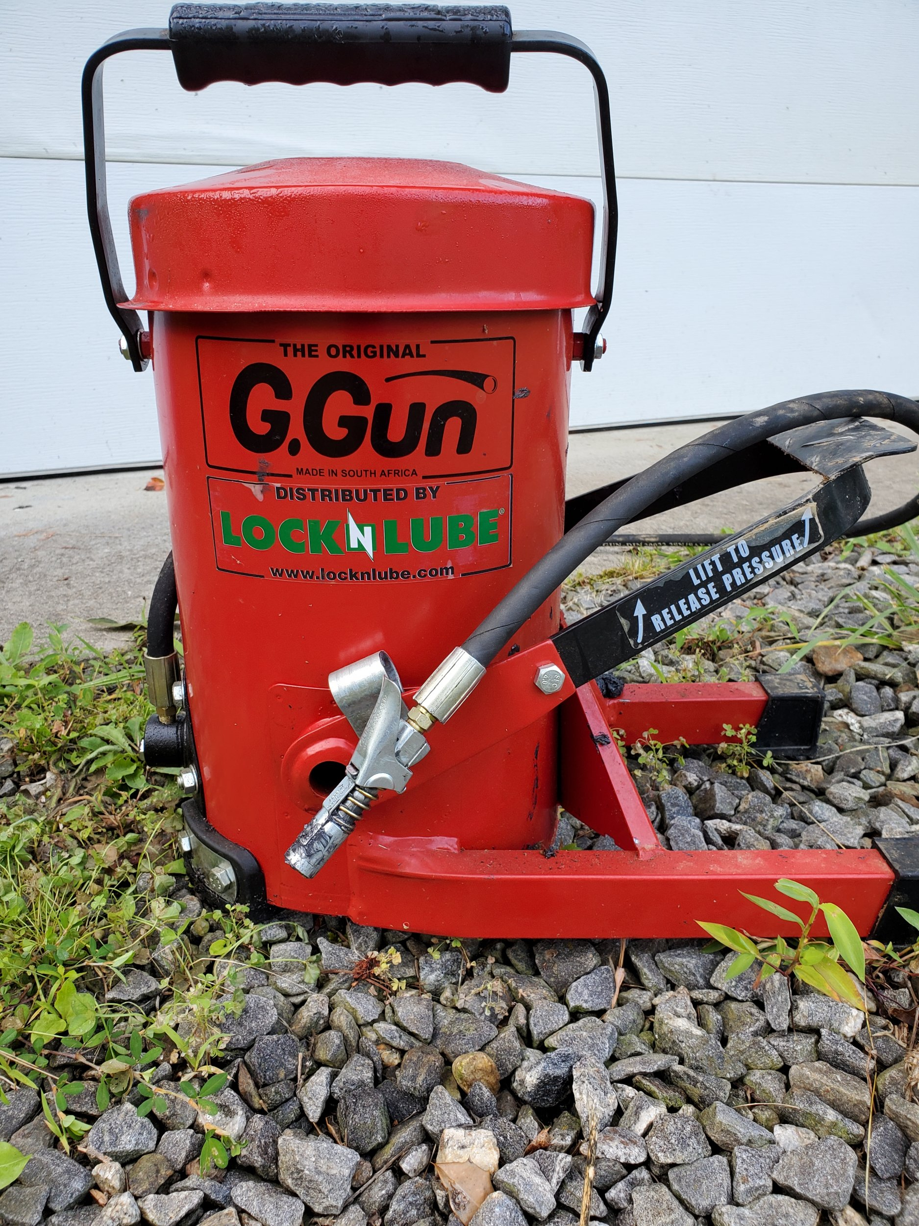

Got my girl a tractor 🚜 and she bought me this grease set up
Go big or go home is her motto .
Texas Refinery Corp Paragon 3000. It’s the only grease my 2000 New Holland has ever seen .
How interesting to see Lock n Lube has now knocked off or rebranded the grease bucket from South Africa. Buying grease by the 5 gallon pail makes grease so much less expensive and the waste goes nearly to zero. No scraping out tubes to get the stuff that squeezed past the plunger, no forgetting to lock the plunger back so it doesn't ooze onto the shop floor, & almost no grease on my clothes because I don't change grease tubes.
Life is good.
