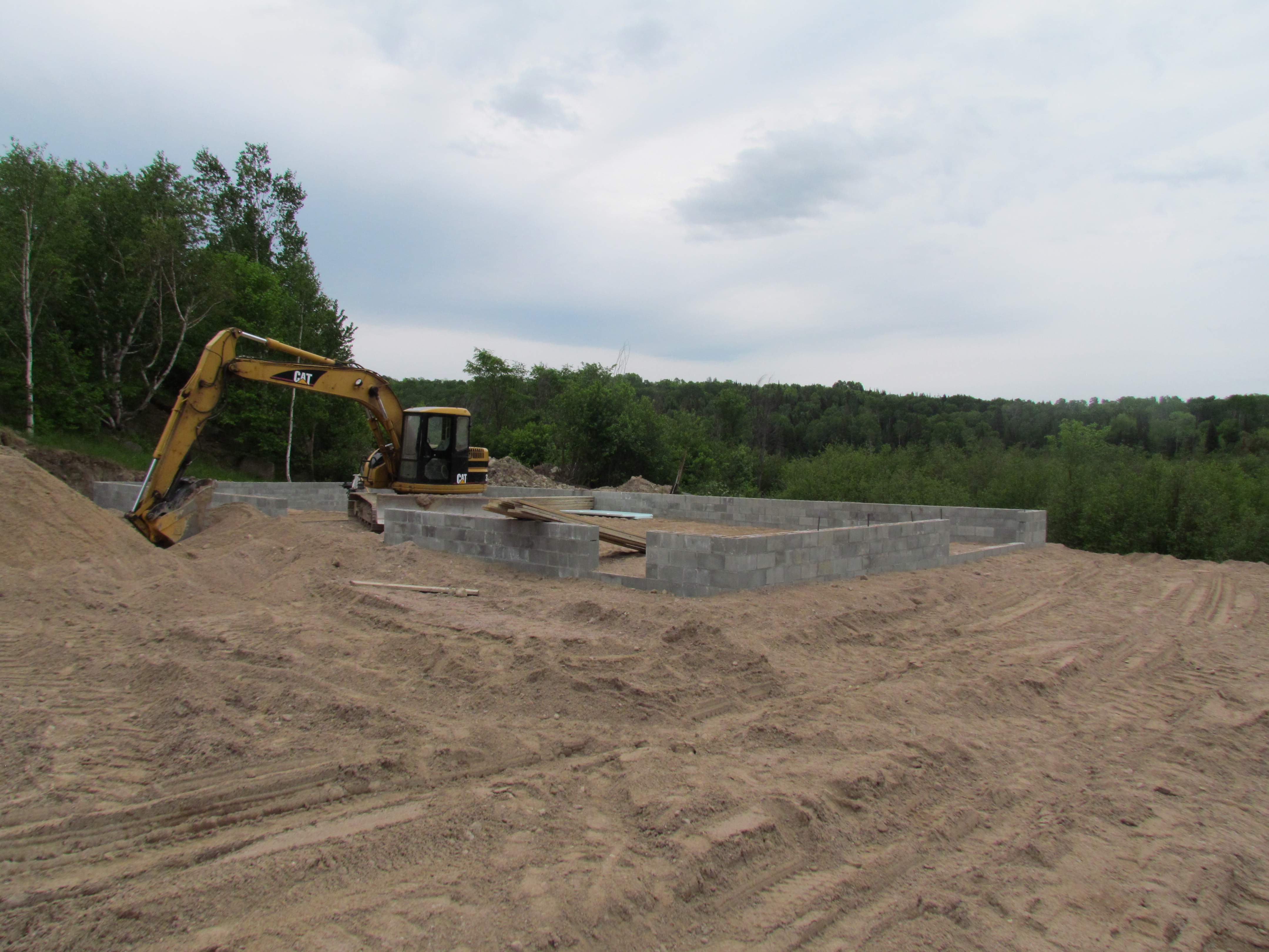

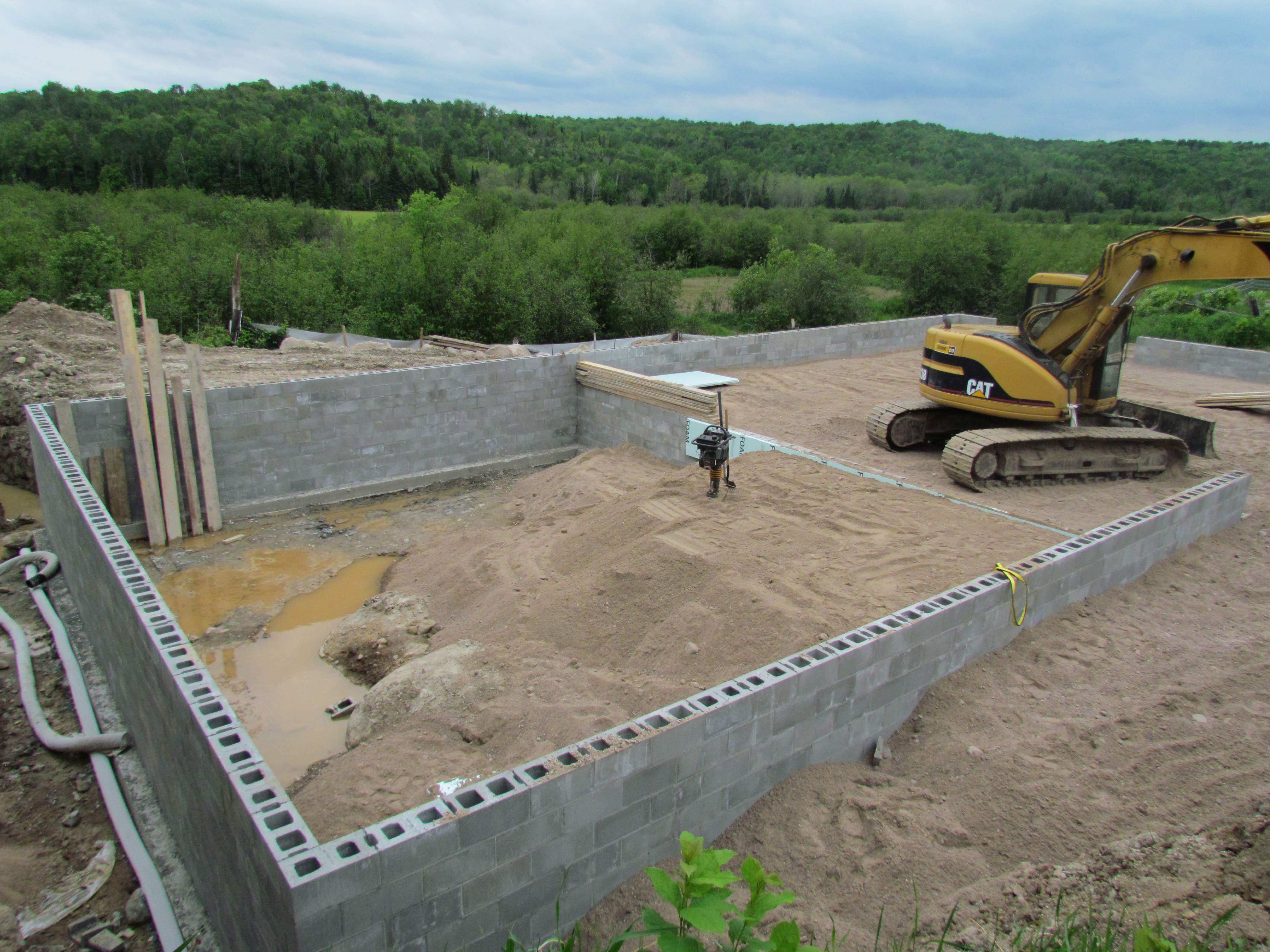

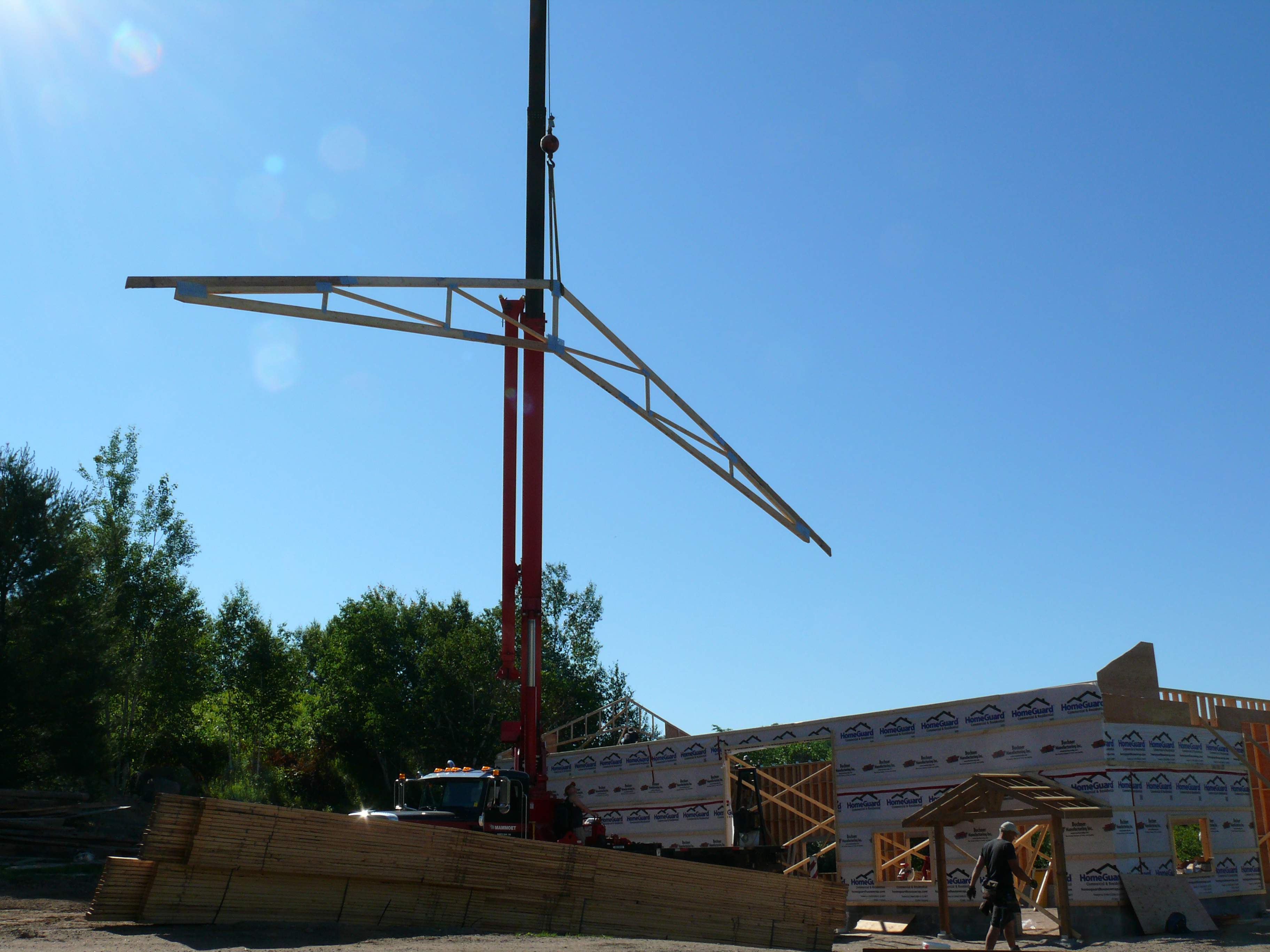

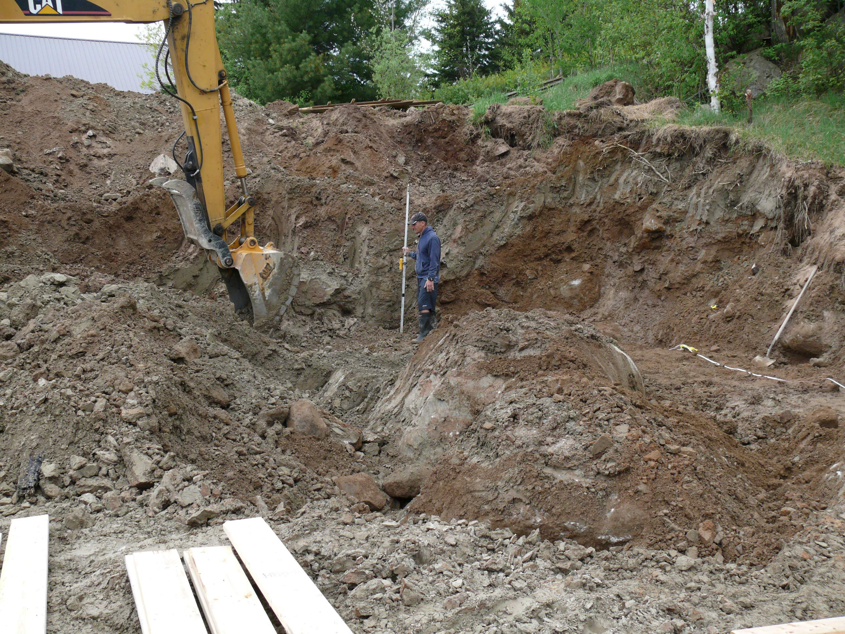

Thanks guys, Footing is down about 4- 5', we have to go down at least 4' due to frost. I also used a scissor truss for extra height.
First pic is excavating by, what was, the old Bank side of the old barn so its deeper than 5' before we took the rest of the bank away
we have a lot of clay here too, which is a problem for frost heaving, so we brought in 60 dump truck loads of sand and gravel to back fill
Crane lifting the scissor trusses,
   / New Tractor & Implement shed #12

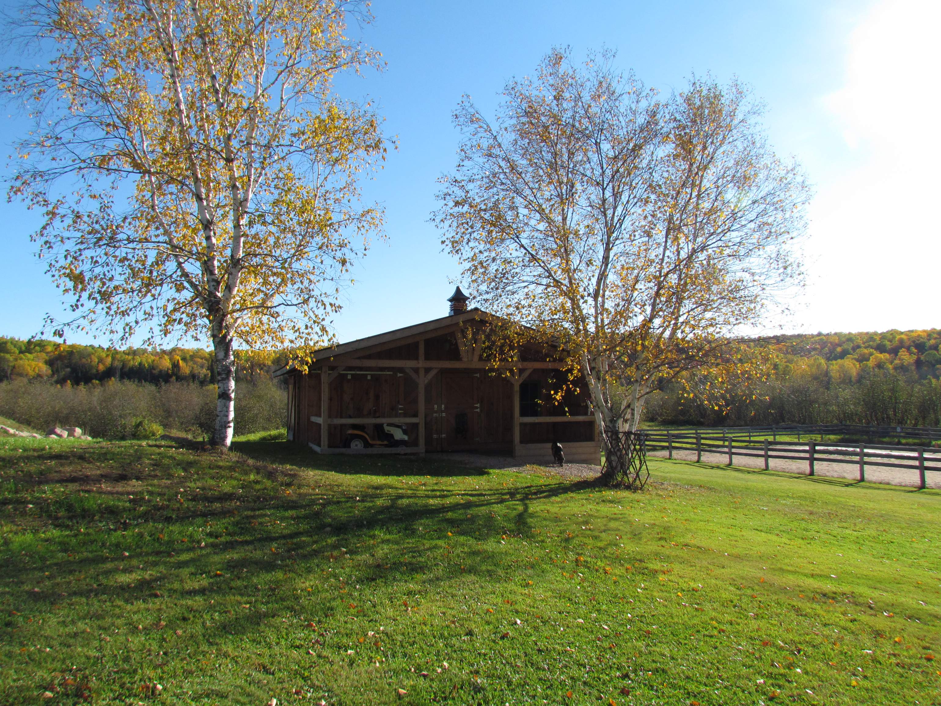

Your "Shed" is a sHow stopper. Very nice !!
Thanks Very Much, im very pleased with it, we were sorry to lose the big old 1800's bank barn but it was just too expensive to fix the foundation
   / New Tractor & Implement shed #16
I really like the fancy truss on the porch.
