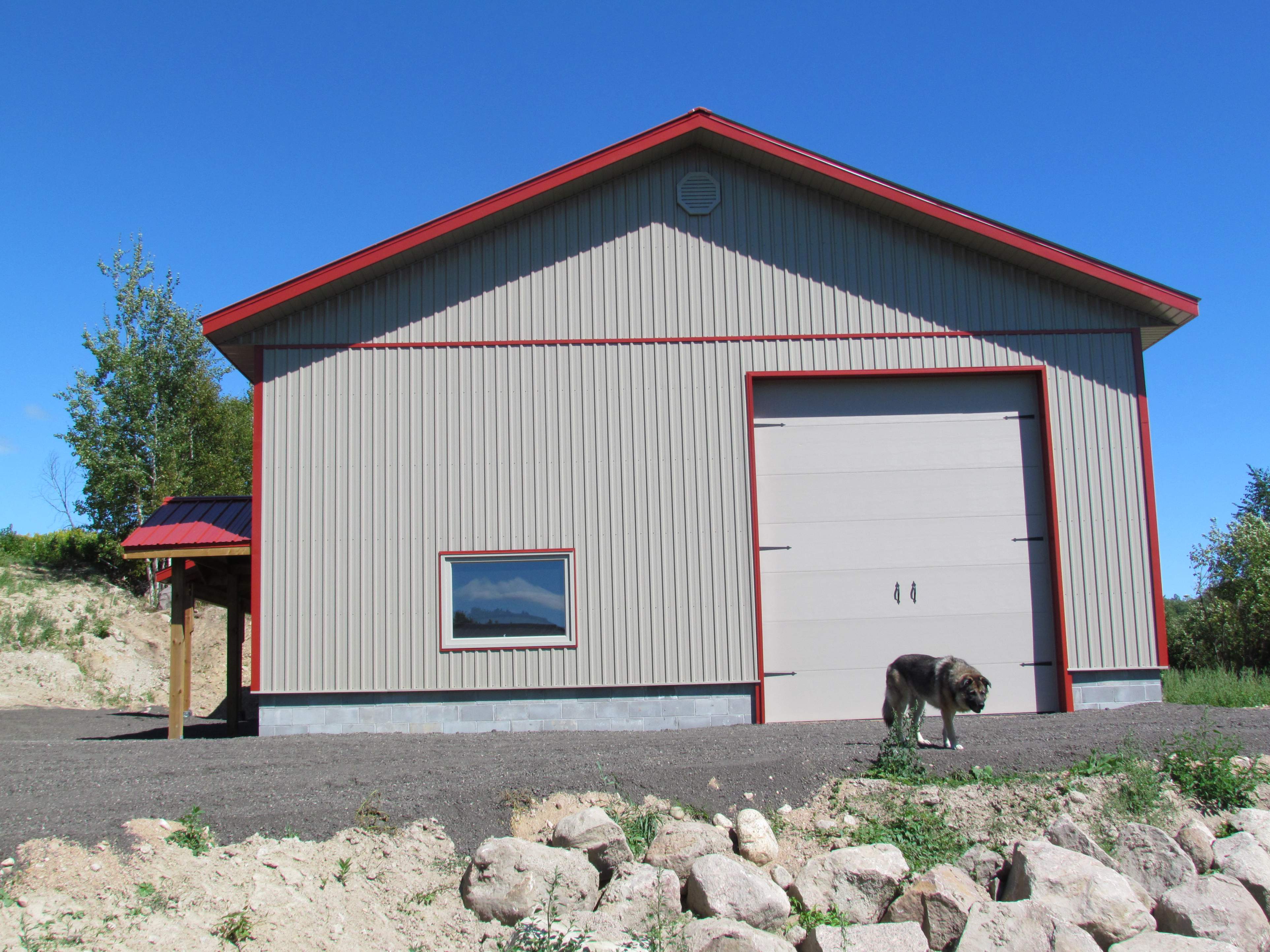

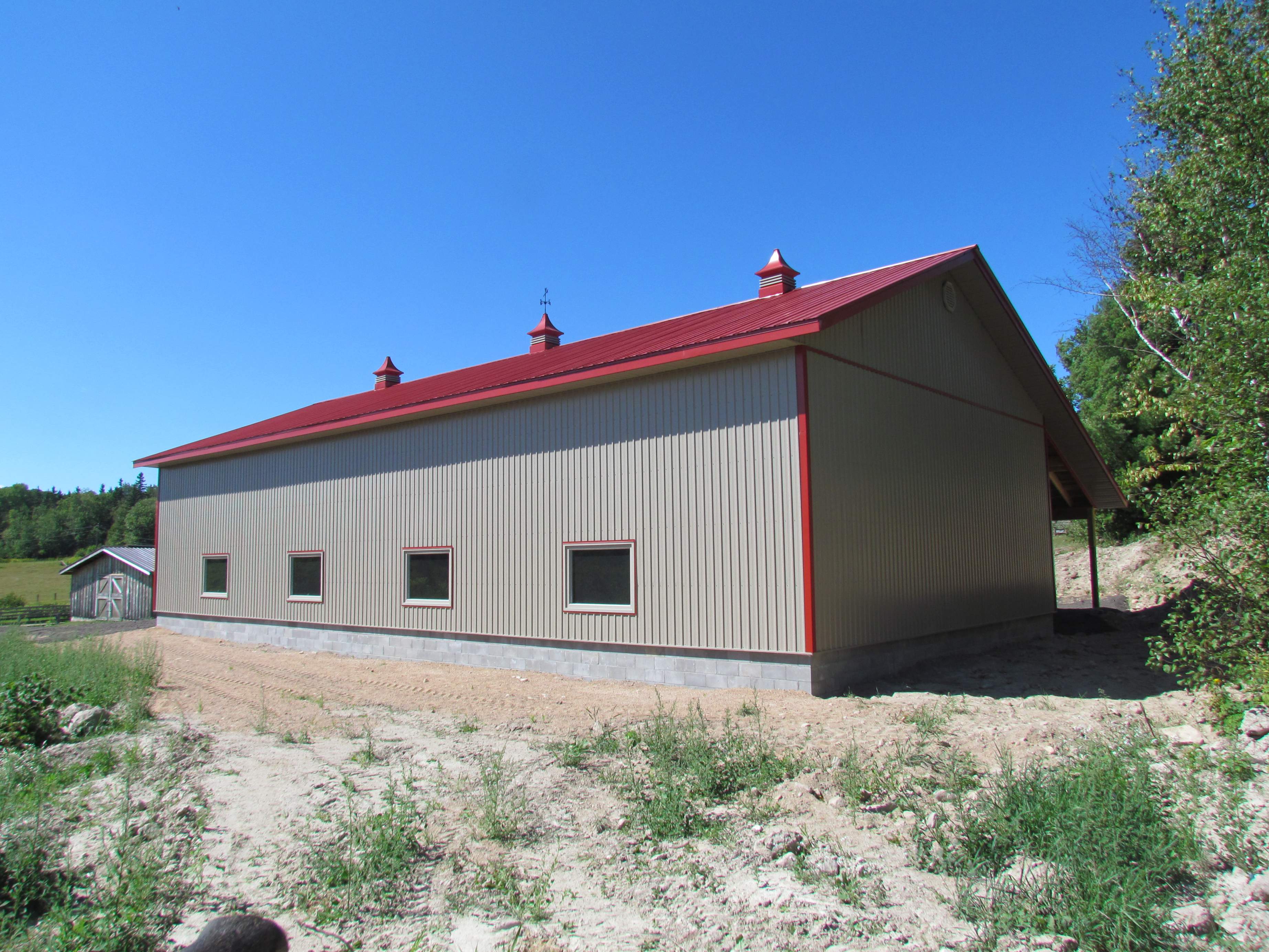

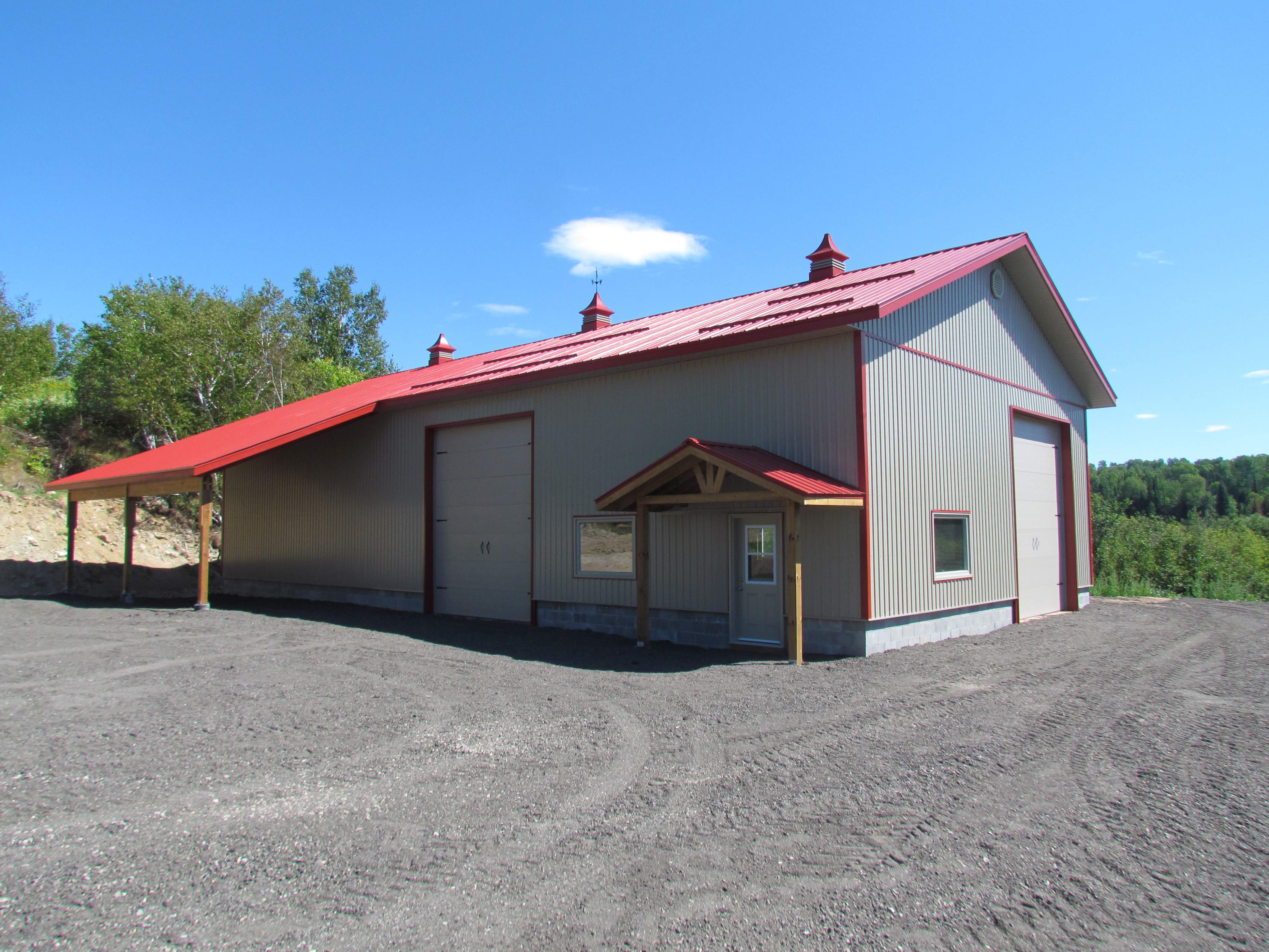

We just finished it 72' x 36' ....

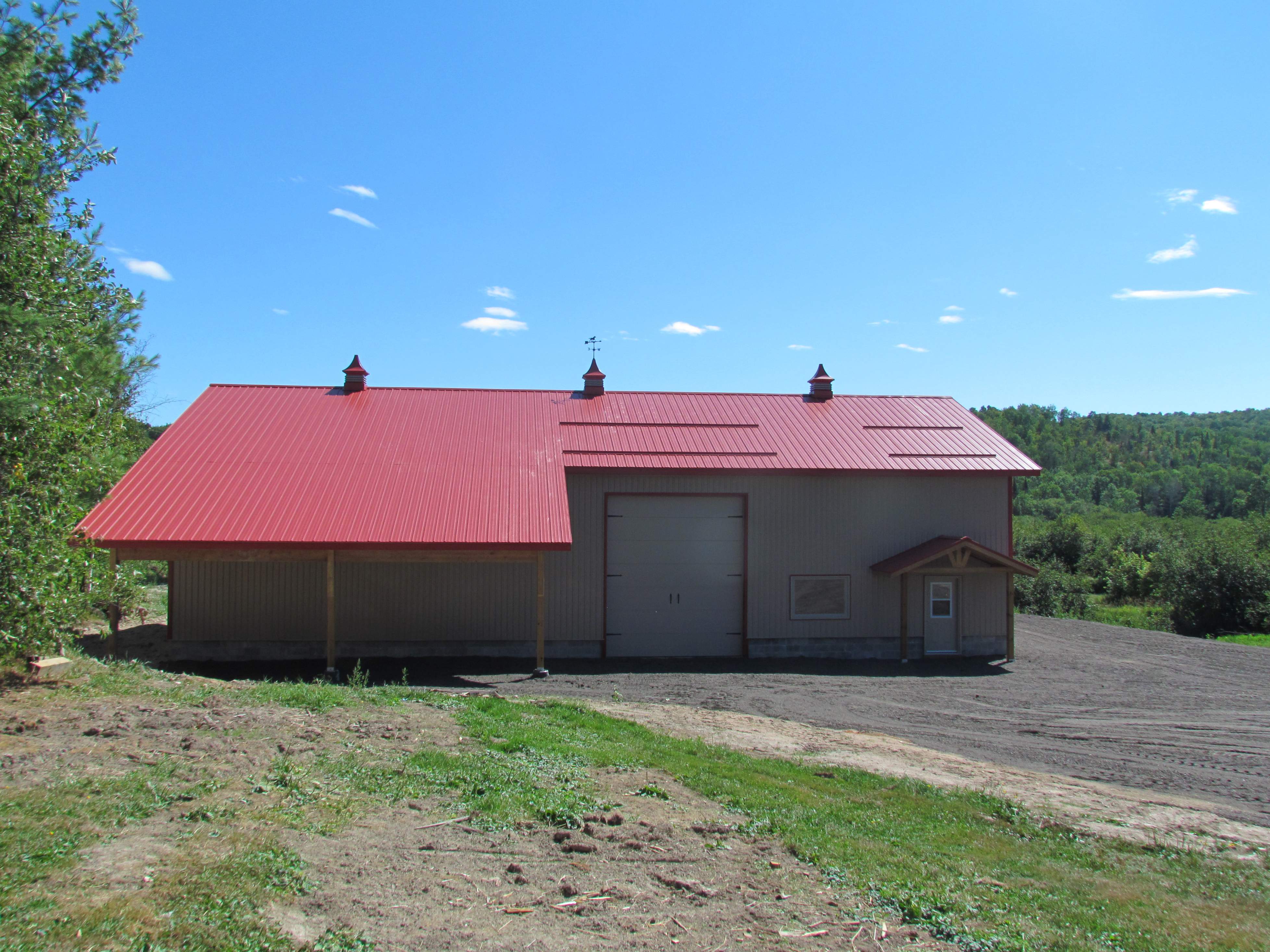

Very nice!!! What are the 4 things on the roof for?
/ New Tractor & Implement shed
They are snow stoppers, we get a lot of snow here, with a metal roof like this they stop the snow from sliding off and piling up in front of the doors etc
/ New Tractor & Implement shed #4
I have never seen snow stoppers like that. The ones in Ohio and pa are little triangle bumps in each channel. What is your typical snowfall?
Pretty common up here on metal roofs, we have anywhere from 2-4 ft of snow on the ground at a time. With the metal roof, these will just slow the shed so it melts and sheds in stages, and I dont end up with a giant pile of snow at my door.
Did you add those yourself or were they designed-in for the extra roof loading? Just curious as snow is pretty rare in this part of the world. Something like 1/2" every 10 years. :)

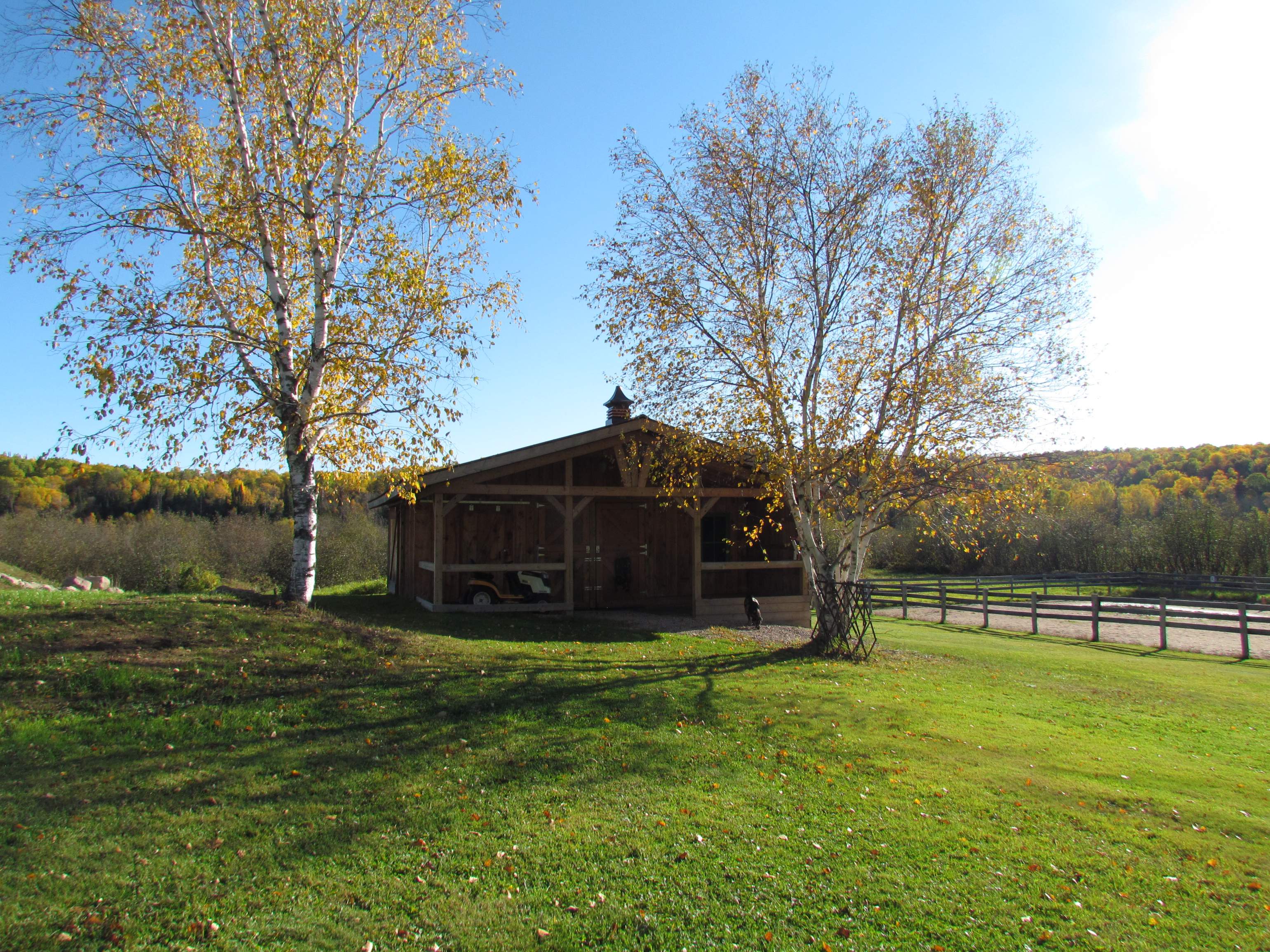

best i have right now... 36x30 concrete pad and 36x42 gravel. that way we can use the gravel area to put up a schooling ring for the horses in winter
/ New Tractor & Implement shed #9
Really Nice! I would have never guessed it was stick frame. I really like the drive-under too.
/ New Tractor & Implement shed #10
Now THAT is a shed! plenty of room and real nice looking too. I like the large overhangs on the gable ends. How deep did you go with the footer?

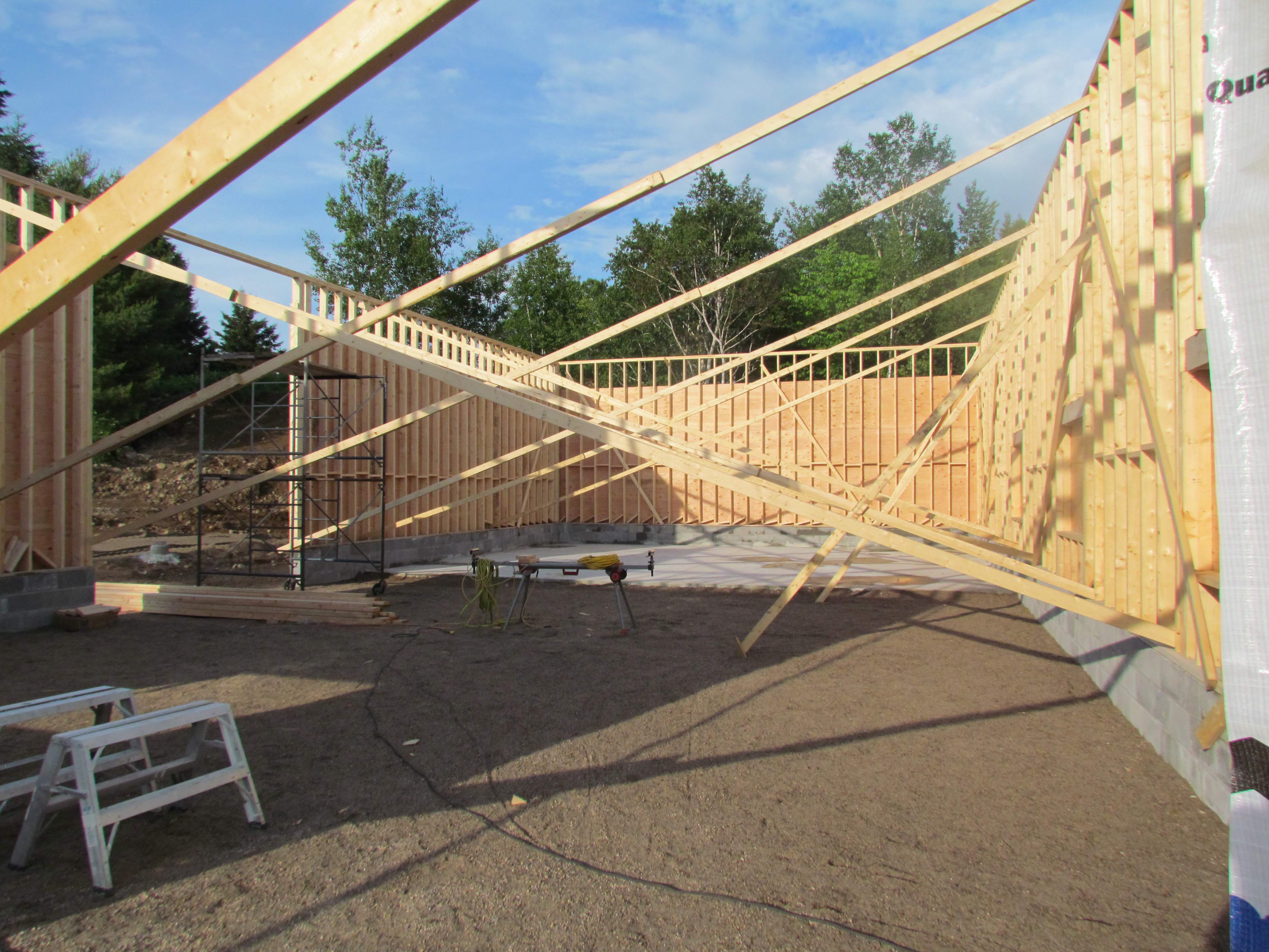

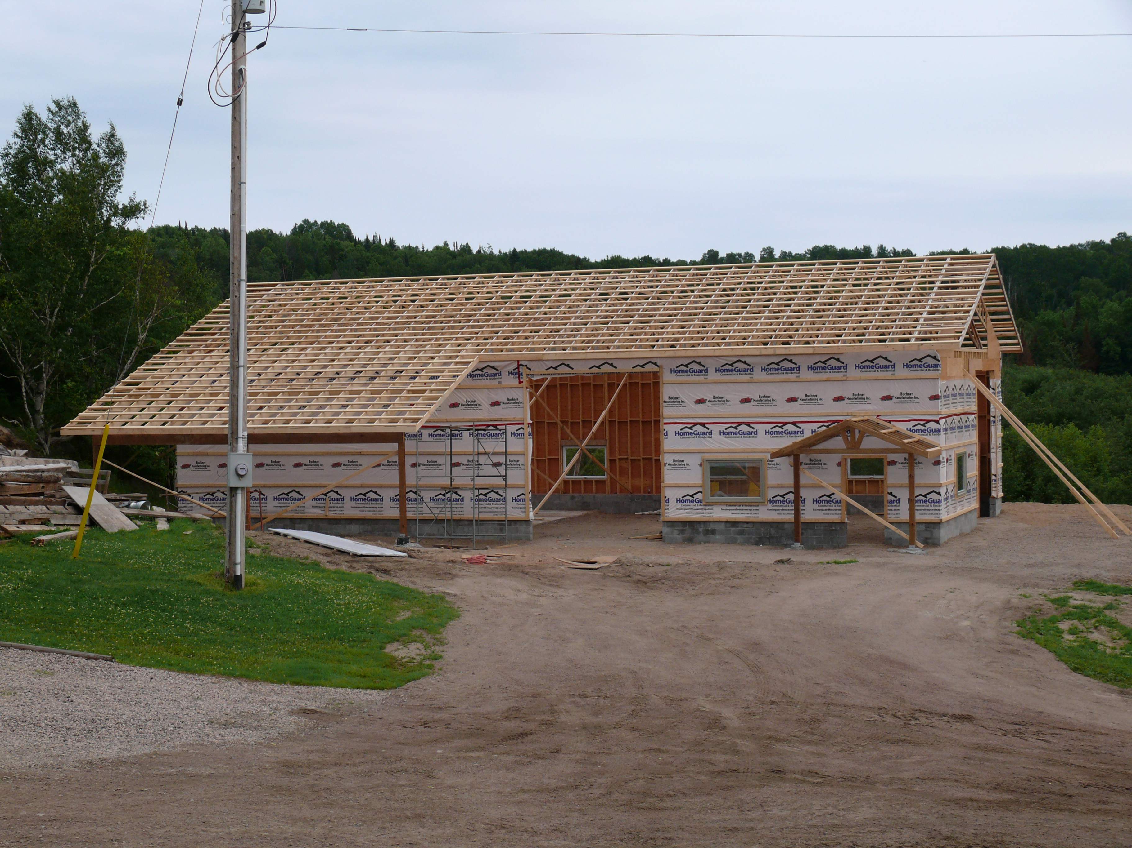

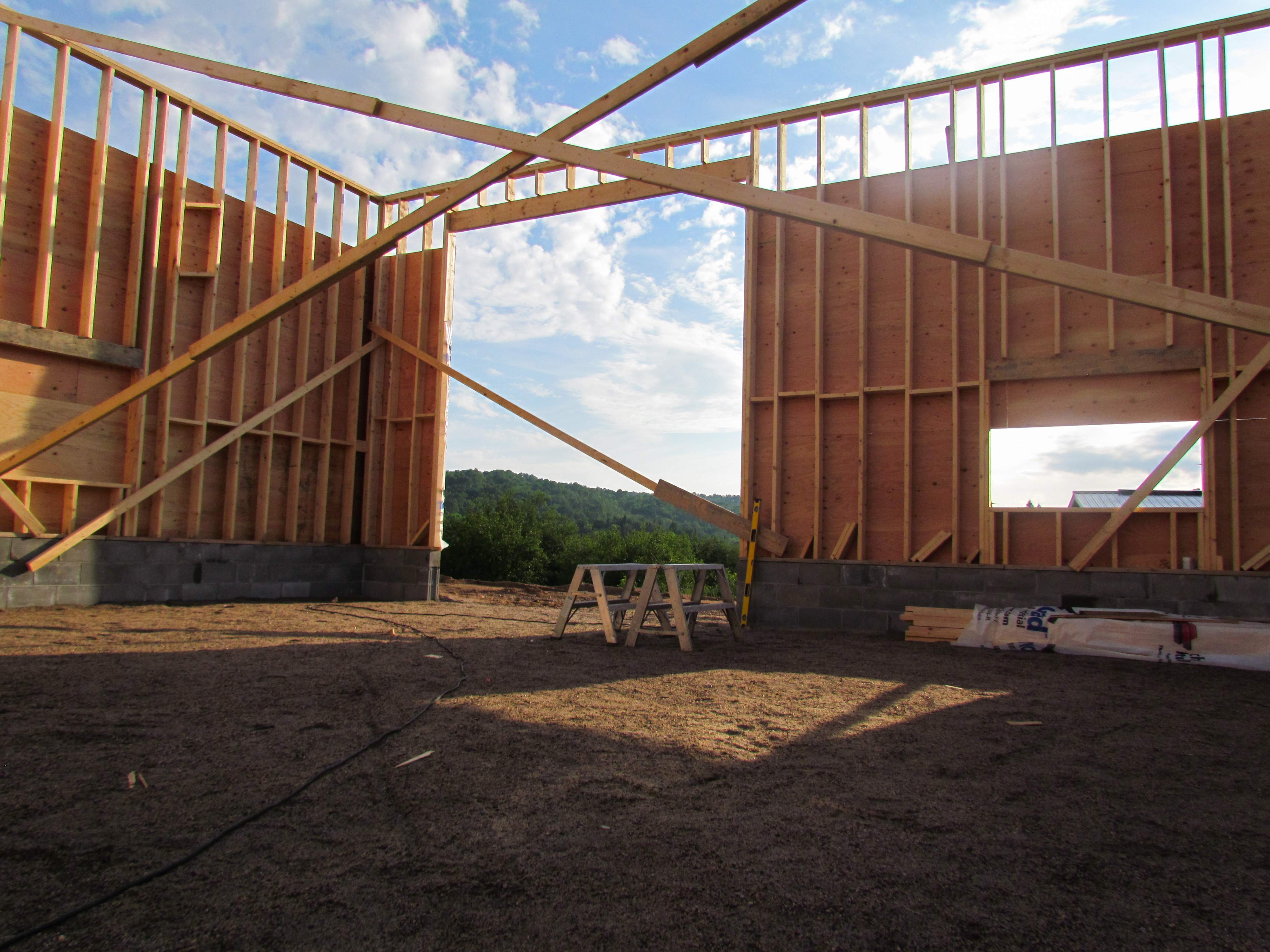

#11

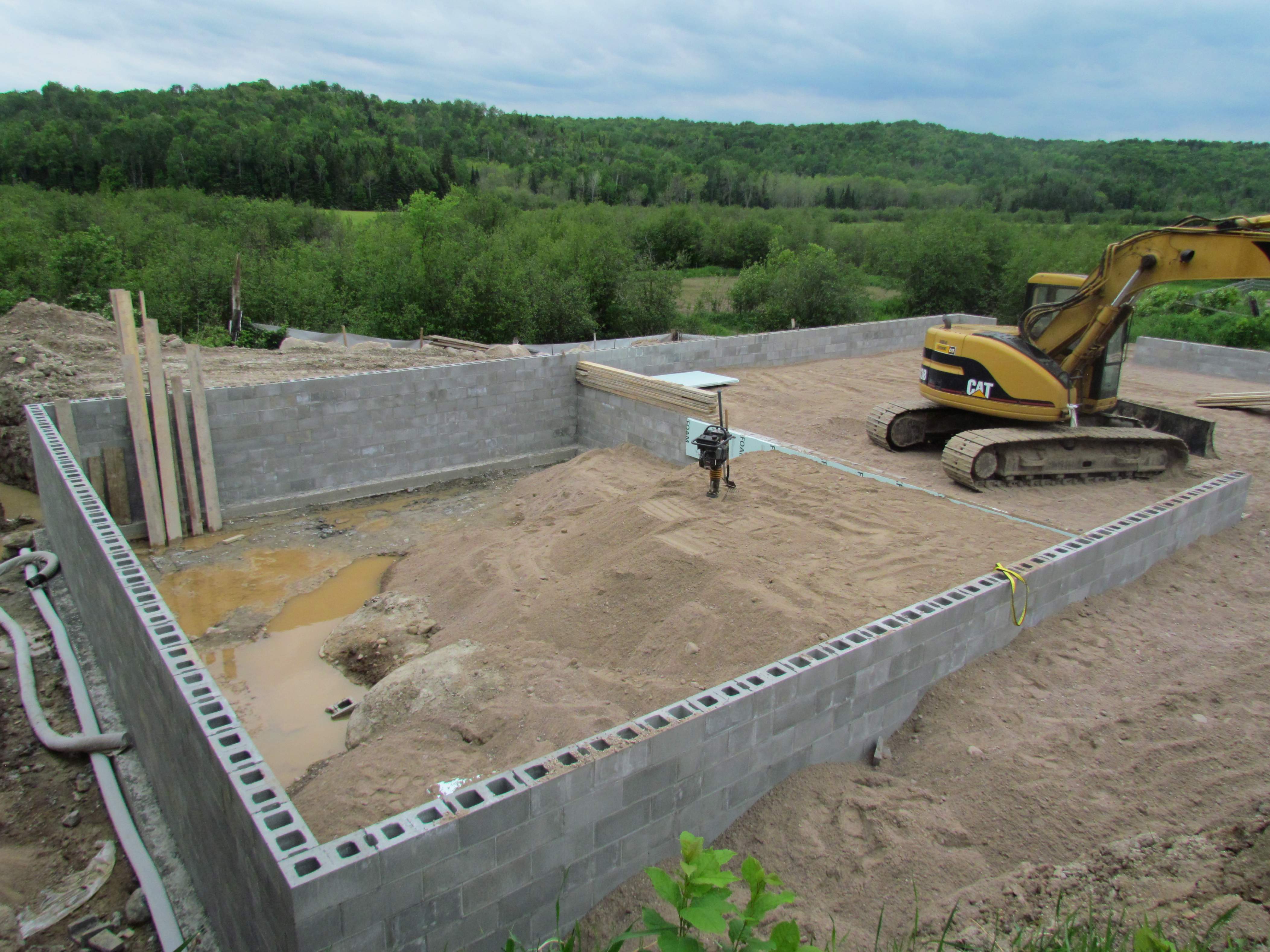

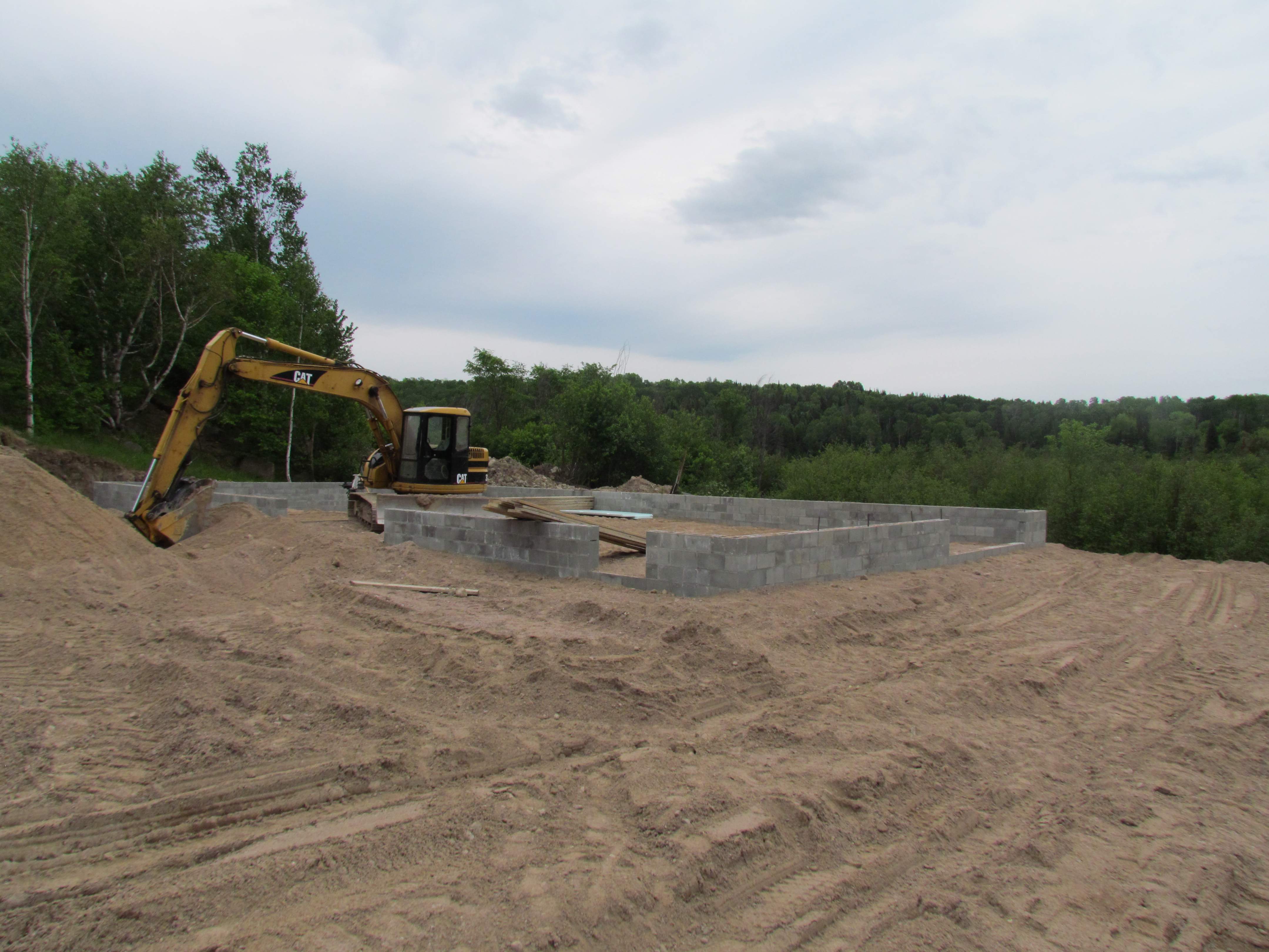

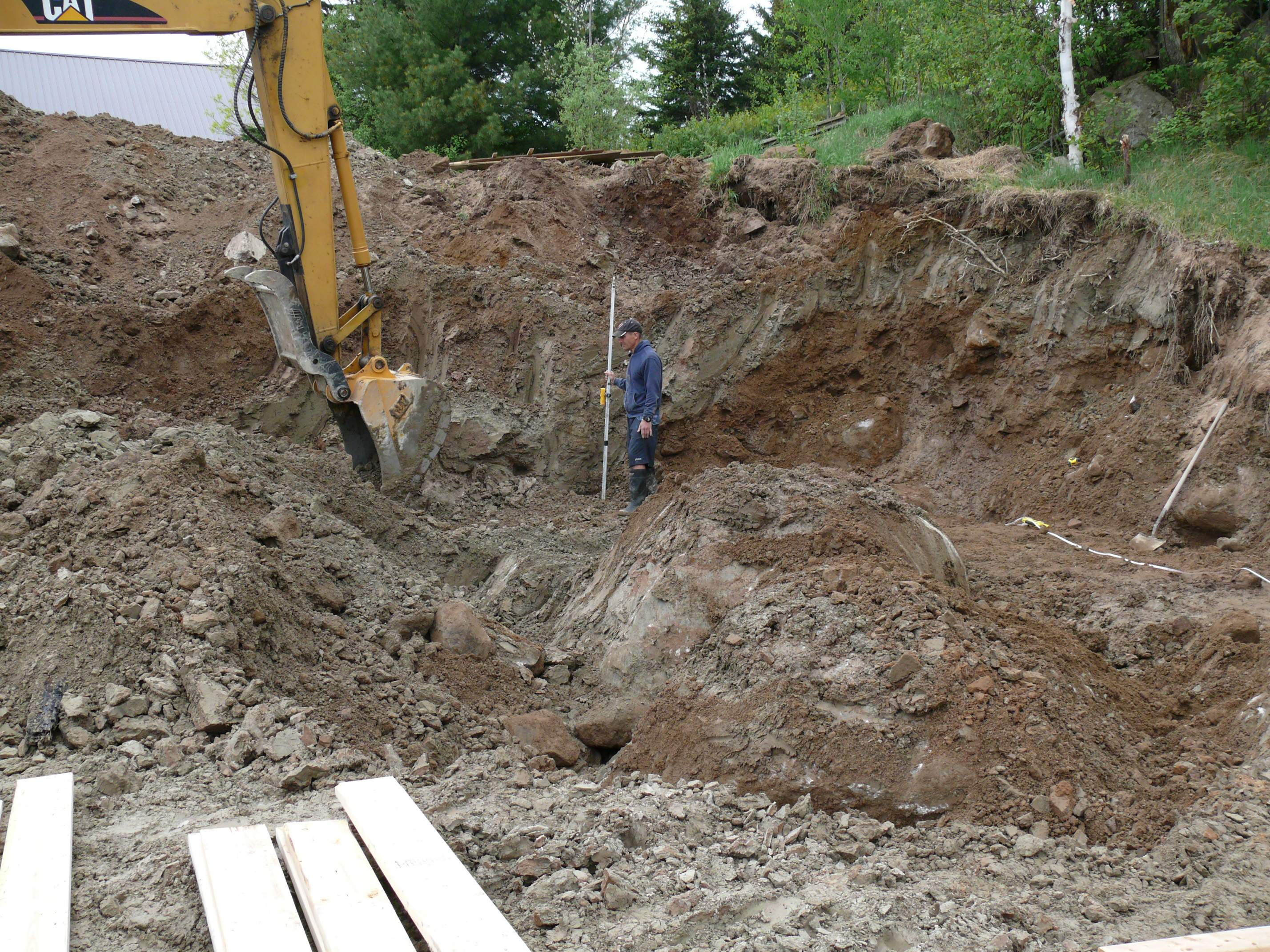

Thanks guys, Footing is down about 4- 5', we have to go down at least 4' due to frost. I also used a scissor truss for extra height.
First pic is excavating by, what was, the old Bank side of the old barn so its deeper than 5' before we took the rest of the bank away
we have a lot of clay here too, which is a problem for frost heaving, so we brought in 60 dump truck loads of sand and gravel to back fill
Crane lifting the scissor trusses,
/ New Tractor & Implement shed #12

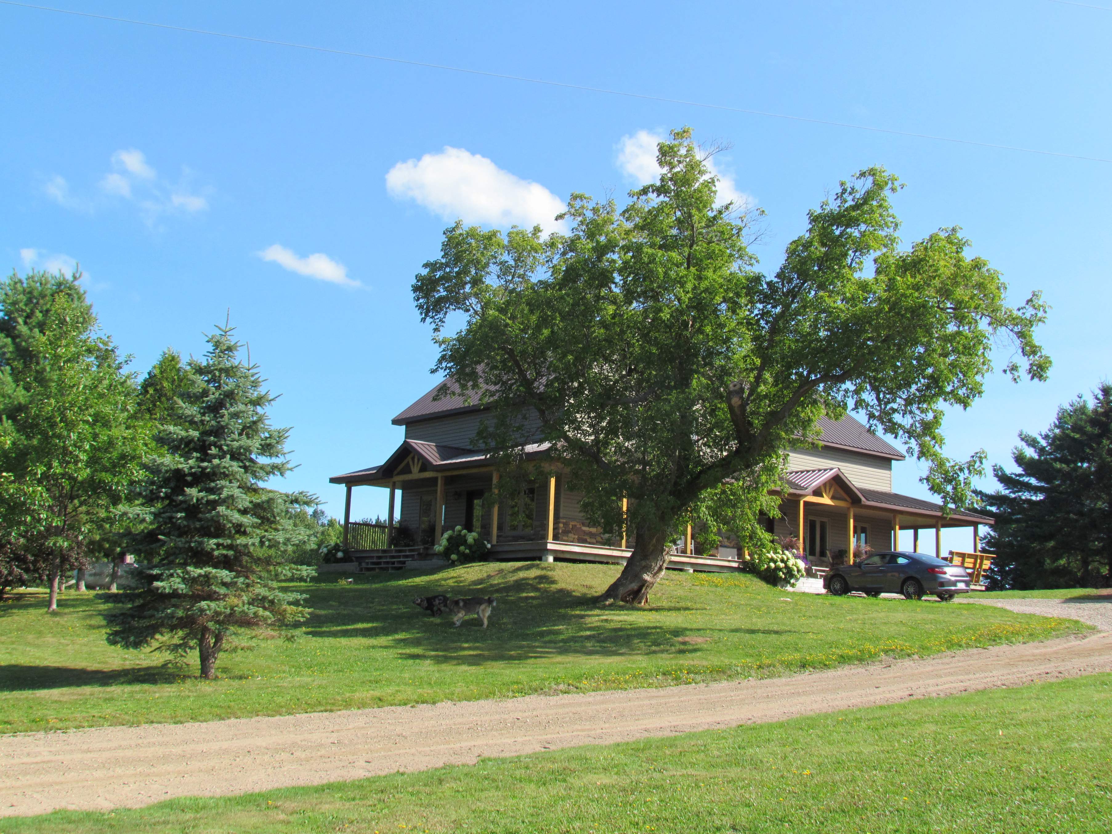

Where are you from? ? Sounds like parts of Michigan(mobile app don't show anything besides username and #of posts)
#15
Your "Shed" is a sHow stopper. Very nice !!
Thanks Very Much, im very pleased with it, we were sorry to lose the big old 1800's bank barn but it was just too expensive to fix the foundation
