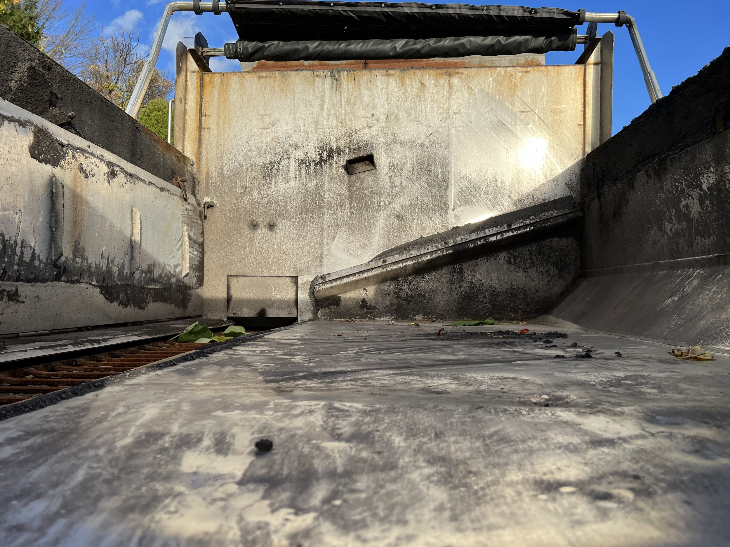

The inside of that body looks to be in good shape as long as the conveyor is not seized up, couple gallons of waste oil sprayed on the chain would work wonders.
Check the side dump hinges also, once they seize up you have a bad job on your hands, a few shots of grease works wonders.
The rubber wiper is partially missing from the headboard too, not a big deal but you'll lose product .
It does drop salt or sand ahead of the rear axle which is good but the bad thing about them is it drops salt over the frame from leakage of the return tray underneath, totally covering the frame in salt.
Depending on how the side dump/reloading cylinders are configured it can be hard on the moveable section as well as the main frame rails of the body. If they're at a really low angle (which some are) it pushes the moveable section and the frame rail apart until it gets high enough to move it up easily. If you get a ham handed operator that tries to reload the conveyor before the product is low it's not good.

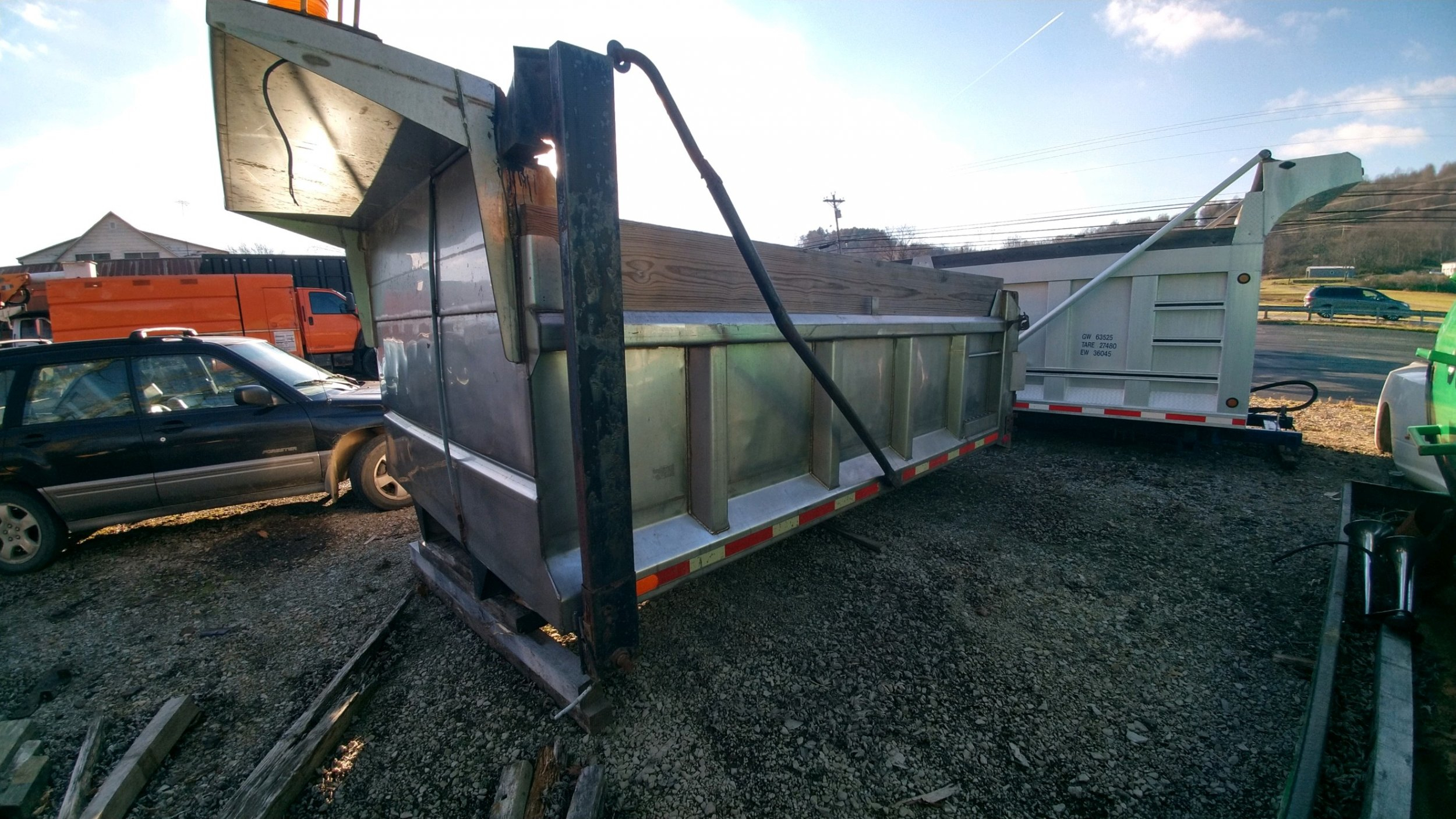

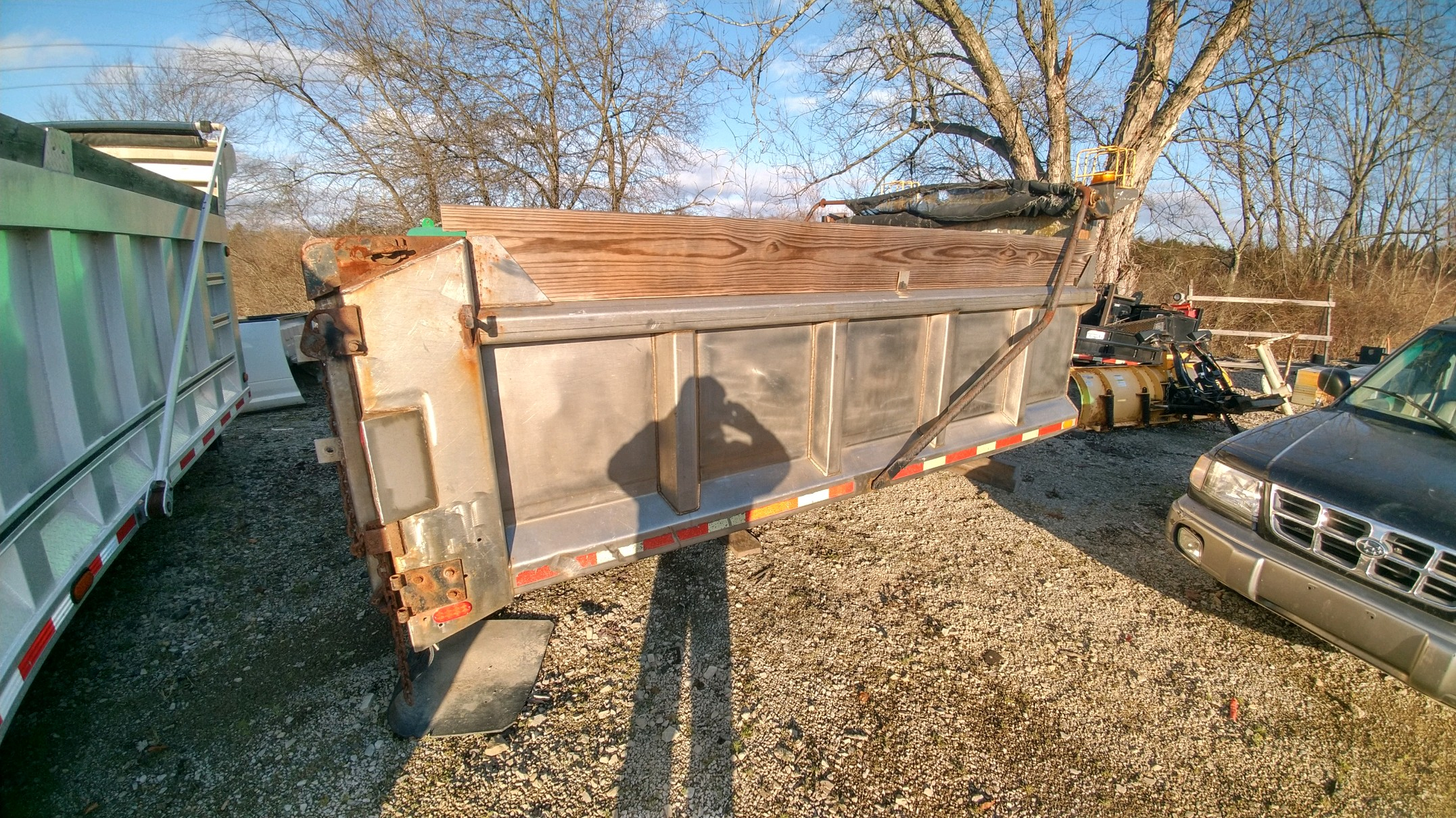

I’m thinking more & more about selling everything now as a complete set up. Hydraulic pump out front, too.
I just want to be left with a bare chassis a while, restore the frame & paint it, and install simple tough steel bed, replace wheels, fix exhaust manifold gasket and whatever else I can afford and I’m good.
If a used 12’ stainless bed bed came along, that would be amazing. It looks good with the green cab.

Got an offer of $11,000 for stainless steel dump, telescopic hoist, hydraulic tank and salt spinner.
I gotta pay to remove. Probably a grand.
End up with $10,000 to put towards new 12’ dump, hoist & PTO
