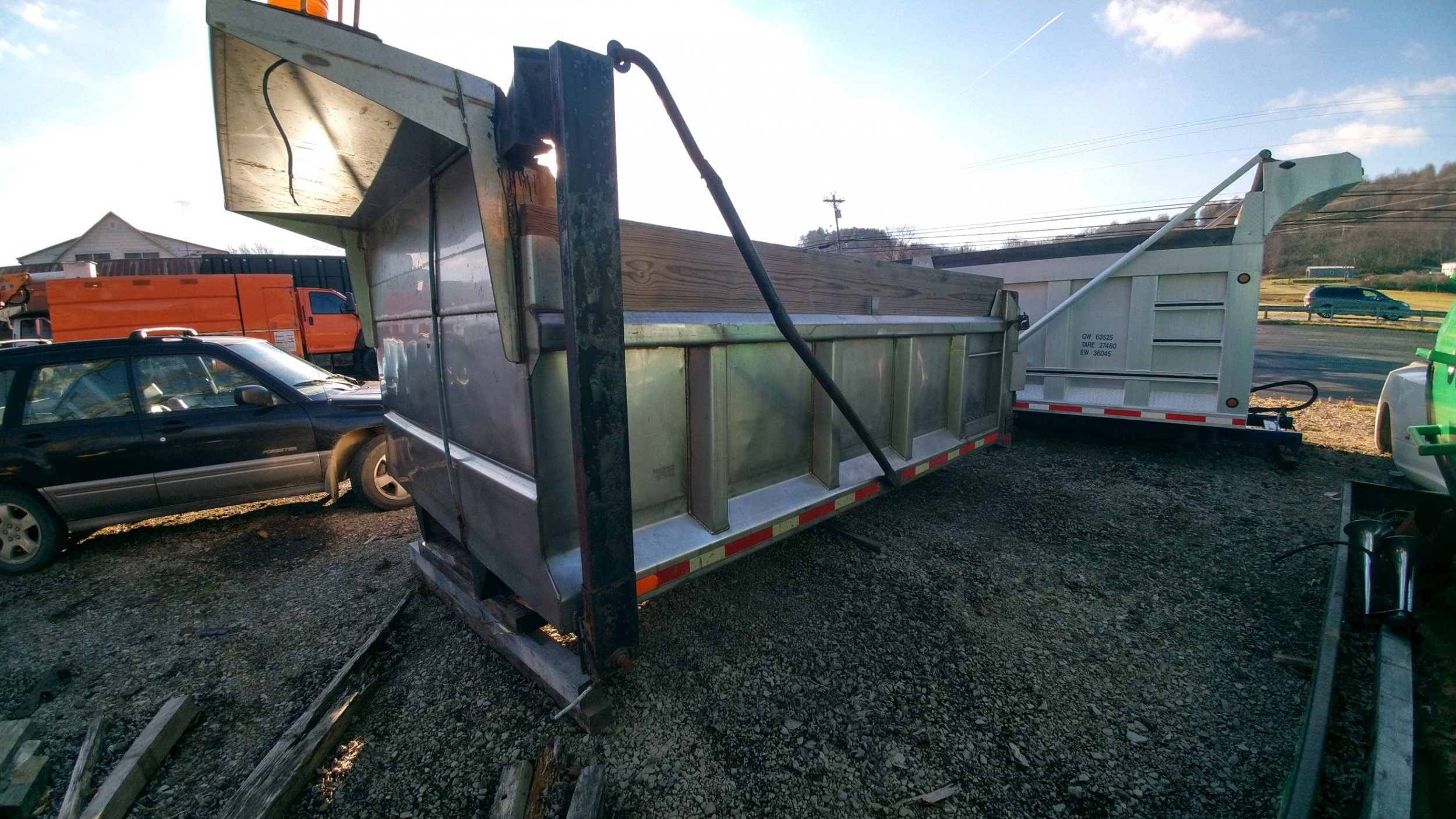

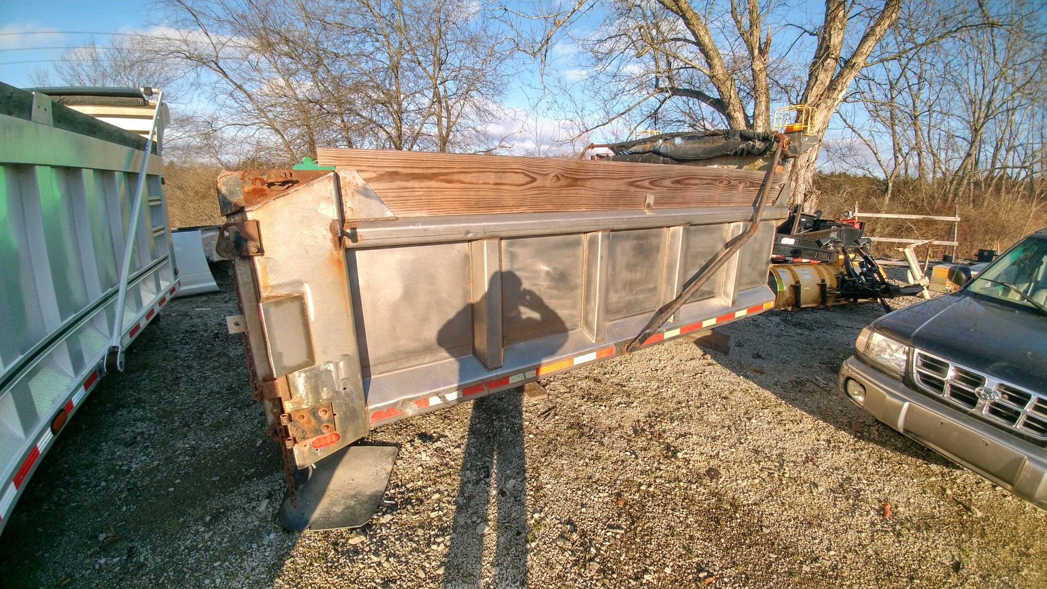

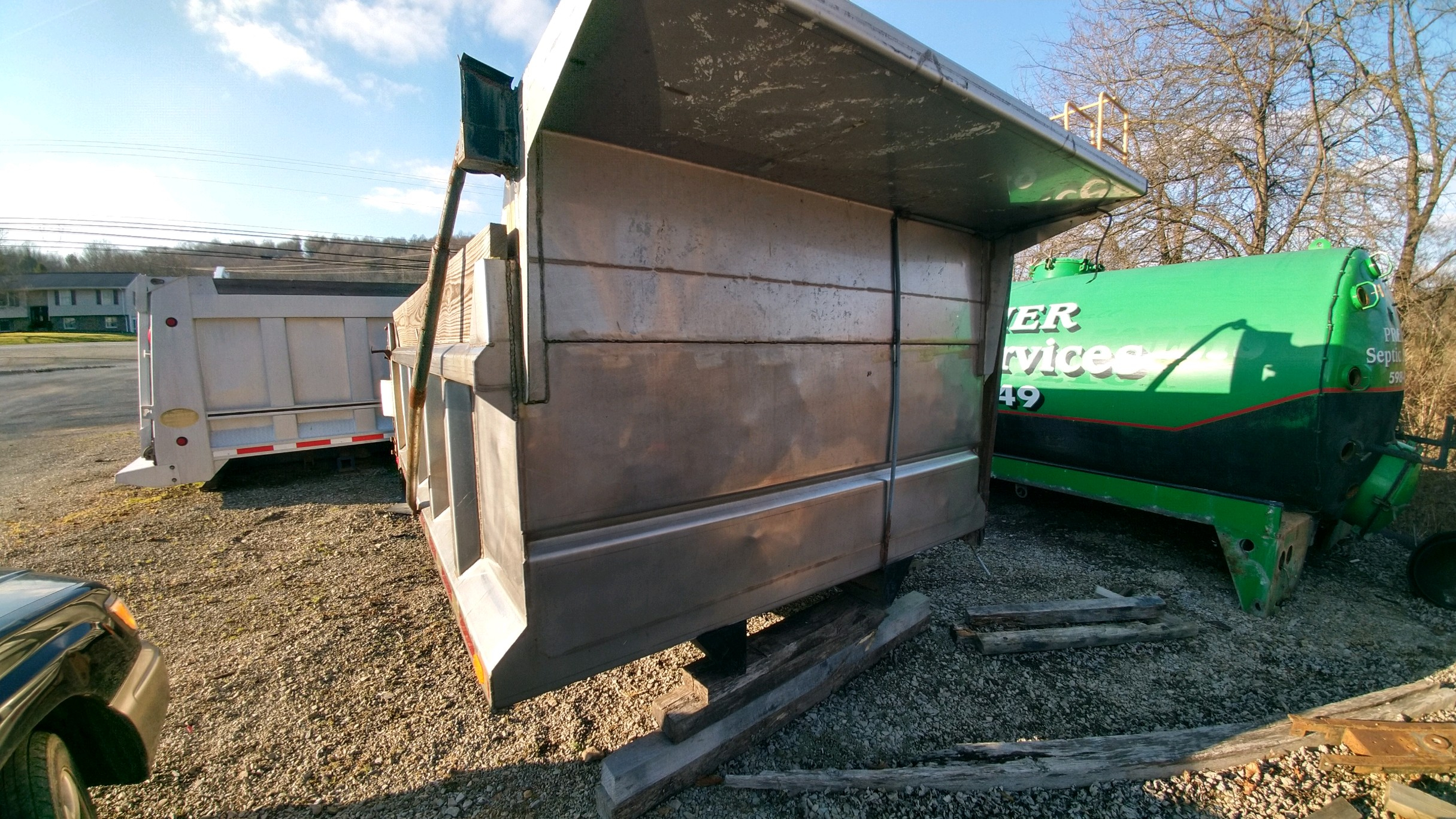

It looks like I found a replacement dump box!
Gotta drive a bit to get it, but it’s 13’ long, stainless steel and very reasonable. I will have to replace 5 or 6 cross members that rusted (frame is not stainless). I think it looks fine for a 15 year old truck. I have 13’ of frame, seller says the hinge is 12’-7” from front, so I think it’ll work.
I wish the sides were taller and it had thicker steel, but other than that, it’ll work.

   / New (used) IH 7500 Dump Truck purchase, modification & fix up #48
The white dump in the background has taller sides:)
#49
   / New (used) IH 7500 Dump Truck purchase, modification & fix up #50
yes:D
That dump is more than enough for a 6 wheeler, hauling heavy material such as gravel. But yes, bigger is better for high volume/low weight material such as wood chips. Doing the math, that dump looks to be about 11 yds, water level, assuming 3' sides.
