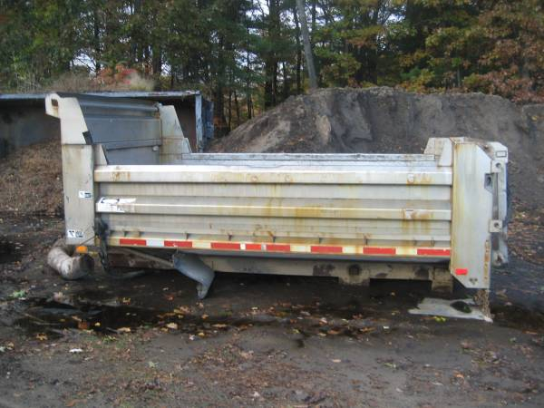

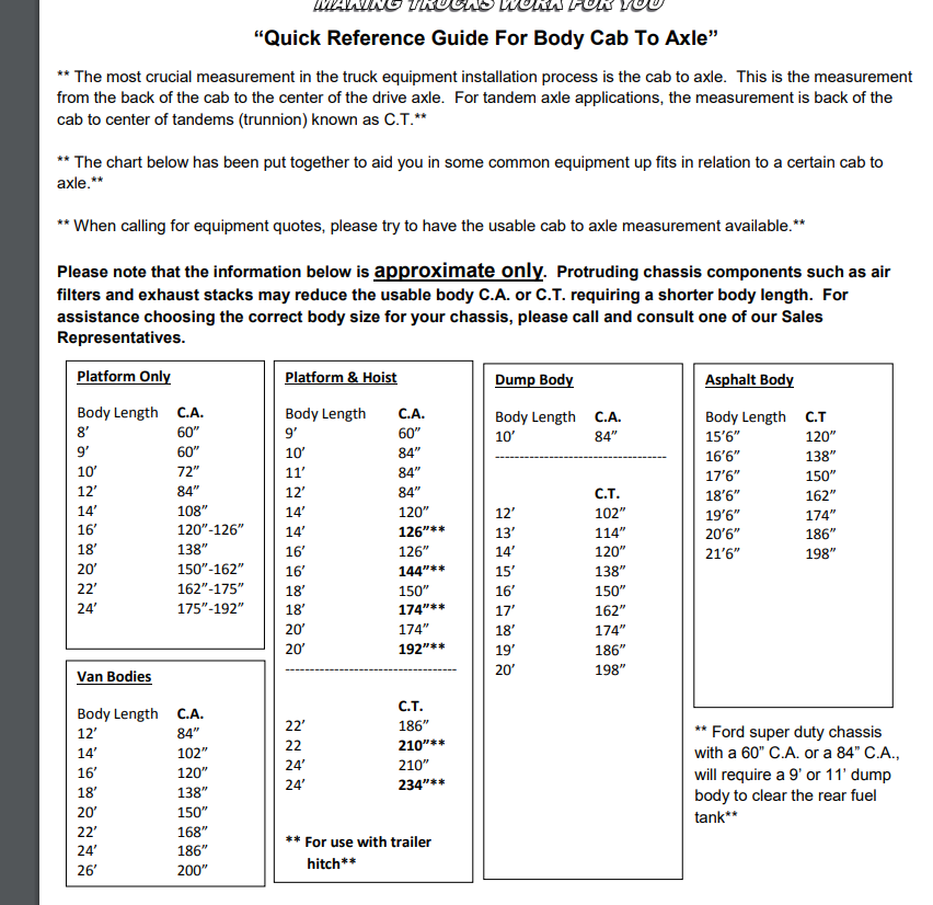

Are you worried about corrosion or dents?
Yes, but I think corrosion (from steel) is less of a concern than dents (with aluminum).
Steel also considerably cheaper.
I think aluminum is too fragile for what I will be doing.
Found this SS 13 footer on CL
   / New (used) IH 7500 Dump Truck purchase, modification & fix up #63
And you could redeck the steel with a new sheet over the old.

Aluminum bodies are nice until they start needing repairs. Personally, I'd never own an aluminum body of any kind, work trailer, dump body, service body or whatever. They work harden and can't take the flexing. Once you get a crack in a joint or anywhere it'll be never ending repairs and they are a royal pia to work on as they have to be clean.
I'd be a bit leery also of an aluminum rock body unless you line the bottom with something and then you're defeating the weight savings.
Those are my opinions and they're free so take into account what you paid for them LOL. Good luck on finding a good body, be sure to keep us in the loop.....Mike
#65
Yeah, I don’t think aluminum is a consideration anymore.
I‘m careful with equipment, but aluminum dump bodies need to be treated like a china doll

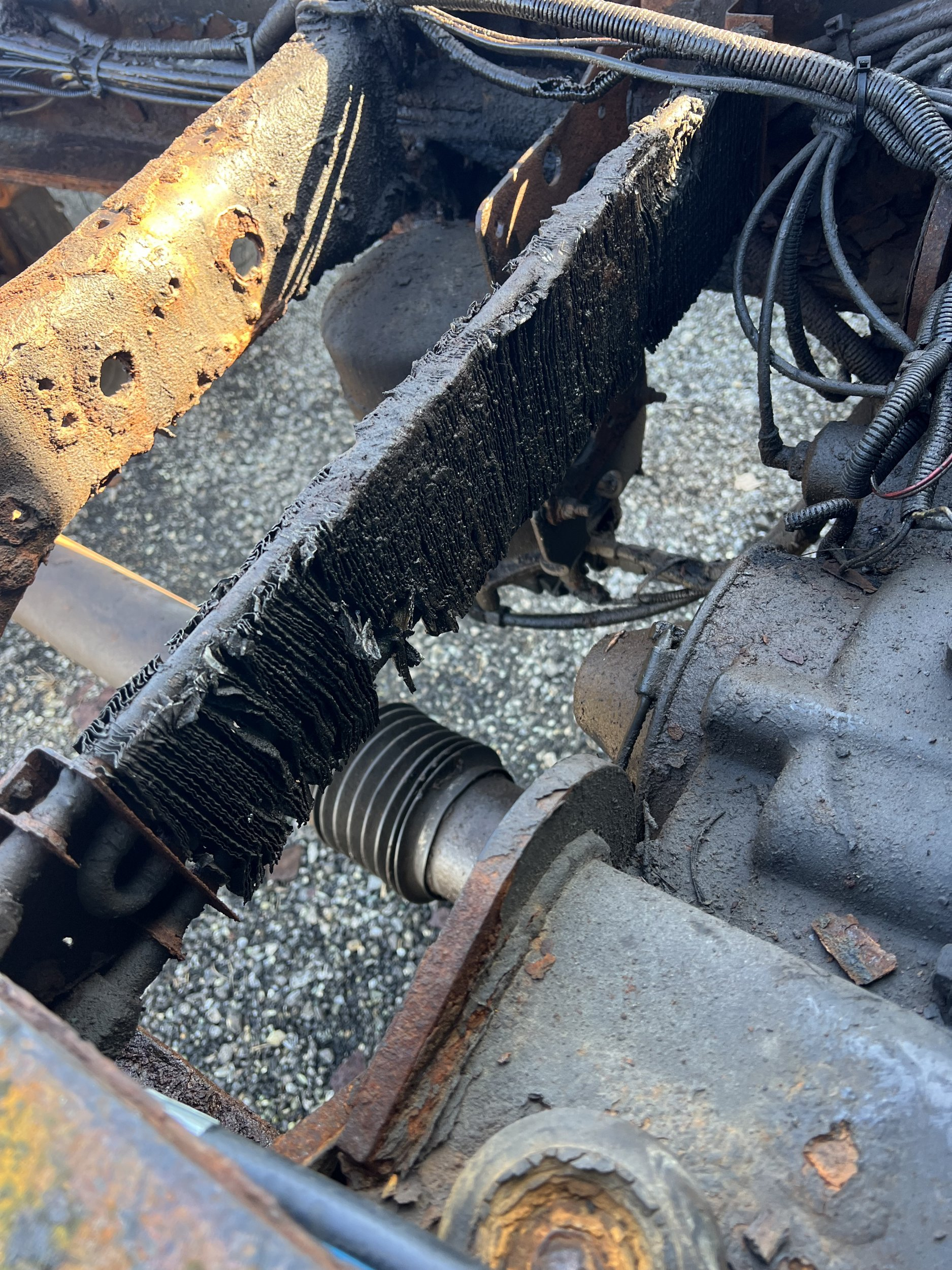

Removed everything. Just bare chassis left now.
Now the fun begins getting this frame restored and fixing some other things, like the transfer case cooler.
And this exhaust pipe.….you know, I thought the truck had a blown exhaust manifold gasket….maybe this is where the popping noise is coming from? I hope so-heck of a lot cheaper to fix this than the exhaust manifold!
