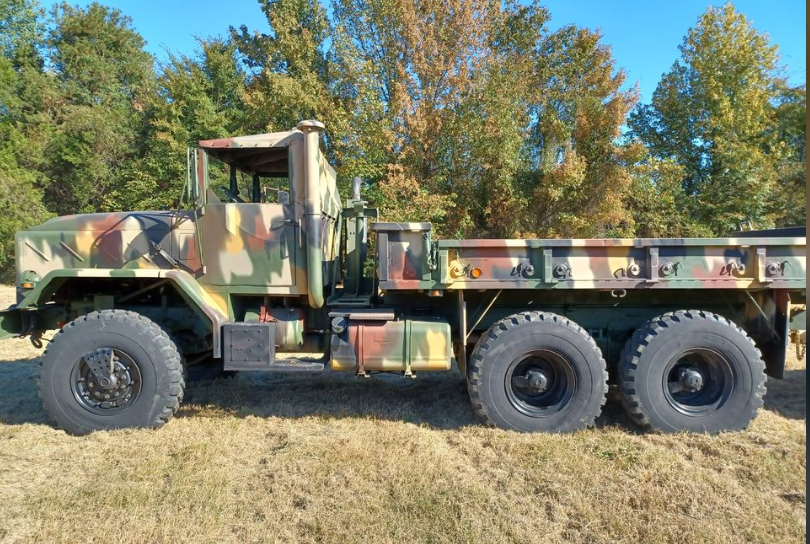

I will probably end up with a longer tandem for square bales, so I can pull a pup trailer if i want. Maybe a 6x6 if the right one comes along.
These things come up for sale a lot near me. I would consider them low priced. This one is a 1990 5 ton, auto, 6X6 with a little 10-12 foot trailer for $14,500. My brother in law got a much older one and it has done him well. They have a lot of drawbacks but also have a lot of good going for them for the price.

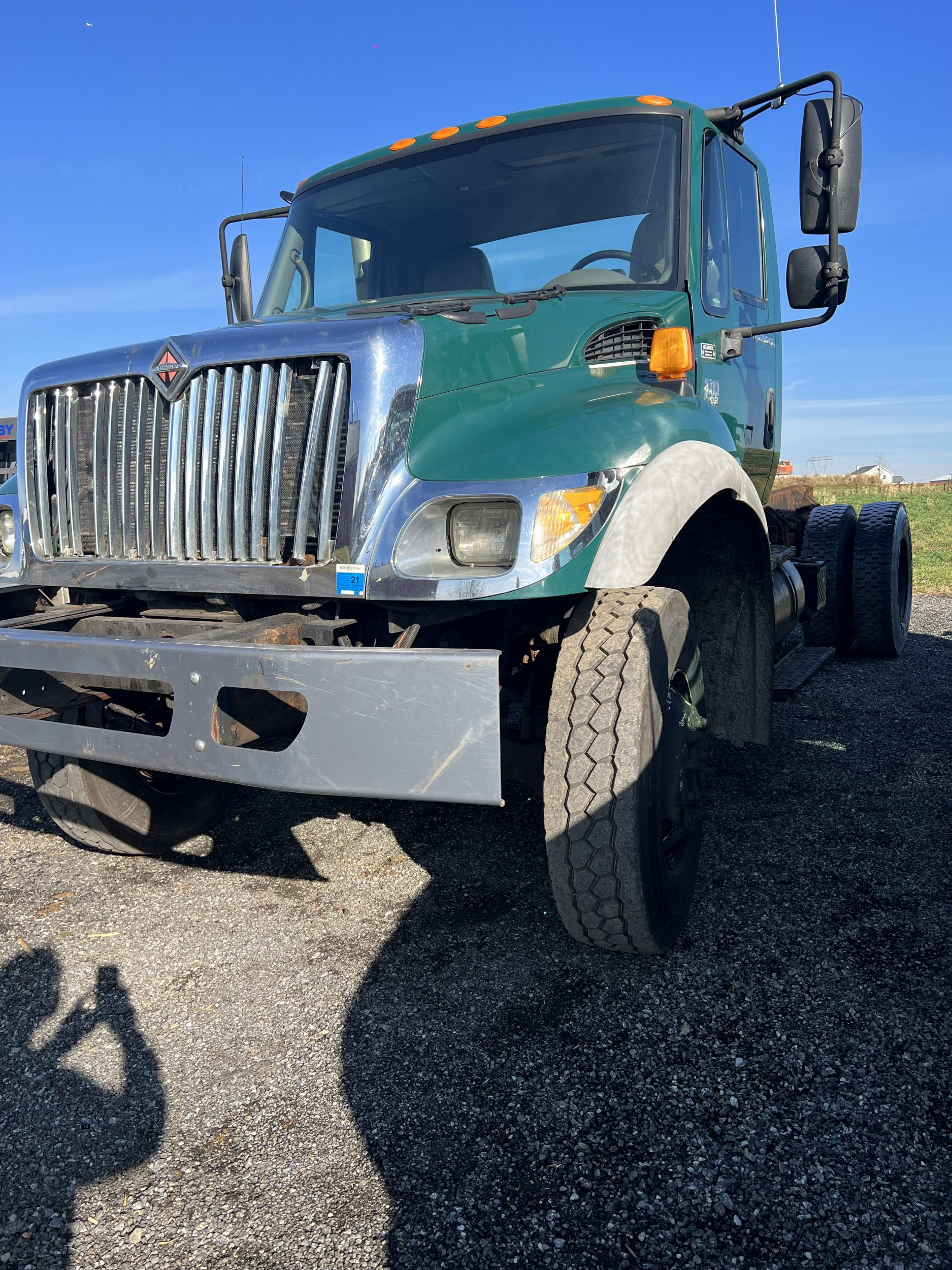

Guess I need to hack off the front frame and move the bumper back….although a front winch would be pretty cool there.
