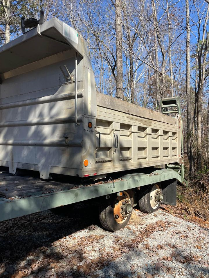

Looks in good shape. Shame tho they used ms on the peripherals instead of ss.
If you want a bit more capacity, you could add a partial cheater board on top of the front of the existing, tapering it off to nothing toward the rear. May give you an extra part of a yd, watch the front axle weight tho unless you're hauling cotton balls :) .
Noticed there's no lift cylinder tower/trunnion mount, I presume it's a scissor arrangement? If it is, watch how much weight you put forward so it'll still lift......Mike
EDIT
Just noticed you're wanting to use it for rock. I'd stay away from ss as it's usually thinner than ms and once you have a rip in the skin, you'll be chasing it forever. If you can, go for a Hardox or similar material.
Its got a 16,000lb front axle and a 30,000lb rear axle. That will really help
