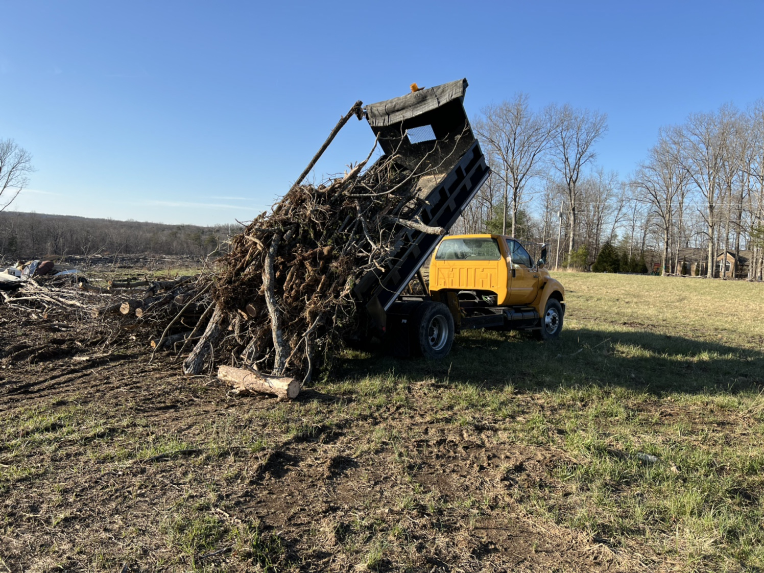

Sure can. It’s up to the operator of the vehicle to make sure its not overloaded. OTR, I’m pretty careful and take it slow. Off road is where I want the load capacity. It may see 100’s of 10-12 ton loads-driven slow to the dump pile.
   / New (used) IH 7500 Dump Truck purchase, modification & fix up #96
Now that's what you want :), nice reinforced tailgate too . Comes with the lift cylinder, trunnion blocks, cradle and hinge I hope? Add a cab shield too....maybe?
If the actual conveyor chain and gearbox is there you could flog that for a few bucks too.
#97
Just the box & cab shield. I have to hunt down the rest :(
But it’s cheap (in todays terms).
