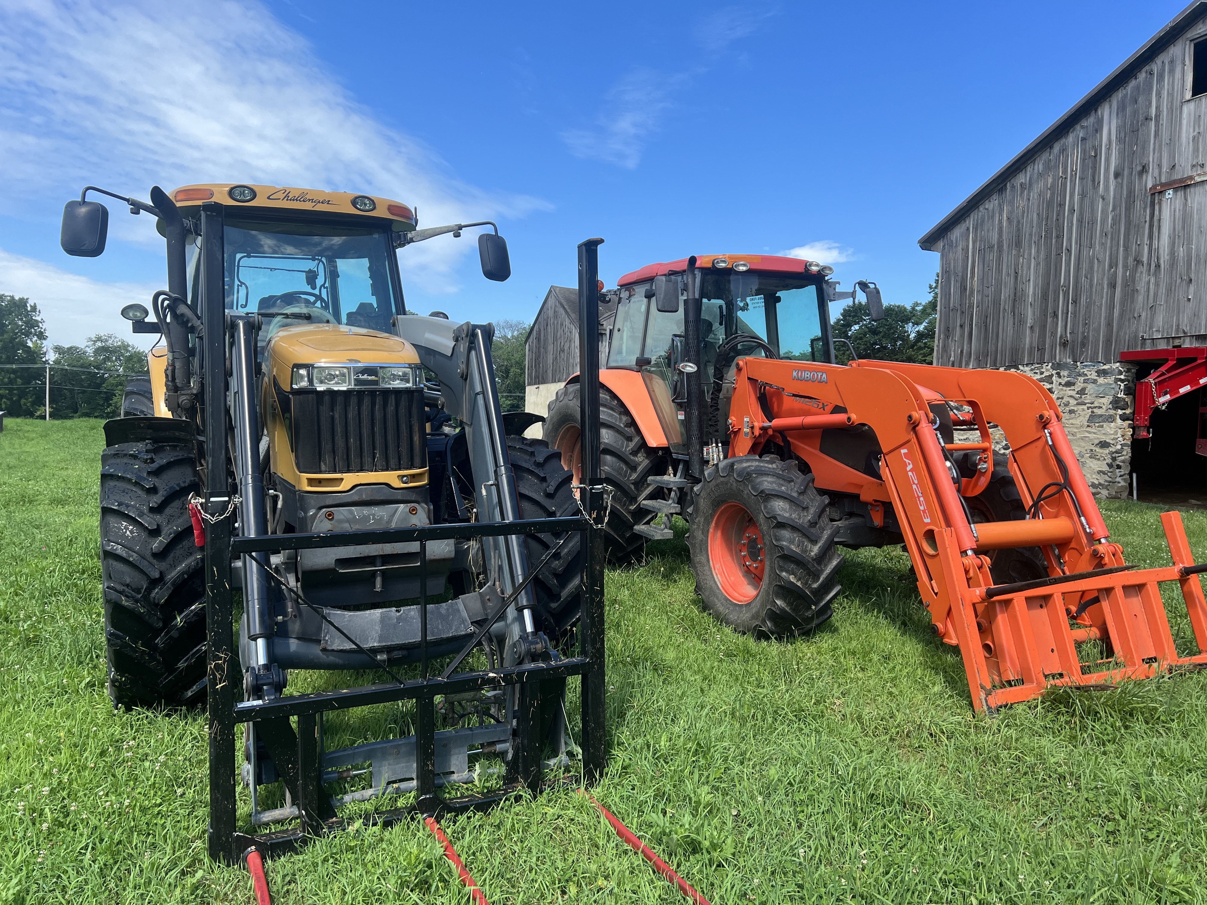

I tried small-medium sized farming with Kubota tractors (M-135X and M-126X) with disappointing results. By 3000 hours with above average care, they both started to fall apart.
I sold them and bought legacy brand tractors. They are faring much better, even with 6,000-10,000 hours on them.

It was disappointing to say the least. I expected more. Most of the tractor was ok, but I found the Kubota was lighter built by like 40% in weight and the hydraulics were much weaker.
Here’s a photo comparison of my 2 135HP tractors. Both are 2010’s. The AGCO Challengers tires are about 40% larger than the “comparable” Kubota. It weighs 5,000 more pounds. The loader/hydraulic pump lits twice as much. The front & rear axles are 50% bigger. Only thing they share in common is they’re both 135HP.

The premium is for the purpose-built heavier Ag built components and the ag dealer support.
You’d be much better off with a used legacy brand real Ag tractor than a new aisian utility tractor. It doesn’t have to be an old open station noisy thing. Look for a 10 year old Massey, Deere, Case-IH, Challenger, etc. They have cabs/AC/buddy seats/all the comforts, too.

Tractor Weight = traction, strength, safety, stability.
While the Asian brand tractors in most cases tout high HP to weight ratios, remember that a unique aspect to tractors is they put more power to the ground if they are heavier. Traction increases with weight. Safety & stability increases because the tractor stays planted to the ground better.
Generally speaking, legacy brand Ag tractors are safer and more stable than “Asian style”, lightweight/high HP tractors.
The 2 tractors I owned which I showed side by side are the same HP, but the American owned Ag tractor is much more capable because it takes its 135HP and transfers it to the ground much more effectively which means better traction. It also is more stable.
