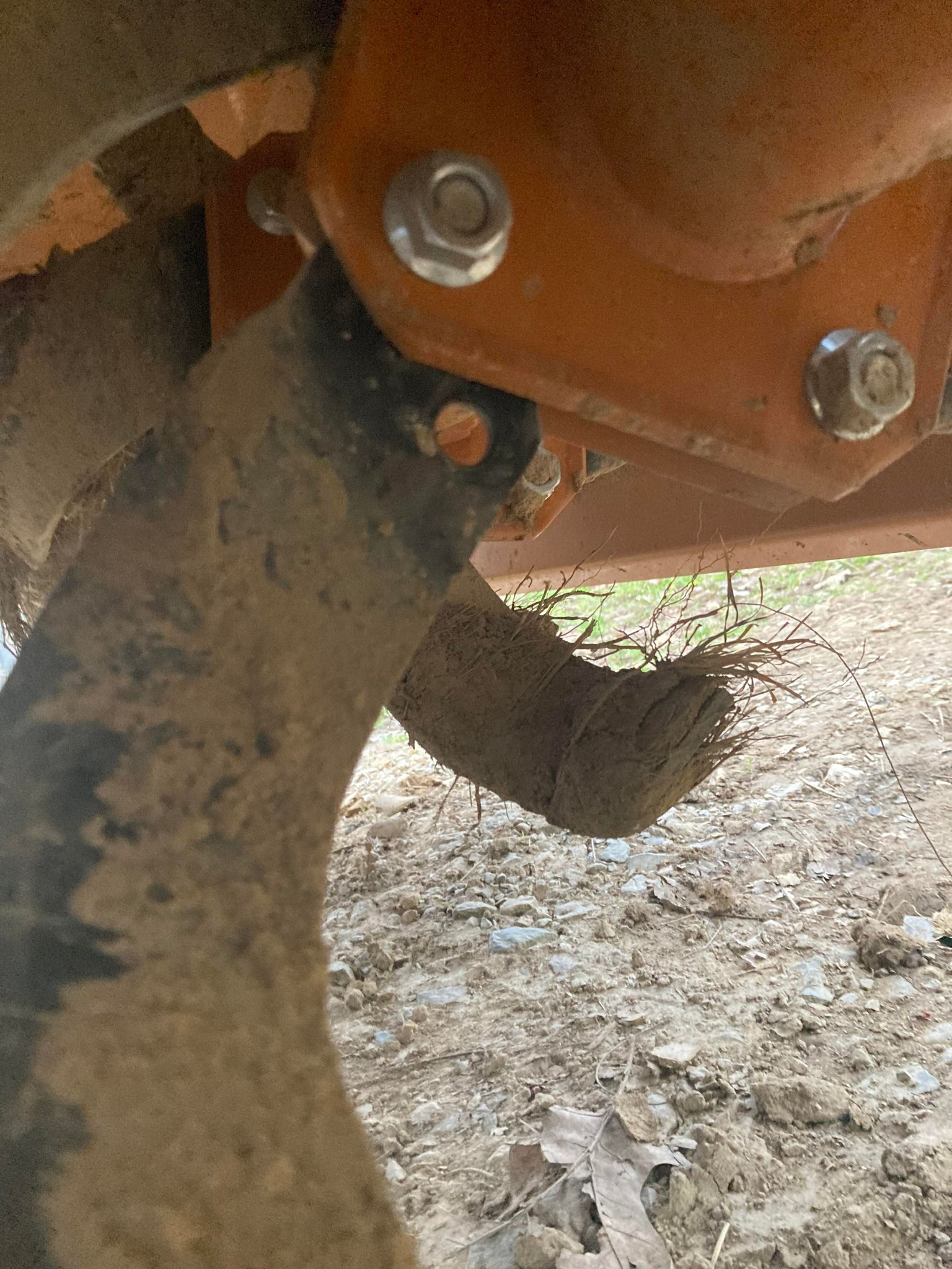

Thanks to everyone that commented. I finally got out there to give it a good looking over keeping in mind the comments of this post and found that I have 2 tines on same plate that are loose. Not sure why that would happen the soil i was in was pretty soft. Can't find much on the fix for this. Is this something easy to fix or will I need to take to dealer to fix. The way they are loose I don't understand. The bolts seem intact. When I moved them I noticed there is another hole in the top tine plus (Im assuming) another hole that the bolts is in.

Here is a picture of the tine. Do you think its just gotten loose and needs tightened up? or is there something broken? The bolt doesnt seem broke, and why is there the extra hole? ... Its only been used for about 40 minutes...thanks

There should be 2 bolts holding every tine.
SR
   / New Woods tiller problem..... #18
Sawyer is right. Look at the tines that are not loose and see how they are connected, With only one bolt those tines will be swinging and banging like crazy . You did not say whether you had filled the gear box and side box with fluid.

I checked and there is only 1 bolt per tine, so im a little confused esp as there is that extra hole which im guessing is for using for different positioning or rotation of the times....
