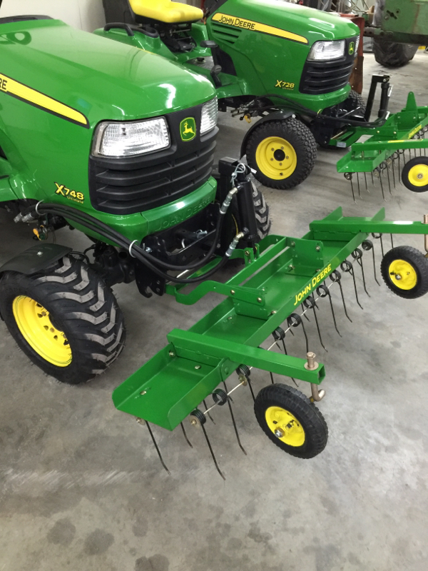

Here is an idea to hydraulically raise and lower your thatcher.
   / New X758 Coming #42
That's on my to-do list. I have the aerator. Just trying to find time to build the cylinder part.
   / New X758 Coming
#43
Thanks for the info on the thatcher lift. I found something similar in another search. Originally I was going to modify it to attach to the front quick hitch. But what you linked above will be a lot easier and I'm sure will work better. I'm debating on using cables to lift instead of a slotted bracket. Just to ensure there will never be any down-pressure.
