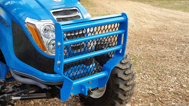

BTW I really like the mesh in the front guard of your tractor. :thumbsup: I have a chunk of mesh sitting ready for the same project even though I plan to stay away from brush and trees with the front end until the new wears off.

Thanks for the grill guard complement. I'll find some of the construction pis and post later.

Thats it! I saw your guard in a other post. Best looking (and functional) that I've seen.
Post thise pics up when you geta chance!
